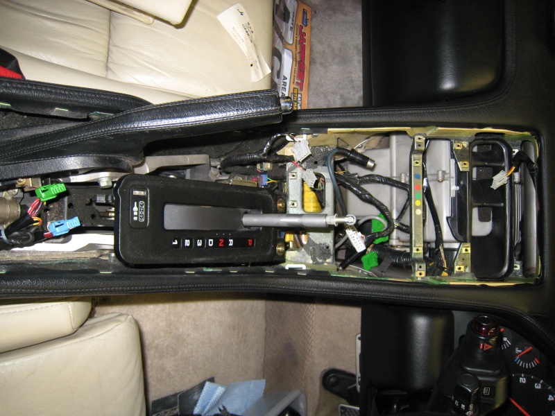

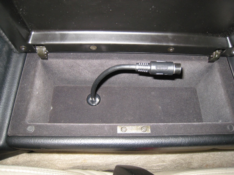

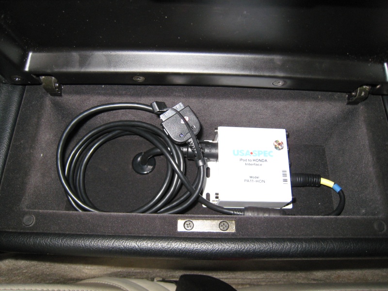

    Kept running the system on the bench for a few hours and then started the actual installation on the NSX.
ID:	7826 Click image for larger version.
    Centre console removed to check the good GND for the head unit.
    Using several Tyrap to secure the adaptor cable that was connected to the factory pre-installed CD changer cable behind the seat.
ID:	7828 Click image for larger version.
    Adaptor cable inside the arm rest box.
    USA Spec PA11-HON installed.

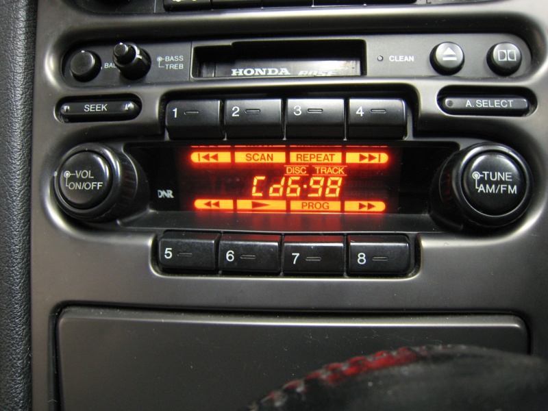

ID:	7830 Click image for larger version.
    Being tested with my old iPod mini. It will work with latest iPhone as well.
    Testing the system inside NSX. Playing 98th file.
    Finally, all the services are done and ready for the collection.

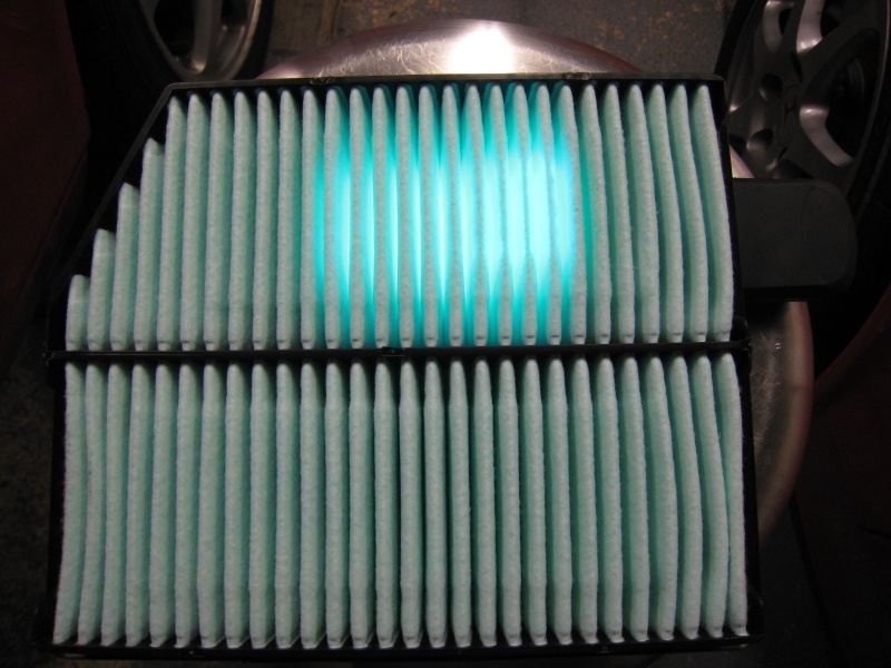

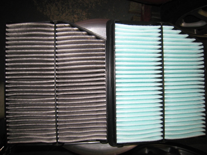

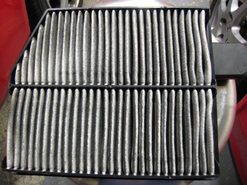

    Replaced the Air cleaner element on my NSX.
    Although there is a mileage based service interval for this item, I normally decide to replace it earlier by using the following method.
ID:	7847 Click image for larger version.
    The old and new ones.
    Honda changed the colour of air cleaner several years ago and it's green for the time being. What will be the next colour??
    I normally hold the air cleaner element against the sun and check whether I can see through enough sunlight or not.
    When the weather is not great, I just use LED light instead of the sun.
    I'm not great in taking photo under this kind of light condition so it doesn't show the actual amount of light passing through the filter but hope you can get some idea on what I was trying to do.
    Compared to the new one, the old one didn't pass through enough lights and so decided to replace it.

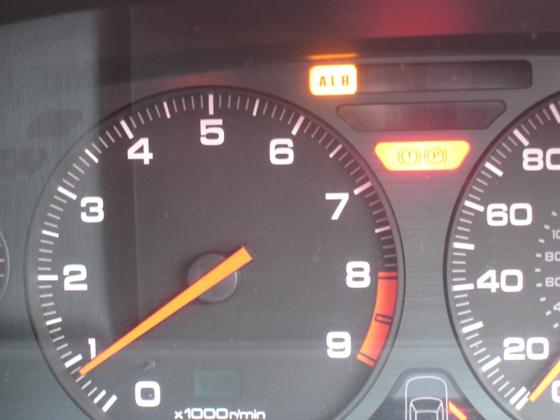

    Once again, started to work on another NSX.
    It went though my Health Check awhile ago and brake, ABS, driveshaft, etc were the main areas to be addressed.
    There were some parts missing from the car but managed to catch up with the owner one night as I was just happened to be in the area close to his place.
    During my Health Check service, it was quite scary to drive this NSX.
    While you were pressing the brake pedal to slow down the car, the pedal was kicked back at super fast frequency every time when the car was just about to stop.
    The kick back frequency felt like 10 times faster than the normal ABS one.
    There was no ABS warning light nor any error codes stored.
    So, before start removing the parts, I decided to carry out further investigation on the strange brake pedal kick back.
    This time, I kept the window open and drove at very slow speed.
    I found that from time to time, the ABS pump was cycling almost every 10sec but not always.
    If I used the hard braking, the ABS will kick in properly so at least, some of the solenoids were operating correctly.
    I decided to force the ABS to fail by disconnecting/connecting one of the solenoids connector while the engine was running and carried out the same test driving procedure.
    This time, there was no issue at all and I didn’t feel a single kick back during the session.
    Considering the state of this ABS system, it is possible that it may have multiple issues.
    The system will be flushed including the four solenoids but it may require replacing the accumulator module like the member 'britlude' reported in his thread awhile ago.
    Depending on the usage of this NSX, considering the potential failure in the future and the benefit of the upgraded ABS kit, it may worth investing into the upgrade than trying to repair this 1st generation system.
    To be discussed with the owner later.
    Time to prepare the car for the services.

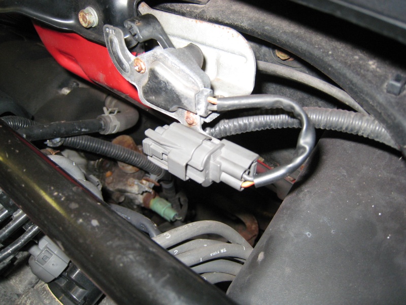

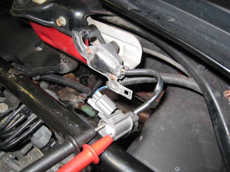

    While briefly looking inside the engine bay, I noticed that the connector for the engine hatch glass switch was partially disconnected. Turned out it was done on purposely as the engine hatch switch was already dead and continuously creating short circuit.
    The bonnet opener/lock was stuck so gave it a good clean.

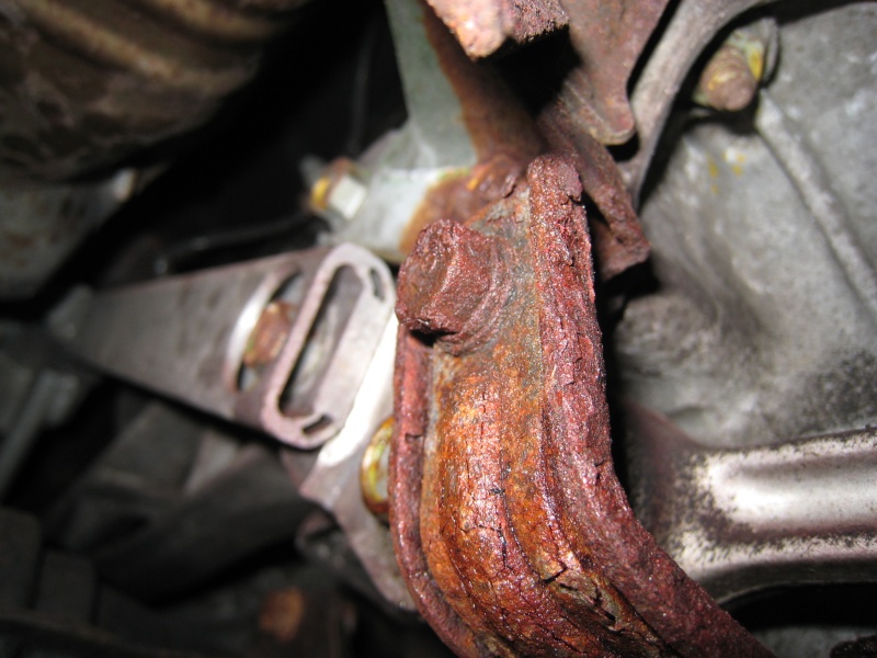

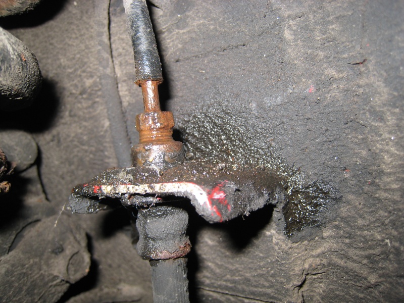

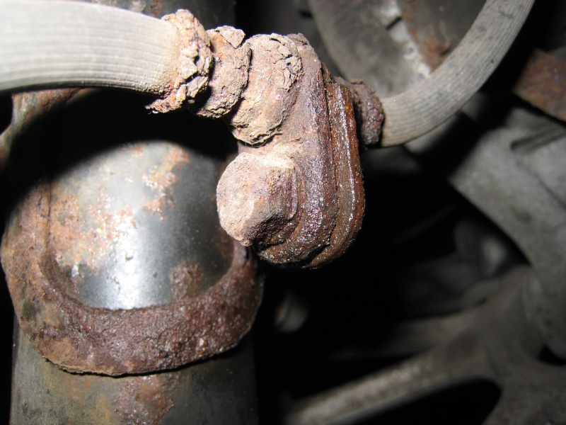

    The initial check on the general condition of the car.

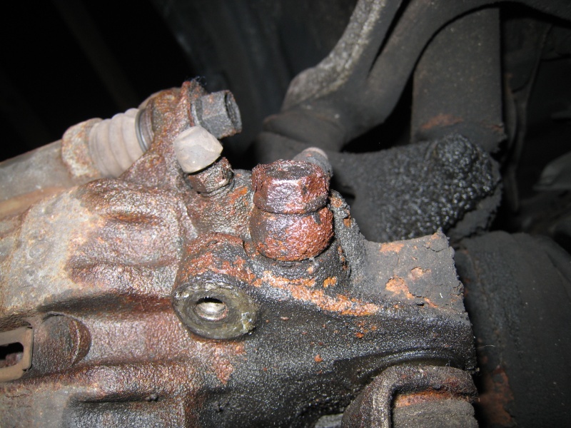

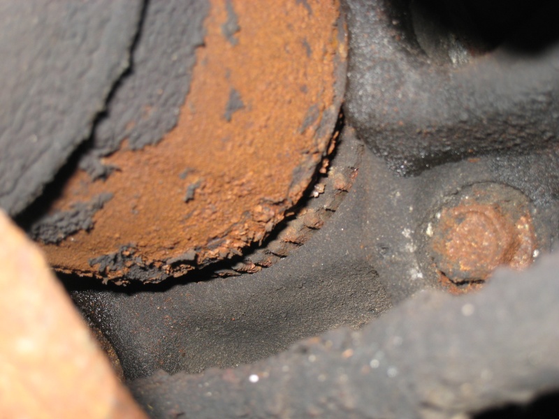

ID:	7853 Click image for larger version.
ID:	7854 Click image for larger version.
    There were lots of corrosion on the bolt, nuts, etc around the brake area.
    I’m quite sure I’m going to struggle with these fittings at each corners. Quite often, the fitting and the pipe bonded each other due to heavy corrosion and if you tried to turn the fitting, it would twist the pipe.
    I'll first need to turn the hose side to disconnect it from the fitting and then use my fingers to break the bonding between the fitting and the pipe. I love challenges....

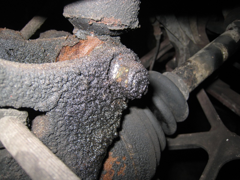

    The right side drive shaft splashed so much grease everywhere that I’ll need to spend long time for cleaning the area.
ID:	7858 Click image for larger version.

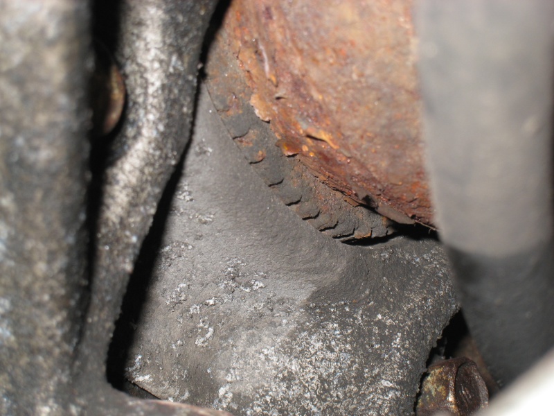

    The wheel speed trigger teeth at the drive shaft were covered in lots of debris.
    Could be related to the cause of ABS issue but it only happens at dead slow speed so not sure.
    Will check the state of the wheel speed sensor head once I have removed the drive shaft.
    At this stage, it is not planned to work on the left side but I may need to do it as the trigger teeth was in similar condition....

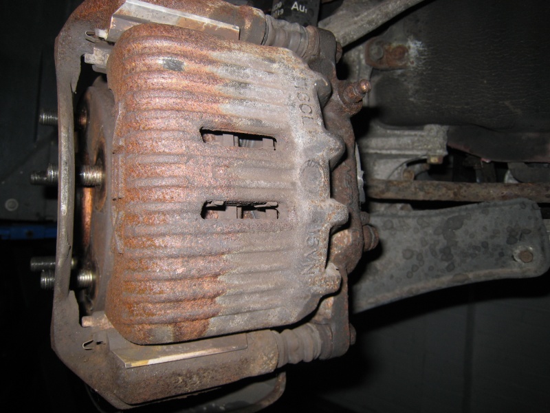

ID:	7860 Click image for larger version.
    Both Front and Rear brake callipers looked never serviced in the past....
    Can't wait to see the inside.....
    Another long long days with NSX starts from here...
    More to follow.
