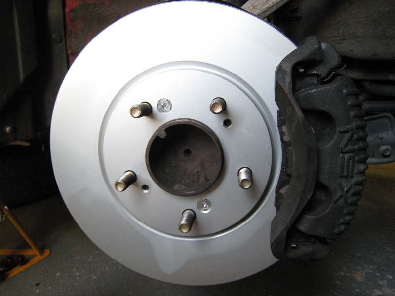

    New Front Brake Disks and Refurbished Front Brake Calliper with new pistons
ID:	5345 Click image for larger version.

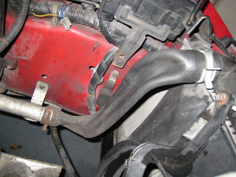

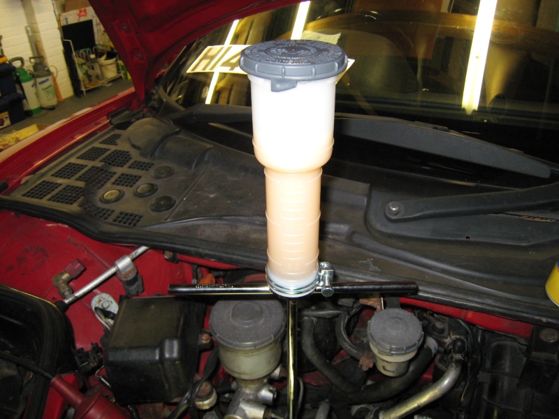

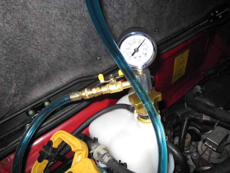

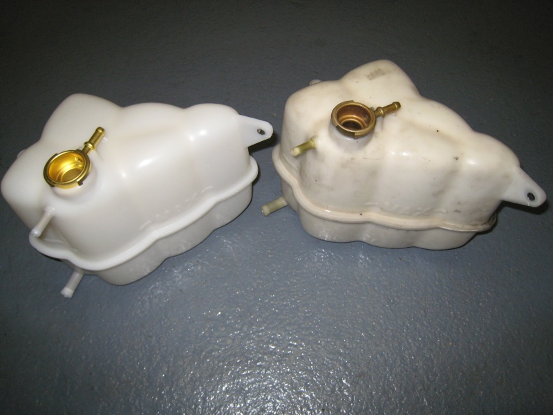

    Vacuum test and fill of coolant with new header tank, thermostat and cap
ID:	5350 Click image for larger version.
ID:	5351 Click image for larger version.
    The coolant hose will be forced to collapse during vacuum test

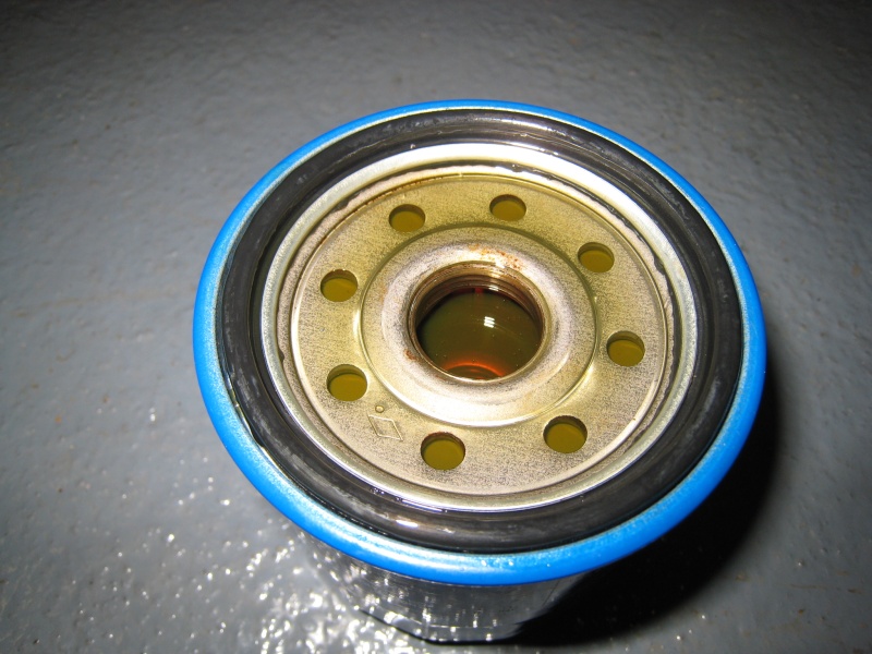

    Oil filter filled with Oil

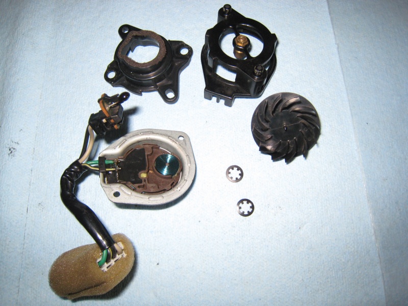

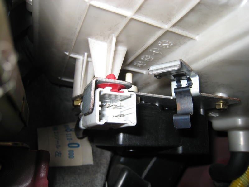

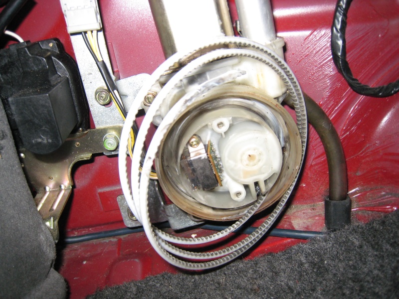

    Air mix motor repair and Door linkage repair
ID:	5355 Click image for larger version.

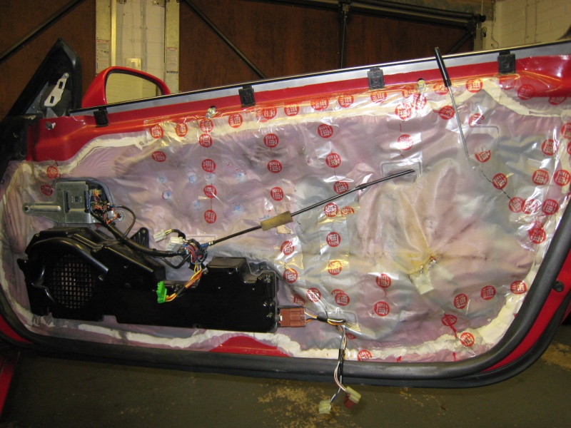

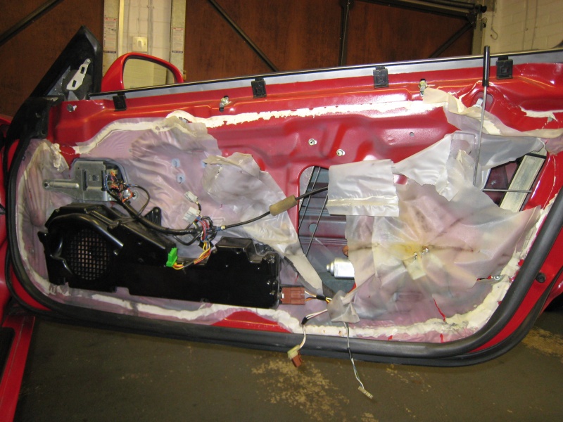

    Door panel internal weather sheet repair
ID:	5357 Click image for larger version.

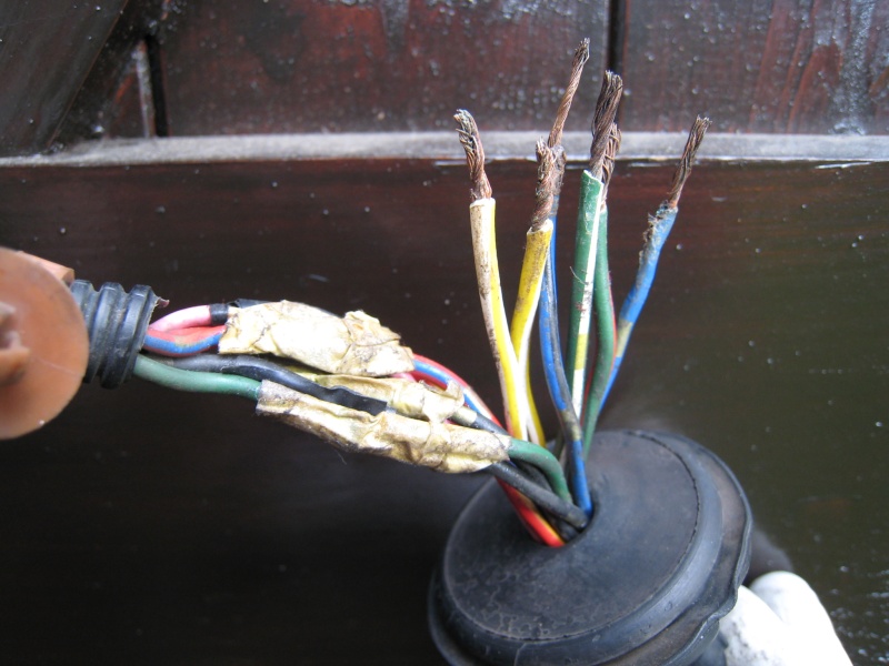

    Antenna mast service

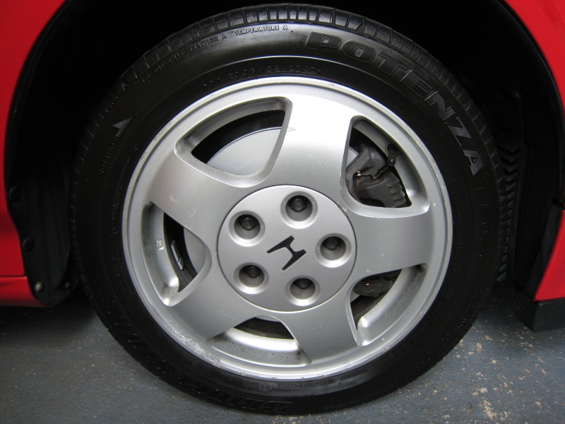

    Nice new weatherstrip and Washed the car and dressed the tyre
ID:	5360 Click image for larger version.
