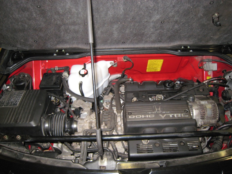

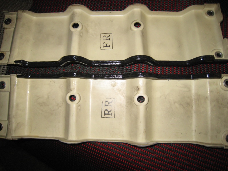

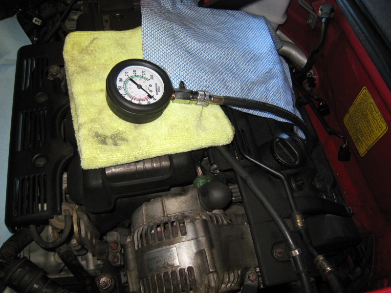

Time for another compression check.
Once again, spending hours on valve clearance adjustment paid off. The compression for all six cyl were within 2psi window. When the car was delivered, #6 cyl showed quite big difference from other cyl but now it is really close to others.

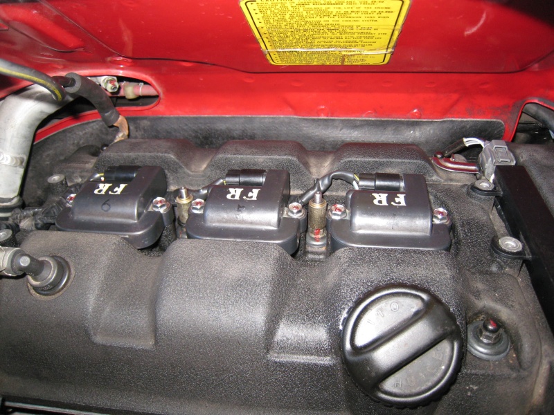

IGN Coil installed and torqued to the spec.
Applied silicone grease to the new rubber seal on the IGN Coil cover. Must items to be replaced.
Please apply silicone grease at least once a year in the future especially at the rear bank in order to prevent misfire caused by moisture getting to the base of IGN coil body.
Attachment 8202
I may need to add small amount of extra coolant but for now, the Engine room is done.

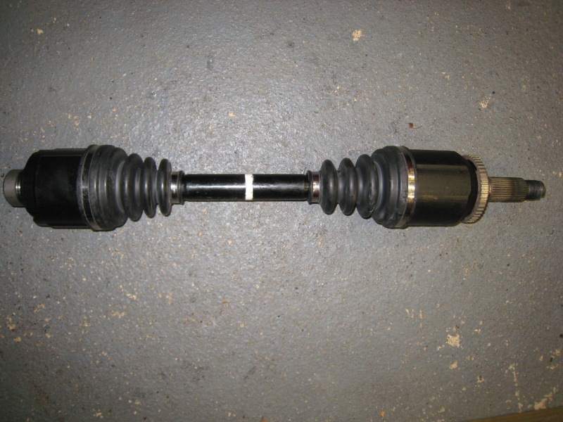

3 Attachment(s)
Attachment 8203 Attachment 8204 Attachment 8205

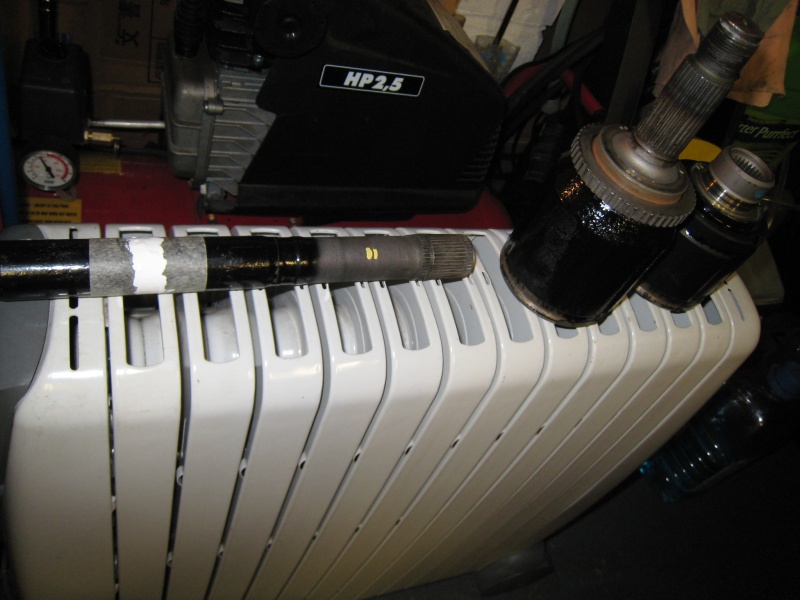

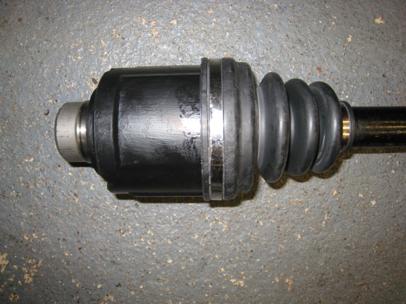

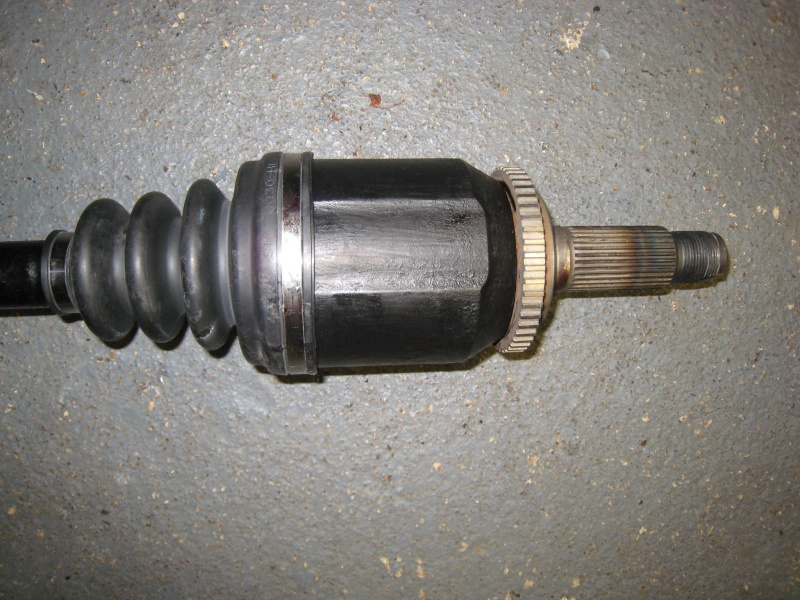

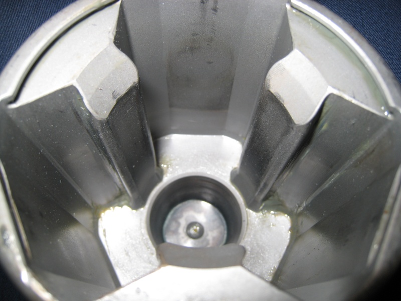

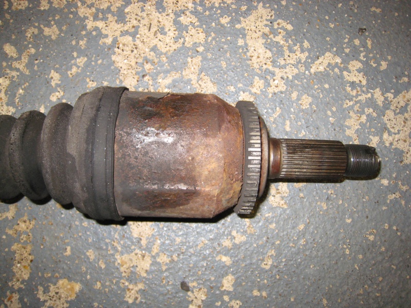

Cleaned and inspected the drive shaft joint. Normal wear was observed.
As seen on many NSX, the spider at the outboard joint was very loose making clicking noise. I could move it with my fingers.
During the refurbishment process, the spline will be staked so that the spider has to be pressed into the shaft to prevent future noise.
Painting the joints and white marker on the shaft.

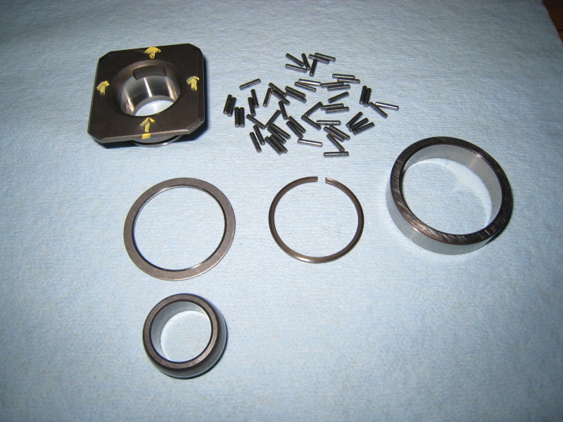

Refurbishing the rollers. Another long hours planting these tiny pin bearings…. Not great when it's so cold and loosing the sense of finger. I had to bring them inside the room for this occasion. I promissed that I won't make any stain on the carpet....
Nearly done.

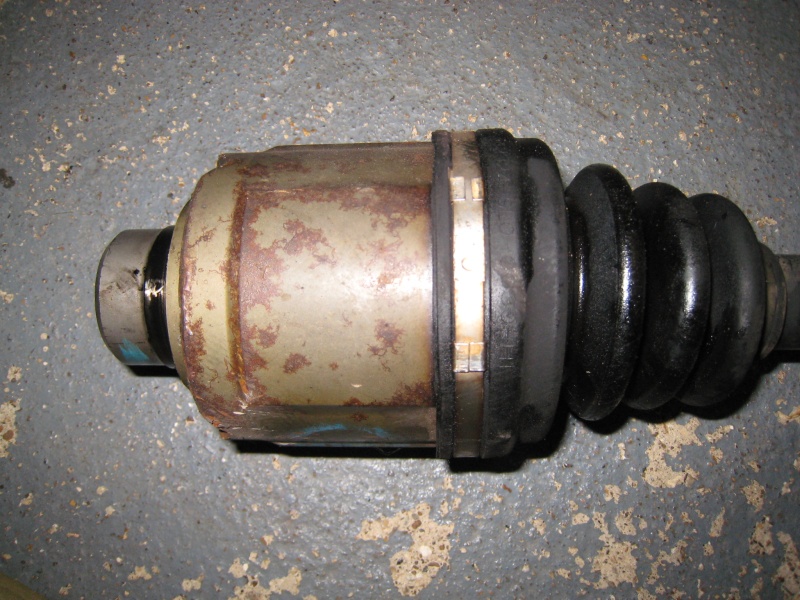

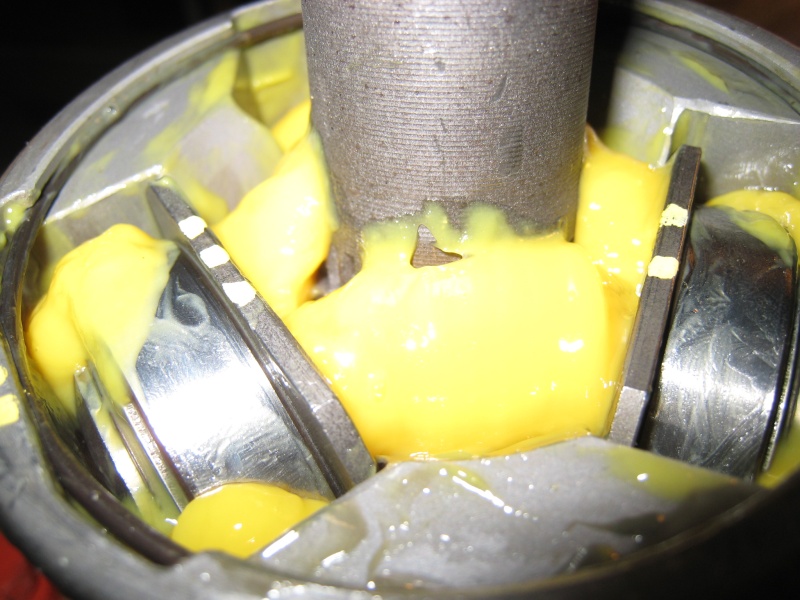

3 Attachment(s)

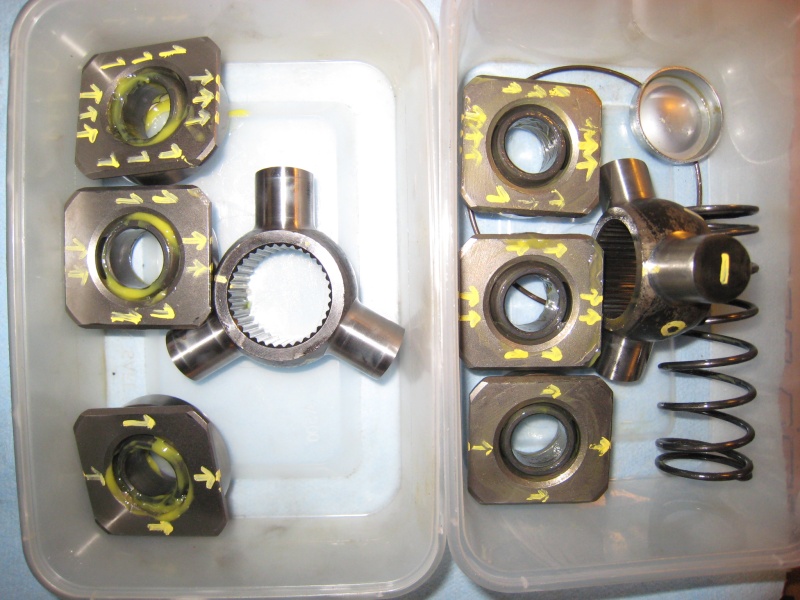

Attachment 8207 Attachment 8209 Attachment 8208
As seen on many NSX, some of the rollers were showing the sign of scorching due to the grease got broken down. The scorching on this NSX is at very early stage and not too bad at all compared to other NSX. Very good timing to refurbish the driveshaft preventing further damages.
All six rollers refurbished with new grease.
Re-building the joint.

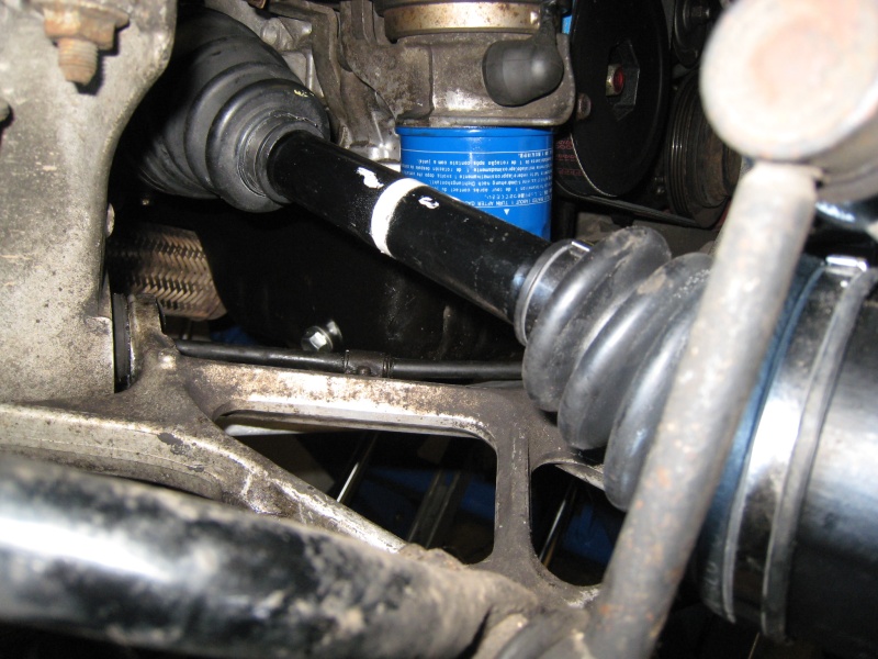

Time to install the driveshaft.
Attachment 8218 Attachment 8215 Attachment 8216

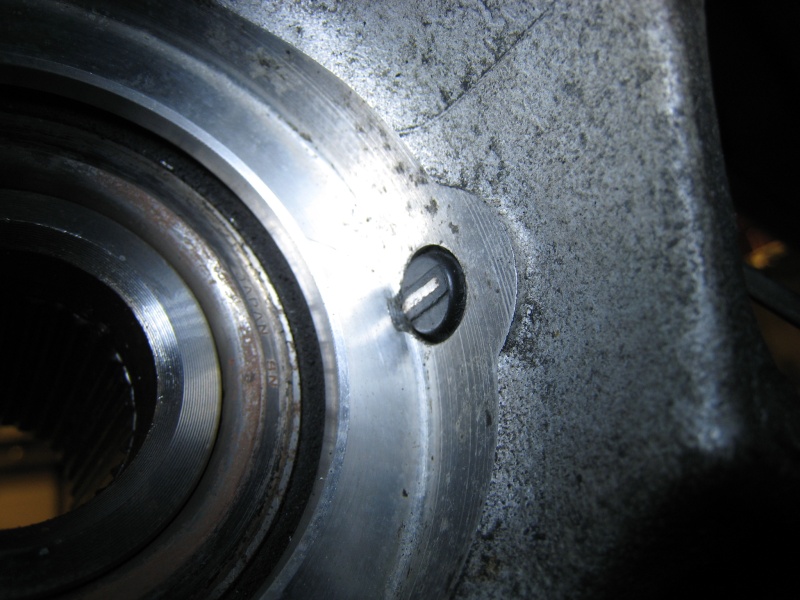

The wheel speed sensor was cleaned and looked in very good condition.

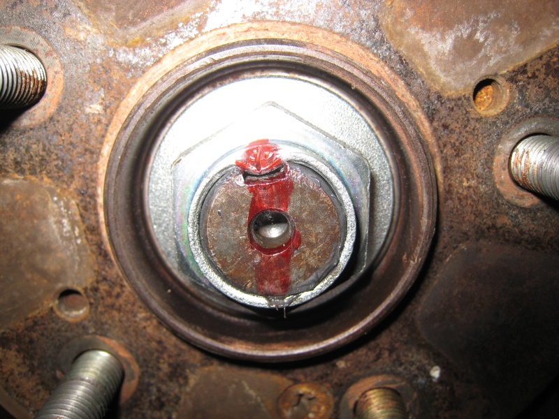

Driveshaft installed and the spindle nut was torqued to the spec and staked to lock it.
Attachment 8217

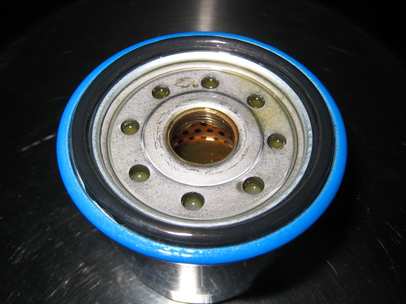

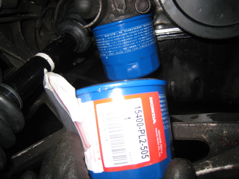

The original oil filter looked fairly new but to be replaced.
As a normal procedure, I just filled up the new filter with the eng oil before the installation.

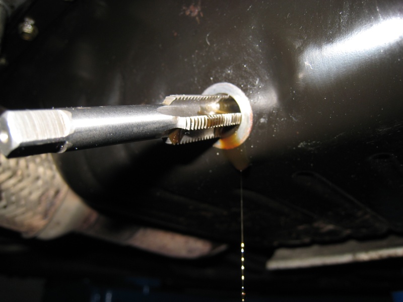

Before start of the service, the owner kindly informed me that he was told from the garage during the previous service that the oil drain bolt was cross threaded. Not the first time to hear this kind of story and in fact, I had to repair the thread or even replace the oil pan on many NSX in the past.
On inspection, it was quite bad but not to the level that I must replace the oil pan.
Attachment 8223 Attachment 8222 Attachment 8219
Therefore, while draining the Eng oil, re-threaded the bolt hole to prevent leaving the debris inside the pan. As you can imagine, my hand and floor were covered in hot oil but cat sand did great job in absorbing it.

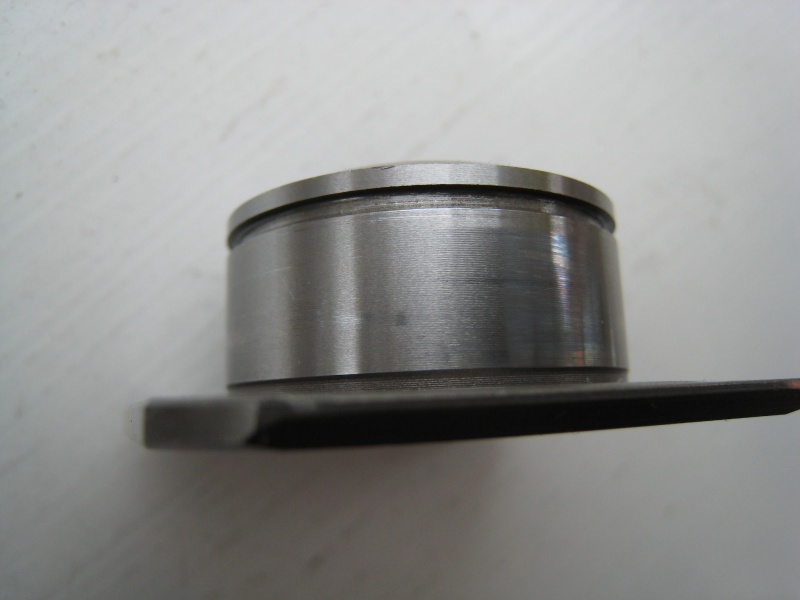

I don’t use silicone grease but apply tiny amount of silicone oil compound on the outer surface of the piston on both the Front and Rear ones. I learnt this long time ago.
I don't apply anything on the calliper cylinder apart from brake fluid.
I do use silicone grease at the groove of the piston where the dust boot rubber sits.
Hope following description will give you better picture.
If you put the piston on the desk with the open end facing upwards and look at it from the side, the top section including the groove for the dust boot is coated in silicone grease.
Below the groove, it is covered in very thin silicone oil compound.
Even if you didn’t apply the silicone oil compound on the surface of the pistons, it will be covered by it once installed into the calliper because all of the seals (Front/Rear) are covered in compound any way.
