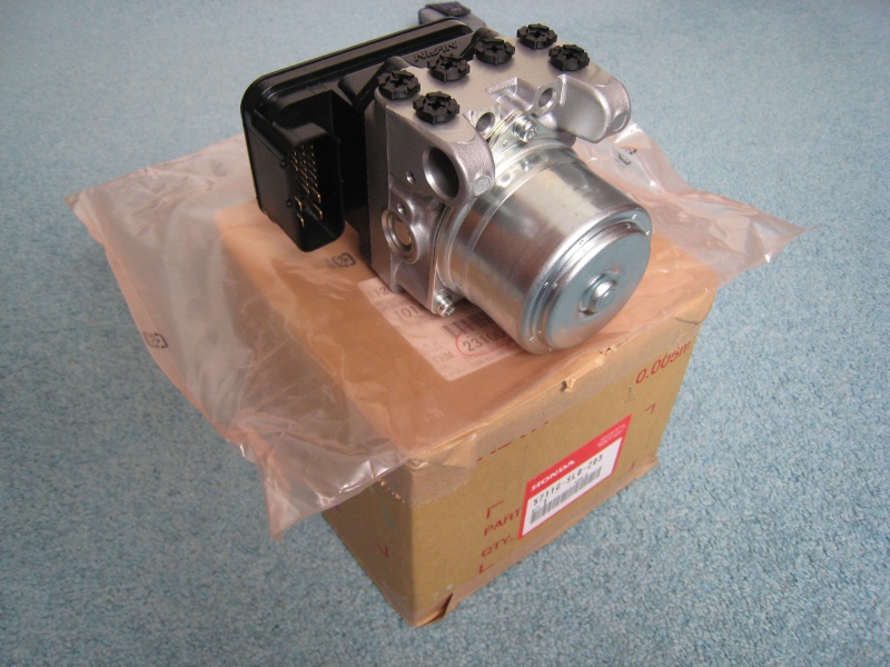

Finally, my ABS controller for the upgrade has arrived.
I wanted to bring it back with me on the way back from Japan recently but it was out of stock at Honda Japan.
ABS upgrade is so popular among the Japanese owners that quite often, this parts goes out of stock. It’s the same story for the ABS upgrade adaptor loom. It ran out of the stock for the big black/orange AMP connector that connects to the ABS controller and lots of people are waiting for the delivery.

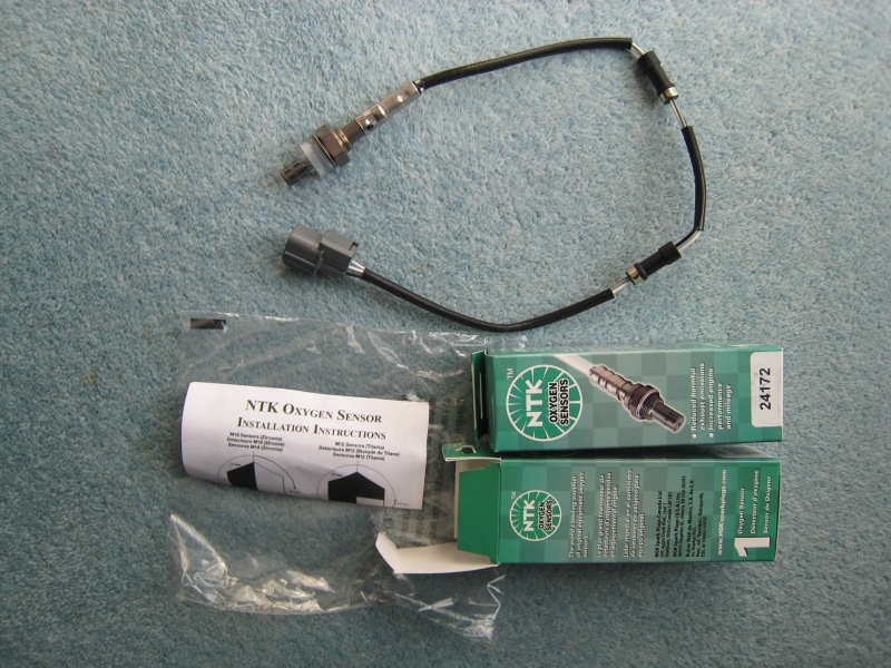

Also, I received my spare O2 sensors from US.
It took extra days due to Easter holiday as well as people not familiar with the international shipping.
Although I brought back the header by KSP Engineering with me from Japan, I have a policy of never touching the header/exhaust area without the spare O2 sensors.
Now they are here so I really want to install all of the parts for the header but I just don’t have time and space….
I hope I can install the header and ABS upgrade in time for the Japfest…….

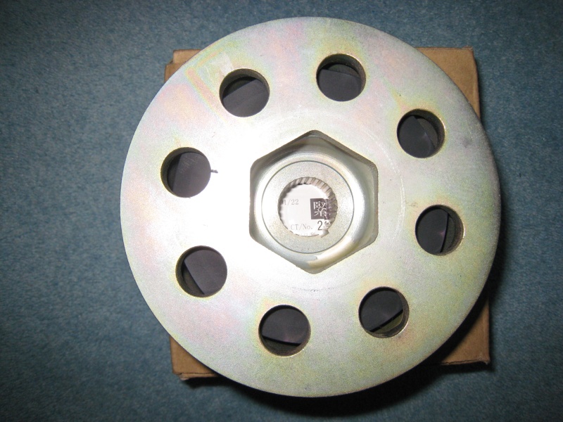

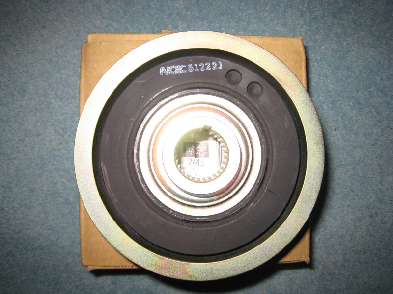

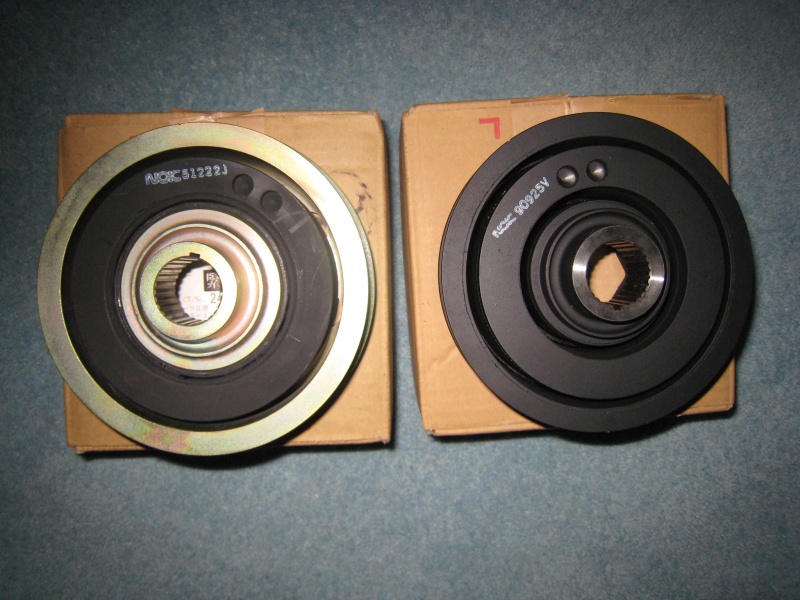

Just for the record… AT Crank Pulley
After the owner took my Health Check Service, he wanted to replace his Crank Pulley and several other parts so I included them into my regular parts delivery from Japan and US.
His NSX is AT and he kindly allowed me to open the box so that I can take the photos.
Attachment 6762 Attachment 6763 Attachment 6764
AT spec on the Left and MT one on the Right.
From opposite side.
Larger diameter on AT one.
Attachment 6765 Attachment 6766
AT spec from both side.
By the way, you will need different HEX adaptor tool for AT and MT.
HEX 45mm for MT and 50mm for AT.
Or, you can keep it if you have other Honda models and willing to work on them. HEX 50mm is common on almost all of other Honda models but some of them require specific depth/height design due to limited space around the pulley.
