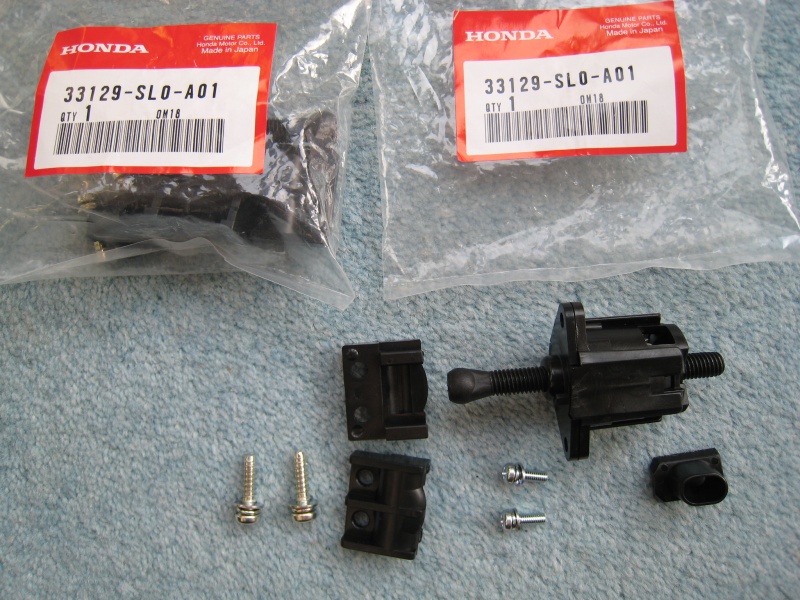

I installed these on lots of NSX in the past and also provided some of the owners with the parts.
In fact, I had the parts for my NSX for a long time but there were lots of higher priority projects than the installation of these and thus, couldn't install them until recently.
Attachment 7562 Attachment 7558

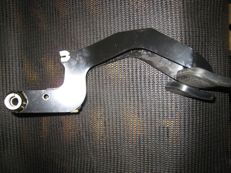

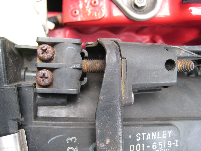

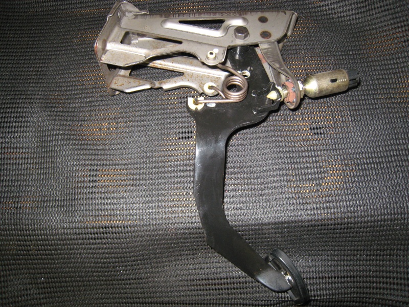

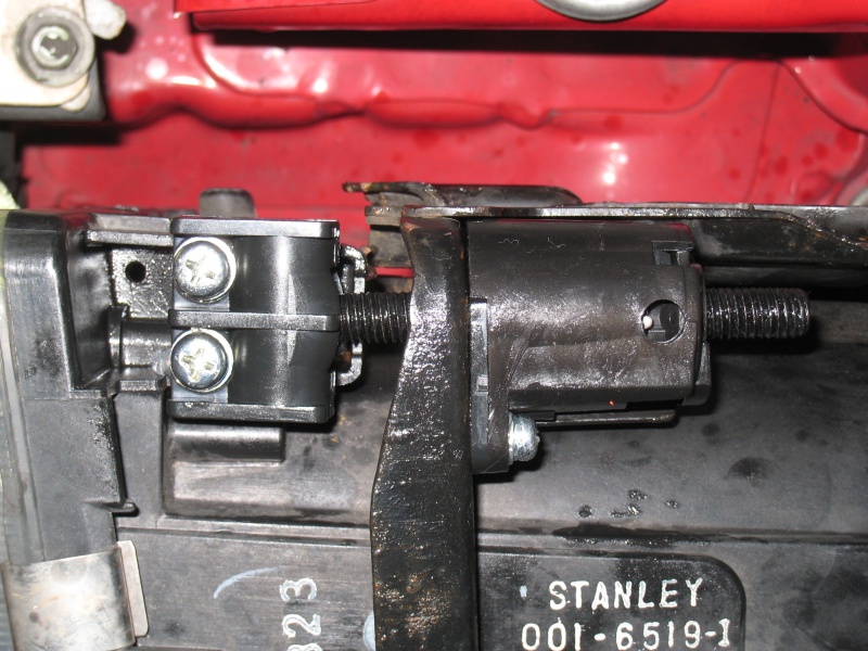

The original pedal assembly. Type-R on the top and standard one at the bottom.
Both pedals have exactly the same mounting shaft point and angle upto the spring holder. Below that point, Type-R one has different angle and puts the pedal closer to the bulkhead.
Attachment 7560 Attachment 7561

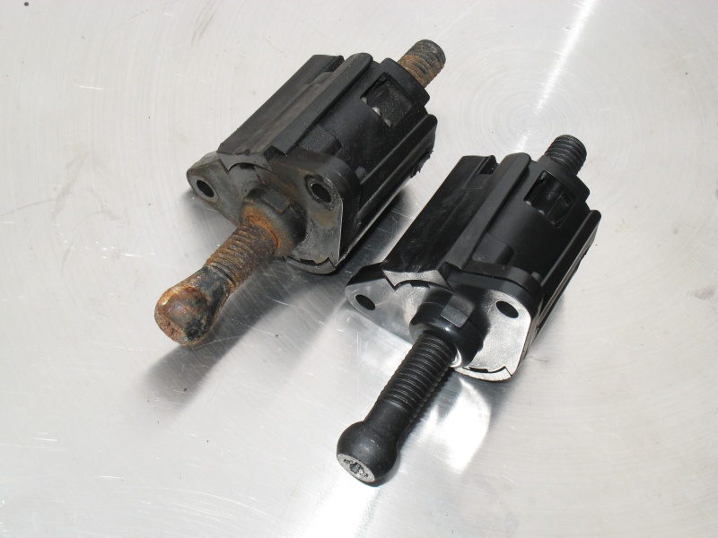

The damper less joint. My master cut the original joint in the past and it was using metal diaphragm to act as the damper.
Attachment 7559
New joint installed.
Nothing new to me and exactly the expected result.
You will get extra feeling through the pedal on the movement of friction discs and release bearing, clutch folk, etc. This is probably one of the reason why Honda placed the damper on the original model as for most of the owners, it is a strange feeling through the pedal.
For me, the clutch bite point is now where it should have been from the beginning. Much closer to the bulkhead and easier to move the foot from the footrest to the pedal.
As my clutch is getting close to the end of its life, it was quite difficult to perform quick up-shift at high rpm with original pedal without any slip but with this new pedal, it's much better.
