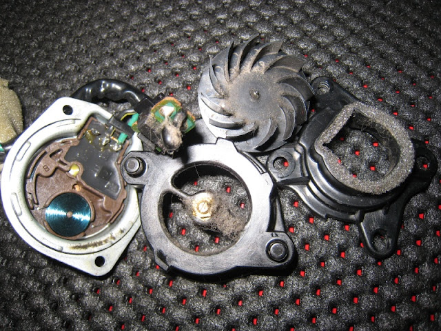

the owner wanted to have the cabin temperature sensor cleaned so
done that as well.
It was making lots of noise due to the debris trapped inside the spindle shaft.
