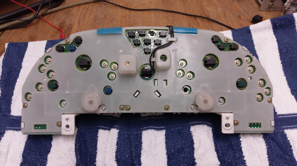

JDM 1997 AT Cluster
All bulbs can be replaced without disassembling the cluster, except the AT indicators. Simply turn the socket and pull them straight out of the PCB. Note that some bulb locations might not be populated and that blue sockets are of different brightness than black sockets but otherwise exchangeable. It's therefore advised to take notes or pictures before removing more than one bulb.

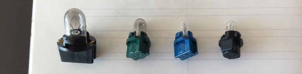

Bulb Types
Five different bulbs are used across the clusters. Four of them being wedge-based, following this classification:
  • Diameter: 10 mm → T10
  • Thickness of the base: 2.1 mm → W2.1 ('W' is for wedge)
  • Width of the base: 9.5 mm → x9.5d ('d' is for dual - two wires)
  • Result: T10 W2.1 x 9.5d (wattage and voltage to be added)
Large (Illumination)
Green (Illumination) Blue (Indicator) Black (Indicator) Gear (Indicator)
Honda Part Number 37237-SA5-003 (lamp only)
37102-SA5-003 (incl. holder)
37103-SL0-003 (incl. holder) 37102-S84-003 (incl. holder) 35505-SA5-003 (incl. holder) 78181-SF1-612 (incl. holder)
Diameter 10 mm 6.5 mm 5 mm 5 mm 4.2 mm
Wattage 3.4 W 3.0 W 2.0 W 1.4 W 1.0 W
Classification T10 W2.1 x 9.5d T6.5 W2 x 5d T5 W2 x 4.6d T5 W2 x 4.6d T4.2
The green holder illumination bulb is a little exotic having a quite high wattage for a 6.5 mm design. As a result, the holder tends to become brittle due to excessive heat and should be replaced together with the bulb.
