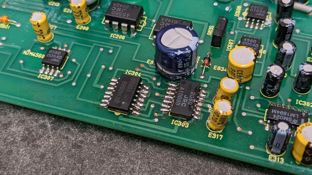

  2. Radio Head Unit - Repair II
    .. continuation of Radio - Repair
    Too little Volume and Distortions increasing with Volume
    Observed on: 1 EUDM Radio
    Fixed by: OP amp replacement
    State: Fully understood
    The audio signal path on these radios is fully analogue with several operational amplifiers at various stages. One of them is IC303, a 20 V, 10 MHz quad operational amplifier from JRC/NJM: NJM2060M.
    IC303 at the rear end of the lower PCB
    Updated 12-07-2023 at 09:28 PM by Heineken
