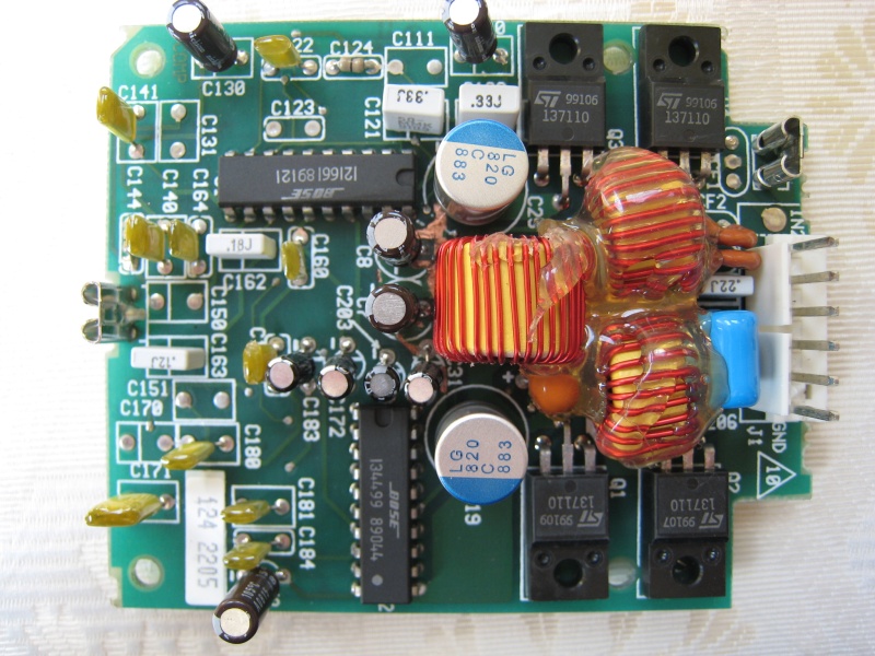

    The owner sent one of his amplifier to investigate his audio system status.

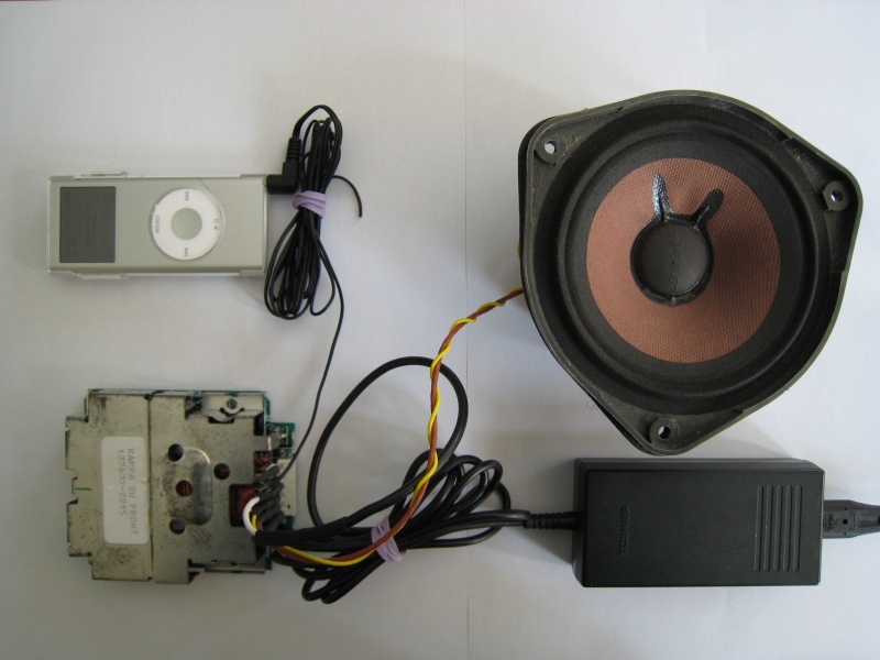

    On the bench system, it sounded fine but as in the past, you never know the real status until you open it up...

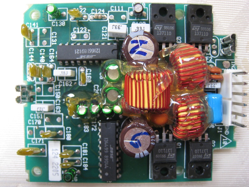

    So, I started to remove the capacitors and this is what I found.

    Even it sounded fine on the bench, the damage was already there… The owner was very lucky that the leakage didn’t damage the two ICs that are Bose in-house model and not being sold as spare parts on the market. I only have limited spares.

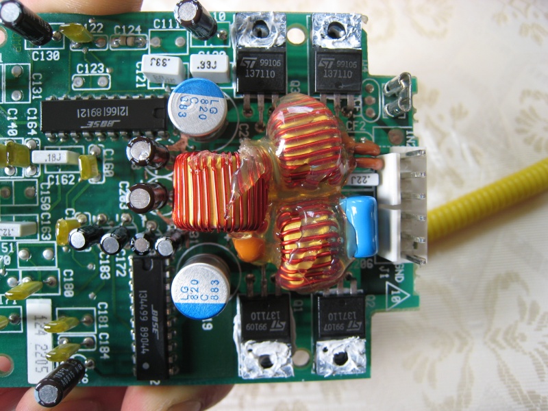

    The four FETs were still not damaged so just replaced all of the problematic capacitors.

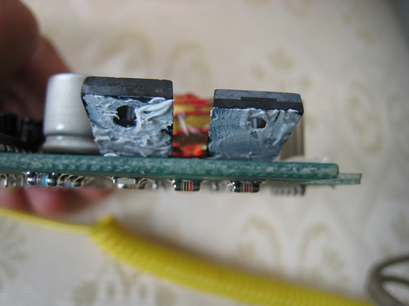

    As an extra touch, I applied heat transfer compound on both side of FETs to maximise the effect of heatsink.
