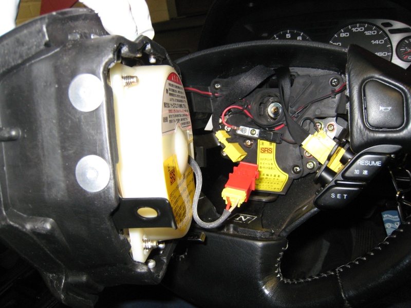

    3. Removing the SRS module

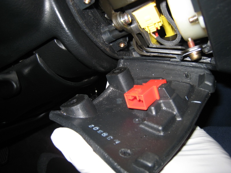

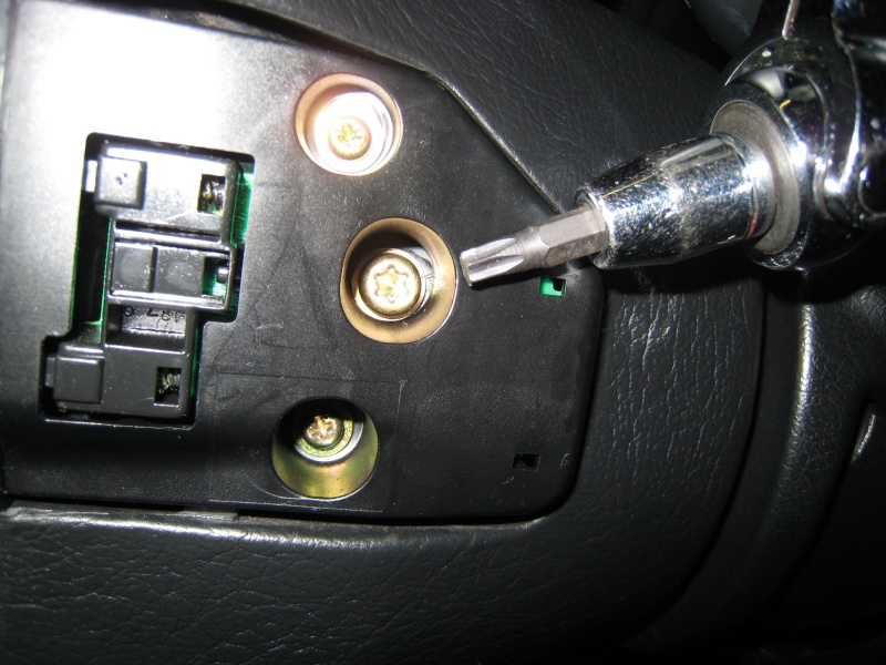

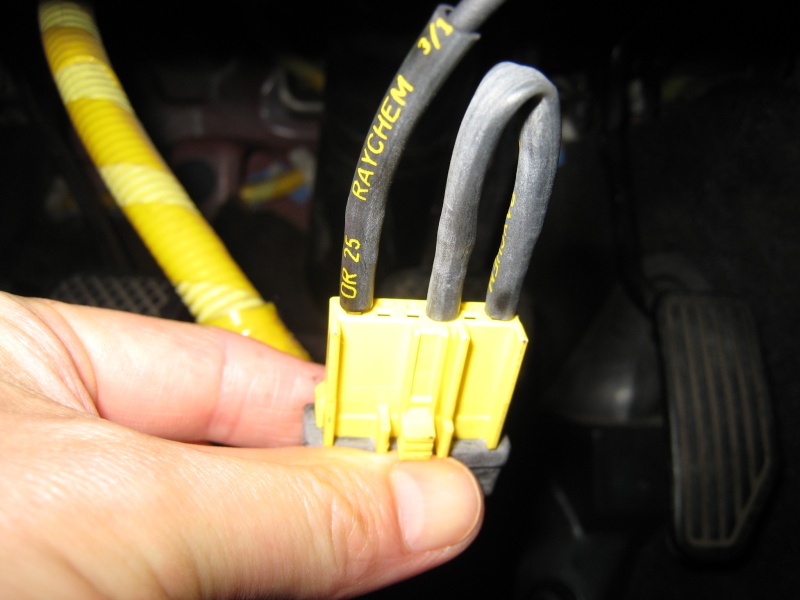

    There are three TRX Star screws to be removed. Two on the left and one on the right side under the cover. You may be able to see on the photo that red thread lock being used on these screws so be careful not to damage the screw head when removing them.

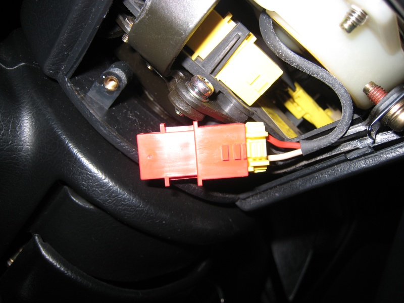

    Take off the left side cover first and remove the RED connector from it.
    Immediately, insert this Red connector to the SRS module connector as in the photo. This is to avoid accidental trigger of SRS by static current.

    Now move to the right side cover behind the cruise control set/resume switch.
    Just remove the middle screw which is the only TRX one on this side.
    Now you can take out the SRS module like this.

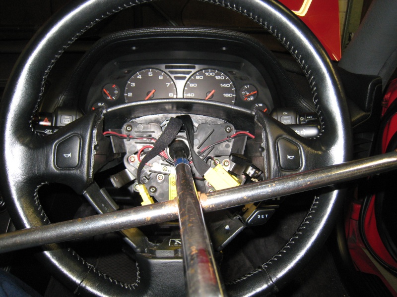

    4. Removing the steering wheel
    Disconnect the horn connector (centre, black one) and cruise control switch connector (right, yellow).
    Remove the SRS connector (left, yellow) from its holder.
    Ask someone to hold the steering wheel or use the impact wrench to loosen the self-lock nut at the centre of the steering wheel.
ID:	5428 Click image for larger version.
    Unlike other production cars, NSX is NOT using the tapered spline so the steering wheel will just slides off from the shaft.
    During this process, please do not apply any side/forward/backward force to the steering column. There is a crushable structure that allows the entire column to move forward in case of big accident. This structure could be partially damaged if you are not careful and results in entire column moving side way (left – right) with little effort. This is a quite common issue among the owners who tend to grab on the steering wheel on getting in/out of their NSX.

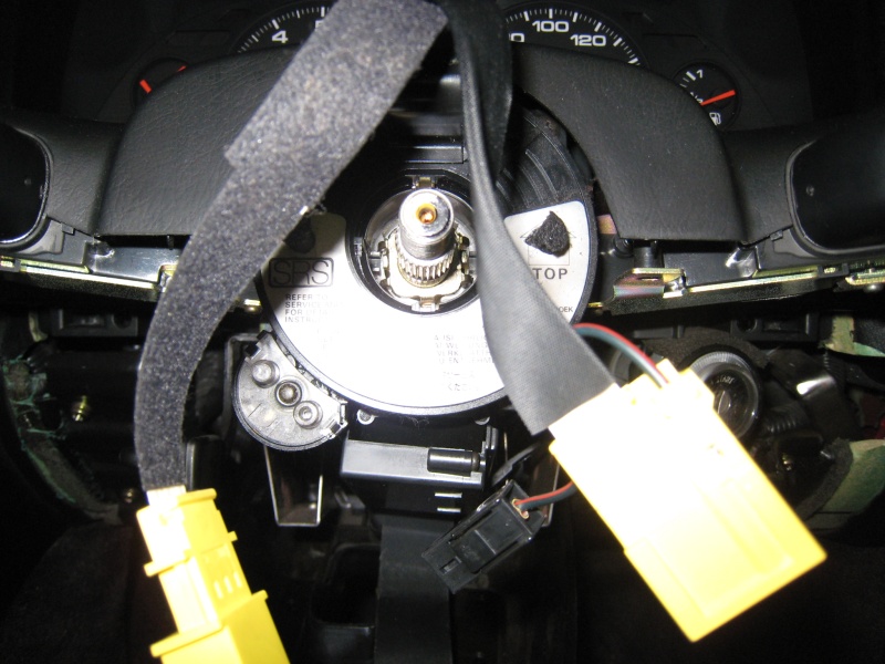

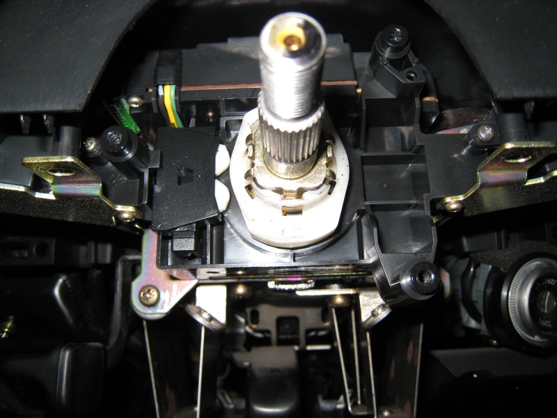

    7. Remove the cable reel by carefully removing the screws behind the face of upper cover.
    8. Keep the turn signal canceller sleeve in this position. When you fit the Type-R steering boss, these 2 metal projections will slide into the slit at the back of the boss.
ID:	5427 Click image for larger version.

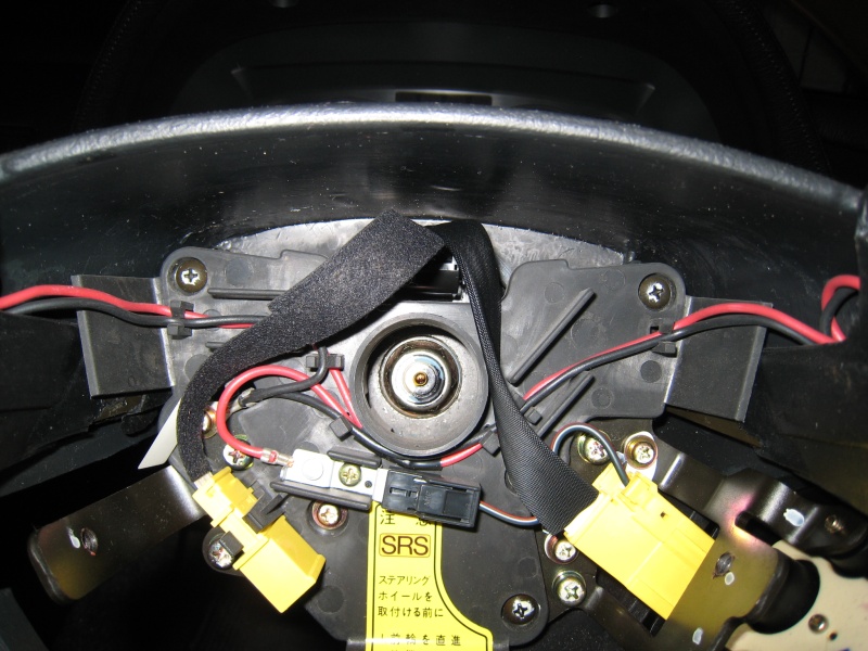

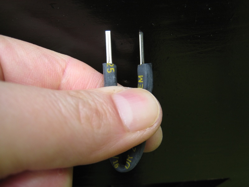

    9. On SRS steering wheel, the horn switches on both sides and the cruise control set/resume switches were connected through the cable reel. As we removed the cable reel, we need to create the connection to the contact plate at the base of the steering boss for the horn circuit. I'll leave the cruise control for the time being.
    First, prepare 2 kinds of cables like these. Short one is to disable the SRS warning light and the other one is for the horn circuit. These cables will be inserted into the yellow mating connector where the cable reel was originally connected.
ID:	5430 Click image for larger version.
    The length will depend on the routing of the cable.
    The yellow connector is from JAE so I was lucky enough to have the exact mating pins.
    The other end of the longer cable will be connected to the hand made metal part described below so attached the ring terminal.
    Please insert the cables as the photo below.
    Please note the orientation of the connector by looking at the position of the connector lock.
    If we count the pin no. from left to right on this photo, insert the long cable at #1 and short cable at pin #4 & 6.
    Use self adhesive tape to keep these pins in place.

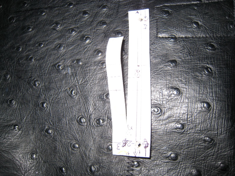

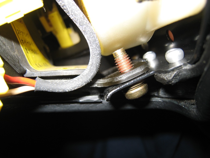

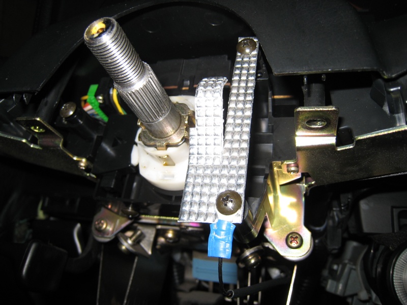

    10. Now we need to create something to establish the connection to the contact plate at the base of boss.
    For this, I used the cardboard from the cereal box to use it as a template.
    (I think our member Sudesh used great idea to create this circuit and he posted it on Prime in the past.)

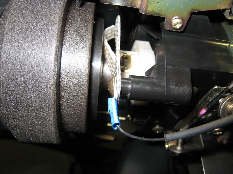

    Based on the cardboard template, I cut out the aluminium sheet and placed it like this. I used the two fixing screws originally designed to hold the cable reel.
    Make sure that this hand made part doesn’t touch any of the metal part other than the contact plate at the boss. Otherwise, your horn will be continuously triggered when you re-connect the battery.
    Route the long cable that was placed at pin #1 of the yellow connector above and connect the ring terminal to the hand made metal sheet with the screw as in the photo.
ID:	5434 Click image for larger version.

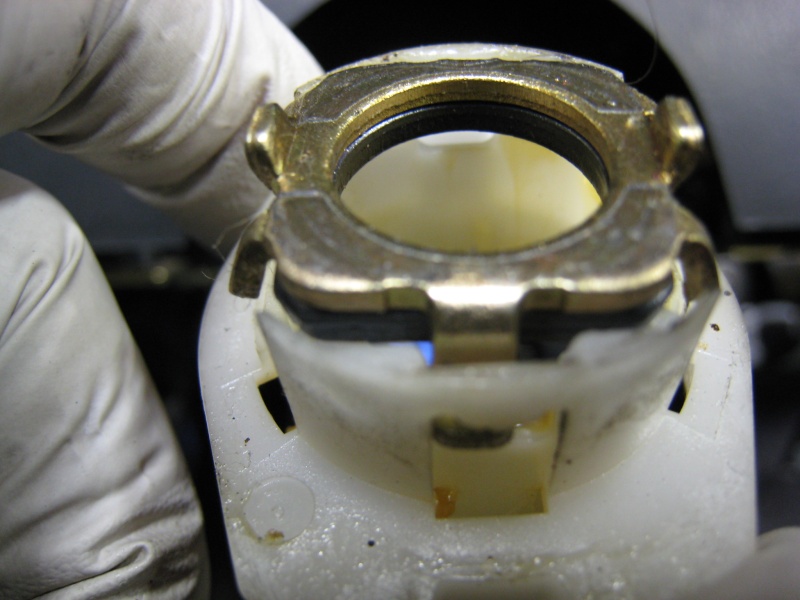

    11. Apply good quality grease at the contact plate of the boss. This is very important as after several years, it will start to make some noise every time when you turn the steering wheel if the grease got dried out. For this reason, I didn’t use the ordinary conductive copper grease. Instead, I used race spec bearing grease. It’s not conductive so don’t apply too much.
    12. Regarding the tension of arch shaped metal sheet, you just need to play with it. Not too soft but not too hard against the contact plate. It will look like this when the boss was placed in place.

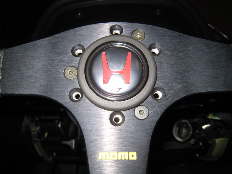

    13. Tighten the boss using the self-lock nut with torque wrench.
    14. Put the silver ring (for horn button contact plate) on top of the boss and then the steering wheel.
    15. Use three of the nine fixing holes to secure the steering wheel and push in the horn button. This button is very expensive so don’t damage it.
    16. Place the black ring over the horn button and use the remaining six fixing holes to tightly secure the steering wheel to the boss.

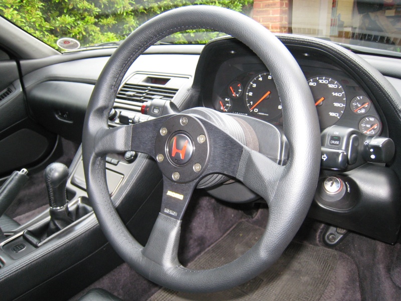

    17. Re-connect the battery cable and check the horn circuit.
    18. Once you are happy with it, put back several covers that you removed during the installation.
    19. As you removed the battery, you wiped out the study coefficient value of ECU. Go out for a drive and let the ECU to learn the state of engine again. Check for the centre of steering wheel and try the horn circuit again.
    20. Job done.

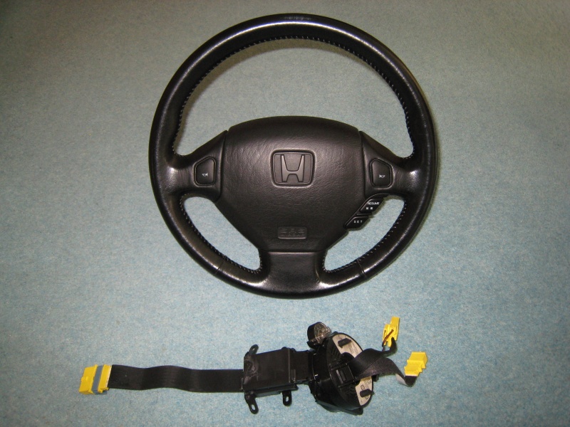

    Just for the record.
    The SRS steering wheel and cable reel weighed just over 5Kg. What a heavy wheel...
