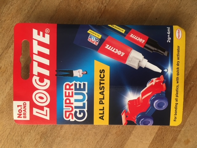

    Not related to windows but, repairing plastics (looking at you rear lights) if you need to glue things this stuff works.
    Most glues including superglues abhor PP and PE, this works; it’s 2 part with an accelerator and a glue and like most superglues it WILL stick gloves and fingers together.
