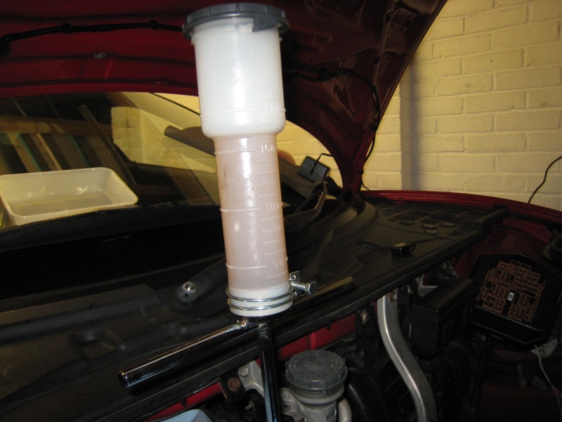

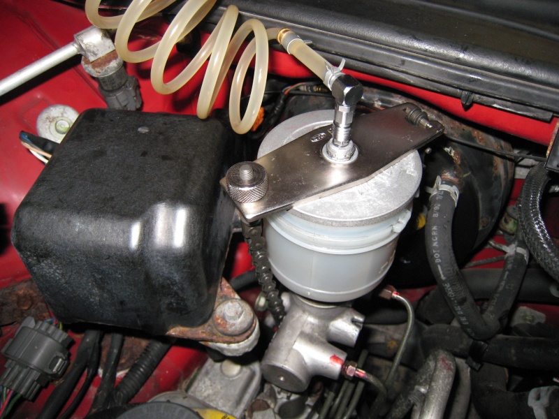

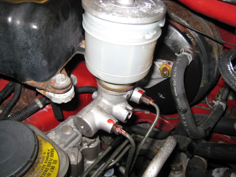

After bench bleeding the master cyl by tilting the cyl at specific angle, it is installed on the car. Pressure bleed the system, left it overnight for the leak check then test driving session followed by another pressure bleed and leak check.

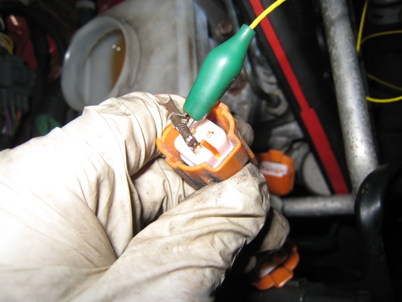

ABS flushing.
While driving this NSX at low speed with window opened, I noticed that the ABS pump was operating almost like every 10sec so I knew the solenoids are leaking or the accumulator bladder is not holding the right pressure.
Attachment 7975 Attachment 7978
Using ABS SST to release the high pressure fluid from the accumulator.
Flushed the system twice before moving onto the solenoids flush.
All four solenoids were not sticky and operated fine which is a good news.
Flushed the system again twice and waiting for the test driving session.
However, looking at the amount of high pressure fluid returned to the SST, as predicted, looks like we may have accumulator issue. As discussed, considering the usage of this NSX and condition of other ABS parts, it would be more cost effective to invest in the ABS upgrade than trying to replace the parts on this original system.

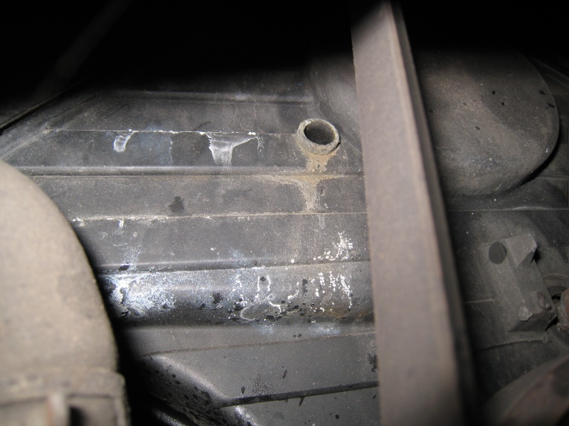

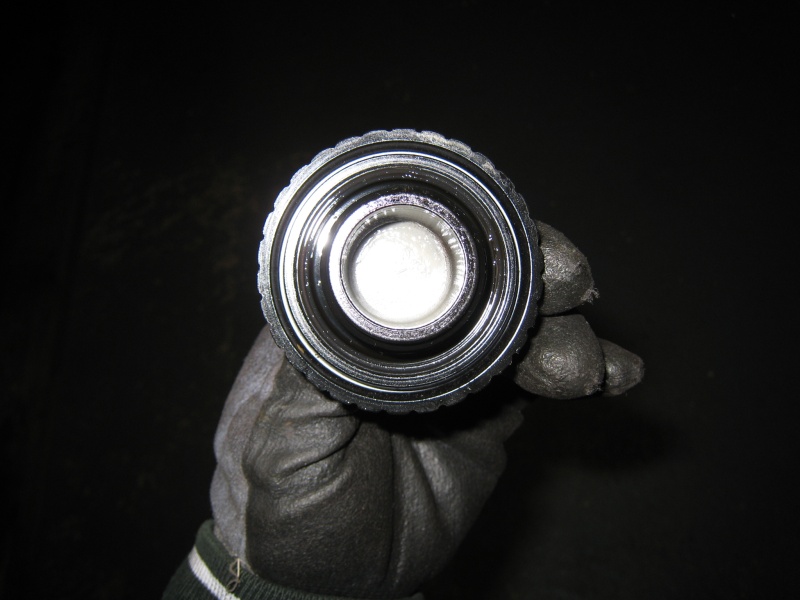

This NSX is mainly being used on busy road for short distance so I knew the amount of blowby gas would be significant.
Fortunately or unfortunately, the filler cap was not cleaned thoroughly and you can see the white residue behind the filler cap.
This is the moisture from the blowby gas.
Another reason to replace the engine oil regularly even for short annual mileage NSX.

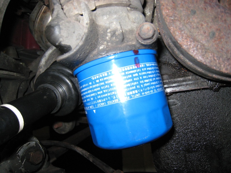

Attachment 7980

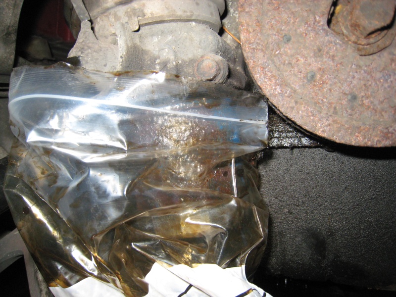

Removing the Eng Oil Filter.
To prevent eng oil from touching the suspension area and stiffener frame, I normally use plastic bag around the filter before removing it. Saves the time cleaning the area.
Attachment 7981 Attachment 7982 Attachment 7983

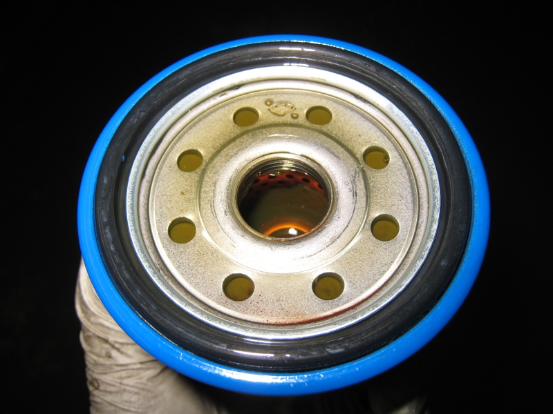

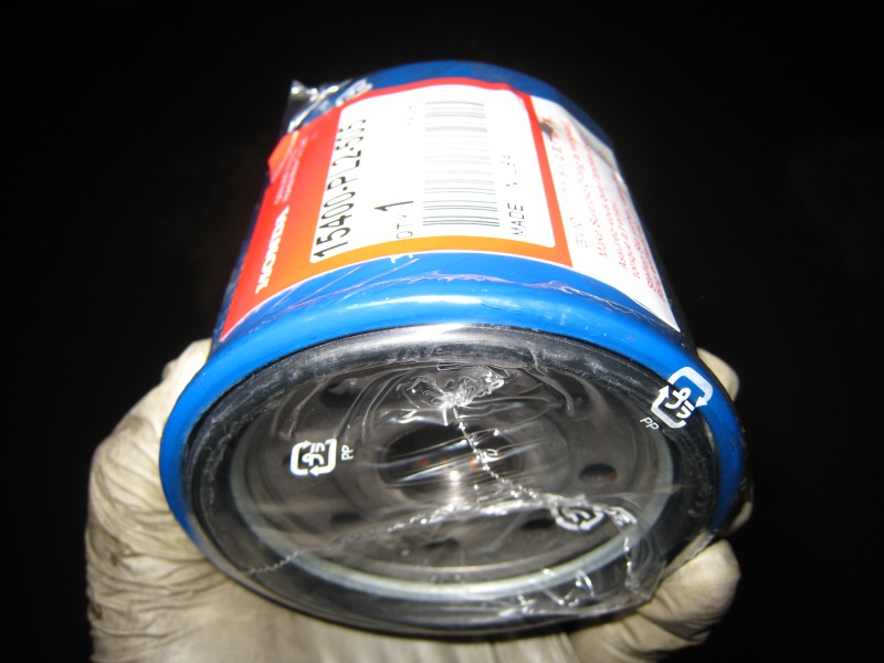

New OEM filter and probably bit too cautious but to keep the same procedure, I always fill it up with the new oil before installing it.
New filter installed. Don’t put too much torque as you will struggle to remove it next time.
You don’t need big torque once the gasket has seated properly.

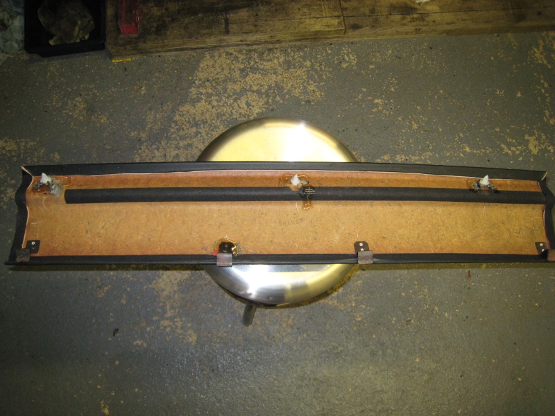

While waiting for the old engine oil to drain out from the oil pan as much as possible, decided to replace the Main Relay.

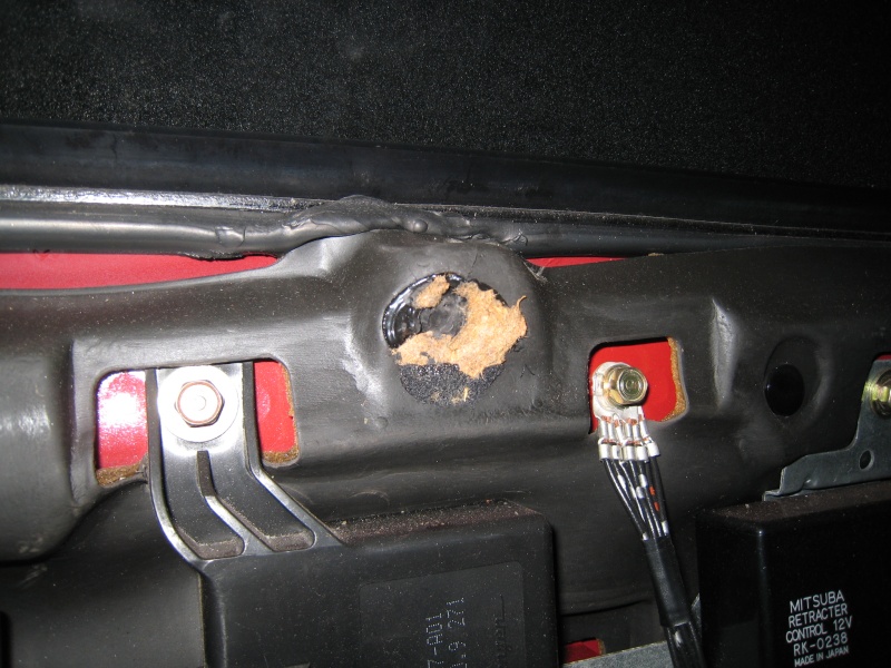

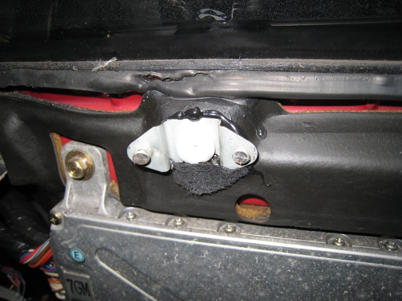

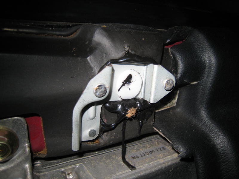

Normally, it is easy to remove the horizontal upper interior panel behind the seat as you only need to push down on it and remove the three fixings.
However, on this NSX, it turned into another challenge session due to someone decided to glue down the panel to the firewall. After some investigation, it became clear that the only way to remove the panel is to apply enough force to break the glue even if it may take out the brackets or even damage the panel.
So, phoned the owner, explained the situation and got authorisation for taking the risk.
Attachment 7984 Attachment 7985 Attachment 7986
Finally, the panel came off. The strange looking glue at the firewall. It was not even using the correct fixings/clips to glue the panel.
Need to re-plant the brackets back on the panel and use the proper clips for the instalaltion.

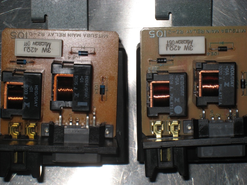

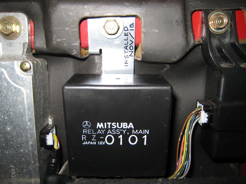

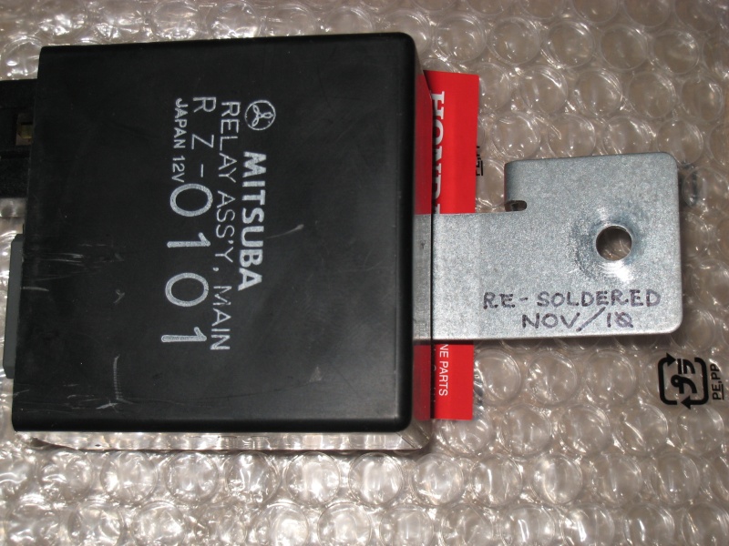

The original main relay.
Although it didn’t show any issues, it was from week 33 & 35 of 1990.
New one is from week 18 & 20 of 2010.

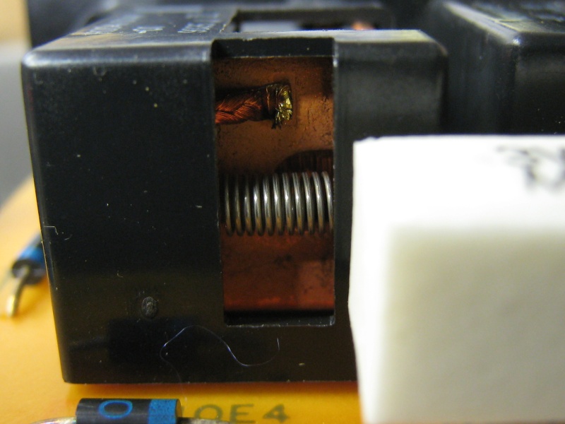

4 Attachment(s)
Attachment 7992 Attachment 7991 Attachment 7990
As in my old post, the original relay was using the old design with the spring whereas the new one is using the mechanical plate.
New one installed.
Attachment 7989

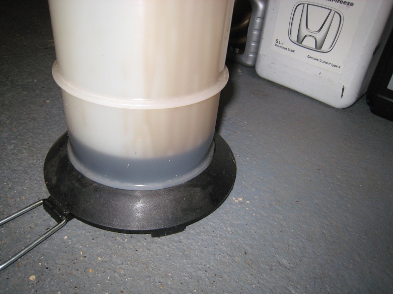

Back to the engine oil.
Managed to extract further 300 – 400cc from the top.

Re-soldered the original Main relay, applied conformal coating and it will be returned to the owner to be used as an emergency spare.
Fortunately, I had the spare clips for the rear upper trim behind the seat and the brackets were repaired overnight so installed it back on the car.

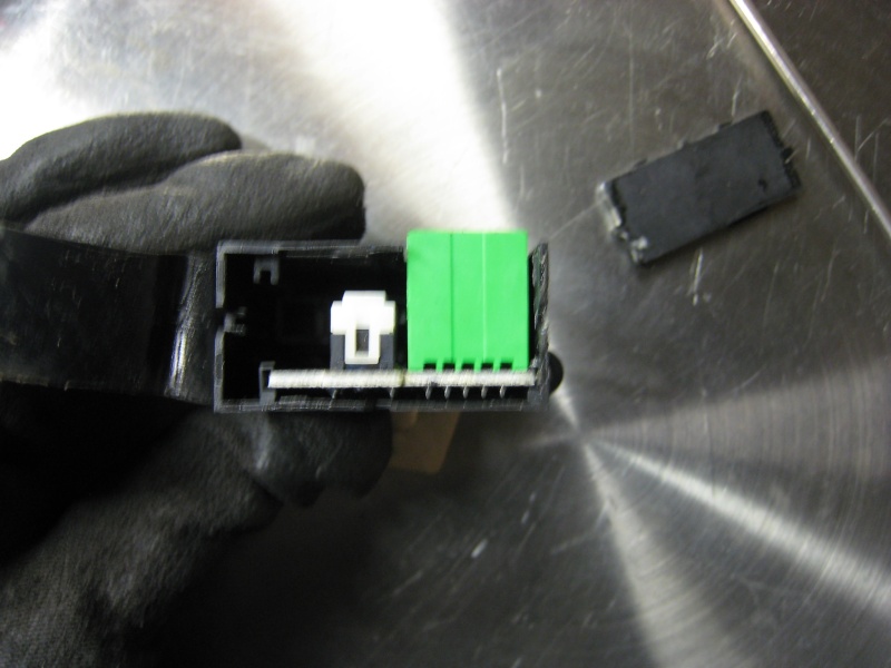

The owner mentioned that the TCS On/Off switch no longer shows the green light at the housing.
Attachment 7995 Attachment 7996 Attachment 7997
So, removed several panels to check the switch and it was clear that someone tried to do something in the past. There was a tape covering the switch housing.
The cause of the issue was someone pulling the connector plug without removing it first.
The receptacle connector on the circuit board was simply pulled away and there was not enough contact to the plug terminals.
This issue is quite common on other switches such as front/rear fog, headlight adjuster, etc located at the centre console.
When working on the centre console without disconnecting the connectors from these switches, you can easily pull the receptacle from the circuit board if you are not careful. Unfortunately, quite often, the switches will operate for a while until the vibration make enough gap at the terminals.
Pushed back the receptacle to where it should be, reassembled everything and now the green light at the switch is back and dash display now shows the ‘TCS OFF’ indicator properly.

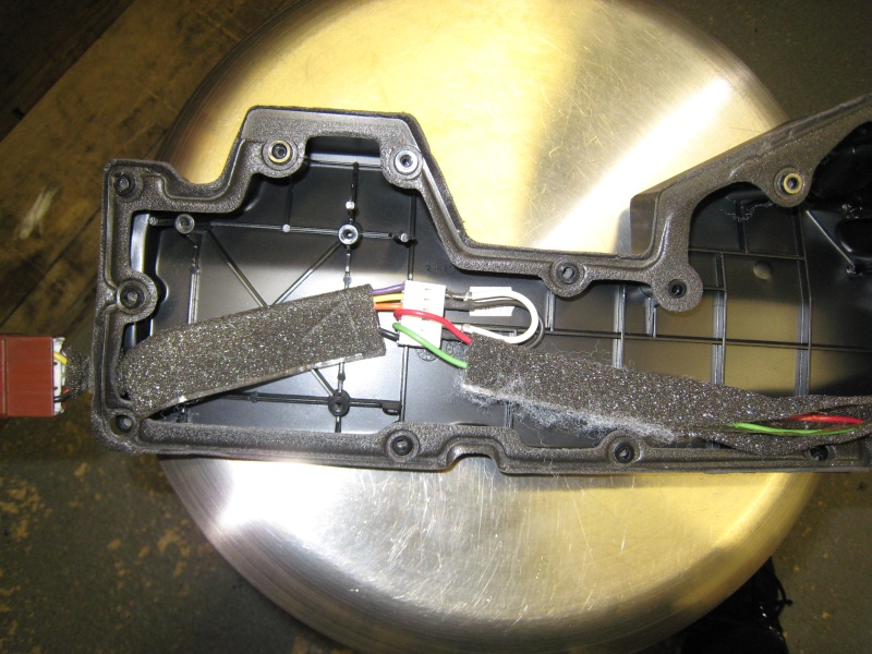

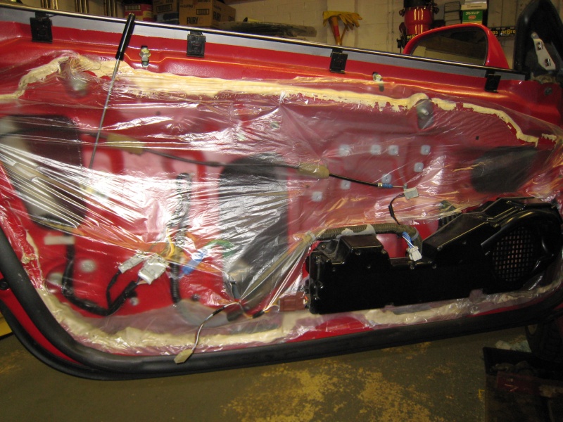

4 Attachment(s)
Attachment 8000 Attachment 8003 Attachment 8002
While removing the driver side door panel to access the Bose speaker AMP, I found the familiar sight of black glue at one of the door trim. Someone really loves this glue….
Also, there was a sign of glue at the panel behind the door handle as it was cracked.
One of the screw was not even tightened properly. Can’t remember whether the brass colour screw to be used here or at the forward side so need to check the parts list.
Attachment 8004
Looks like someone struggled to put back the clear sheet behind the door panel.

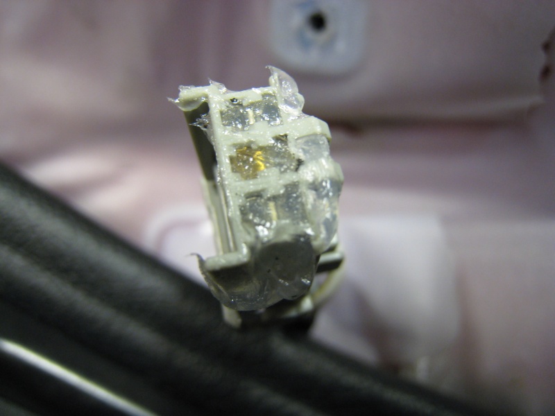

When I re-assembled everything at the RH door, I checked every switches and I noticed that the ‘Lock’ switch didn’t work.
Not sure whether it was working or not before I removed the door trim as it is possible that I may have damaged it when I disconnected the connector.

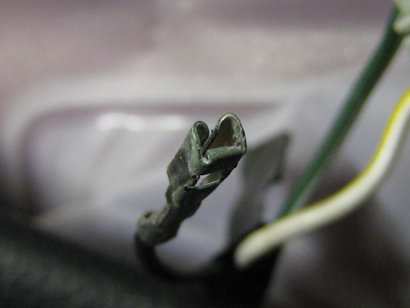

However, this is another common failure on our NSX when we deal with this specific connector. For some reason, Honda decided to use non water proof connector on this switch and because of this, the terminals just get corroded and break when we disconnect/connect it.
As expected, the middle terminal was showing green colour corrosion and internal part was broken.
Replaced the terminal with gold plated one, applied silicone grease and now it recovered the functionality.

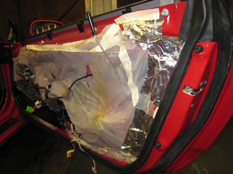

3 Attachment(s)

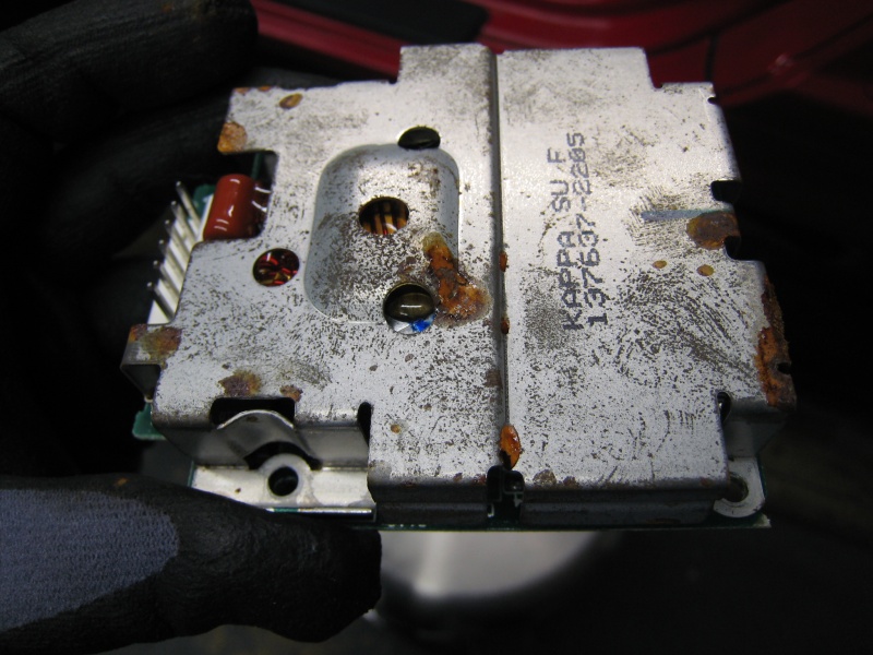

Left side door speaker AMP.
Attachment 8010 Attachment 8012 Attachment 8009

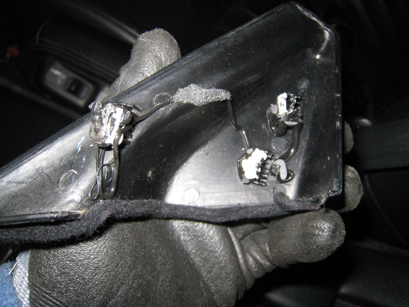

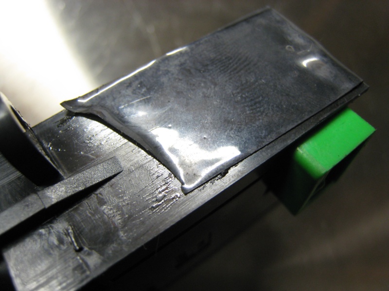

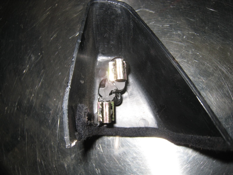

Once again, glue was used at the front sash to hold the triangle cover in place. These parts can be replaced at reasonable cost so not a big problem.
Someone decided to replace the entire plastic sheet behind the door trim with clear one.
The leakage from the capacitor was quite severe and corroded the AMP metal cover acting as the heatsink.
It was replaced with the refurbished one that I provided the owner last year.
The passenger footwell speaker AMP was also replaced.
The + terminal at the footwell speaker was not connected so no wonder why there was no sound from there.
Now we have beautiful sound from all four speakers.

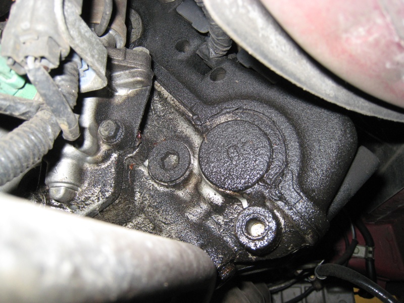

Quite common on our NSX, oil was leaking from the camshaft cap seal. When looked from different angle, there seemed to be no oil leakage from the VTEC spool valve seal on both banks so they are not going to be replaced this time. They can be replaced together with the filter at any time without removing other parts.
Looks like I'm going to spend long hours cleaning the engine again... Another reason why I prefer taking the engine out even just for the TB service...

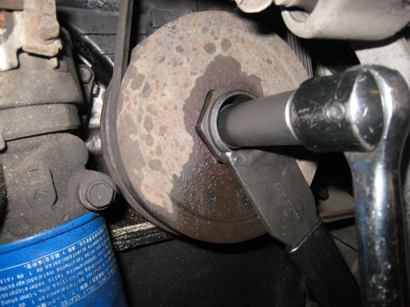

Initial check on the crank pulley bolt. The owner bought new one so it will be replaced anyway. The bolt was not greased properly during the last TB service so it required extra torque to loosen it but not too bad. There is no point in start removing parts for TB service if I can’t remove this bolt. If it’s too tight, just take your NSX to your local garage dealing with HGV. They normally have huge impact wrench with sub-tank attached to it. They can loosen it for you.
Greased it properly and torqued it back to the spec for warming up the engine for the compression check.

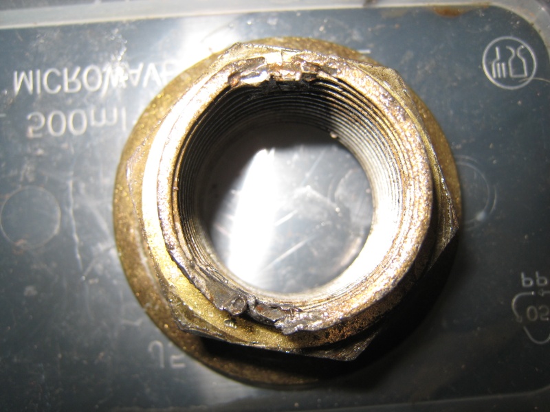

36mm spindle nut at the right side driveshaft.
Seems like someone worked in this area in the past as there was a sign that the spindle nut was re-used.
Each driveshaft service kit includes new spindle nut so it will be replaced with the new one.
I have lots of spare spindle nuts any way. If you need one, you can have it for free if you can collect it from my place.
By the way, as same as the crank pulley bolt, if you have problem removing this nut, take it to HGV garage and ask them to loosen it for you with their sub-tank assisted huge impact wrench.
