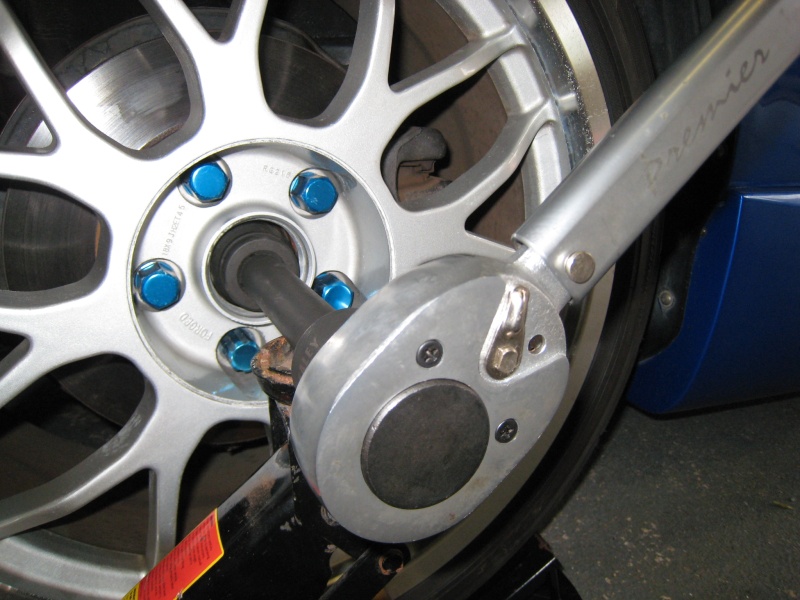

You will need to loosen the spindle nut holding the driveshaft to the hub.
If it was never removed in the past, you will really going to struggle. There are several techniques to loosen it if it is very tight.
I use 36mm size 1’ impact socket, 1000mm breaker bar with the assist of floor jack while applying full body weight.
In the worst case scenario, I will take the NSX to local HGV garage where it has the huge impact wrench with sub-tank attached to it.

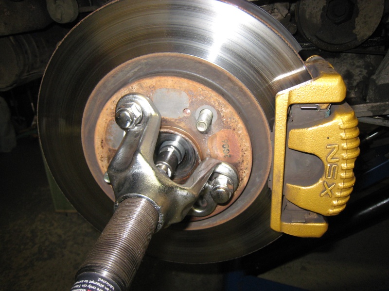

You may struggle to slide out the outer joint from the hub if it was never removed in the past. The spindle could get corroded and the outer joint may bond to the hub. If that is the case, you can use hydraulic puller to push it out.

As NSXGB mentioned, you need to get hold of the torque wrench which can cover 329Nm.
