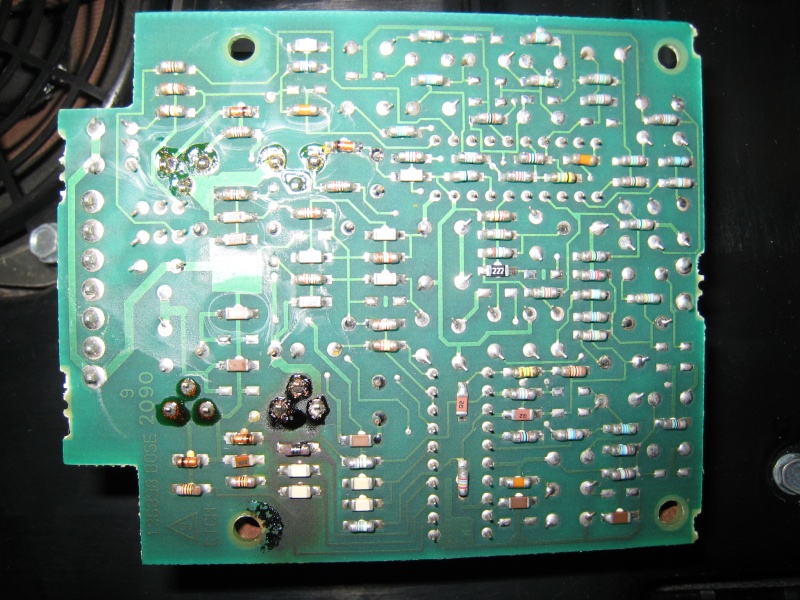

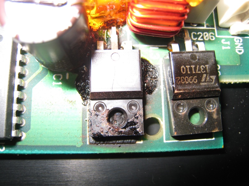

When I opened the speaker box, immediately I noticed strong smell of burnt circuit board. As seen on several Bose Amps in the past, one of the FET was burnt and damaged other surface mounted parts. Also, there was a trace of someone already worked on the circuit board previously.
Attachment 6426

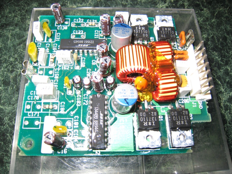

Instead of trying to repair the burnt board, decision was made to replace it with my refurbished spare Bose Rear Amp. So, the new amp was installed and the sound test was carried out.

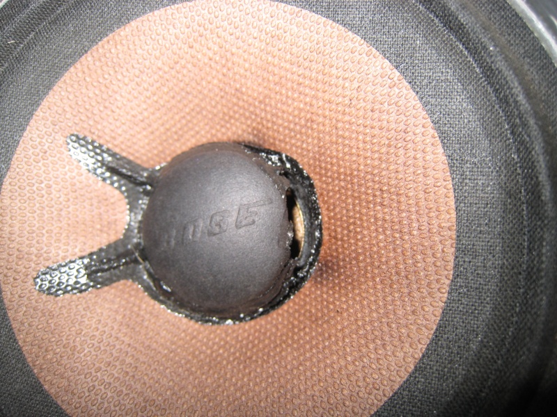

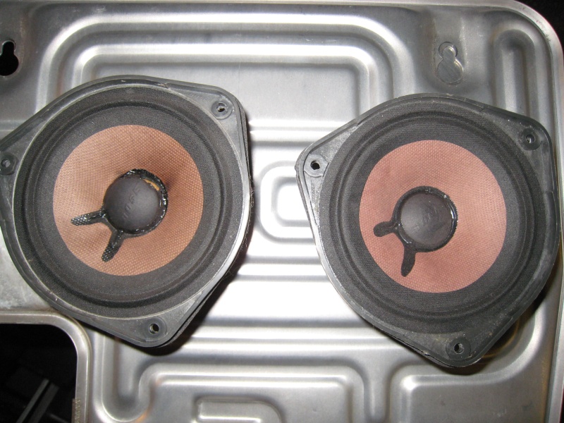

After some investigation, I found this….
Attachment 6425 Attachment 6427
There was a damage/burn on the actual speaker. I was already using spare Foot well speaker on my bench system which was provided from the member ‘mutley’ a while ago.
And with the support from another member ‘328’ who will be providing me with another spare Bose speakers, I managed to use my bench speaker to replace the broken one.
