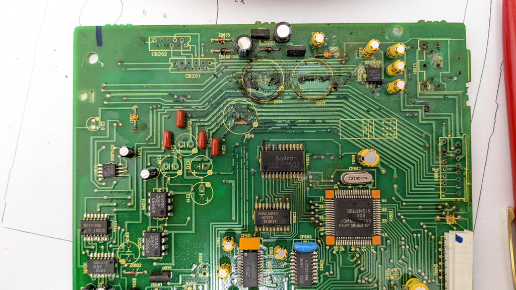

Usually the worst report. If acid damage from leaky capacitors manages to reach the proprietary Alpine CPU and cause damage there, not much can be done since these are no standard parts.
a badly damaged PCB that would not turn on

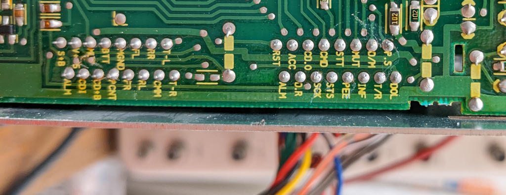

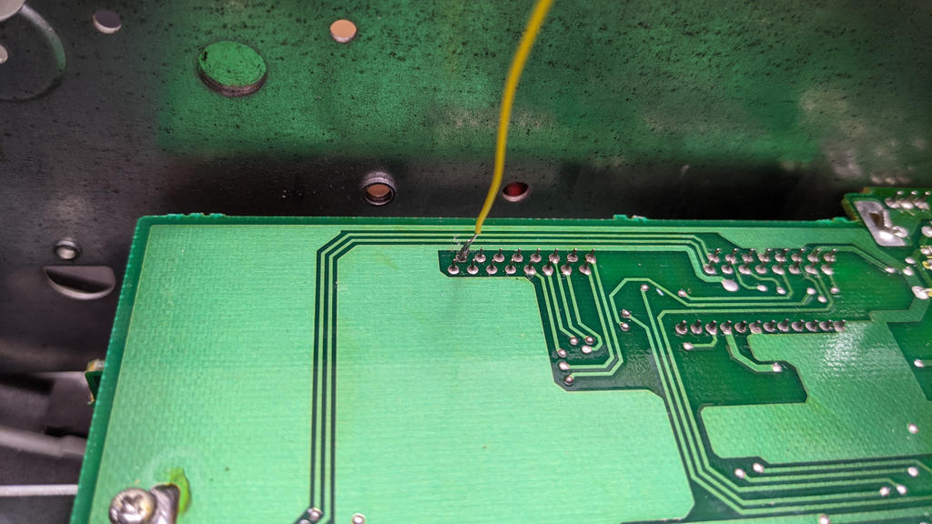

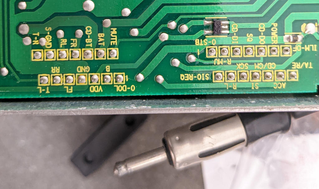

With power supplied to the radio (but radio turned off) and with the bottom part of the metal housing removed, check pin SCK at the right hand 16 pin (EUDM) or 14 pin (JDM) flex cable at the back of the radio (connecting the lower PCB to the middle PCB).

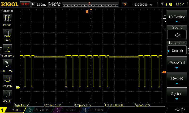

It should show groups of seven 5 V rectangle pulses, every 15 ms which indicates that the microcontroller on the middle PCB is alive and communicating:

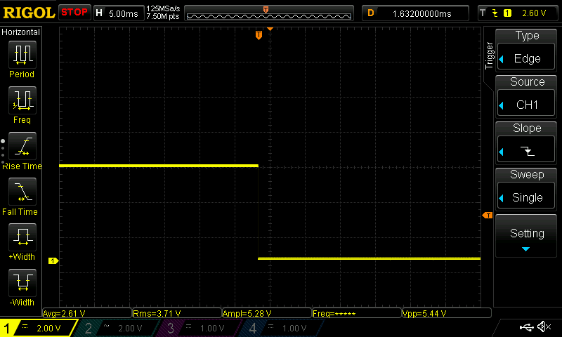

Correct signal when pressing ON/OFF

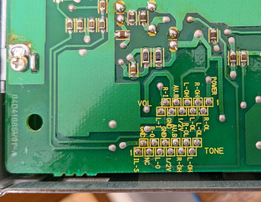

Now check the POWER pin (JDM) at the Volume knob flex cable connector (on EUDM radios, it's the same pin but unlabeled). It should behave the exact same way as the pin at the 14/16 pin flex cables.
Pins (JDM)
The two pins previously checked are electrically connected. Measuring the resistance between them should yield a value of <1 Ω. A higher value indicates a broken trace or VIA on the PCB. Often it's the lowermost line from the volume knob flex cable connector to the first VIA:

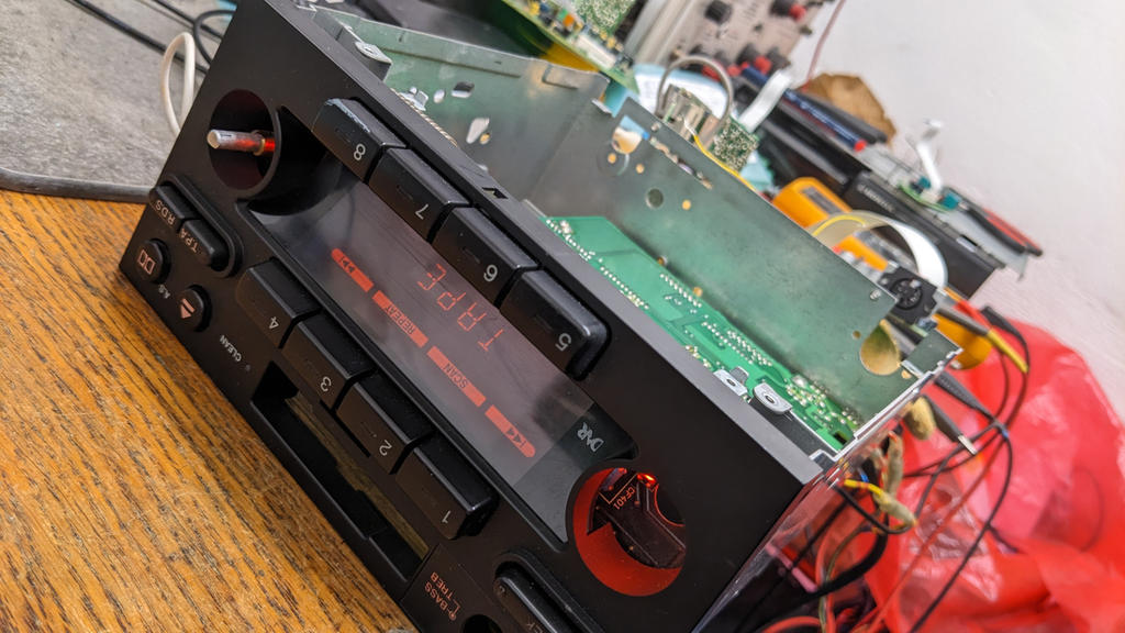

Radio doesn't turn on II
Observed on: 1 EUDM Radio
Fixed by: -not fixable-
Status fully understood
If the repair under "Radios does not turn on I" wasn't successful or not required, other reasons are possible. The middle PCB processor is responsible for controlling the display and the start-up procedure. He creates and monitors the ON/OFF signal that is routed to the lower PCB and to the ON/OFF button.
The middle PCB can be checked independent of the lower PCB. To do so, remove the lower PCB and the tape unit. Measure the top left pin of the left flex cable connector to ground. It should measure 5 V.
This pin is the ON/OFF (P.S pin) signal mentioned under "Radio does not turn on I". When briefly connected to GND, the middle PCB starts up and illuminates the display with the TAPE message (or 78.5 MHz if a tape unit is installed). Connecting the pin to GND a second time will switch-off the middle PCB - identical to the Power ON/OFF button.
If the display is not lighting up, the middle PCB is damaged. During "Radio does not start up I" we checked the SCK pin on the lower PCB and the 5 V on the power signal which confirms, that the middle PCB processor is generally working.
When manually turning on the middle PCB (via the ON/OFF signal), pin 6 of the middle PCB processor needs to rise - it switches the display power supply. If this pin does not rise, the processor pin is considered broken and a middle PCB replacement required.
