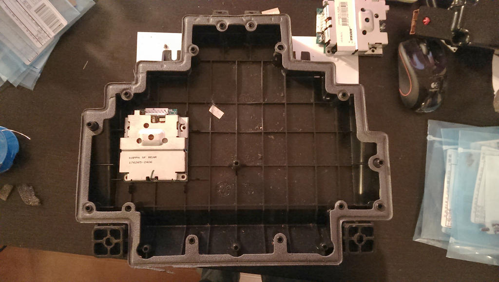

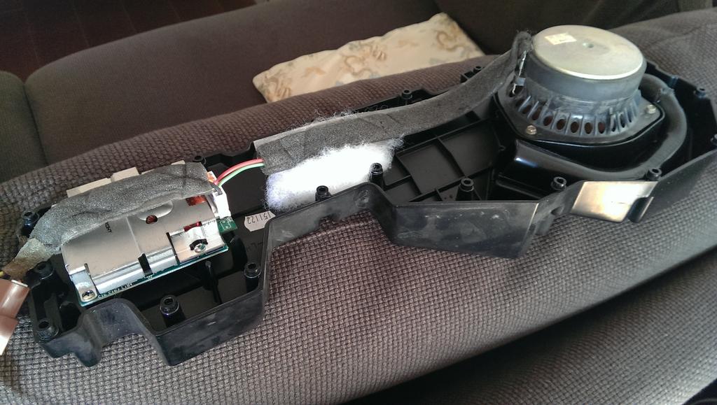

To remove the speakers from the car, please refer to the service manual or the instructions provided on nsxe-repair.com. The amplifier modules can be unscrewed and removed from the case for all upcoming steps. To get access to the PCB, simply pull-off the cover.

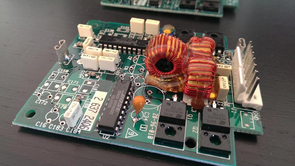

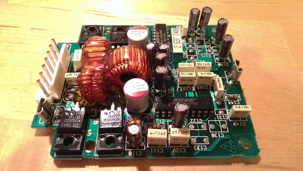

Before removal of any capacitors create a drawing with location, capacitance, diameter, height and solder point distance (RM). Replacement types should be regular electrolytic capacitors for the small diameter ones as these are potentially carrying audio signals and should therefore not be replaced with dry Polymer-Aluminium capacitors . The large ones are used for voltage smoothing and can be safely replaced with Polymer-Aluminium ones.
Specification Suggested Replacement
820 μF, 16 V, ↥ 15 mm, ⌀ 13 mm, RM 5 mm Nichicon RNE1C821MDN1PH, 2000 h @ 105 °C, 14 mm, 10 mm, RM 5 mm
47 μF, 16 V, ↥ <15 mm, ⌀ 6 mm, RM 5 mm Nichicon UPW1C470MDD, 2000 h @ 105 °C, 11 mm, 5 mm, RM 2 mm
22 μF, 16 V, ↥ <15 mm, ⌀ 6 mm, RM 5 mm Nichicon UPW1C220MDD, 2000 h @ 105 °C, 11 mm, 5 mm, RM 2 mm
10 μF, 16 V, ↥ <15 mm, ⌀ 6 mm, RM 5 mm Nichicon UPW1C100MDD, 2000 h @ 105 °C, 11 mm, 5 mm, RM 2 mm
1 μF, 50 V, ↥ <15 mm, ⌀ 5 mm, RM 5 mm Nichicon UPW1H010MDD, 2000 h @ 105 °C, 11 mm, 5 mm, RM 2 mm
Above list of specifications might not be complete, please check your board before ordering. Any missing specification can be safely replaced by capacitors from Nichicon's UPW Series if enough space (height and diameter) is given at the corresponding location. Note that the maximum height (↥) of all capacitors on this board is 15 mm.

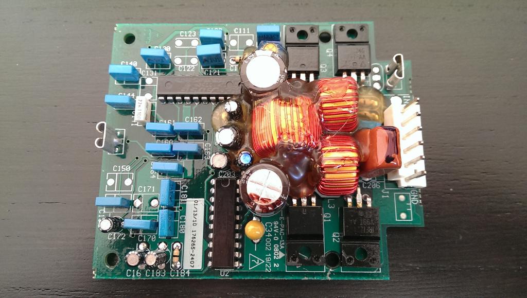

To be able to remove the large voltage supply smoothing capacitors, use a hair dryer and a pair of pliers to carefully pry away the hot-melt glue. It's sufficient to remove just enough to free the capacitors.
After removal of all capacitors, please refer to Climate Control Unit (CCU) - Capacitor Replacement, section "Repair" on how to detect damage to the PCB and properly repair it.
Replacing the capacitors on these PCBs is a relatively easy task as they do not contain large copper areas. A simple, fixed power electronics soldering iron (~30 W) should be sufficient. It's suggested to fully remove all of the old solder using de-soldering wick or a comparable tool before installing the replacements.
