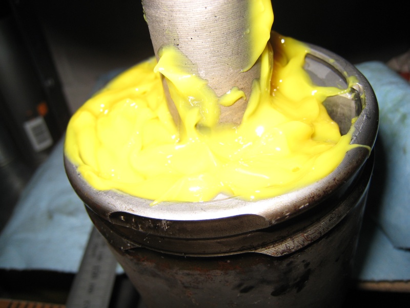

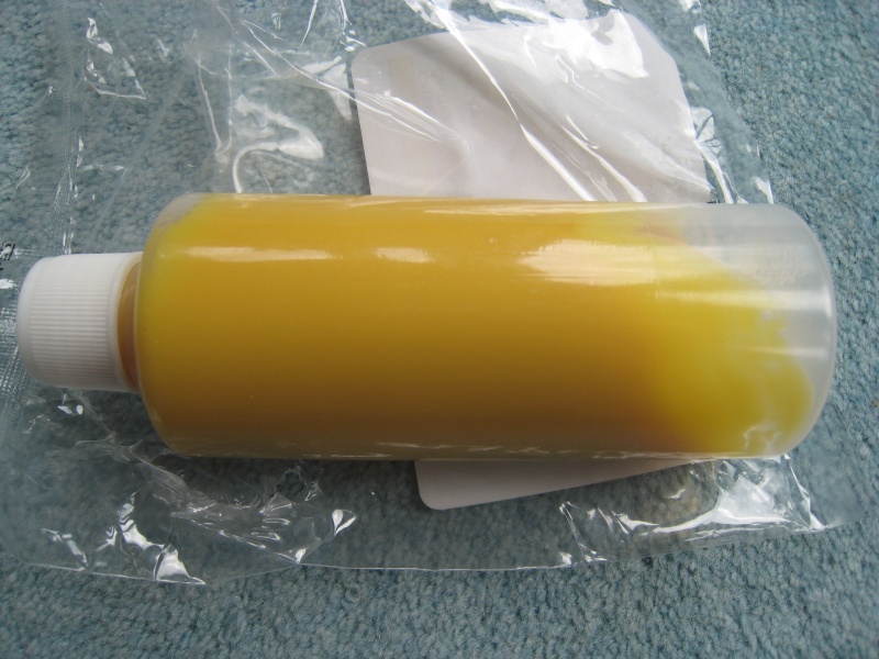

    When the grease is new, it looks like yellow/cream custard colour and very-very sticky. The grease will hold its original position inside the container even you place it up side down.

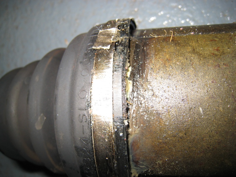

    Quite often, I found damage to the boot like this one or lots of grease splashed around the boot even there was no damage to the boot. The grease got leaked from the side of the boot.

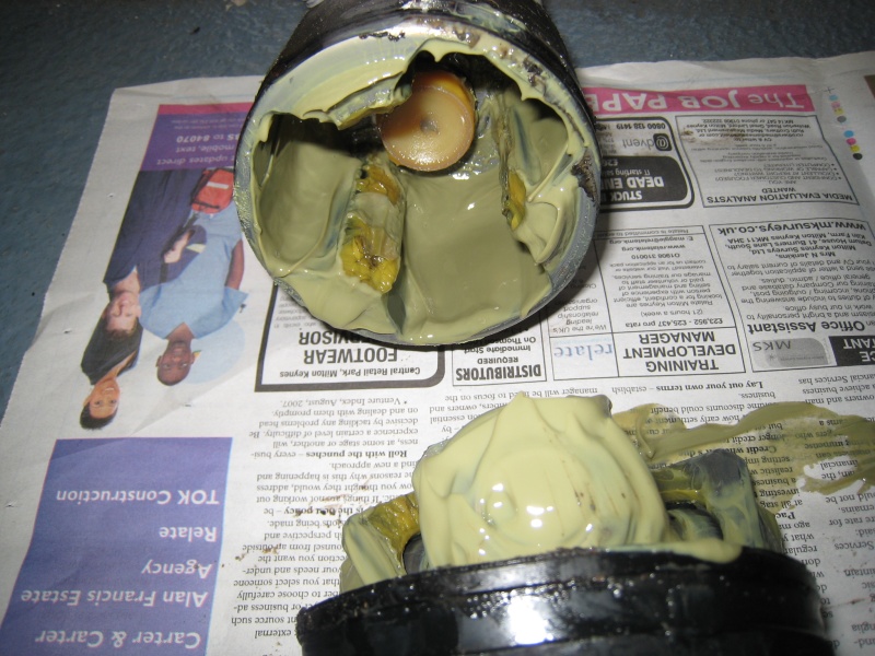

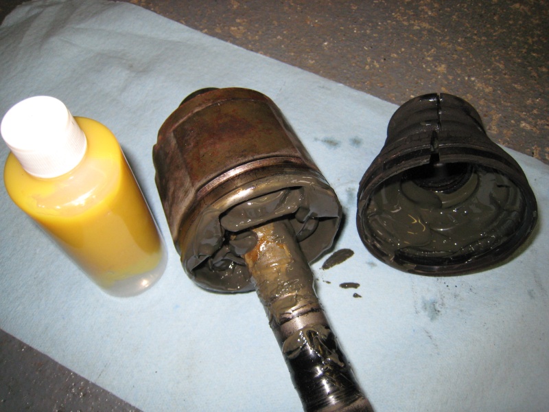

    Because of the damage to the boot, lots of debris, water, etc could get inside the boot and thus, degraded the quality of the grease. Also, the grease will be leaking to the outside world resulting in loss of lubricant capacity.

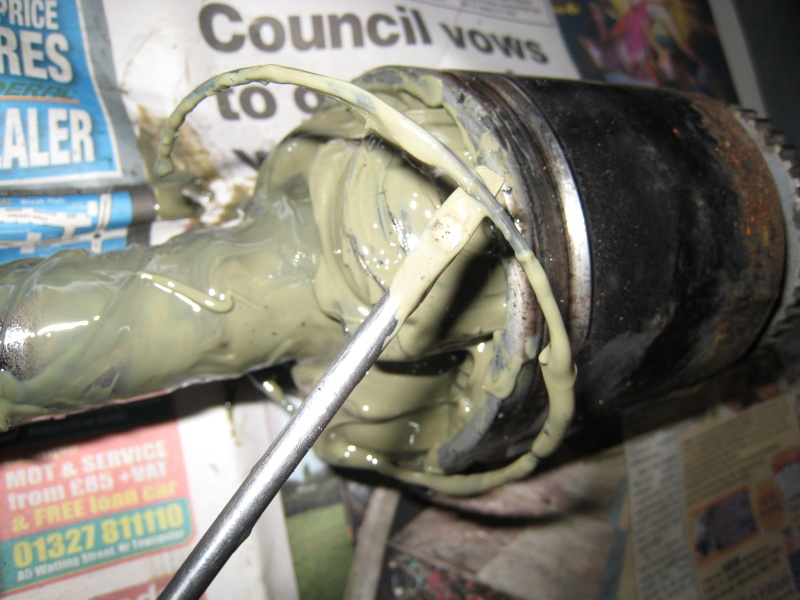

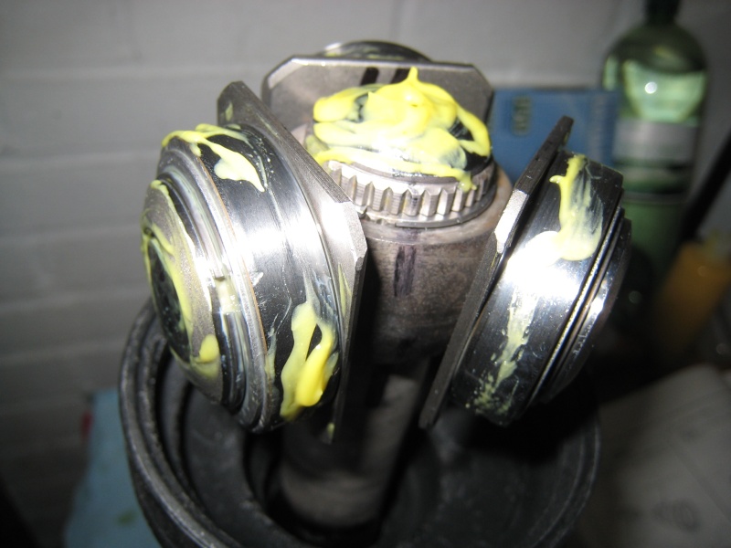

    If you ignored or didn’t notice the early sign of the damage/leakage, your grease will turn into very soft character and it would look like this. When you open the boot, some of the grease simply runs down like gravy or melted mocha ice cream…. Not a good sign as it has contaminated the grease inside the three rollers with lots of tiny roller bearing inside.
ID:	5648 Click image for larger version.

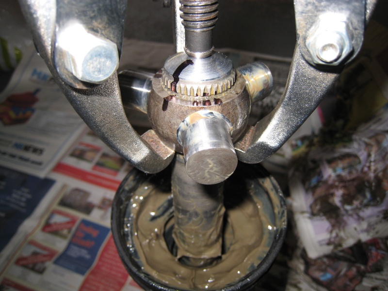

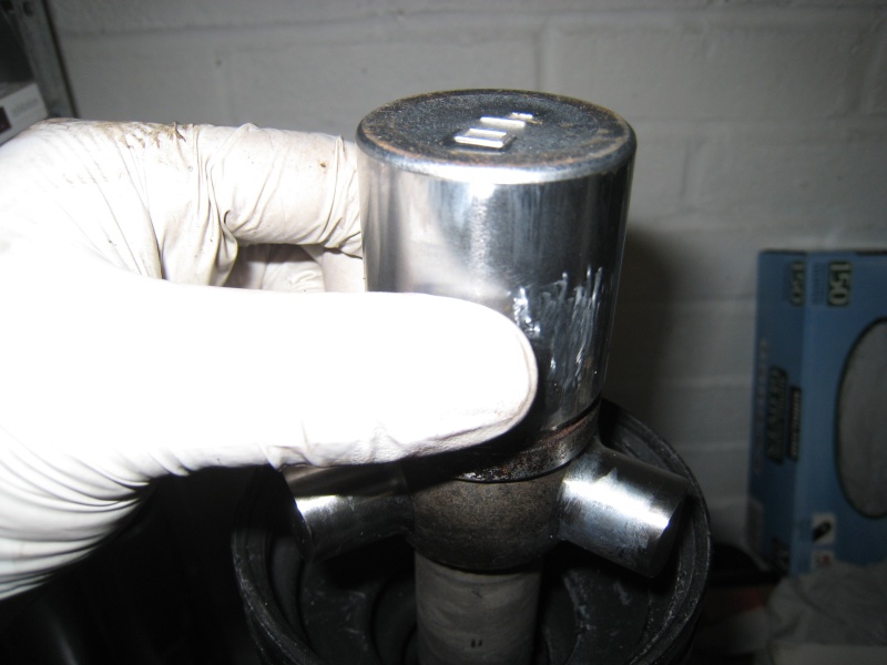

    Also, to remove the spider, normally you’ll need to use the standard puller tool.
    However, if the grease was not performing well, extra force would be applied to the spider resulting in loose fitment. Quite often, you can remove the spider with just the fingers without any tools.

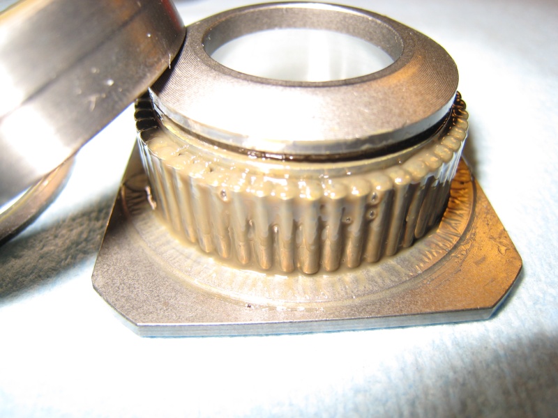

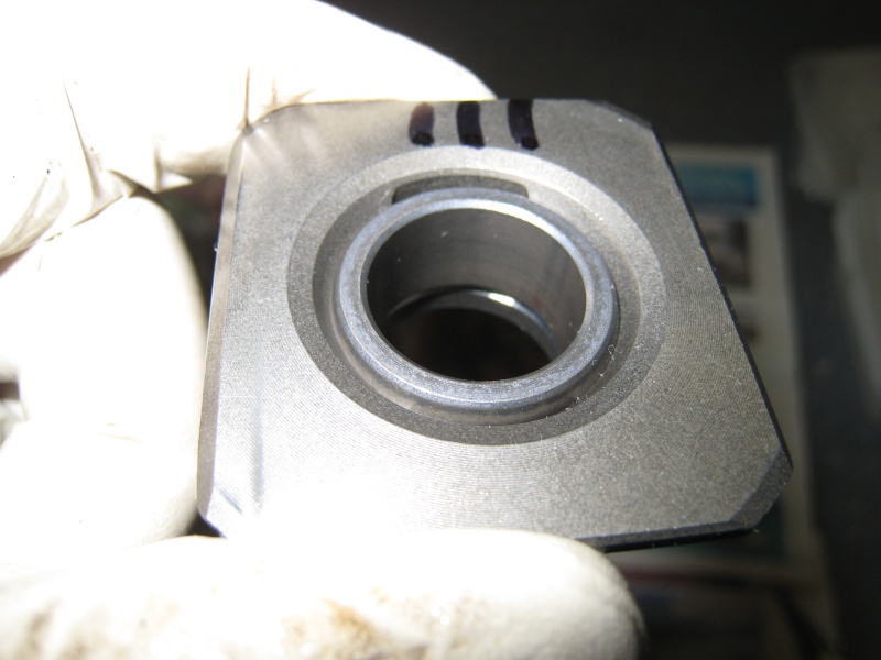

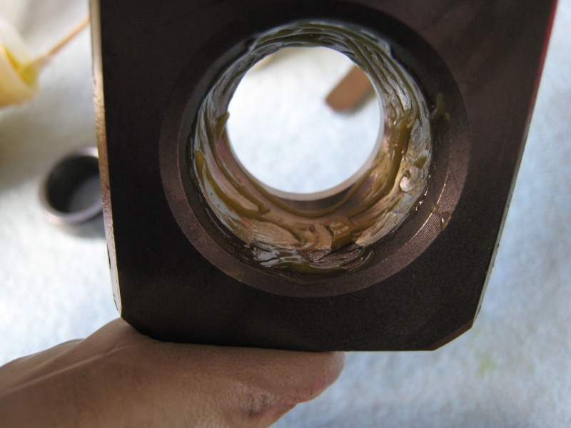

    If your grease was too soft and looked like melted mocha ice cream, you may want to consider re-packing the grease inside the roller. Please note that roller contains the bearing inside so under normal situation, you SHOULD NOT wash it with the degreaser. You just wipe off the old grease and that is good enough if you have looked after your drive shaft well.

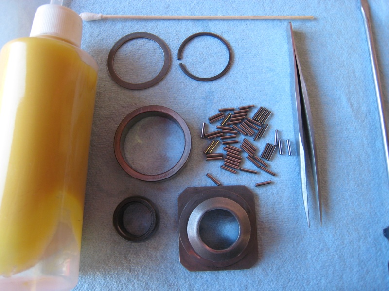

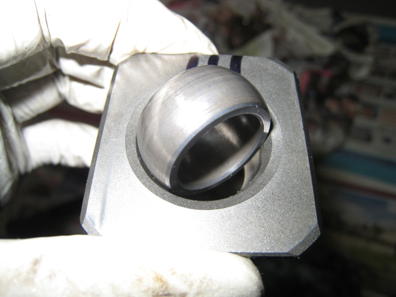

    Before, you remove the rollers from the spider, mark them so that you can put them back in their original position after cleaning process.
    At the same time, mark the spline of the shaft and the spider so that you can keep the original 60deg offset between the two ends of the spider.

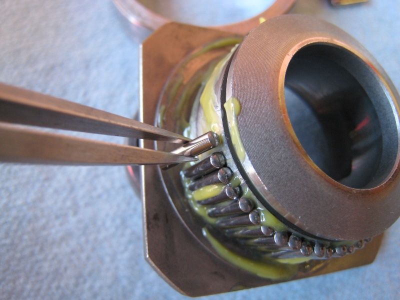

    There are lots of tiny roller bearings inside the roller. Remove the circlip on top and disassemble the roller. Never loose any of the roller bearings otherwise you will need to buy a new joint assy which will be very very expensive.
    When you re-pack the grease for the roller, it is best to carry out the process inside the Clean room or at least, dust free environment.

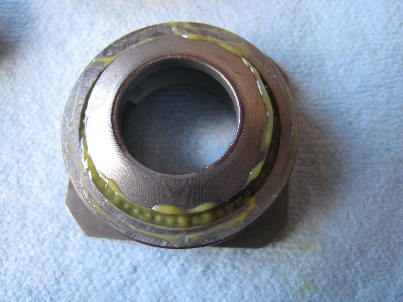

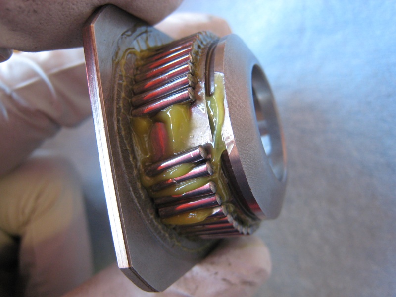

    Apply reasonable amount of grease to the internal roller surface and plant each roller bearing carefully. Once you have planted most of the bearings, re-built the roller.
ID:	5654Click image for larger version.
ID:	5655Click image for larger version.
    Then, insert the remaining bearing from the top and apply another coat of grease from the top. Rotate the roller several times and confirm that the roller is filled with the new grease. Put back all the parts to finish the re-packing of grease inside the roller.

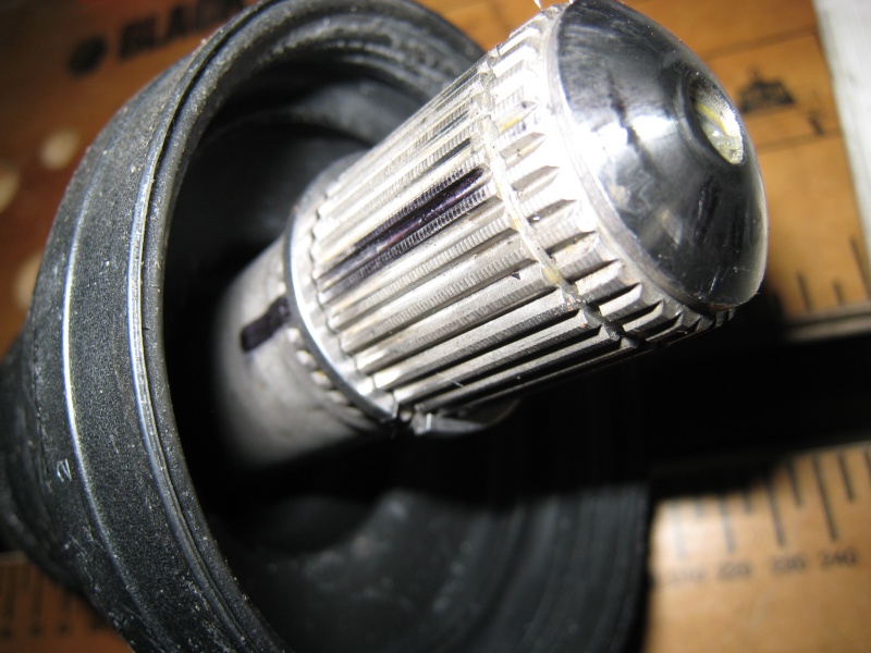

    It’s time to rebuilt the drive shaft.
    Put some tape on the spline of the shaft for protection and slide on the new boot.

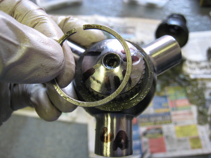

    Place the new thick set ring into the inner slot of the shaft. Unless you have carried out this several times, you will struggle to place it in the correct position.
    Insert the spider at its original position by looking at the marking. You may want to use some sort of tool for this. I use old brake calliper piston as its opening is just the right size.
    Place the new thin set ring on top. This one is easy.

    Put the remaining specified amount of grease into the housing.

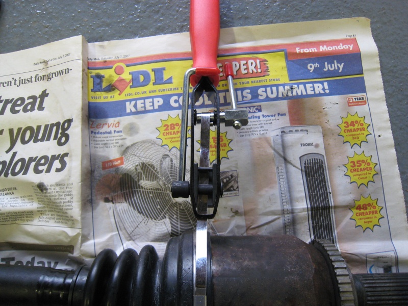

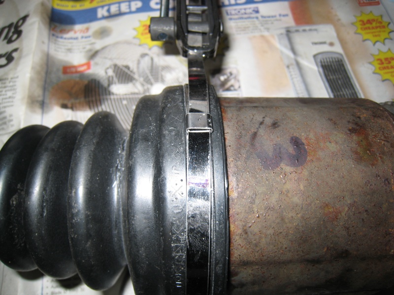

    Because of the spring inside the outer joint, it is best to secure the boot bands on the inner joint first and then move onto the outer ones.
    If you order the OEM replacement boot kit, the boot band will be different from the original ones. It is double loop type and it is best to use the special tool for tightening it. It is recommended to face the free end of the band towards the forward of the car.
    After the double loop, hand tighten it first and then use the special band tool. You will need to tighten it for about 10-14mm from the point after hand tightening.
ID:	5666 Click image for larger version.

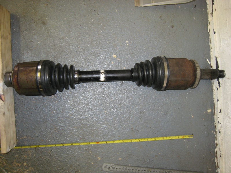

    Then, look at the manual and adjust the length of the driveshaft before securing the boot band on the outer joint. Right side is the same for both MT and AT but the left one is different.
    As you don’t want to create any rust or attract any dirt on the spline of outer joint, cover it with some grease. On the left inner joint, you don’t want any dirt on it as it will be inserted into the GBox which means that it will be in contact with MTF or ATF.
ID:	5668 Click image for larger version.

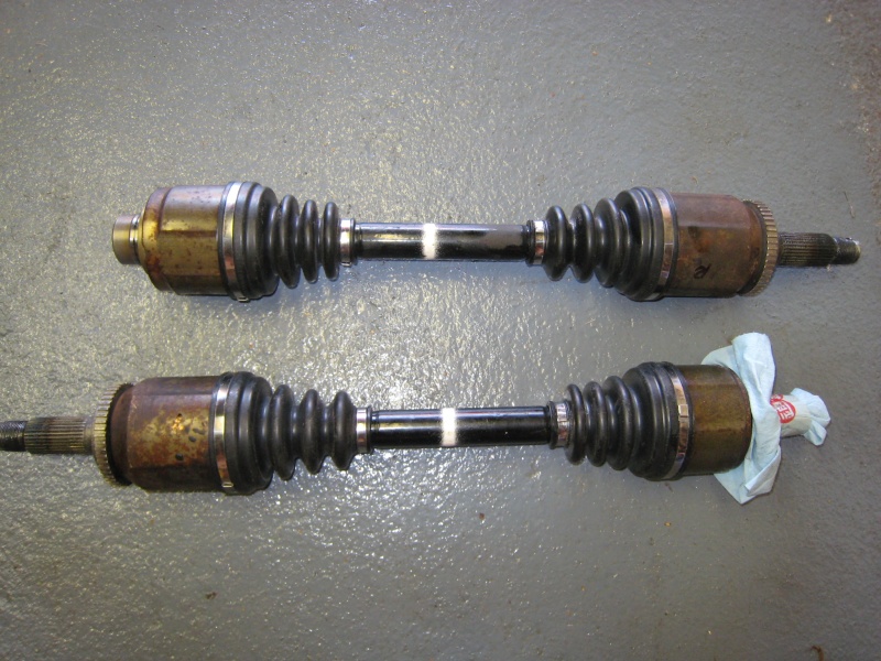

    Now we have the refurbished driveshaft.

    Kaz, is the yellow Honda driveshaft grease available separately form the boot kit? I need a bottle like the ones that come with the rebuild kit or smaller.
