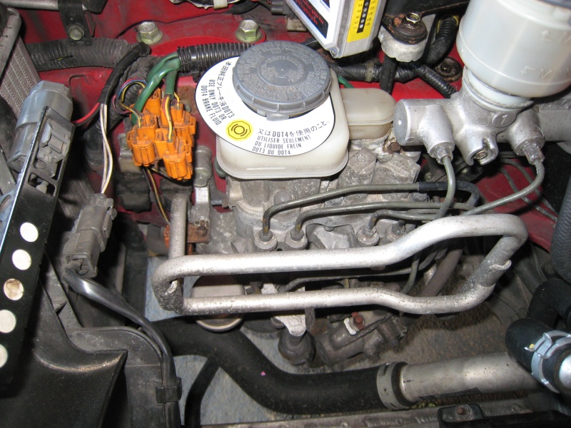

Hi, Sudesh.
Haven’t checked the price in UK but I think you are referring to the ABS on 2002 Type-R.
For JDM, there are two different type of modulators, version Z03 (standard) and N21 (Type-R).
The software setup is different and on 02 Type-R, the brake booster and master cylinder are different from standard models. The booster valve and ratio were increased to improve the response. For this reason, if you select 02 Type-R ABS modulator ver.N21, then you will need new booster, master cyl and two different brake pipes compared to the parts that I used this time.
I tested both version on the street and also on track recently but because so many other factors were different on Type-R, I couldn’t carry out direct comparison between the two.
Also, my driving skill is no-where near to the people I used to work with even I was on track every two weeks or so. Therefore, it is best to listen to the feedback from the professional driver. I was told that the entire brake system including the ABS on Type-R has faster response than the standard one so the ABS will kick in at early stage but also has better linearity control of brake pressure allowing the driver to take more control on brake.
The stopping distance under panic brake condition would be shorter on the standard ABS modulator and this is why I went for the standard spec.
