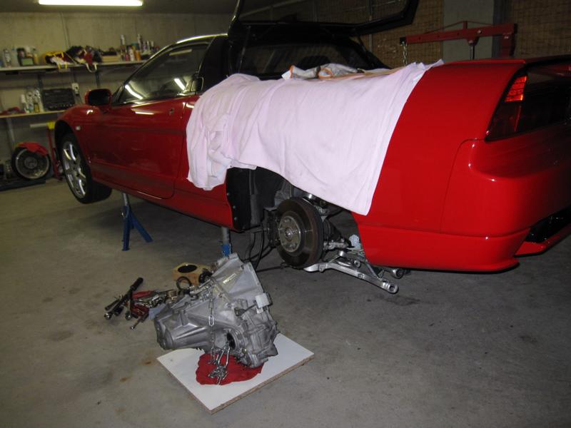

    First taking the gearbox out. Special thanks to Sylvian for borrowing me his lift.

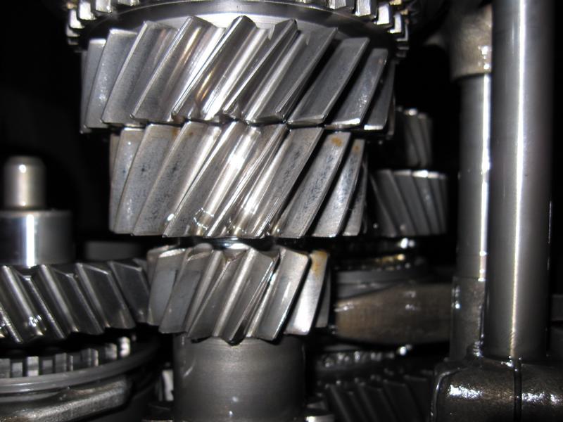

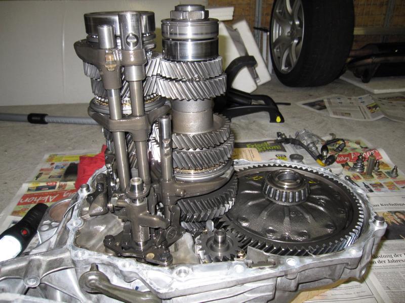

    Opening the box, at first sight:
    - snap-ring ok
    - countershaft bearing (the one at the snap-ring) ok
    Not sure what to think about the gears. There are spots and even rust ??? on them? I didn't lend my car to 007 for diving in the sea...

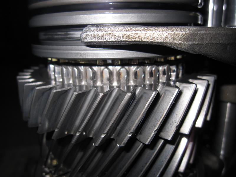

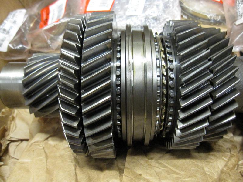

    5th gear: mysterious signs of wear. I've to admit that it popped out on the German Autobahn 2-3 times but that was back in 2008 or so. Something is wrong here. Of course, I use the 5th gear a lot (a lot of cruising). Opinions?

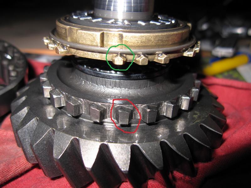

    Reverse gear synchro teeths. While the synchro ring looks good the reverse drive gear looks strange. The sleeve looked ok. I've compared it to another gearbox we did in the past and it looked about the same.

    Hi, goldnsx.
    As you went for the final ratio change, you were forced to replace the countershaft, final driven and oil pump. I presume you replaced the countershaft bearing at that time.
    With the short gear ratio, you were forced to replace the mainshaft (main 1st, reverse, 2nd directly machined on it), counter 2nd, main/counter 3rd & 4th gears.
    I don’t know the base gbox no. of your NSX but looks like there is no washer between the main 2nd/3rd gears so I believe you got the later spec mainshaft which is good.
    I'm afraid that main 5th gear needs replacing.
    As it looks like you are replacing all of the synchro related parts, not much to say but that damage is the typical sign of driver accelerating to the limit in 4th gear and then quickly shifting up to 5th.
    As you opened the gbox, you will notice that compared to the 3rd and 4th synchros (both using the same capacity), 5th one is much smaller for some reason and that is the main reason for the damage.
    Addition to this, the inertia of the CL will play the big part against the synchro capacity but I'll leave it for now.

    Back in 2005, my tranny (1003042) of my 1991 was built with new bearings, FD4.23, new mainshaft, new countershaft and short gears 2-4 (1st and 5th not changed), new synchros and main bearings and new snapring. I always had the OEM twin-disc clutch kit, being the first one, so will replace it now too. Always filled with MTF III, changed every 20k km.

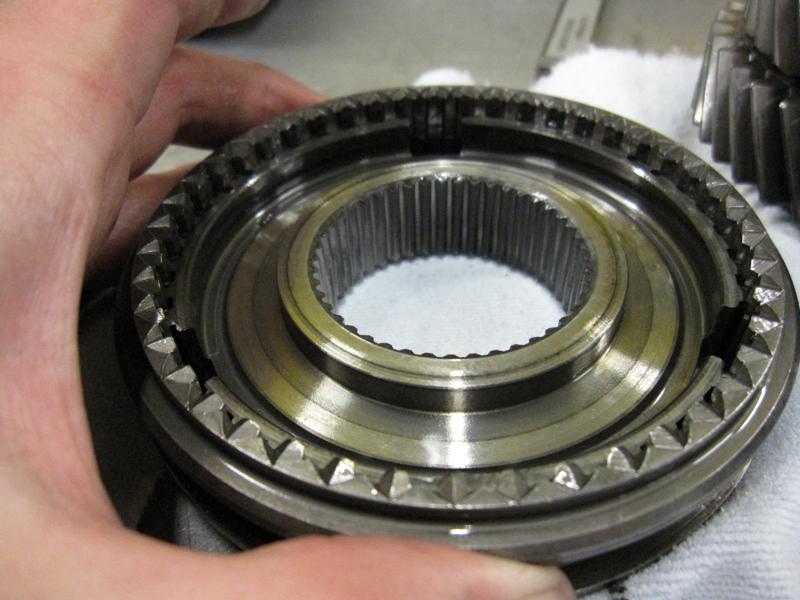

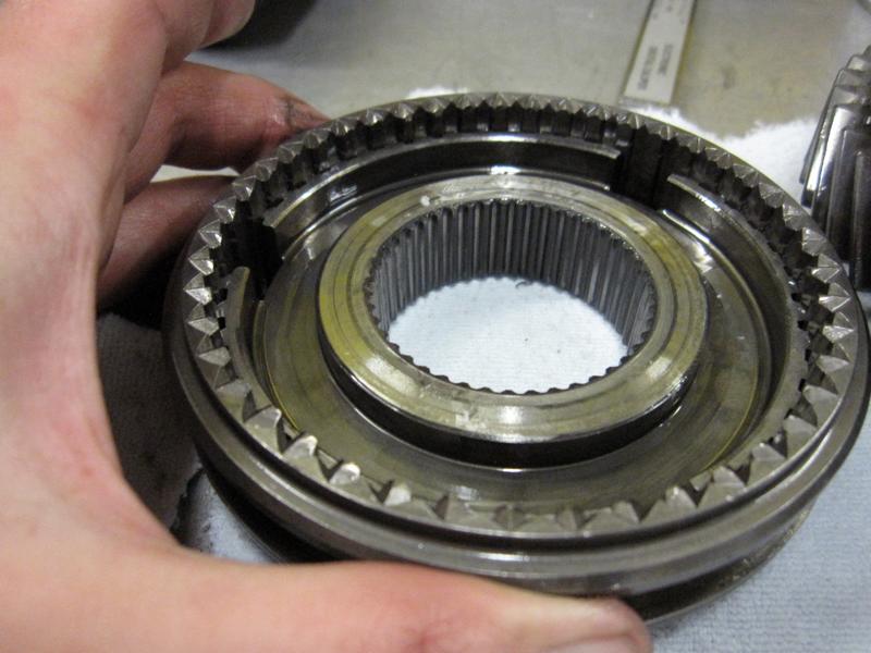

    I've changed the 1st/2nd synchro/hub/sleeve as a complete set. Before, I've measured the clearance between the 2nd and the 3rd gear (according to 13-30) and found no play at all but the 2nd gear was turning. The standard clearance is 0.04-0.10 mm. I've pressed the 3rd gear onto the shaft and now the 2nd gear is NOT turning, neither so the synchro ring (this are expensive new parts!). The synchro also looks too far of the gear. Now, it looks like the 2nd gear synchro is pressed and it that's the case it's damaged I think. If I'm lucky the spacer collar is just a tiny bit too small.
    In the first two pics is the 1st/2nd gear hub/sleeve. One side is 6.5 mm deep and the other is 7.5 mm. I've installed it the way the old one came out and backed up the the installation with the pics I've taken before. The tiny groove on the outside (pic 3) is towards the 1st gear. The SM doesn't mention anything about that.

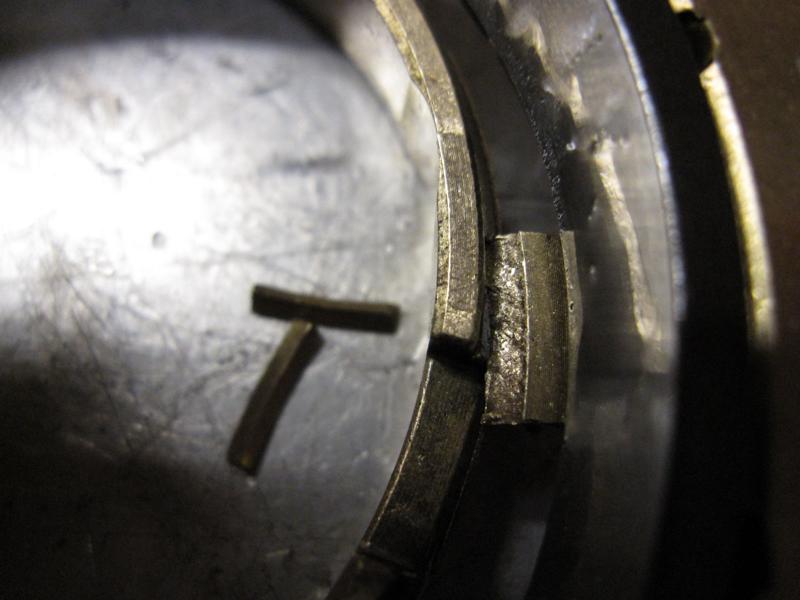

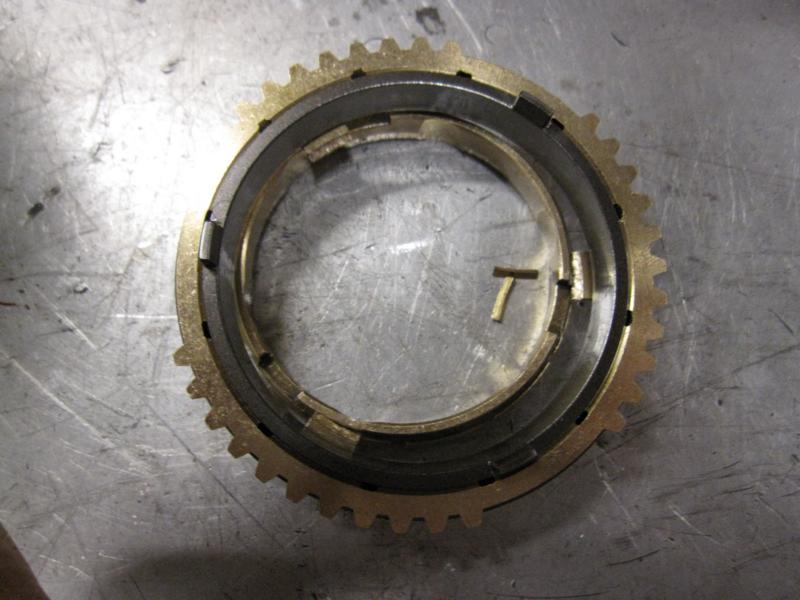

    The mystery with my 2nd gear has been solved.
ID:	12783Click image for larger version.
    The new synchro ring was damaged while pressing the 3rd gear on the shaft. Even after doublechecking every step and consulting the manual (and my brain) it must have misaligned when I was fidling with the 3rd gear. I regard it as bad luck or as a puncture in a new tire, it's only money... I'll get a new one. I testfitted the third gear and there's a space of 0.05 mm between 2nd and 3rd, that's fine.

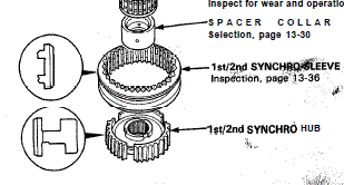

    The hub/sleeve story ended like this: there are small pictures (on the left) in the exploded diagram. By most of them you have to think about a minute or two what area they could refer to and what they are willing to tell you. I don't blame the SM but I guess I was expecting a note or a word of caution. Anyway, it was installed correctly.

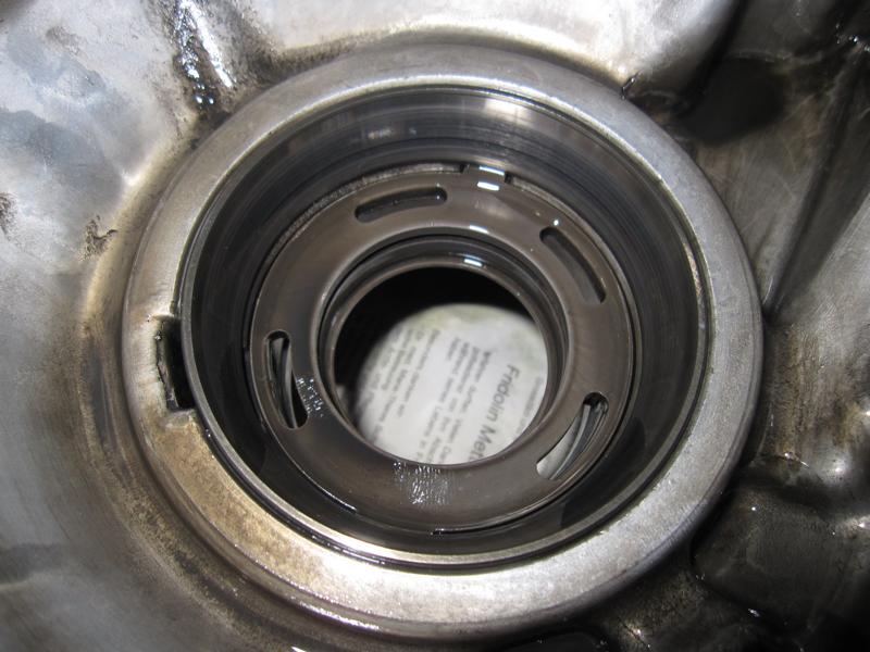

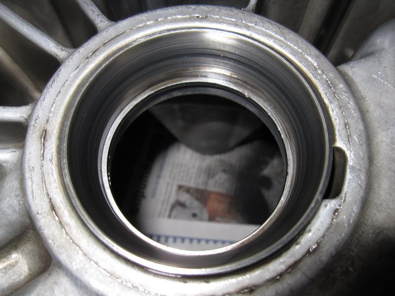

    Another question: how to get these two babies out?
ID:	12782Click image for larger version.
    The oil seal is already out.
