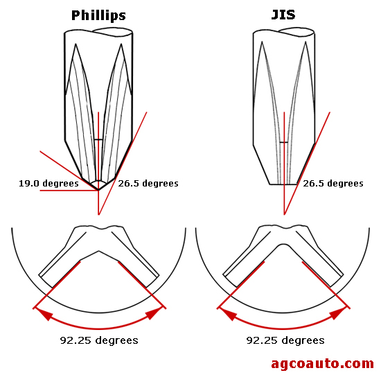

New to me also and the reason for the post; is that the OEM slot headed fixings on Hondas are NOT Philips but are manufactured to a JIS [Japanese Industrial Standard] form.
JIS for slot headed screws looks like Philips but are not, the root between the drive is a different, deeper profile and was designed to lock and not to ‘cam out’.
See the attached detail spec.
JIS slot heads should [may?] be marked with a dimple to identify them, [check the door latch screw heads and a dimple stamping is just about visible].
Thus the following scenarios exist,
Philips screwdriver, Philips screw, designed to work together, designed to disengage under load. If it’s old and furry and the head strips – it’s what science intended.
JIS screwdriver, JIS [as Honda OEM] screw, designed to work together, designed to be able to take full torque and to give a Zen like sense of nirvana.
JIS screwdriver, Philips screw, will work together, should be better than Philips/Philips.
Philips screwdriver, JIS screw, will not properly work as the screwdriver cannot get a full face of surface of contact and can and will damage the softer fixing.
How to get JIS screwdrivers - with difficulty; as, save for Japanese companies, the world doesn’t readily accept they exist, let alone for the last 50 years.
Easiest and cheapest – try the slotted screwdriver in the toolkit - honest.
Put a new Philips screw in a vice and then try to turn it with a standard Philips screwdriver then try with the one from the toolkit, totally different feeling the Honda one does not try to slip.
