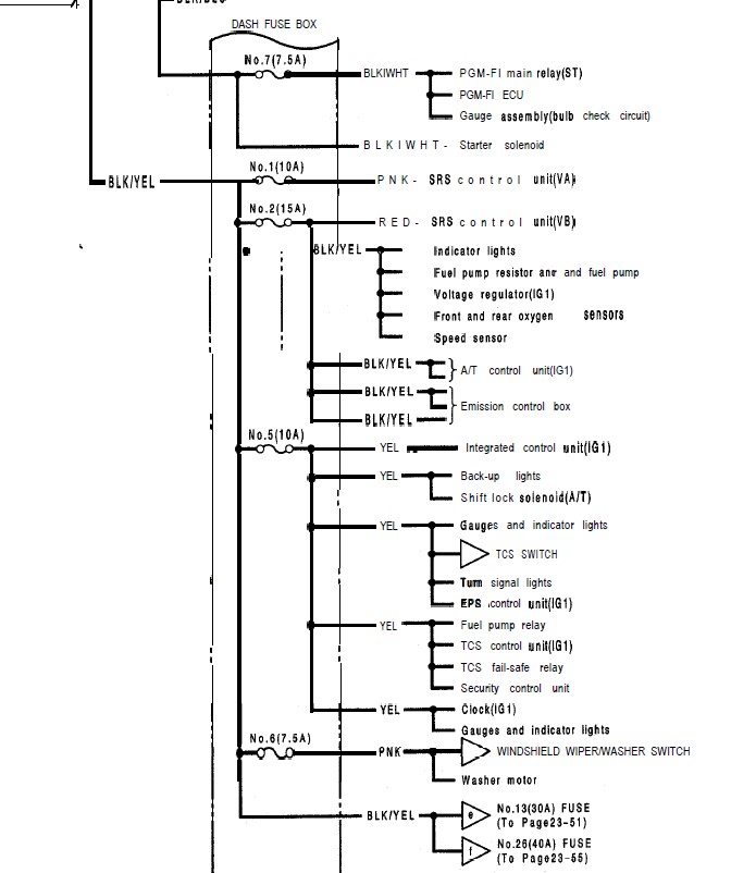

1 Attachment(s)
Cabin temp sensor / aspirator fan

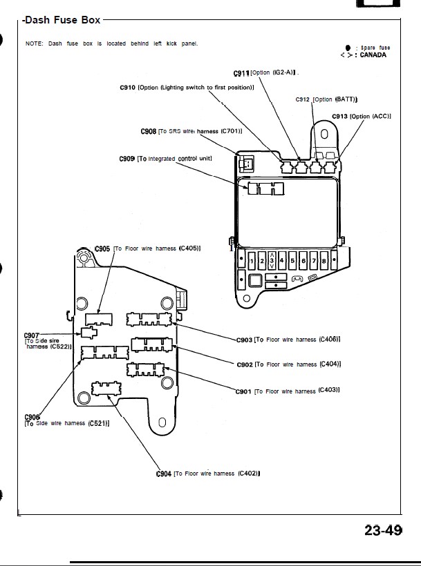

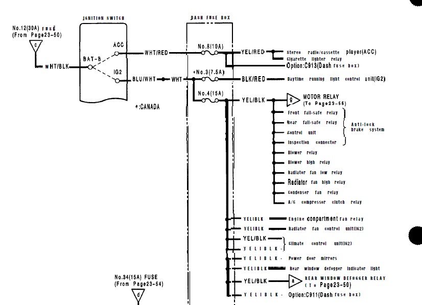

2 months with my 91 car and working through some issues, Intermitent radio died so took it out, found 2 leaking capacitors, had them replaced local but still not working. While taking the radio out, I thought I would clean out the cabin temp sensor as temperature control was very poor, but found no dust and no aspirator fan! While looking for a replacement (£120 from Japan) found a Land Rover part that looked the same, so bought one off eBay for £10. Connector is the same but wires going to different pins, so pins swapped out and all worked and abit of silicon grease silenced the fan. Now back to the radio... i cannot find a fuse diagram/key for the fuses LH footwell?
