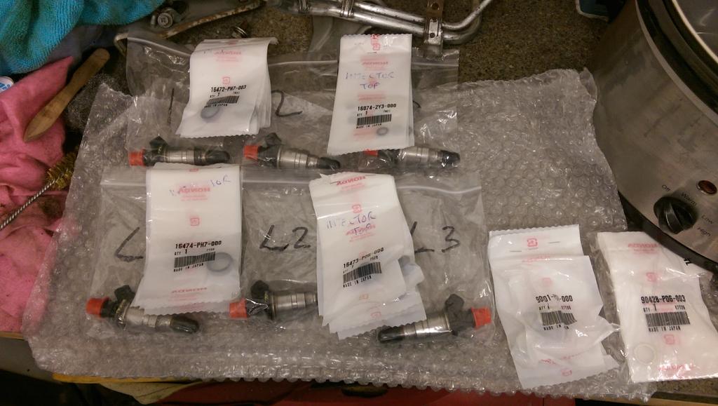

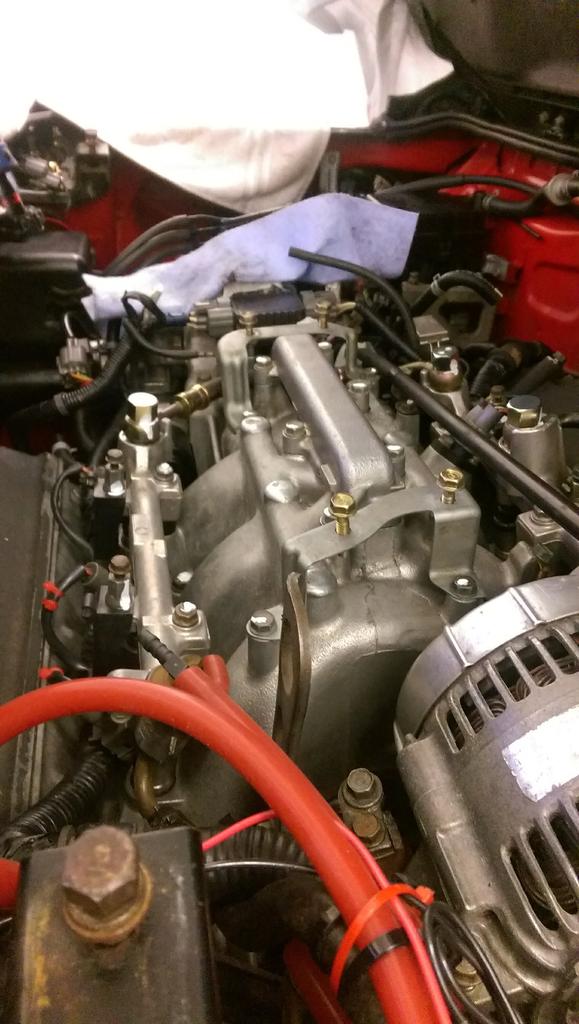

Update. Injectors now cleaned & new seals fitted and re-installed.
Attachment 13354
Attachment 13355

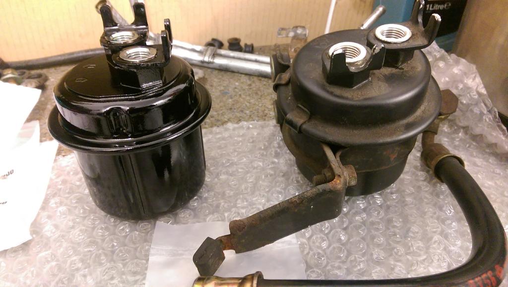

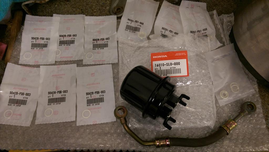

Fuel filter changed. More of an awkward job than it would first appear !
Attachment 13356
Attachment 13357

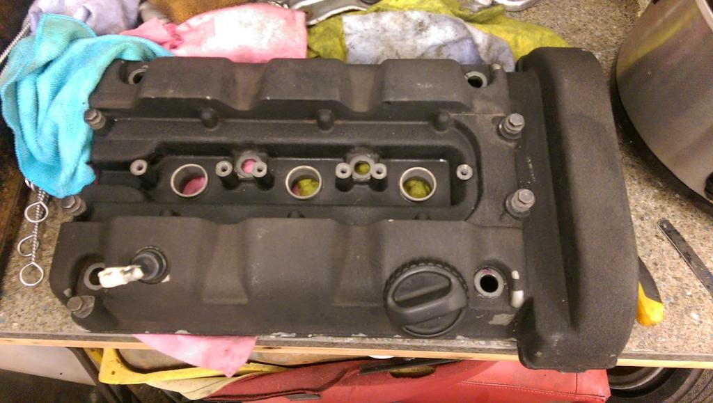

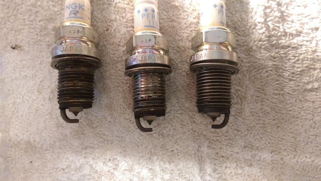

Rocker cover removed and spark plugs removed.
Attachment 13358
Attachment 13359
Do you need all those washers when replacing the filter, or did you get extra just in case?
