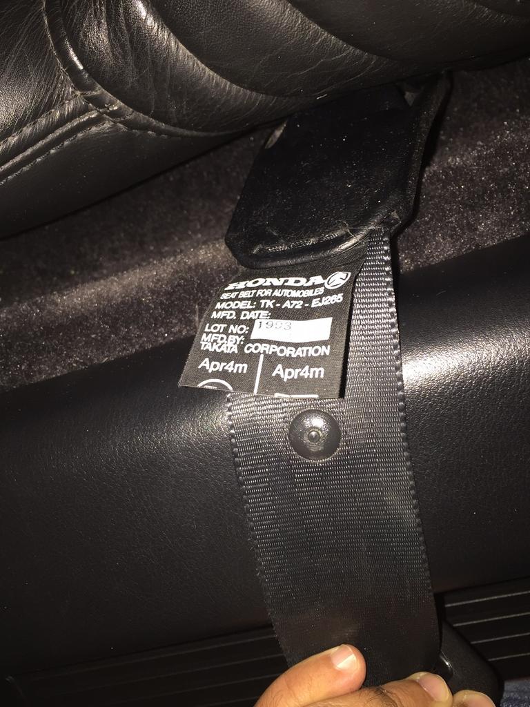

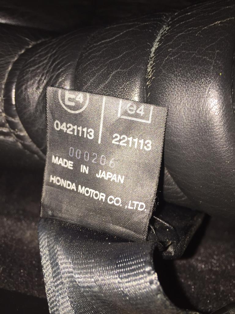

Hi goldnsx,
My NSX is a EU (LHD) model (1993)
here my drivers belt stickers:
Attachment 12980Attachment 12981

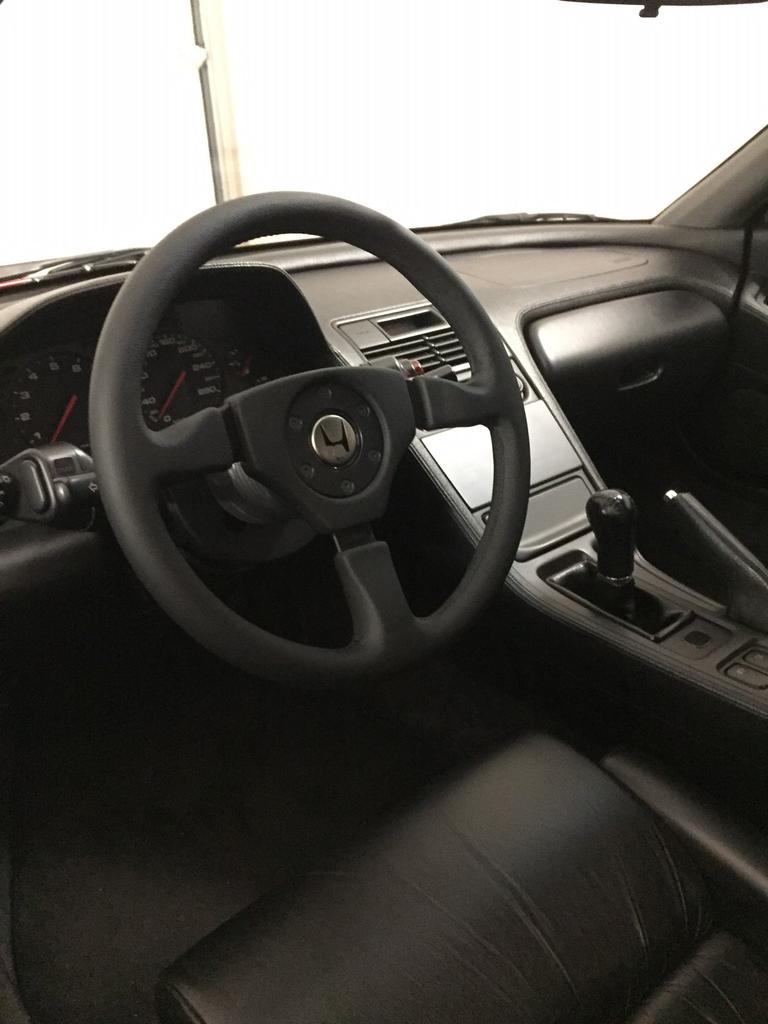

And a bonus picture of my Type S steering wheel (installed 3 days ago):
Attachment 12982
Thanks very much for the update. So they have changed the seat belts around 1993 when the passenger airbag was added. All infos on a single sticker instead of two.
1991: Ar4m
1993-: Apr4m
According to https://www.colliseum.net/wiki/ECE-R_16 (sorry German) is Apr4m = belt with a pretension system (if translated correctly from "p = Gurt mit Vorspanneinrichtung") while the 1991 belt does not have this feature. I'll ask my engineer about that.
One more belt of a 1991 would be helpful. :)

When i installed my type S steering wheel i also removed the firewall engine insulator, and while working there i could see the warning stickers from the pretension system, this also made me decide against removing the SRS ecu and sensors!

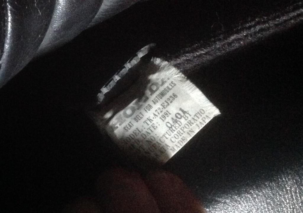

My 91/92 drivers side (right) white label, no black label though.
Attachment 12983
