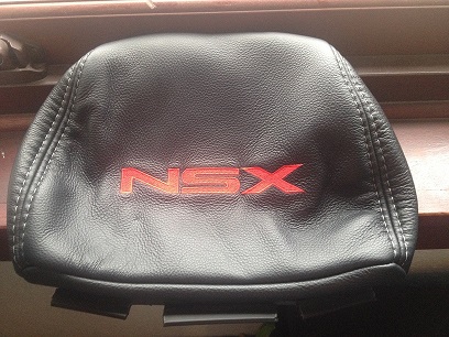

Attachment 12369
New headrest with NSX logo (I was very impressed with the quality of the work)

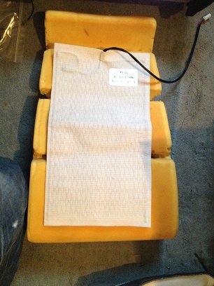

Heated seat kit fitted (the kit includes 2 heating elements per seat)

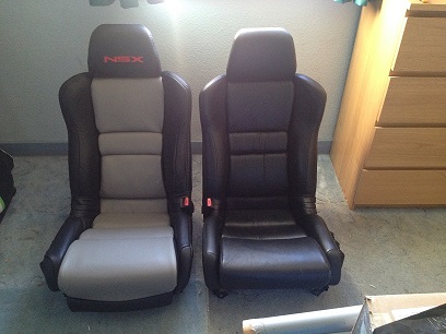

Attachment 12371
Comparison between old and new

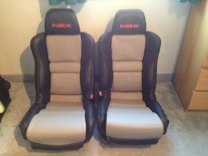

Attachment 12372
And both complete

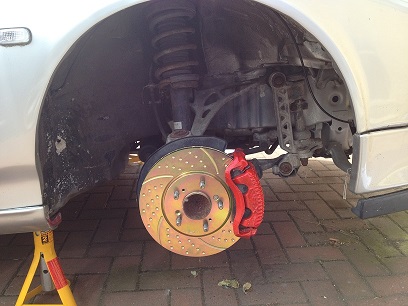

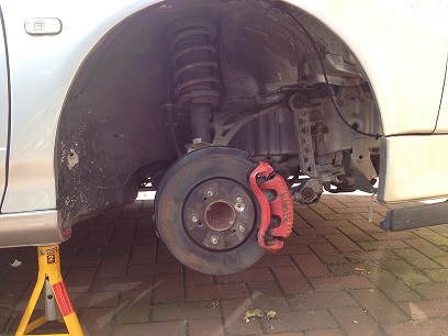

brakes were looking a bit past it
Attachment 12374
New discs and pads on all 4 corners, and a bit of new paint on the calipers

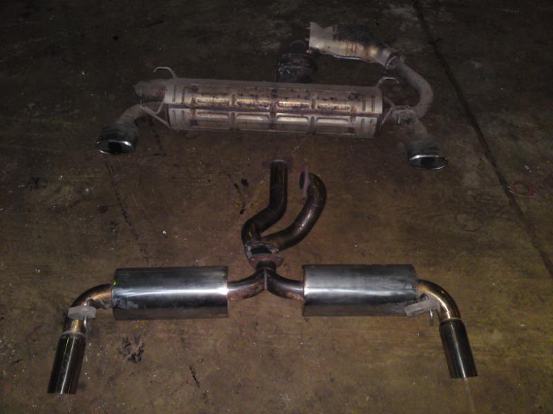

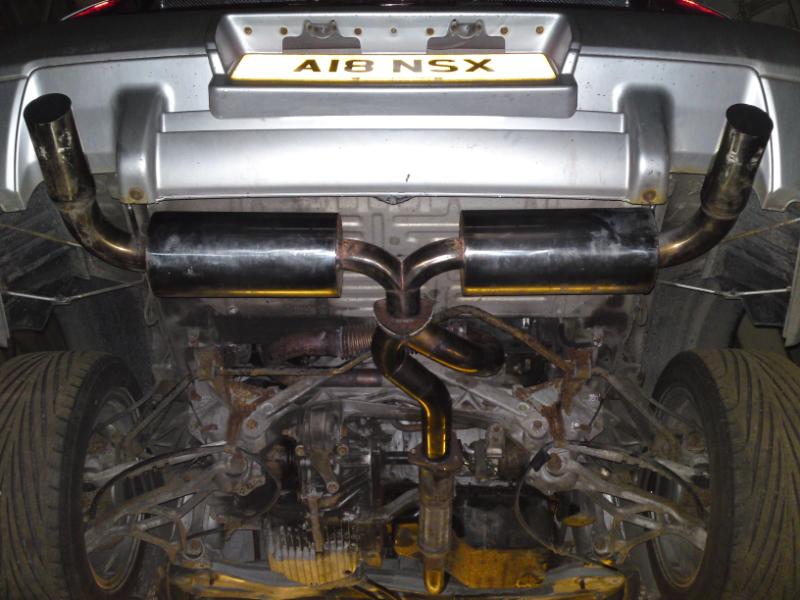

Exhaust change. OEM off, De-catted one on:
Attachment 12375
old and new
Attachment 12376
Attachment 12377
And fitted (wasn't as easy as it sounds, old bolts had to be ground off as there was nothing left of them, but got there in the end)

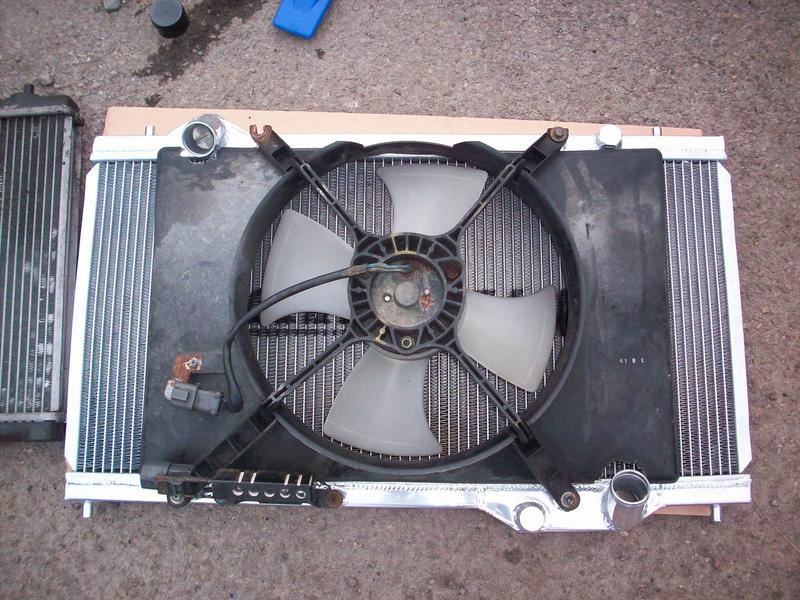

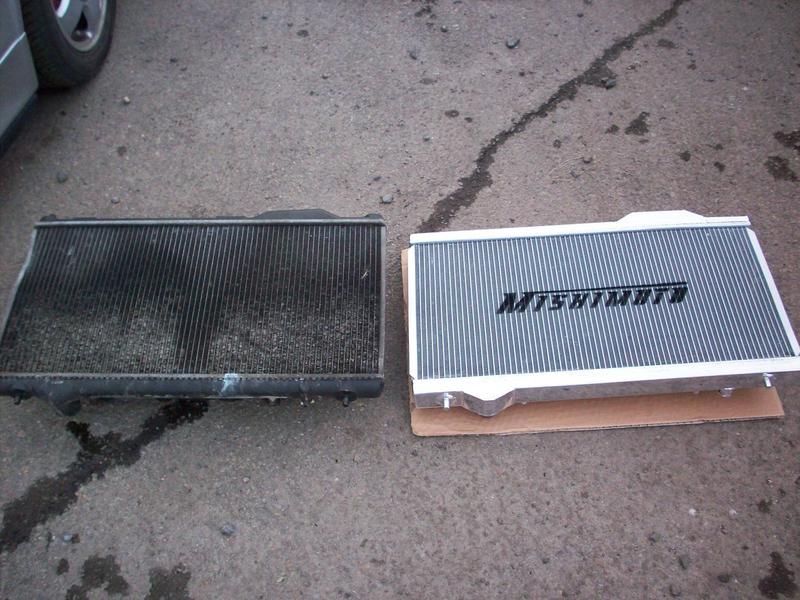

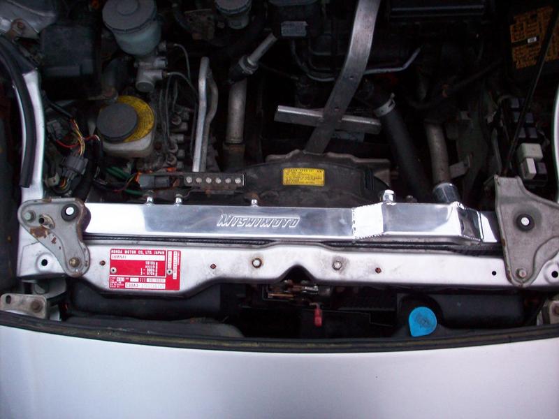

Again, this was a few yrs ago, but the radiator required replacement, OEM off, Mishimoto fitted
Attachment 12378
just a little difference!
Attachment 12379
A few minor mods to the fan cowling to get to fit
Attachment 12380
And in it's place
the seats look very well indeed Jim. Was going to put the logo into my headrests as well but was shot down by Sudesh! :)
As Paul says you will likley need to get the other trims sorted as well to match
good job!
