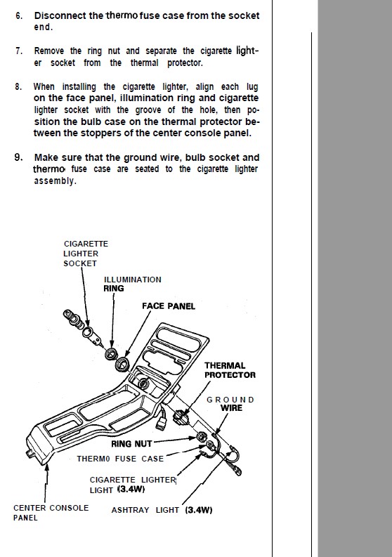

In other cars, the thermo fuse is typically connected to the center (+) terminal. The Electrical Trouble Shooting manual implies that the thermo fuse is connected on the ground side which is odd considering the diagram in the service manual. Regardless, given that you have not reported fuse popping I expect that what may be happening is that the center contact in the actual socket may be coming loose and moving around when you insert 'whatever' or the connection of the socket to the thermo fuse case may have come loose with the same effect resulting in an intermittent connection and possible sparking at the bad connection point location. If the center pin in the actual lighter socket has come loose, I don't know whether that is fixable. You may need a new socket. If the thermo fuse case has come loose I think that may be fixable.
I have attached the section from the service manual describing removal and separation of the lighter parts. Once separated, I think the problem and the repair options should be apparent.
Attachment 14738

Kaz, as ever, kindly passed on his knowledge of the system in a recent Blog post for which I am very grateful. I disassembled the unit and found it to be fine visibly and working again with the cigarette lighter on re-assembly. The cause of my woe is the compatibility issue between our cigarette lighter socket and modern power adapters. I'll refrain from using power adapters and have instead used a fuse adapter to power a USB lead in the glovebox and arm rest
