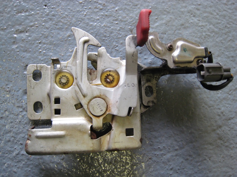

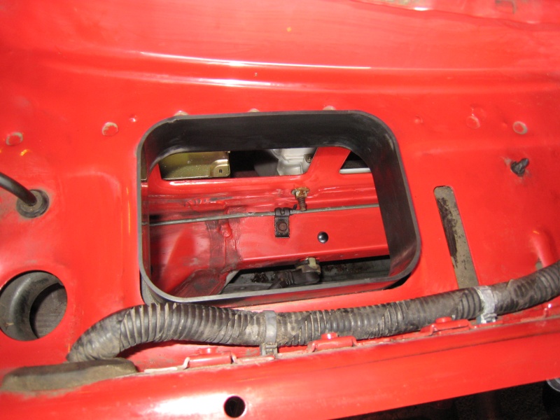

Well, I started to work on this NSX but every time when I tried to open the bonnet, it was stuck in the original position and I couldn’t open it. I had to hold the opener upwards and pull the bonnet to open it. As I didn’t like to return the car in this status, I decided to remove the entire lock mechanism, soaked it in the cleaner and re-greased it. Now, it opens freely.

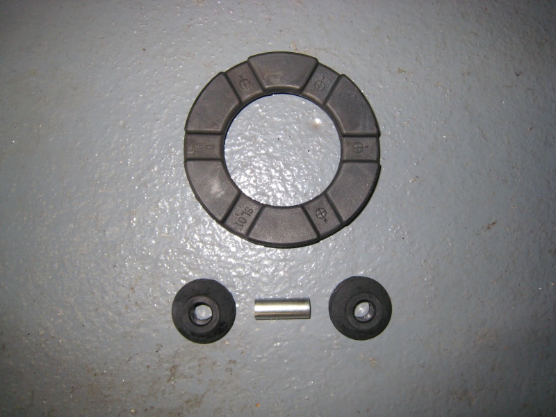

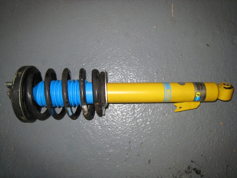

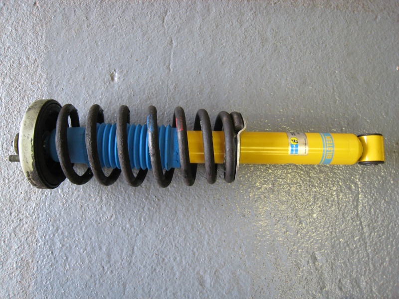

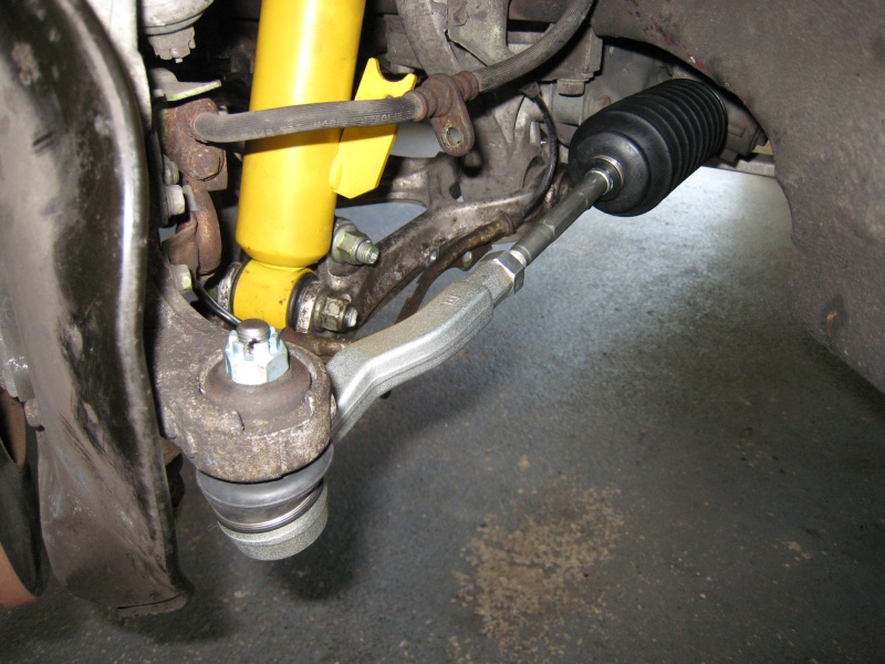

2. Bilstein damper with OEM early Coupe Spring
Attachment 5769 Attachment 5770 Attachment 5771

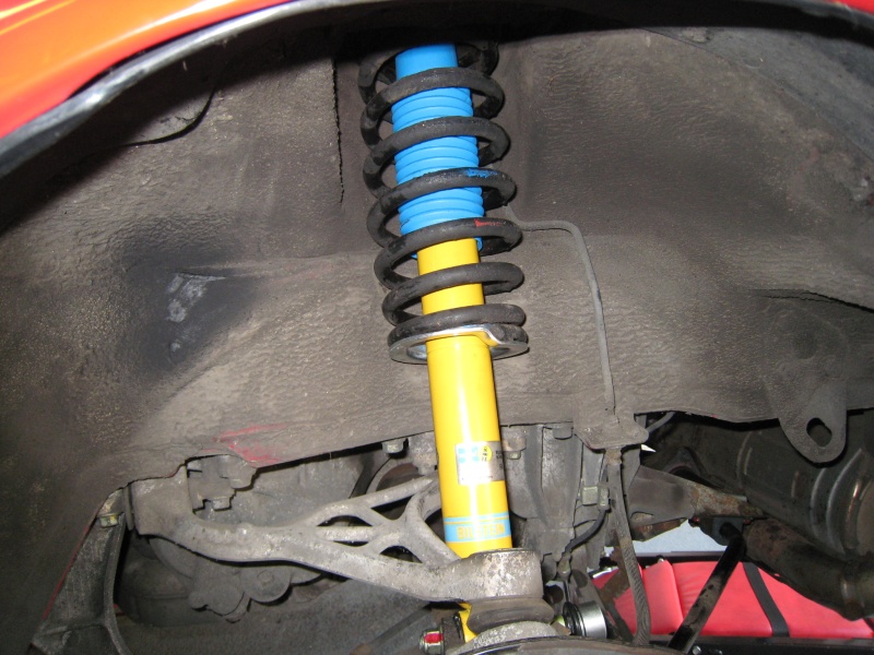

We spent long hours discussing about the chassis setup and for the damper/spring, we decided to go for the Bilstein damper with OEM spring.
For this combination, I always use new bushes and mounting rubber so placed the order to Japan. Attachment 5772
I only drove the car to/from the alignment place but I already found it was a good combination to meet his demand and budget.

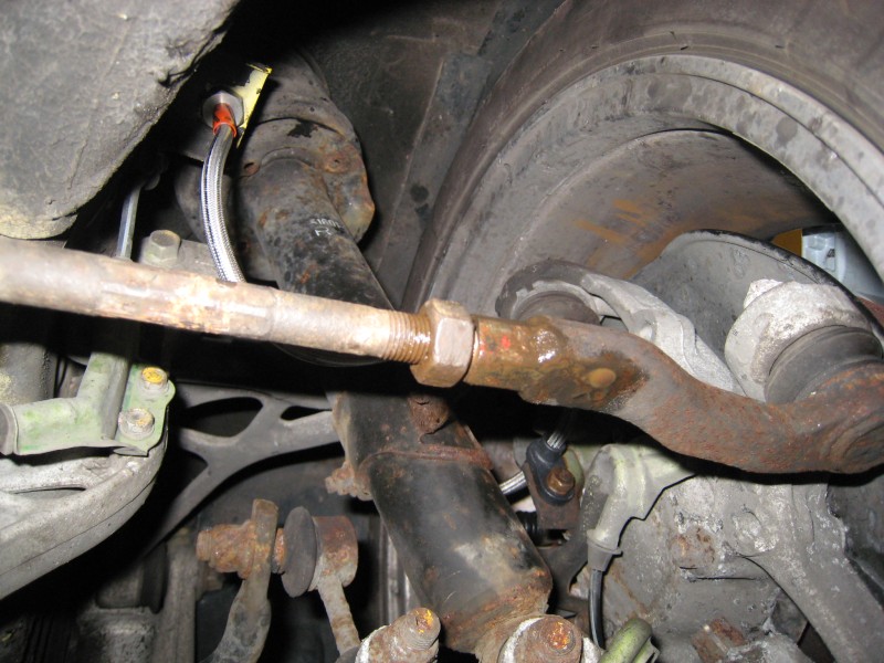

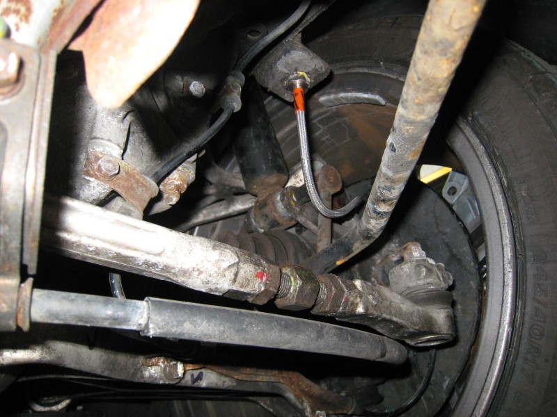

3. Stabi link, stabi bush, tierod/rack end
Attachment 5777 Attachment 5773
While replacing the damper/spring kit, we also replaced the old and tired stabi links and stabi bushes. Removing the locking nut on the stabi link is always the challenge as quite often, the hex hole is rusted and too weak to hold the big torque on loosening the self locking nut. In fact, for one of the link, I had to cut the shaft to release it from the stabilizer.
Quite often, I found small movement on the passenger side tierod/rack end but on this NSX, both sides were rattling. So, new parts were installed before going to the alignment place.

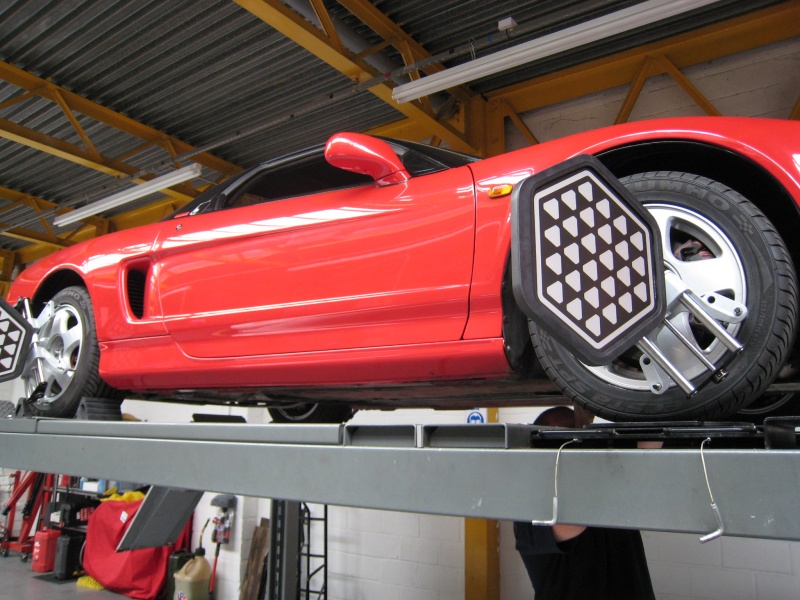

4. Alignment
Attachment 5774
Back to my favourite 2Hr alignment session. From time to time, I found seized alignment bolt even on NSX but this one was really tough. After fighting against some of the nuts and bolts, the final alignment result came out beautifully. Although it is a very old frame, no severe damage to the chassis and thus, perfect alignment to my own setup.

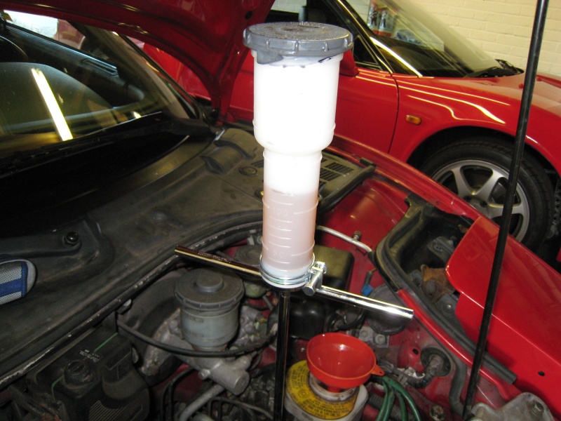

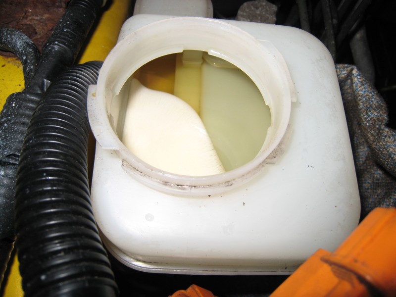

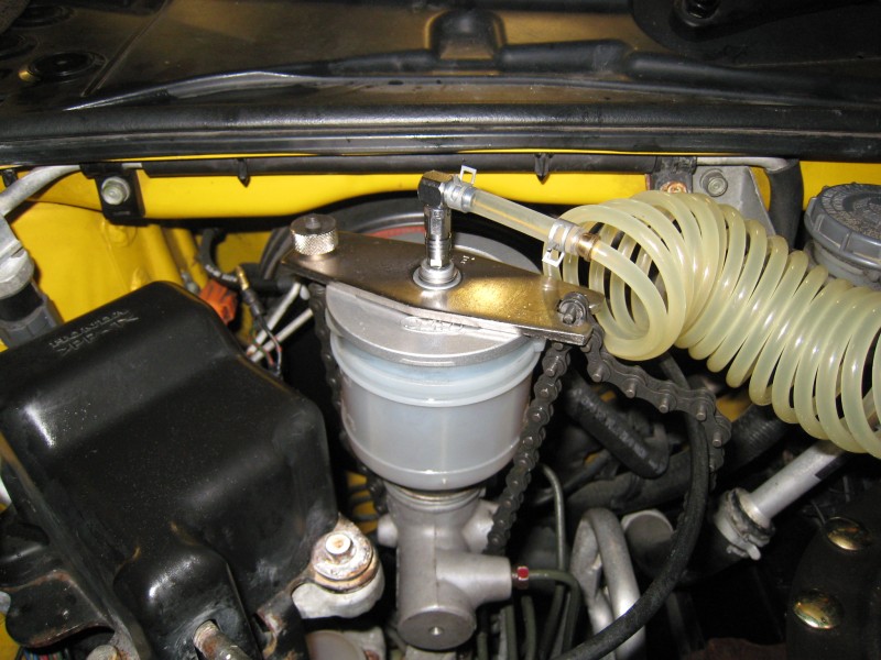

5. ABS
Attachment 5775 Attachment 5776

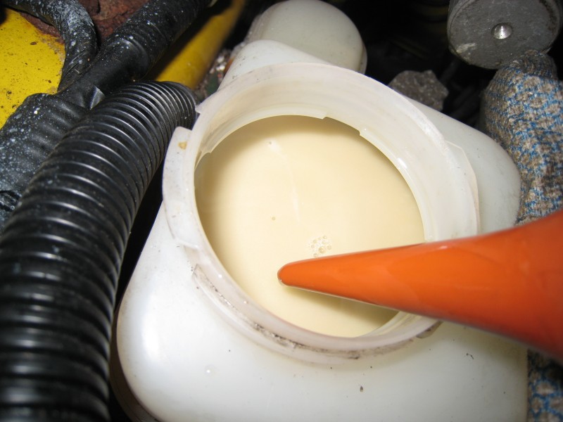

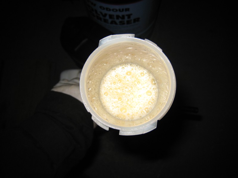

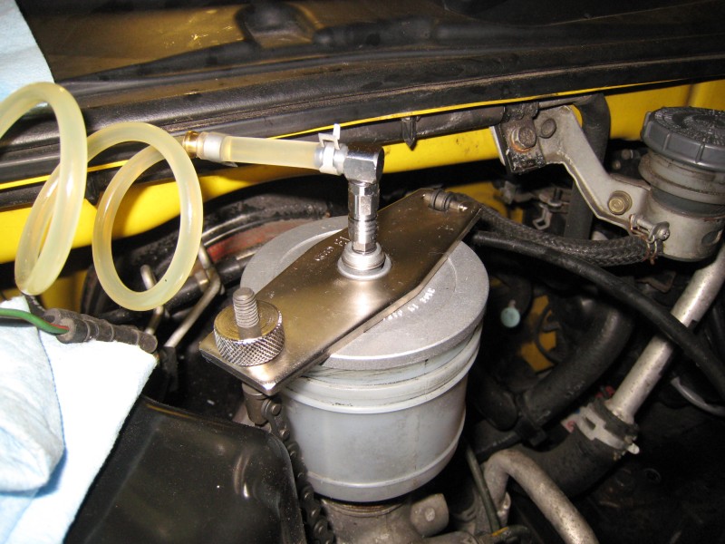

ABS has been neglected for a long time so when I used my SST to drain the old fluid, some of the debris from the ABS were trapped inside the one way valve of the SST and when I lifted it, almost all of the ABS fluid was released on the floor… After flushing the system several times, I managed to push the debris out of the one way valve so my SST function was recovered.
Unfortunately, I found that one of the four solenoid was already dead no matter how we flush/activate it. I could disassemble the unit and try to refurbish it but instead, it would be best to convert it to the latest ABS system so that will be on the future menu.

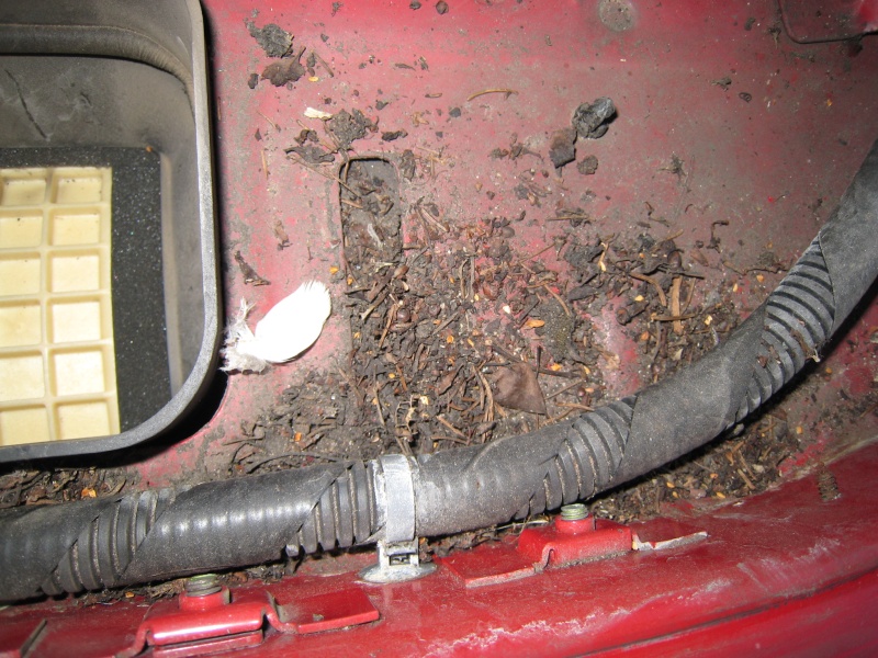

Unfortunately, when NSX was designed, there was no plan to fit cabin air filter like the modern production cars. Because of this, you’ll be surprise to see or may be, I should say, you don’t want to know how dirty the air could be inside the cabin. This is one of the reasons why the fan on the cabin air temperature sensor starts to make some noise after several years.
You may find lots of dirt around the air inlet of the blower motor unit. Once you have managed to remove it, you can see the evaporator.
Attachment 5782 Attachment 5778 Attachment 5779
This one looks very dirty but in fact, not too bad. In Japan, the summer is very hot and humid so the A/C is continuously being used and thus, lots of moisture is always at the evaporator resulting in black dirt or even sometimes some mould on the surface of evaporator.
First, blow out as much dirt as possible. Then, wash it with water followed by the cleaner. Wait for a while and then rinse it with plenty of water.

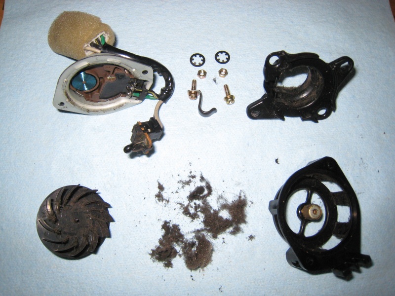

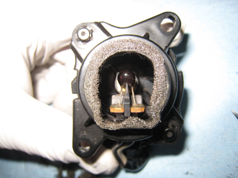

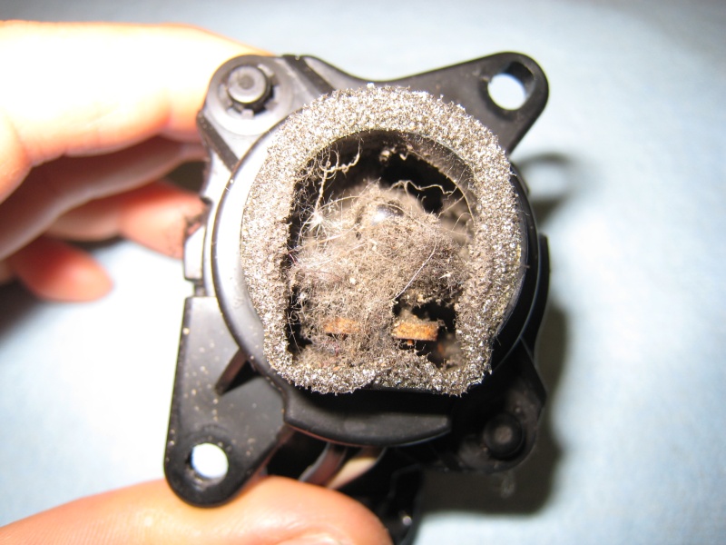

7. Cabin air temperature sensor
Attachment 5783 Attachment 5786 Attachment 5787
The cabin air quality was so bad that I found so many dust and debris on the temperature sensor. It was also making quite annoying noise so although it was not requested from the owner, I decided to clean it. This is what I found and I’m glad I cleaned it….

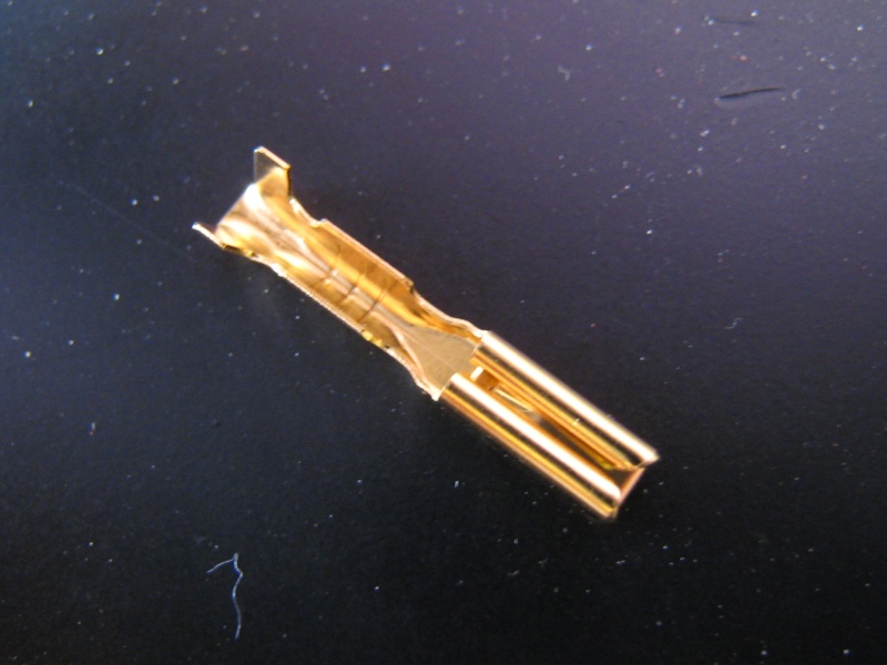

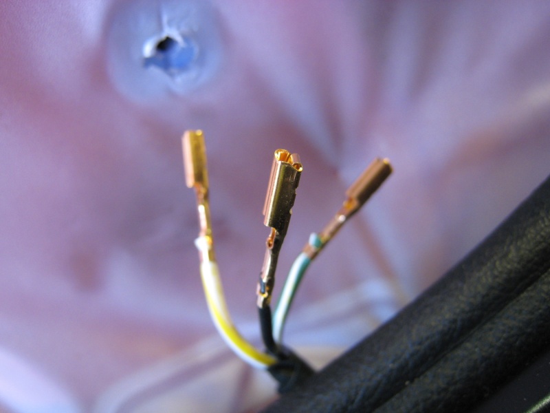

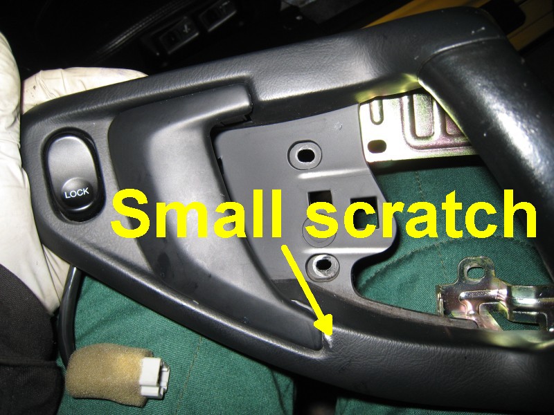

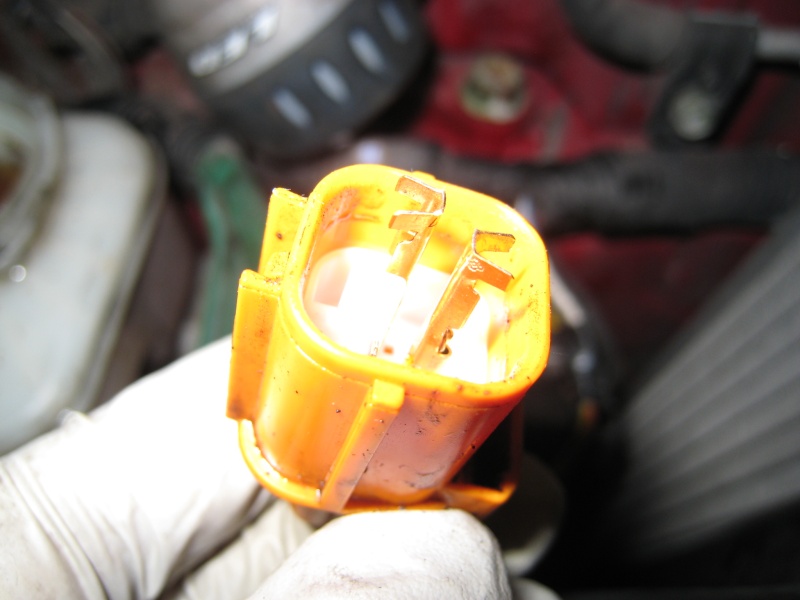

Quite often, I was asked to investigate the electrical issues on NSX and one of the common failures is related to the non-waterproof connector being used inside the door. On this NSX, the driver side door lock sw was not working at all.
After long years, the moisture corroded the GND pin on the non-waterproof connector and lost part of the contact point. In order to prevent this from happening again, decided to use gold plated terminal with grease inside the connector. Now, it is fine…

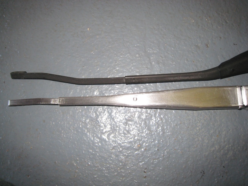

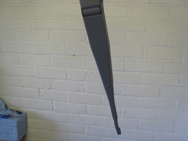

9. Painting wiper arm
Attachment 5791 Attachment 5792 Attachment 5793

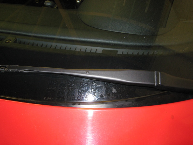

Black is very important for the presentation of your NSX. For example, it will make great appearance if you have nice black colour at the front lower spoiler, the upper seal of front windscreen, the tyre, the pillar and so on. Unfortunately, our wiper arm is very old design and sticks out behind the bonnet resulting in chip by the stone, etc. Also, if you wash the car regularly and if you are not careful, you can gradually scrape off the paint from the wiper arm.
So, it would be nice to spend some time painting them. Strip the old paint off and apply several coats of primer first. Then, wet/dry sand it down a little to get smooth surface and wash and dry it. De-grease it and then apply several coats of nice mat finish black paint. Now it looks much better.

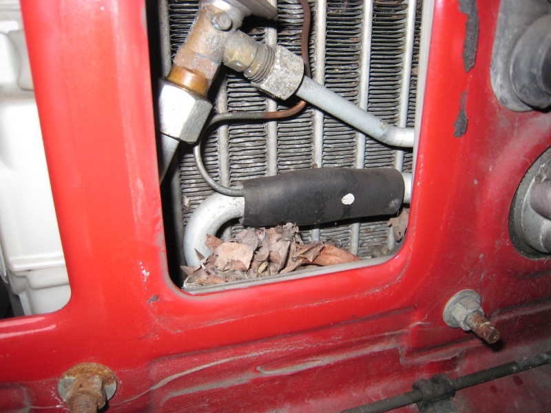

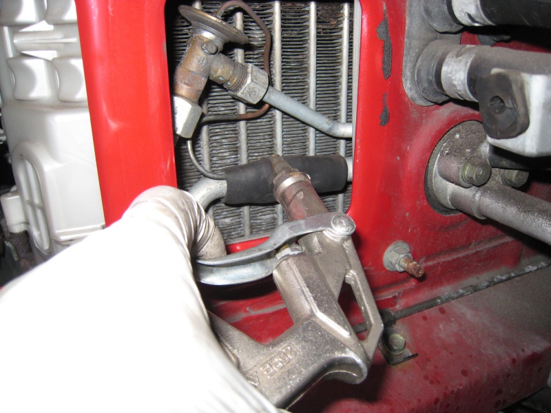

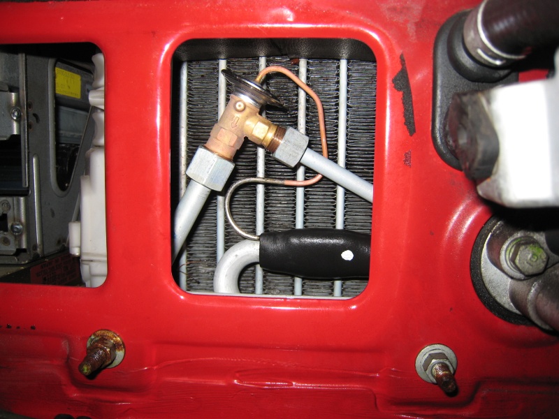

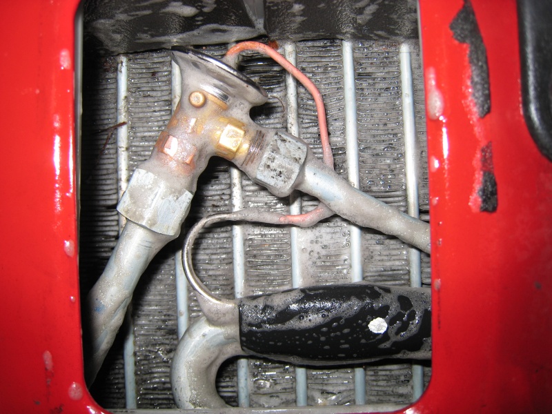

10. A/C gas leakage

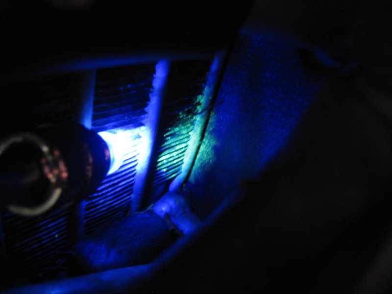

Attachment 5794
There are several common places to check for the A/C gas leakage on our NSX. The worst part to find the leakage is at the evaporator. While I was cleaning the evaporator, unfortunately, I found the leakage there. This is a big job to repair as we need to first remove the entire interior panel (yes, the whole one in front of the driver and passenger seat…), take out the evaporator and heater core as a package and then replace/repair the evaporator. As this NSX is using the old R12 system and although alternative R12 gas in available, we’ll be replacing the compressor, pressure valve, O-rings and so on to convert it into R134a system in the future.
