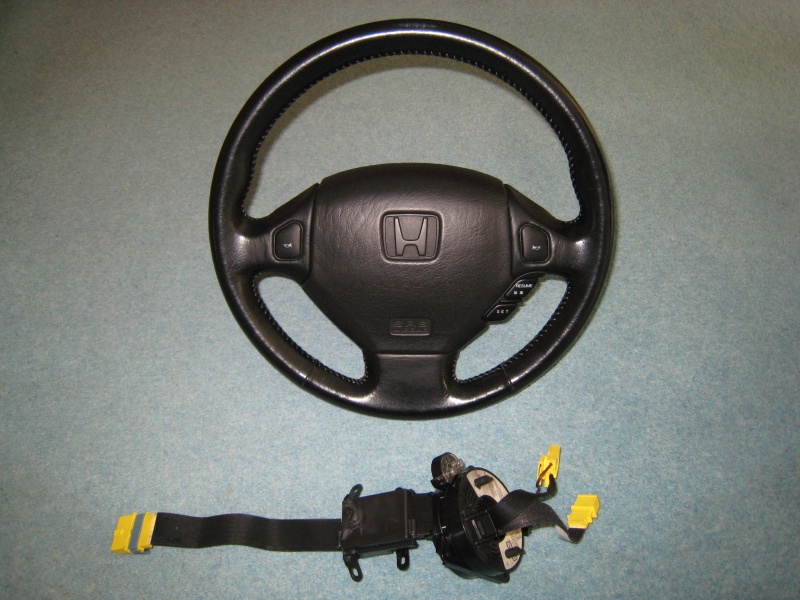

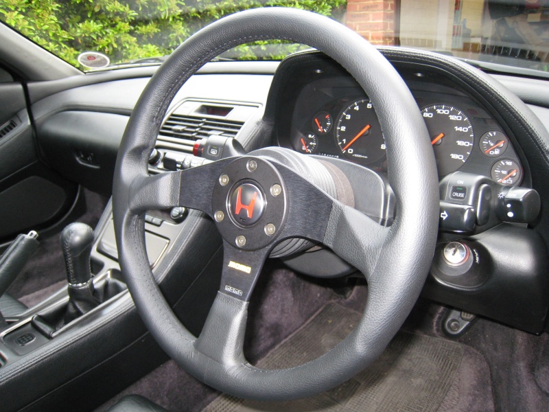

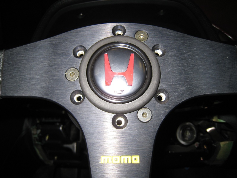

There are lots of nice write up on similar subject so I hope I’m not duplicating too much information. However, there were not much photos on OEM steering wheel and the boss that has 9 fixing holes so I hope this will provide you with some idea.
I bought the Type-R steering boss last year (seems like long time ago…) but until recently, I couldn’t decide on the steering wheel itself due to the design, leather feeling, price and so on. As I am going to use the Type-R boss which is the modified one from Momo, I have to use the wheels from Momo or the one with the same pcd. Some of the manufactures use different pcd so please be careful.
At the end, I decided to go for the OEM 2002 Type-R steering wheel. It is based on one of the Momo steering wheel (Tuner for 02R?? Corse for 93R??) and costs about 3 times more of the original aftermarket one from Momo.

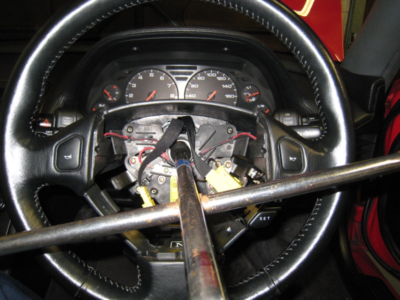

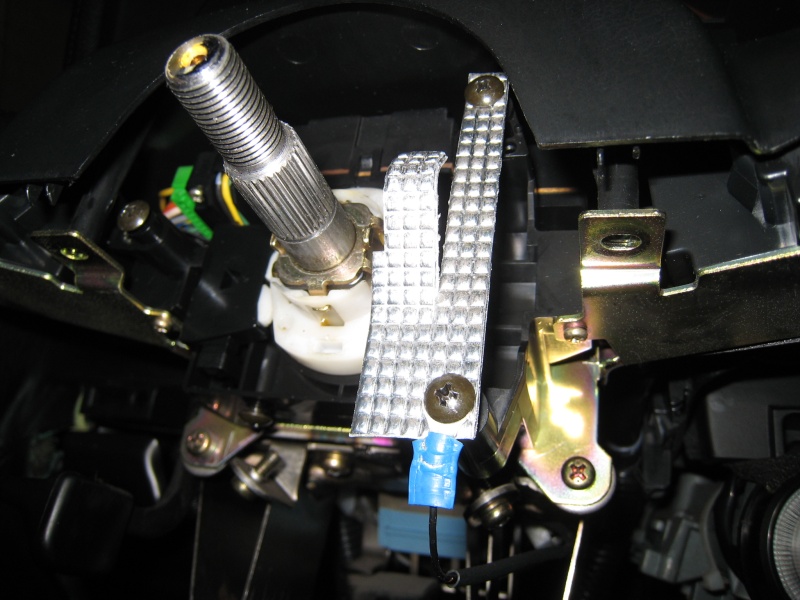

1. Park the car so that the steering wheel is in the straight position.
2. Remove the cable from the battery terminals.
3. Removing the SRS module

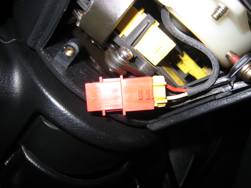

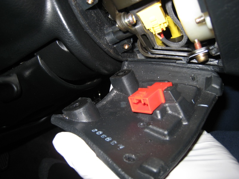

There are three TRX Star screws to be removed. Two on the left and one on the right side under the cover. You may be able to see on the photo that red thread lock being used on these screws so be careful not to damage the screw head when removing them.
Take off the left side cover first and remove the RED connector from it.
Immediately, insert this Red connector to the SRS module connector as in the photo. This is to avoid accidental trigger of SRS by static current.
Attachment 5422 Attachment 5421 Attachment 5424

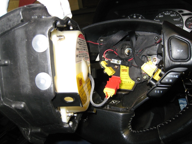

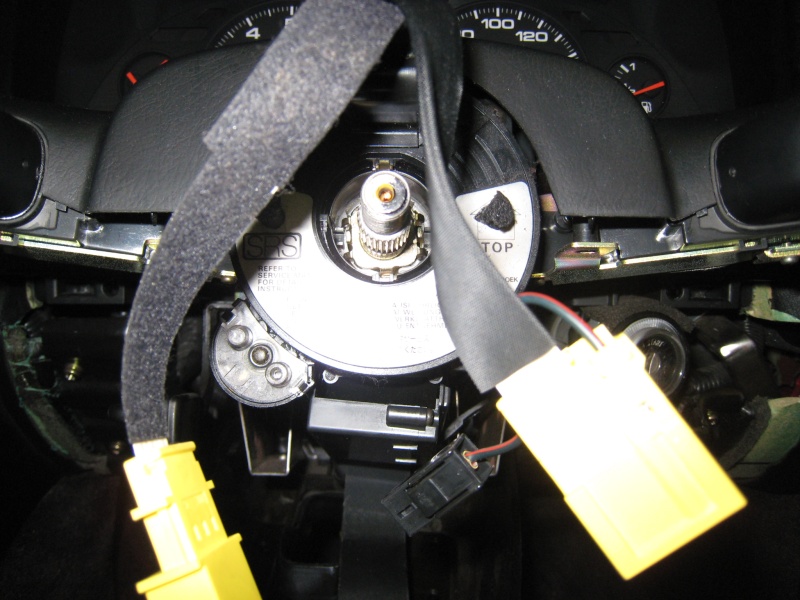

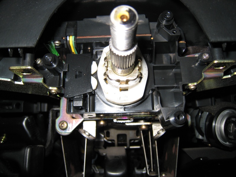

Now move to the right side cover behind the cruise control set/resume switch.
Just remove the middle screw which is the only TRX one on this side.
Now you can take out the SRS module like this.
