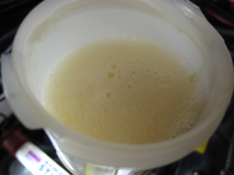

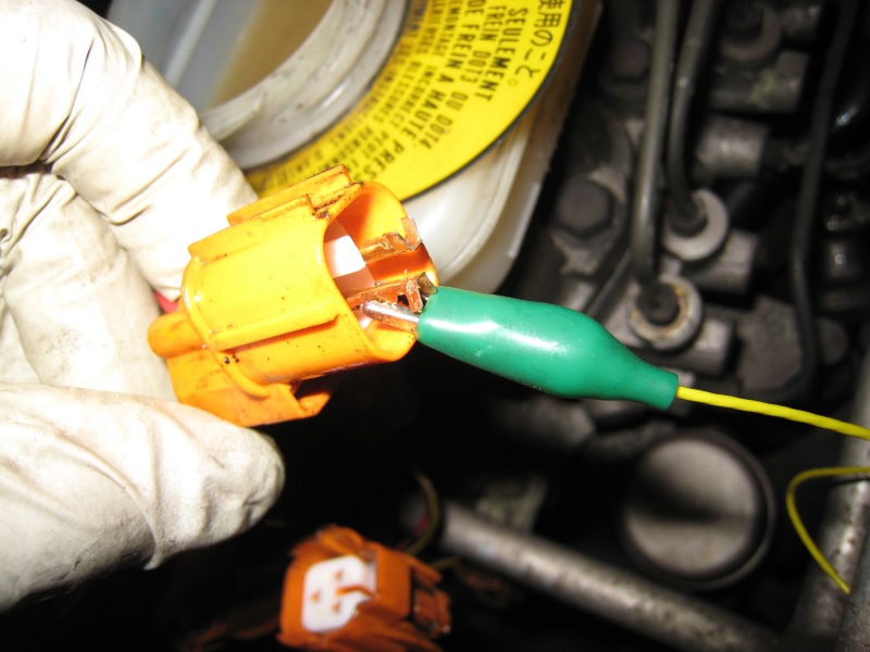

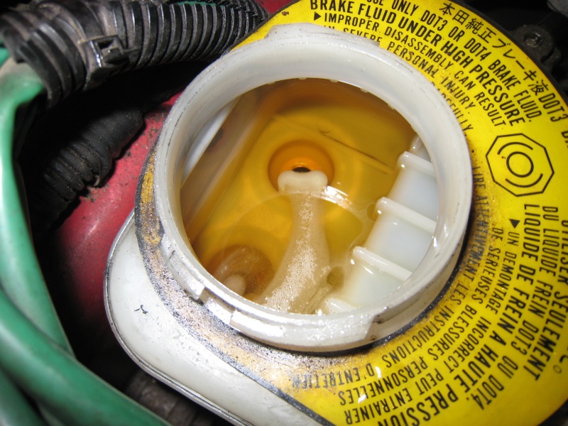

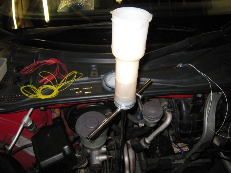

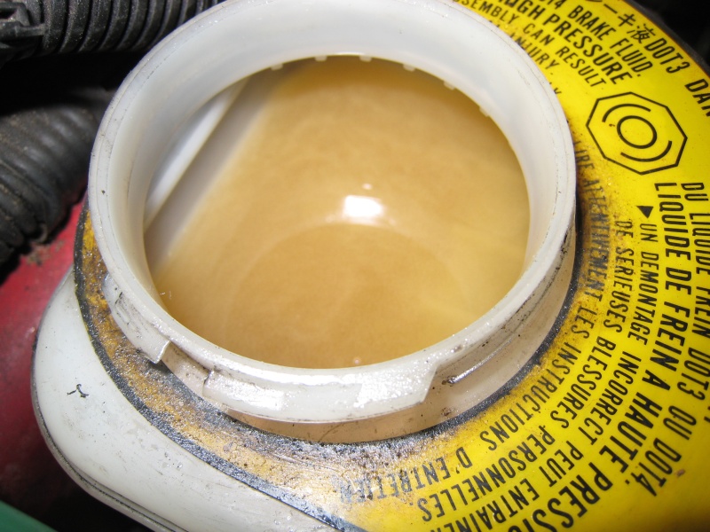

With standard ABS service at the main dealer, they will only replace the brake fluid inside the ABS reservoir and that’s it. This is better than doing nothing but it won’t replace any fluid at the chamber around the four solenoids for each wheels.
It is recommended to bleed the ABS accumulator and flush the four solenoids at least once in two years time but ideally every year.
So, although ABS system on this NSX was serviced by the main dealer, it was still full of air with dirt inside.
Attachment 6428
Attachment 6432 Attachment 6430 Attachment 6431
I normally bleed the accumulator twice using fresh fluid. Then, for each solenoids, I’ll activate it in a short burst using the full amount of fresh fluid stored inside the accumulator until there is no more pressure built inside there. Then, before moving onto the next solenoid, I’ll drain out any fluid inside the ABS reservoir in order not to mix any debris from the solenoid and the old fluid. After all four solenoids were flushed, I’ll further bleed the accumulator twice to complete the service.
Attachment 6429
By this time, the fluid returned to the ABS SST T-wrench would be clear with no air inside the accumulator.
This NSX was very lucky that none of the solenoids were sticky.
Quite often, at least one of them was sticky and either not returning any fluid back to the reservoir or causing slow leak over many hours. There is a technique to cure this problem but in the worst case scenario, you will need to disassemble the ABS solenoid housing or upgrade to the later ABS spec.

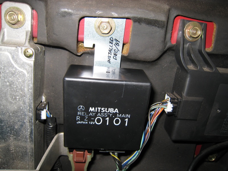

3. Main Relay

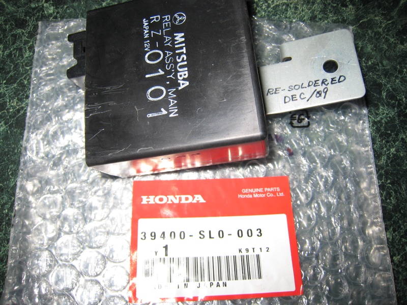

Another common failure parts on our NSX. This one is non-DBW model so it was easy to replace it.
Attachment 6434 Attachment 6433
The original one was opened up and re-soldered so that it could be used as an emergency spare for other owners.
Looking at the date stamped on the actual internal relay, it was really old and still using the small spring which was from the old design. There was a tiny hairline crack at the solder joint so I’m glad we replaced it now….

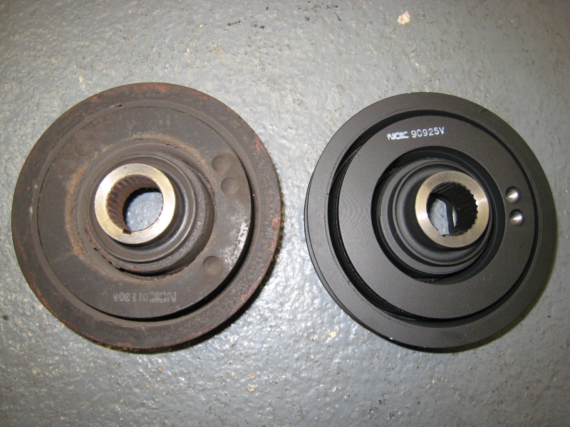

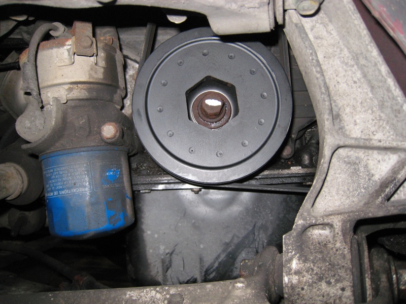

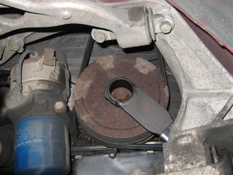

4. Crank Pulley – MT version
On this NSX, the timing belt was replaced in the past but not the Crank Pulley.
Considering the age of this NSX, we decided to replace the pulley as a preventative measure.
Attachment 6436 Attachment 6435 Attachment 6437
Although the pulley bolt was removed during the last timing belt service, it was not cleaned/greased properly so it took quite a lot of torque to loosen it but not too bad compared to other ones.
The original one looked really rusty and tired….
The new one installed with the pulley bolt properly treated and torqued to the spec.
It will be fine for many years.

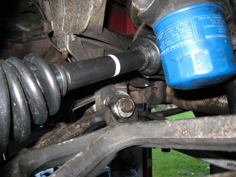

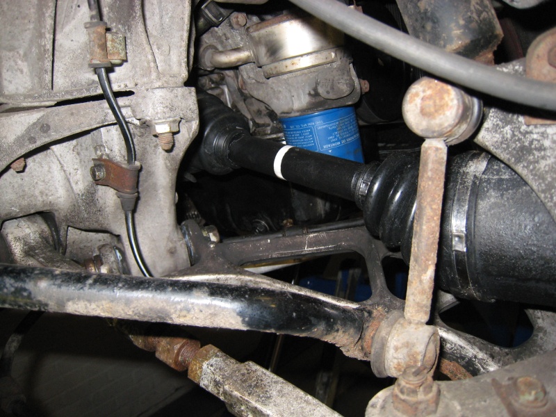

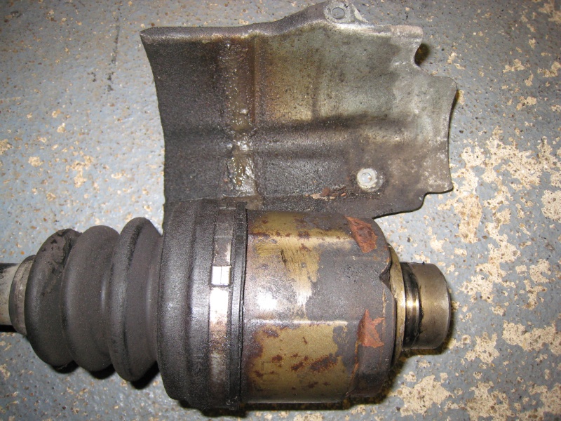

5. Driveshaft – Right side
This is one of the weakest points on our NSX.

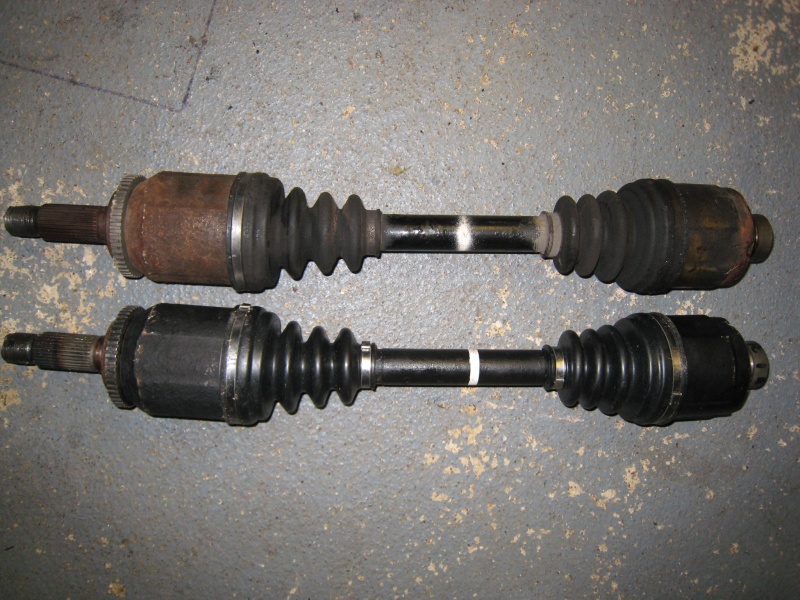

Almost all of the NSX will suffer from leaking joints on the driveshaft especially at the right side.
This one was the same and already making noticeable ‘click’ when the wheel was turned by hand.
Attachment 6441 Attachment 6440 Attachment 6442

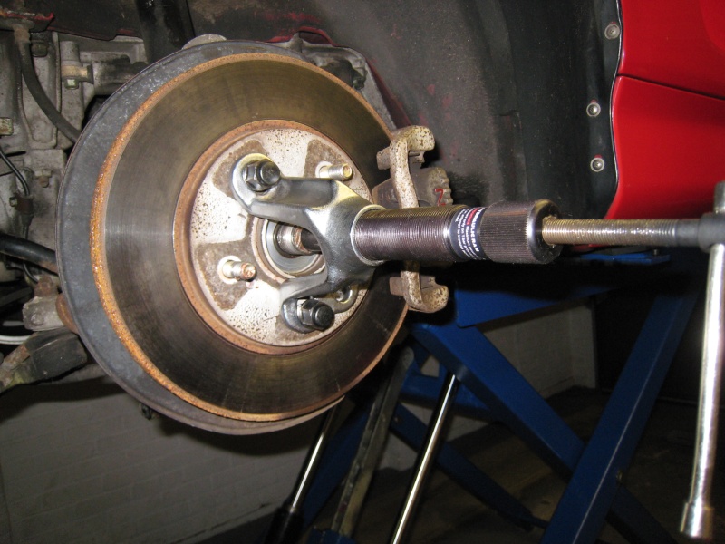

For most of the NSX, the joint can be separated from the hub/spline with reasonable amount of force. However, on this one, it looked as if it was never removed and heavily corroded that it just didn’t want to come out.
In the end, I had to use the hydraulic hub puller with one big tap to crack open the corrosion. The inner joint was leaking and the outer one was making the ‘click’.
In order to speed up the process, I normally prepare the refurbished one ready for the replacement. During the refurbishment, each joint will be inspected in detail. Then, each roller will be disassembled, cleaned, then lots and lots of pin bearings are packed with new grease to reassemble the roller. With this process, it will provide you with completely different feeling when the joints were turned by hand.
The joints and the shaft were painted in black and using the new boots and grease, the length was set to the spec to adjust the amount of air inside the boot to complete the refurbishment.
Attachment 6438 Attachment 6439
Beautiful driveshaft in place.

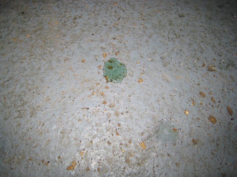

This morning, I noticed small amount of coolant on the garage floor.
Although the tiny amount of leakage from the drain bolt was spotted during the last Health Check Service, it looks like the recent severe cold weather and rise of temperature this morning speeded up the leakage.
Attachment 6443 Attachment 6444
I’ll be replacing the two O-rings next week…

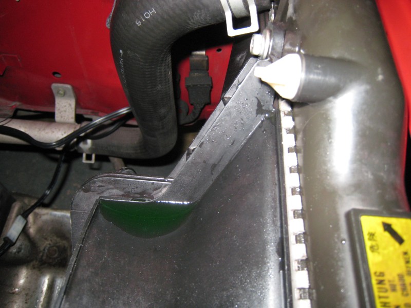

As reported in the previous post, it was leaking small amount of coolant on my garage floor from the bottom radiator drain bolt.
However, after the car was left inside the garage for a longer period without any engine fire up, I started to notice very slow leakage (a few drips per day) from the top bleeding plug as well.
Attachment 6458
It won't start dripping on the floor until after many weeks as it will be first trapped in the pocket behind the radiator.

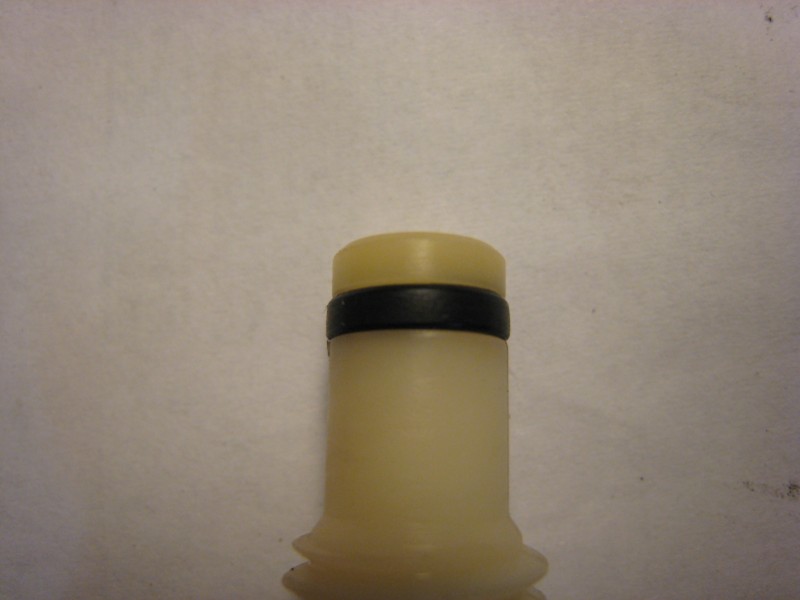

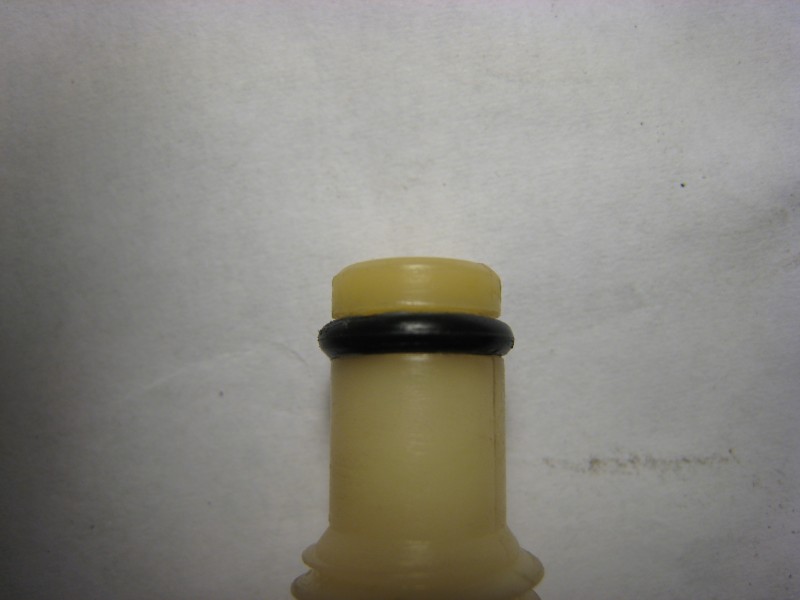

Time to replace O-ring at both drain/bleeding bolts.
As I had spare drain/bleeding bolts in stock, it was easy to replace the O-rings once I received them from Honda.
Attachment 6459 Attachment 6460
The old (Left) and new (Right) O-ring.
The old one was almost flat and not doing any job.

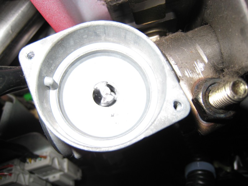

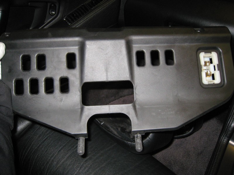

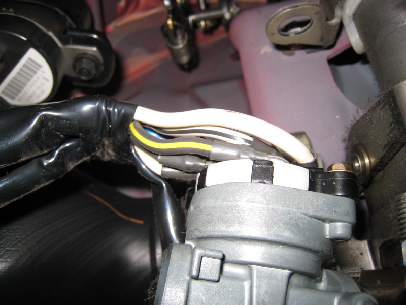

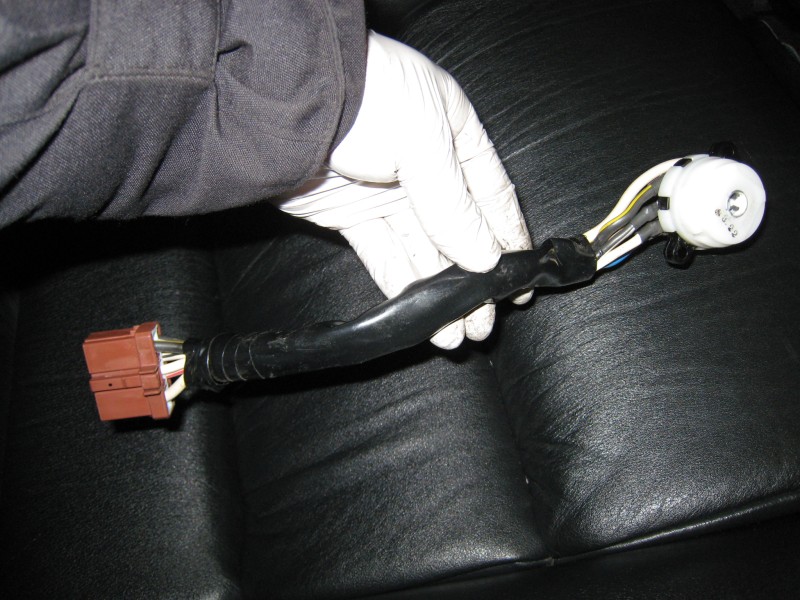

After removing the [Edit: deleted 'two'] lower panel, you will be able to access the two small bolts holding the IGN Switch comp. It is at the very back of the key cylinder and it has lots of thick wires soldered to it.
Attachment 6464 Attachment 6465
There is a brown connector at the other end. After removing the switch comp, the key cyl side will look like this. This will provide you with the original position of the contacts inside the white cover described in the next post.

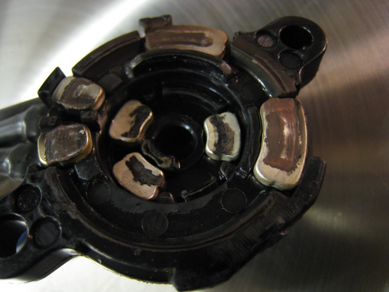

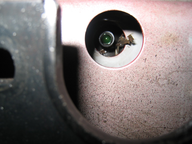

4 Attachment(s)

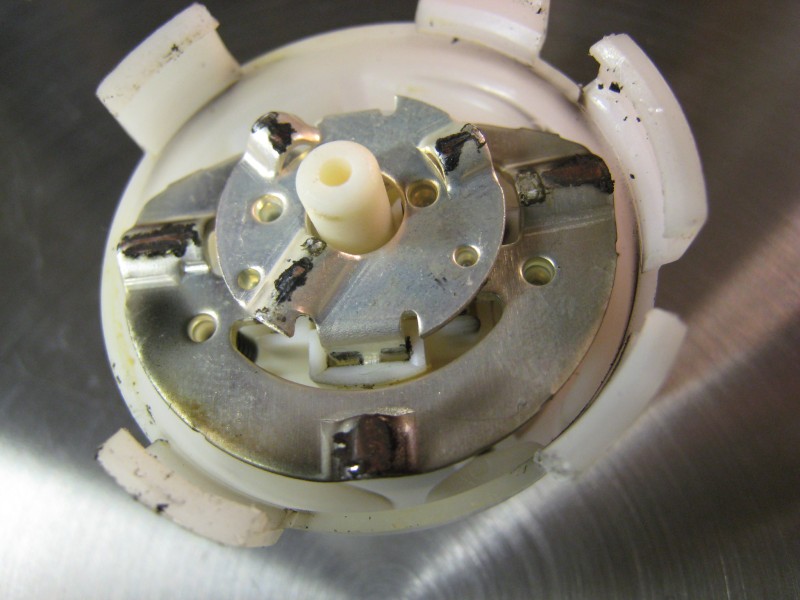

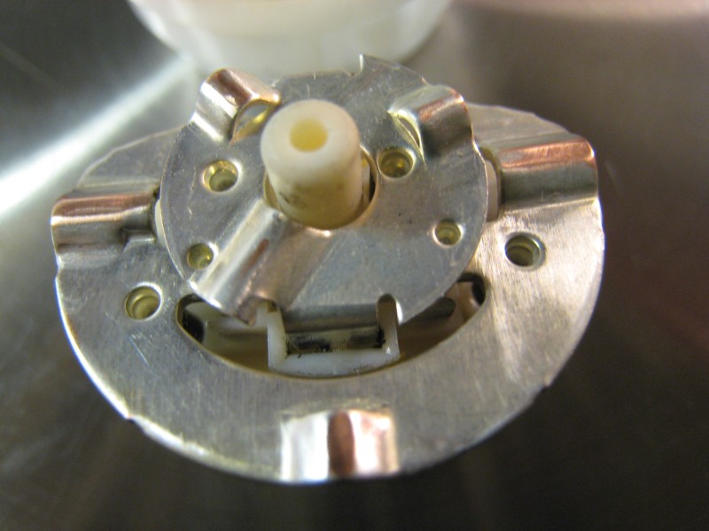

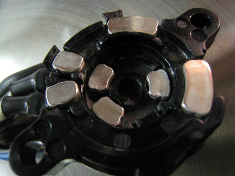

On the IGN switch comp, you can remove the white cover to expose the internal contact points. The cover will only fit in one orientation so no need to worry about its original position.
As expected, even after just 3 years, the contacts were already showing fretting corrosion residue.
Needs to clean them again.
You can carefully take out the contacts assy inside the white cover but before doing so, please make a note on its original orientation as you want to put it back into the 'Lock' position.
I normally use super fine wet sanding paper with very little force to re-condition the contacts surface.
Attachment 6466 Attachment 6468
Attachment 6467 Attachment 6469
Before (Left) and After (Right) of each contacts assembly.
Re-assemble everything and test the key operation several times before going out for a test driving, if I can...
