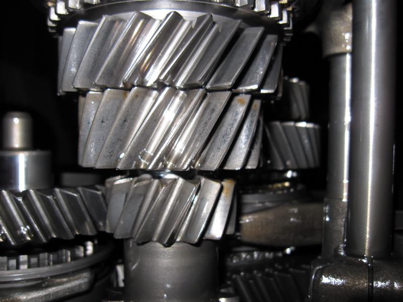

Opening the box, at first sight:
- snap-ring ok
- countershaft bearing (the one at the snap-ring) ok

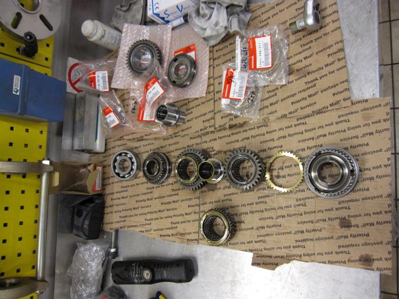

Not sure what to think about the gears. There are spots and even rust ??? on them? I didn't lend my car to 007 for diving in the sea...:)
Attachment 12773

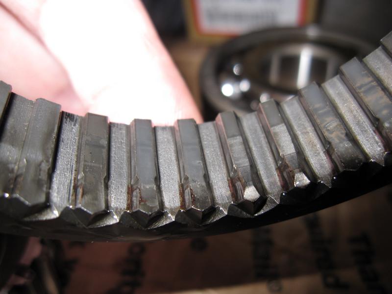

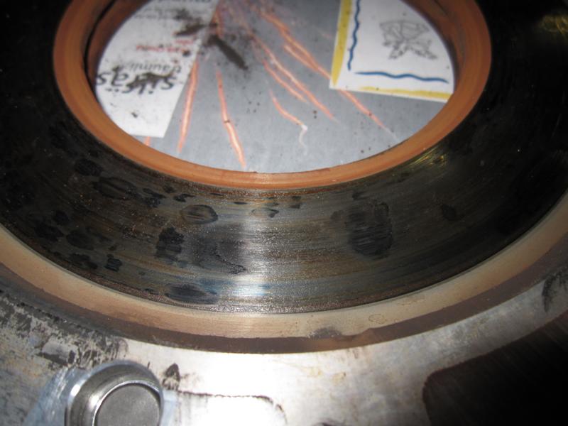

5th gear: mysterious signs of wear. I've to admit that it popped out on the German Autobahn 2-3 times but that was back in 2008 or so. Something is wrong here. Of course, I use the 5th gear a lot (a lot of cruising). Opinions?
Attachment 12772
I already have new main bearings and all synchros for sure to go in. Will do a lot of measurements by the SM tomorrow.
Expert advice warmly welcome, thanks in advance!
