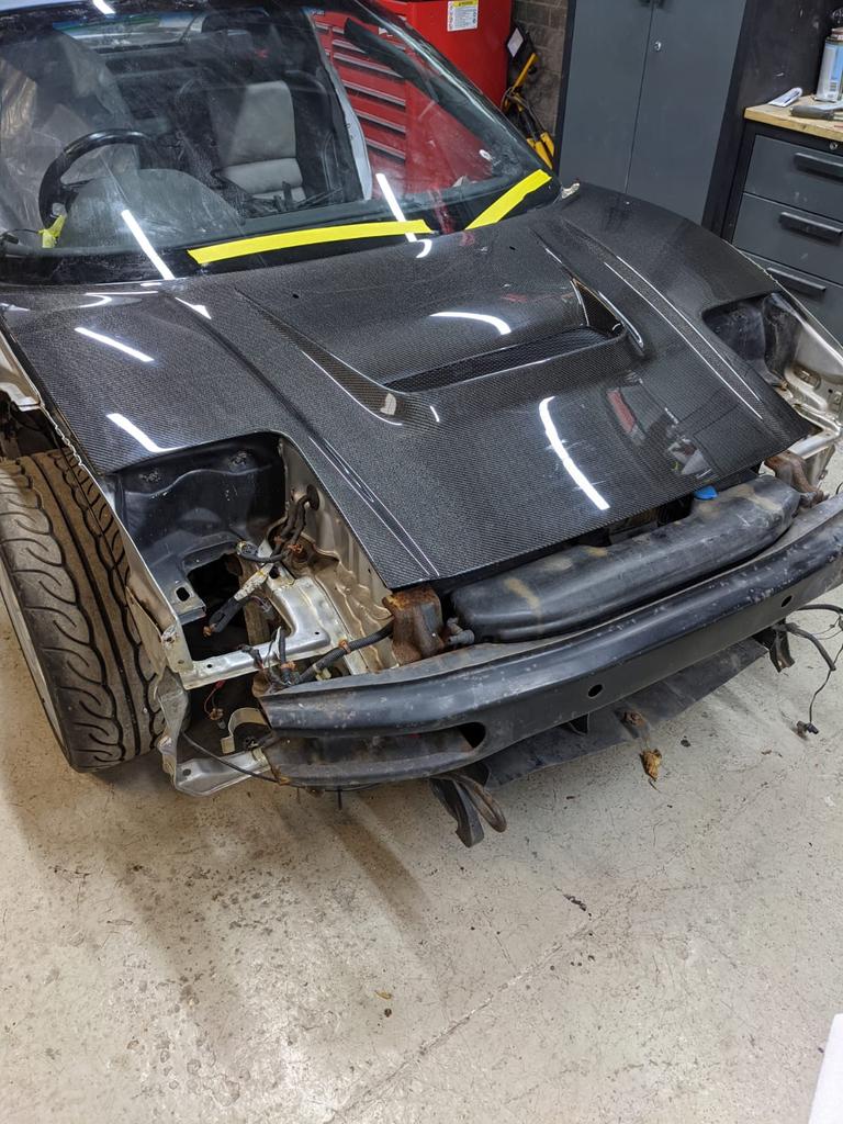

And test fit of the Seibon bonnet (although now not sure if the spare wheel fits in with the scoop):
Attachment 14412
I’m sure I was told that the design of the Seibon is such that the OEM spare will fit … however …
Why fit a lightweight carbon bonnet then shove a heavyweight spare you’ll never use underneath it? ;)
