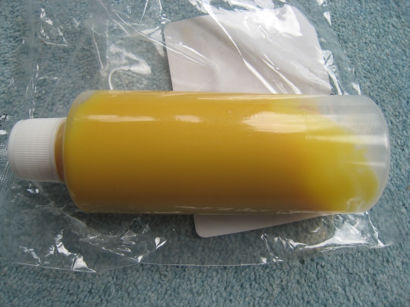

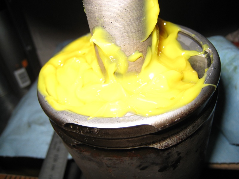

When the grease is new, it looks like yellow/cream custard colour and very-very sticky. The grease will hold its original position inside the container even you place it up side down.

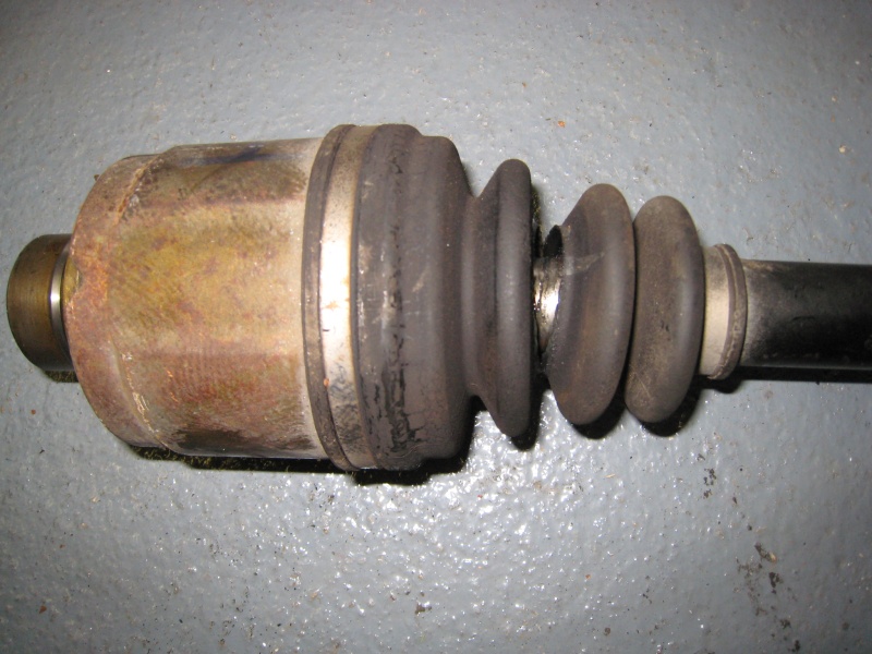

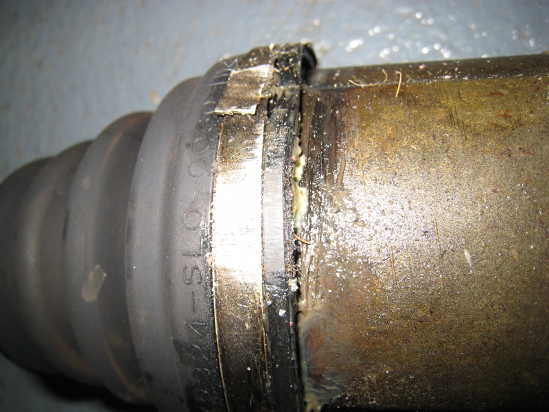

Quite often, I found damage to the boot like this one or lots of grease splashed around the boot even there was no damage to the boot. The grease got leaked from the side of the boot.
Attachment 5646 Attachment 5644 Attachment 5645
Because of the damage to the boot, lots of debris, water, etc could get inside the boot and thus, degraded the quality of the grease. Also, the grease will be leaking to the outside world resulting in loss of lubricant capacity.

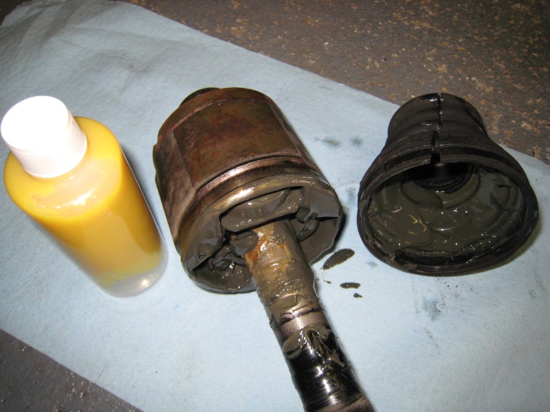

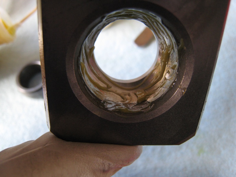

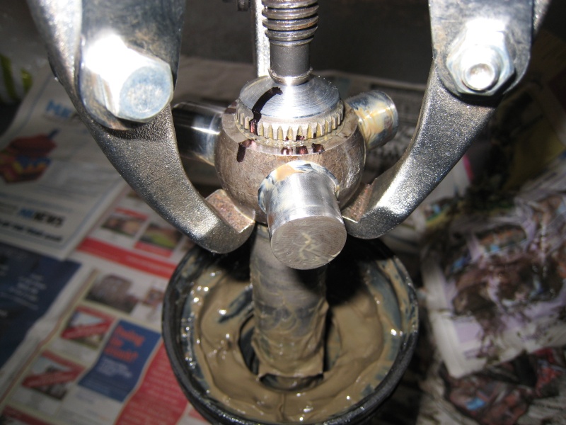

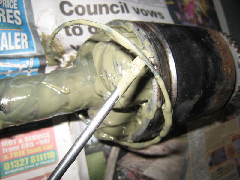

If you ignored or didn’t notice the early sign of the damage/leakage, your grease will turn into very soft character and it would look like this. When you open the boot, some of the grease simply runs down like gravy or melted mocha ice cream…. Not a good sign as it has contaminated the grease inside the three rollers with lots of tiny roller bearing inside.
Attachment 5648 Attachment 5647
