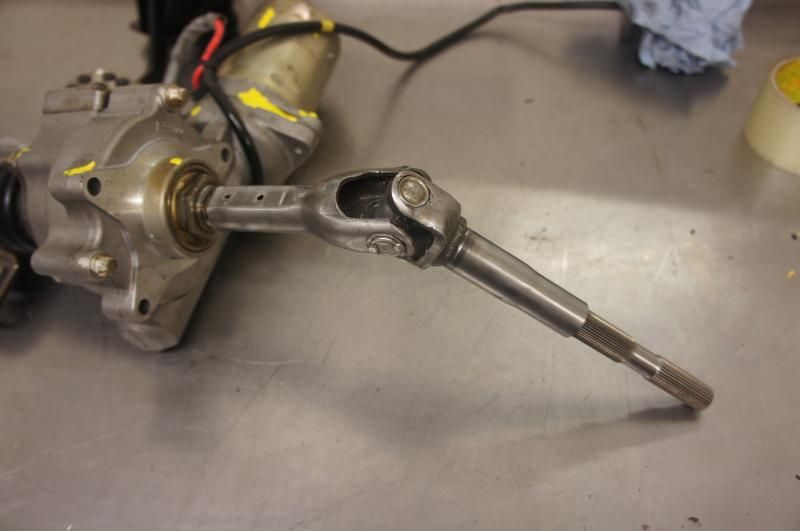

Been a lot of trial and error to fit the EPAS system to the car using a manual NSX rack I had with the EPAS system. But in the end using a combination of the GM unit, NSX and EP3 parts it fits perfectly and the UJ movement is perfect. I have even managed to get the existing steering wheel surround to fit
The EPAS unit with modified UJ and column

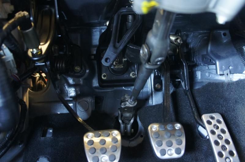

Alignment of the column is perfect. I hope you like my (ahem) Type R pedals
