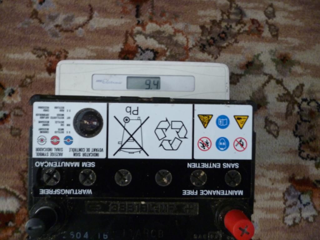

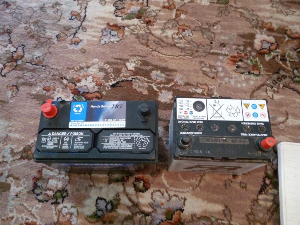

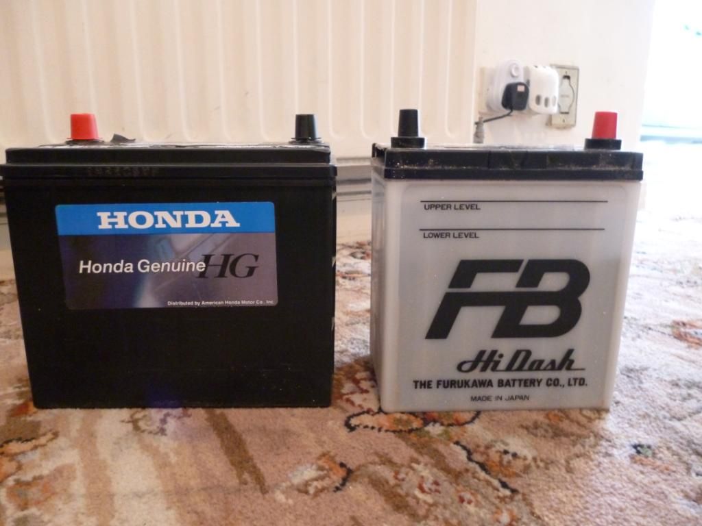

Ok little update on the NSX-R battery.
There were in fact 2 types of battery used in the NSX-R! But from my research, it was only on the facelift model.
Pre-Facelift NSX-R used the battery I posted earlier, type 55B24L; however the facelift NSX-R used either 55B24L or the smaller type 38B19L as seen above.
It would seem that only facelift NSX-R models that had no AC, no airbags, navigation etc, used the smaller battery!
The smaller battery weighs 9.4kg on my scales, and it is either Yuasa or FB asseen in my phitos, exact same battery and comes fom Homda, again this battery is nothing special and its shared with other honda models, [at least in the country it is] it can be purchased from your dealer and not that expensive either, again this applies to UK.
