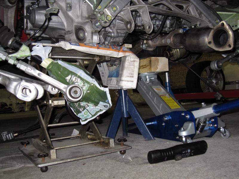

Yes, I forgot the bloddy release bearing fork. Asylum forgot it, I forgot it. I hope Pride won't forget it too. :) Will have to take the gearbox off again, initialize the clutch, mount the fork and on we go with a second attempt to fit the gearbox on the engine.
