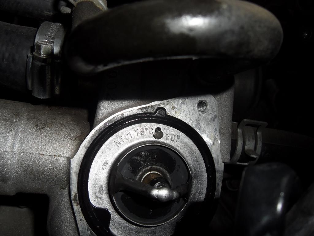

One free you will the thermostat in its place
http://i77.photobucket.com/albums/j7...t/SAM_0270.jpg

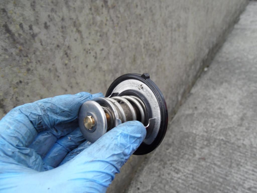

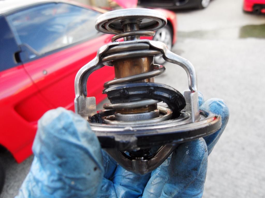

There is a little tiny metal catch at the top of the thermostat and with a pair of needle noe pliers I took hold of that and stat came fee nicely
http://i77.photobucket.com/albums/j7...t/SAM_0271.jpg

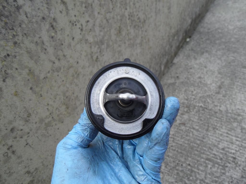

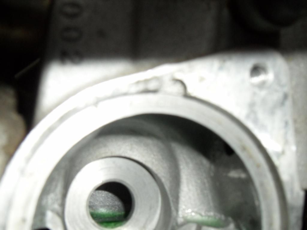

With the the stat removed it was easy to see the problem
http://i77.photobucket.com/albums/j7...t/SAM_0272.jpg
http://i77.photobucket.com/albums/j7...t/SAM_0273.jpg

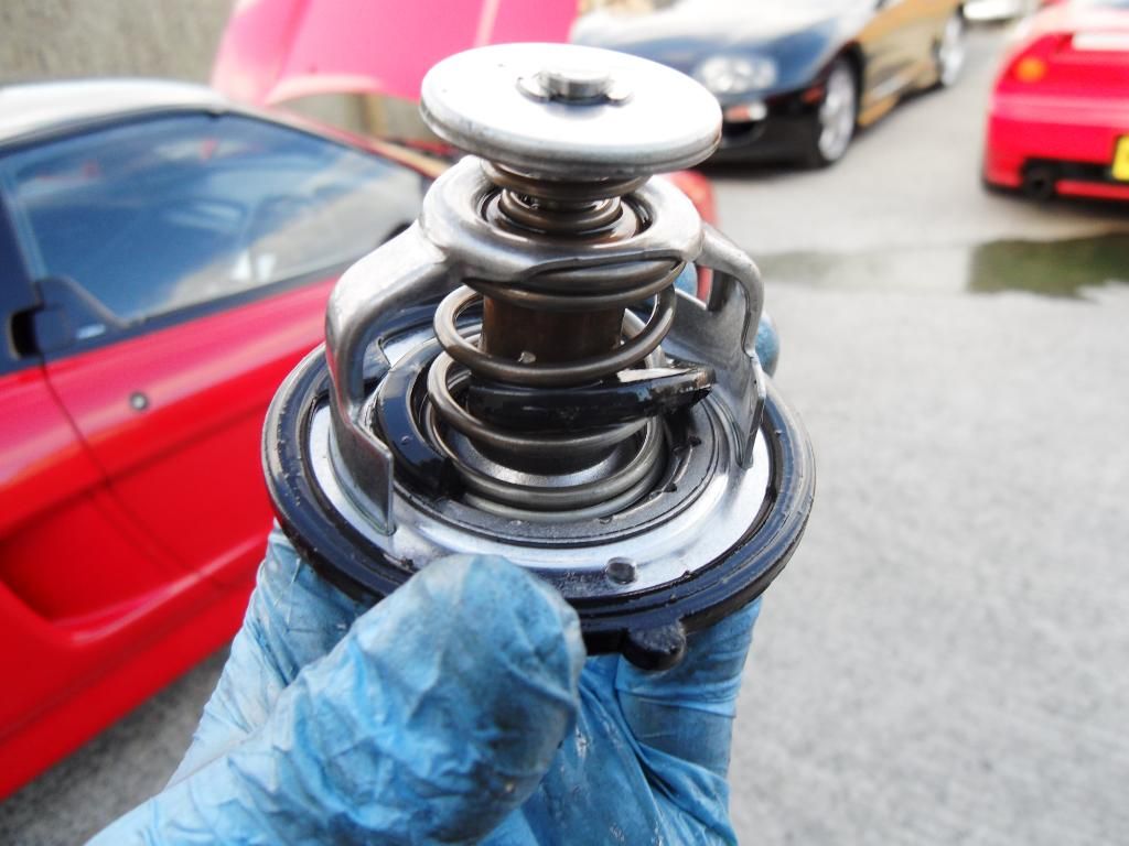

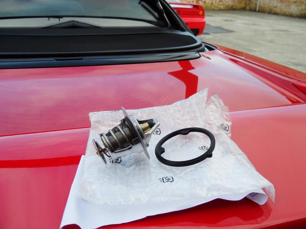

I have a new OEM stat which is slightly different to my old one
http://i77.photobucket.com/albums/j7...t/SAM_0257.jpg
http://i77.photobucket.com/albums/j7...t/SAM_0258.jpg
So everything in reverse
Attach the new seal which came with the thermostat keeping the small single tab to the top as marked on the stat
http://i77.photobucket.com/albums/j7...t/SAM_0276.jpg
http://i77.photobucket.com/albums/j7...t/SAM_0277.jpg
In the housing you will see a small groove to where the stat fits and indicates the right way up
http://i77.photobucket.com/albums/j7...t/SAM_0278.jpg
New thermostat in place and gentle settle it in
http://i77.photobucket.com/albums/j7...t/SAM_0282.jpg
All you have to do now is replace everything in reverse and bleed the fill the coolant system!!:)
I tested my car earlier and the car now heats up in about 5 to 8 mins and stays at the correct temp when driving.

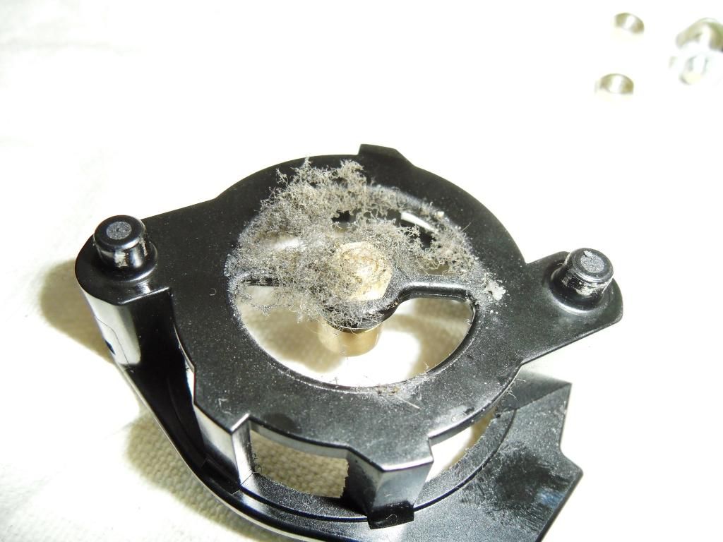

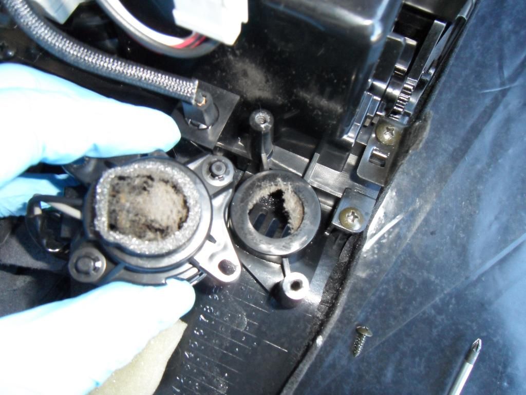

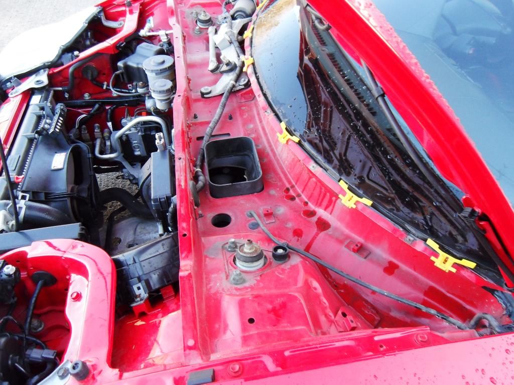

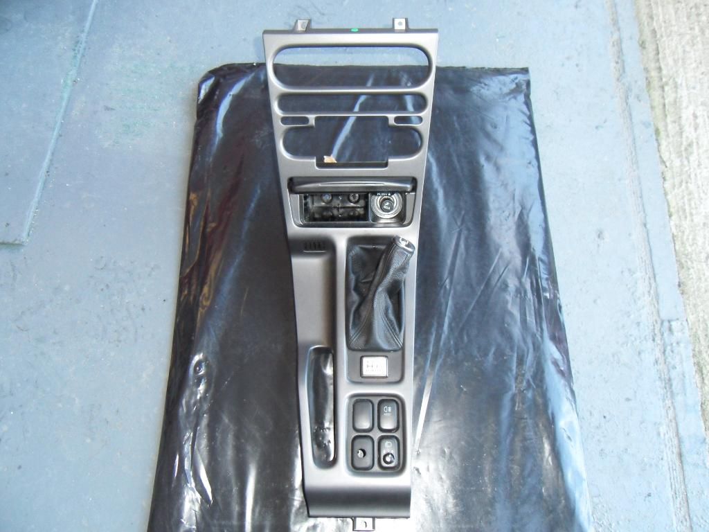

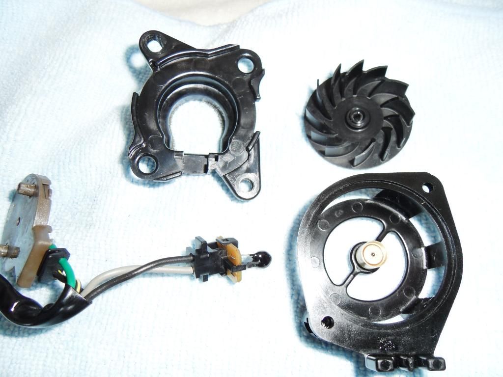

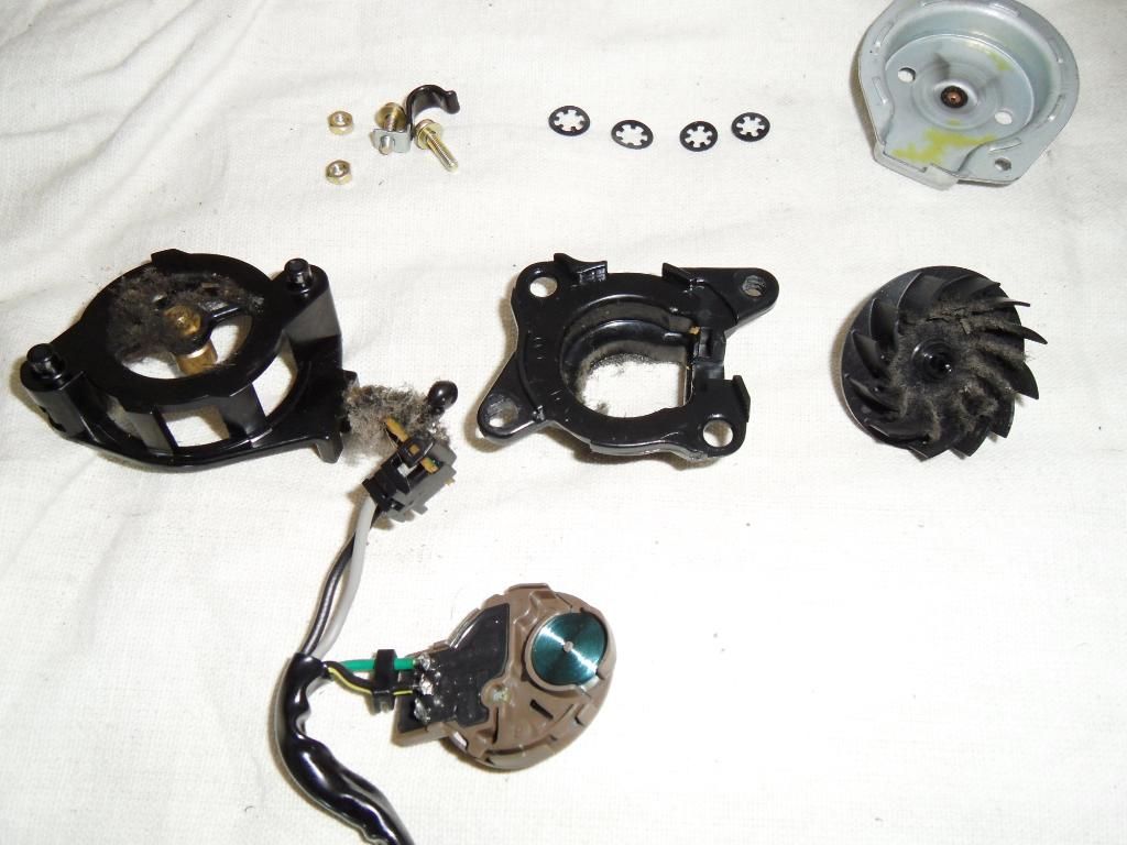

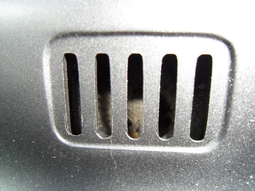

Started work on a 2002 car I received.

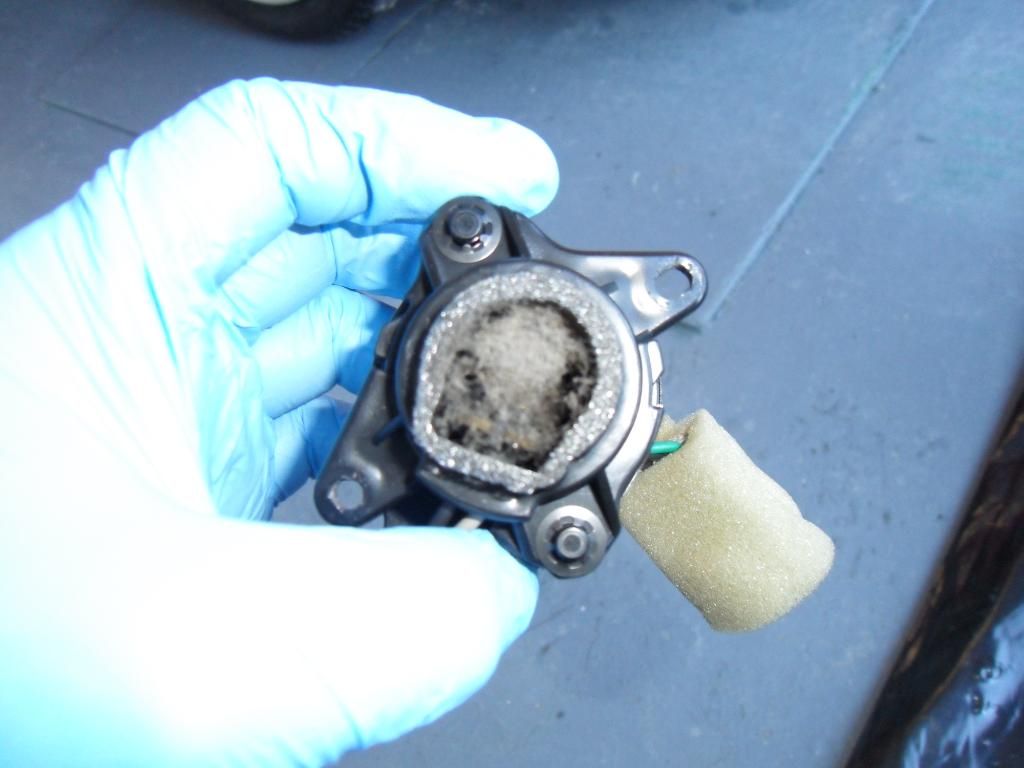

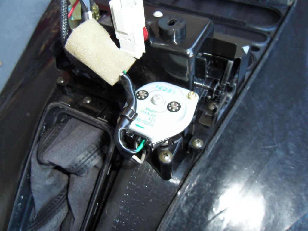

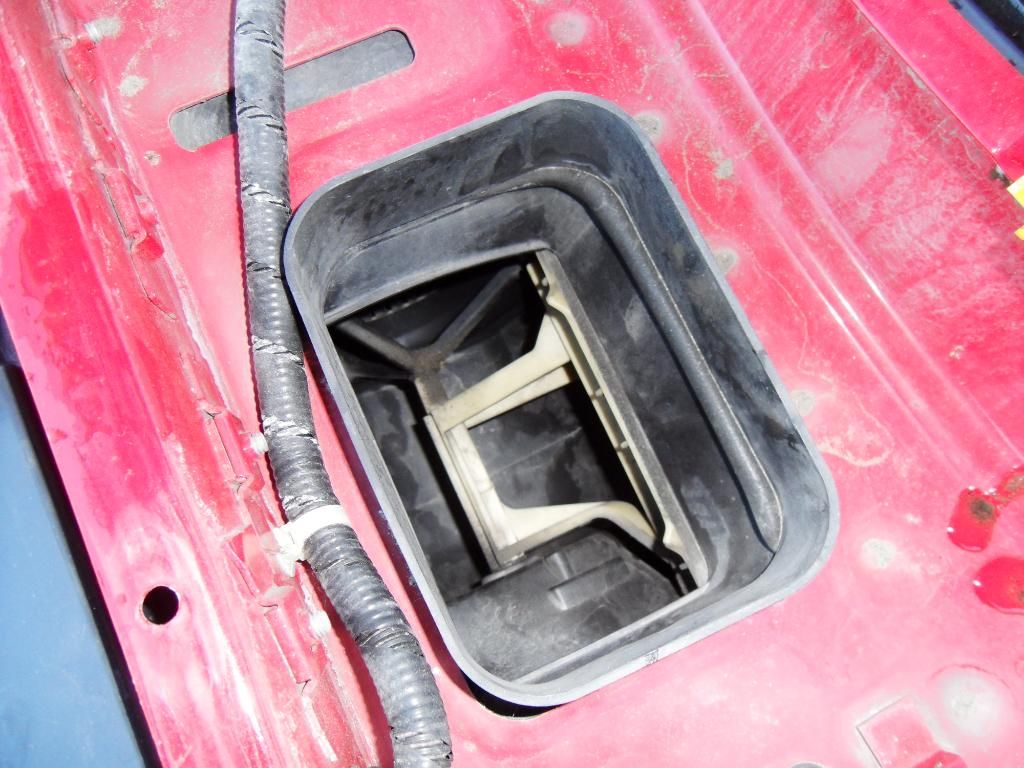

First thing I looked for was noise form the aspirator, although I couldnt hear anything I took a visual look, to which there I could see a build up through the vent
http://i77.photobucket.com/albums/j7...X/SAM_0304.jpg

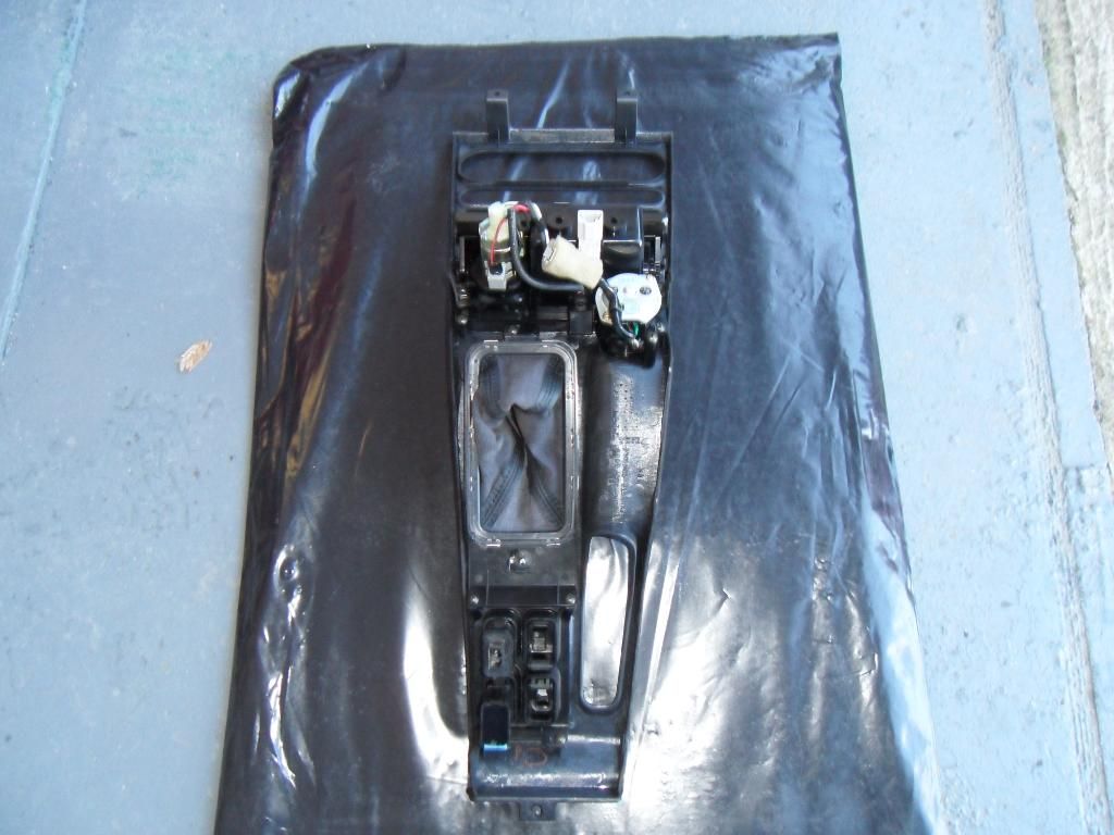

So took took the console out

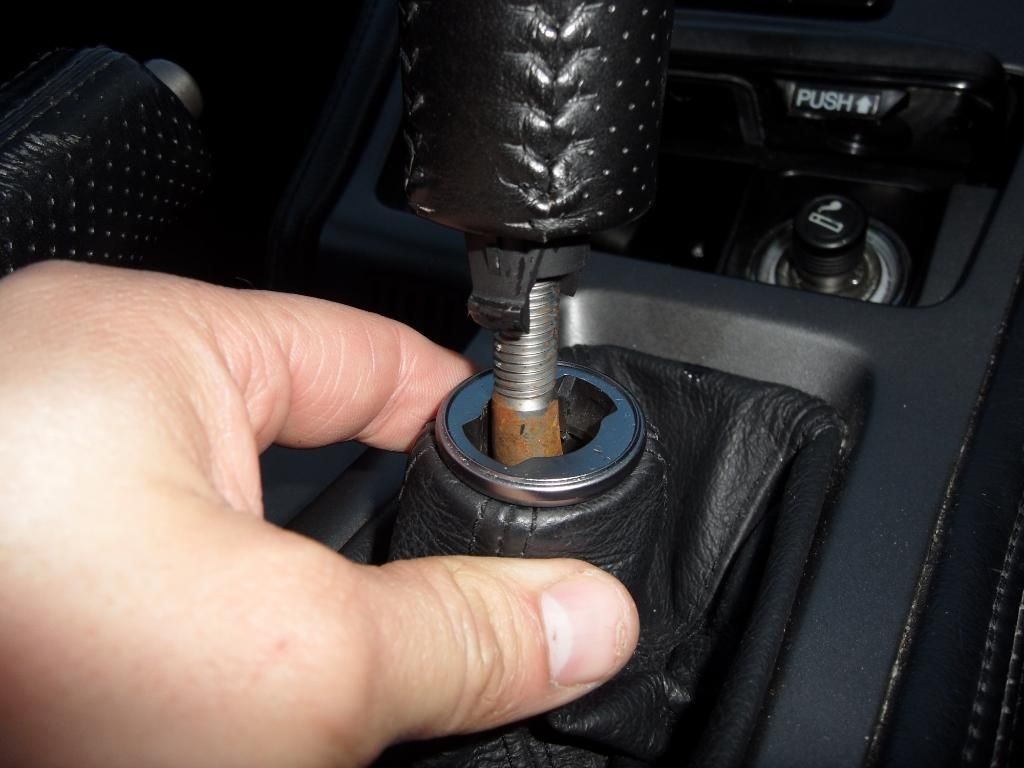

On taking it out I noticed the gear knob was not seated correctly
http://i77.photobucket.com/albums/j7...X/SAM_0311.jpg
Console removed
http://i77.photobucket.com/albums/j7...X/SAM_0312.jpg
http://i77.photobucket.com/albums/j7...X/SAM_0313.jpg
With the console removed this is what I'm after
http://i77.photobucket.com/albums/j7...X/SAM_0314.jpg
Once unbolted signs are pretty obvious, along with build around console vent
http://i77.photobucket.com/albums/j7...X/SAM_0315.jpg
http://i77.photobucket.com/albums/j7...X/SAM_0317.jpg

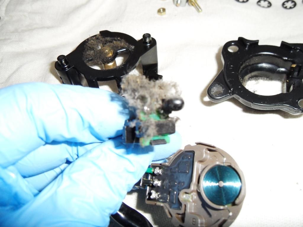

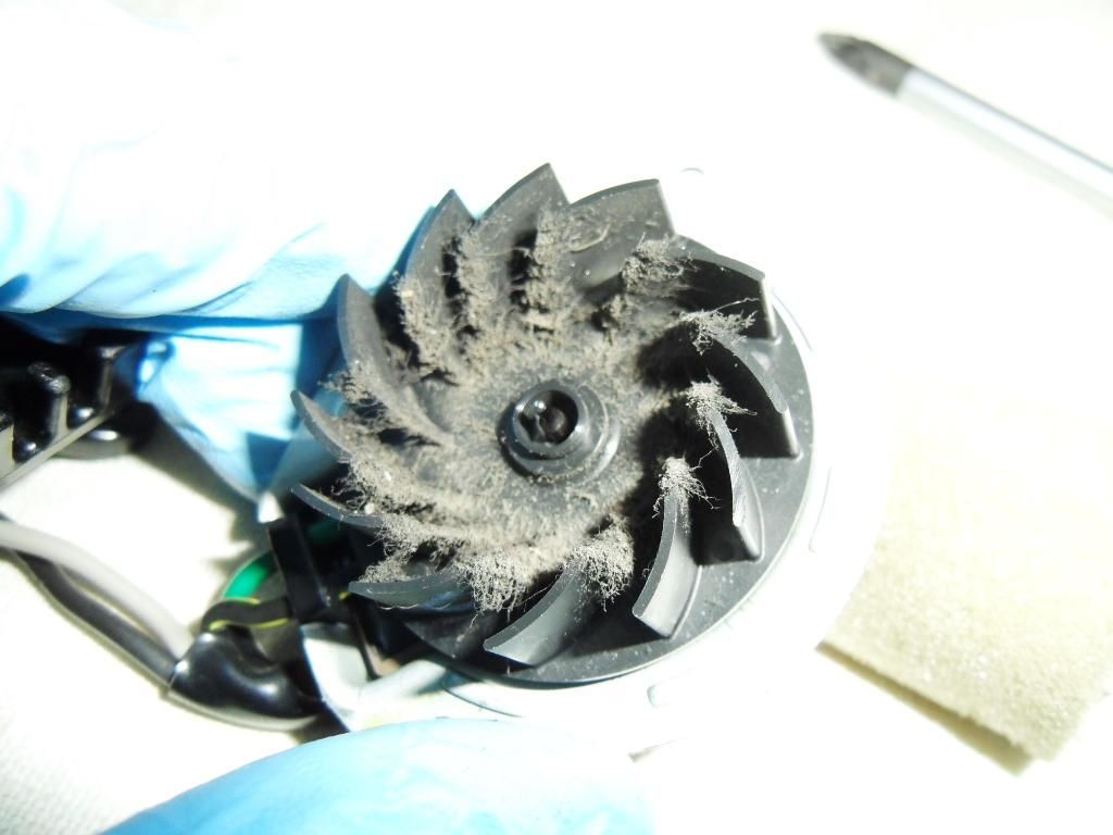

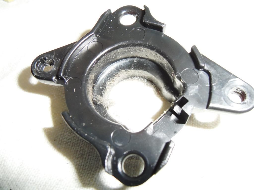

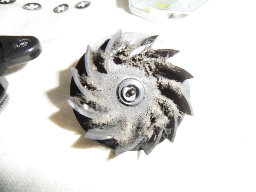

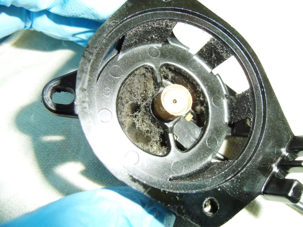

Dismantling the aspirator, you can see the build up
http://i77.photobucket.com/albums/j7...X/SAM_0319.jpg
http://i77.photobucket.com/albums/j7...X/SAM_0320.jpg
http://i77.photobucket.com/albums/j7...X/SAM_0321.jpg
http://i77.photobucket.com/albums/j7...X/SAM_0322.jpg

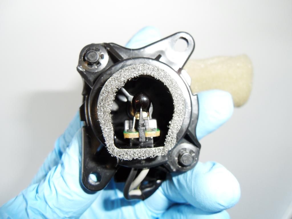

To clean the aspirator, I used combination of Pressure Air, Meguiars cleaning swabs and micro fibre cloth for lifting static debris
http://i77.photobucket.com/albums/j7...X/SAM_0326.jpg
http://i77.photobucket.com/albums/j7...X/SAM_0328.jpg

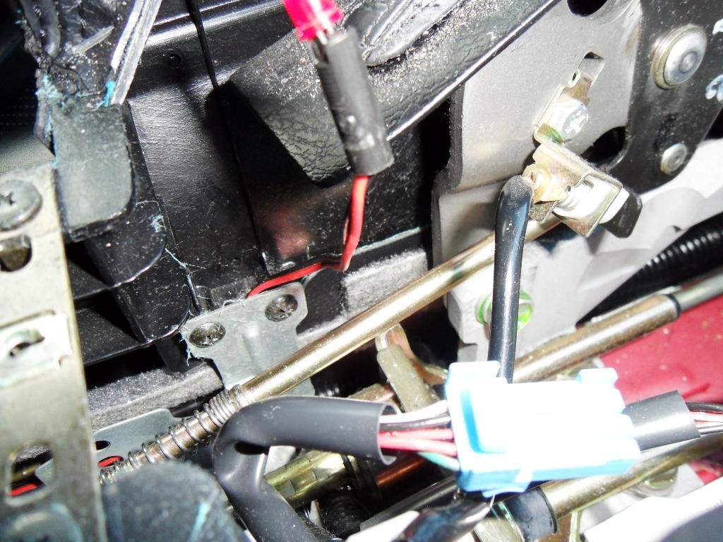

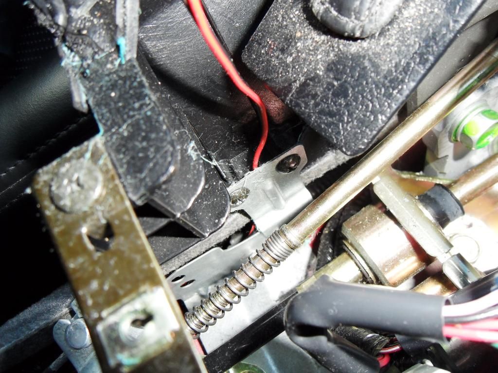

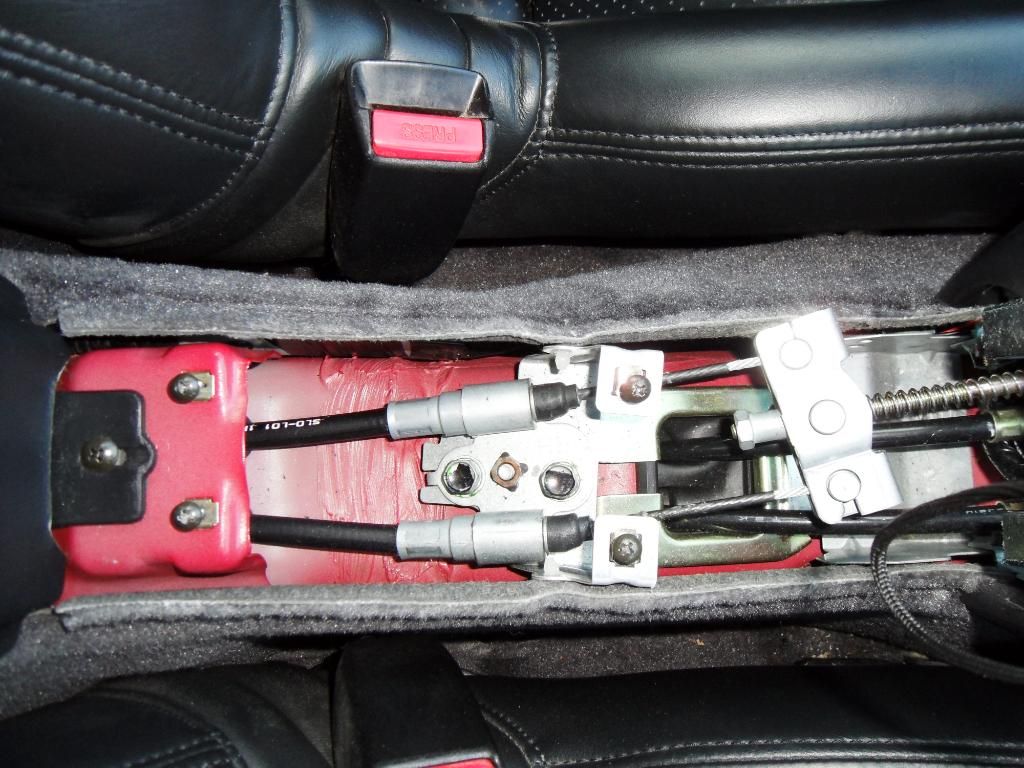

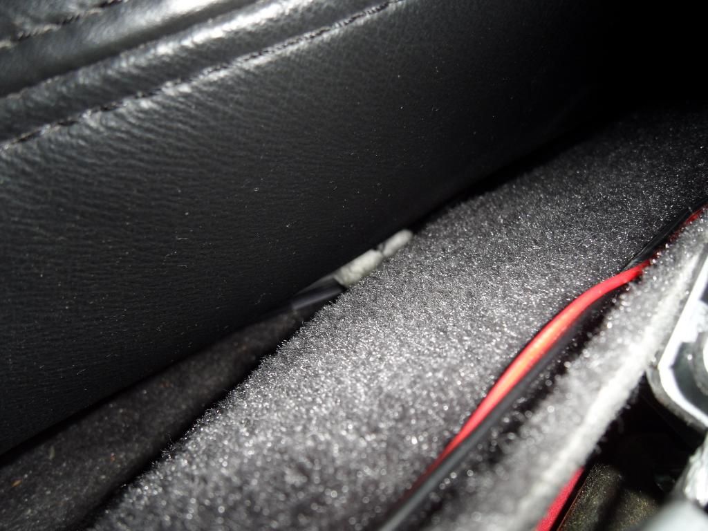

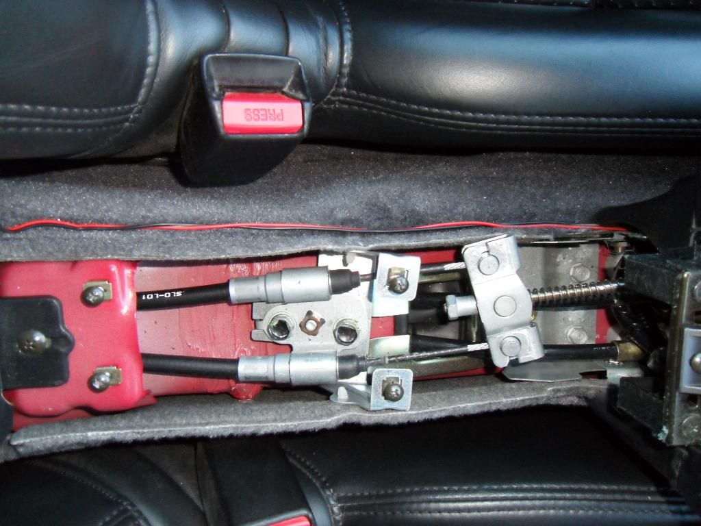

With the console out I noticed tracking of the LED Alarm light was not great and was visible from the passanger side hanging below the centre tunnel.
http://i77.photobucket.com/albums/j7...X/SAM_0308.jpg
http://i77.photobucket.com/albums/j7...X/SAM_0309.jpg
I tidied this up and tracked the wire inside the tunnel, away from the hand brake mechanism and tucked into the console retaining bracket.

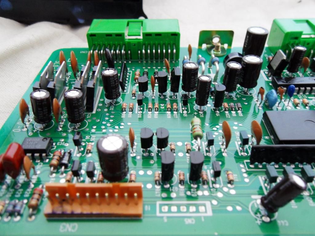

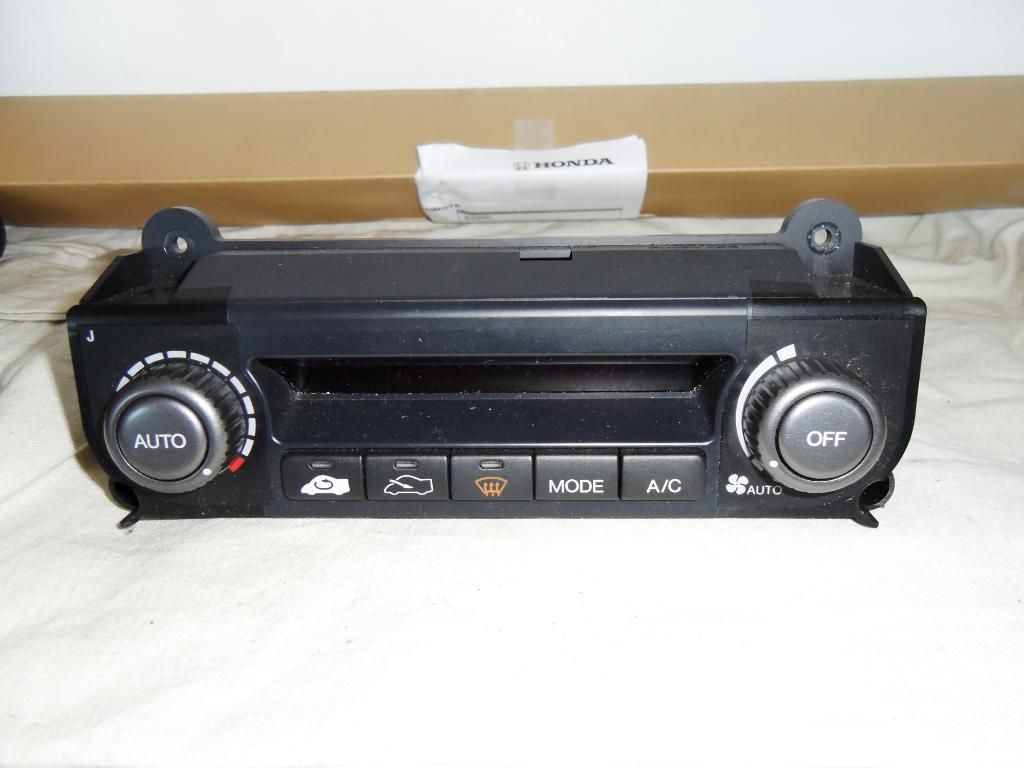

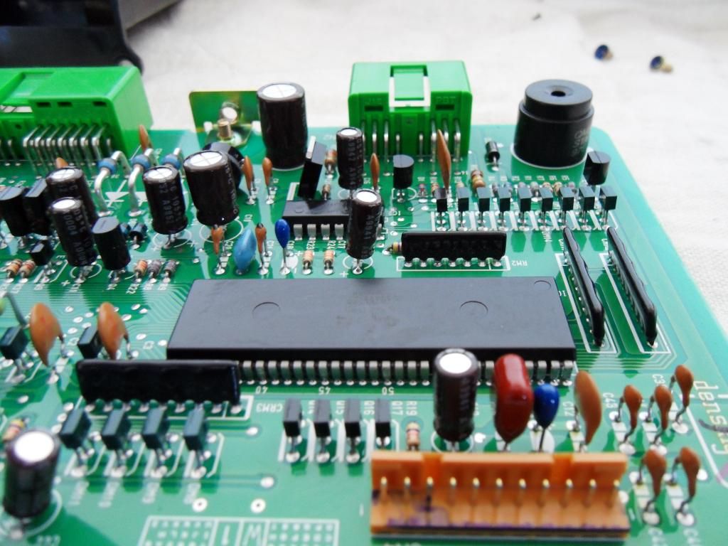

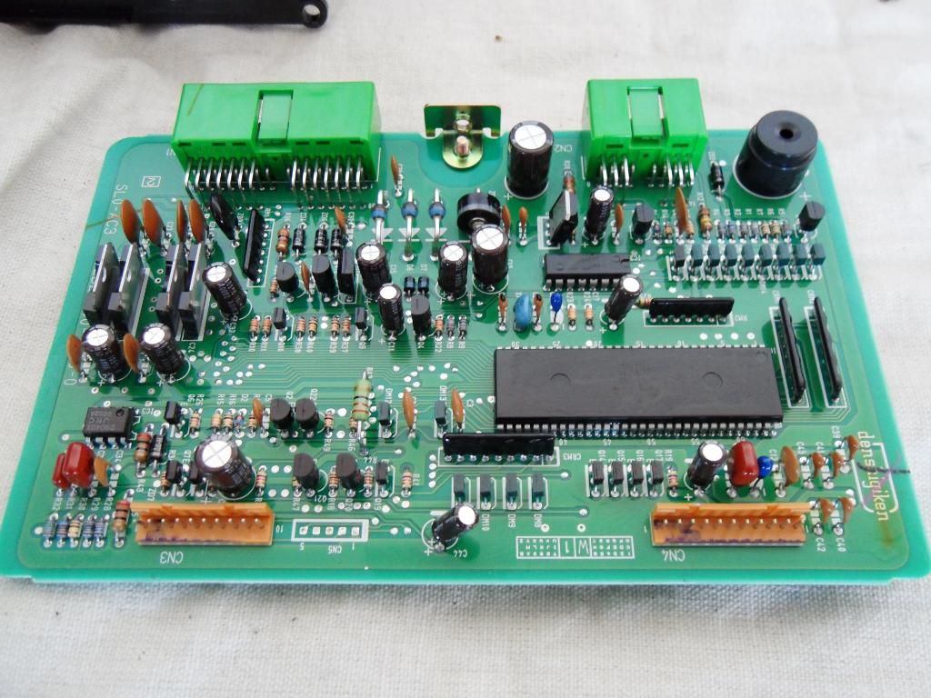

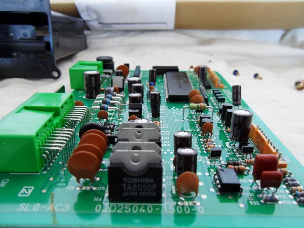

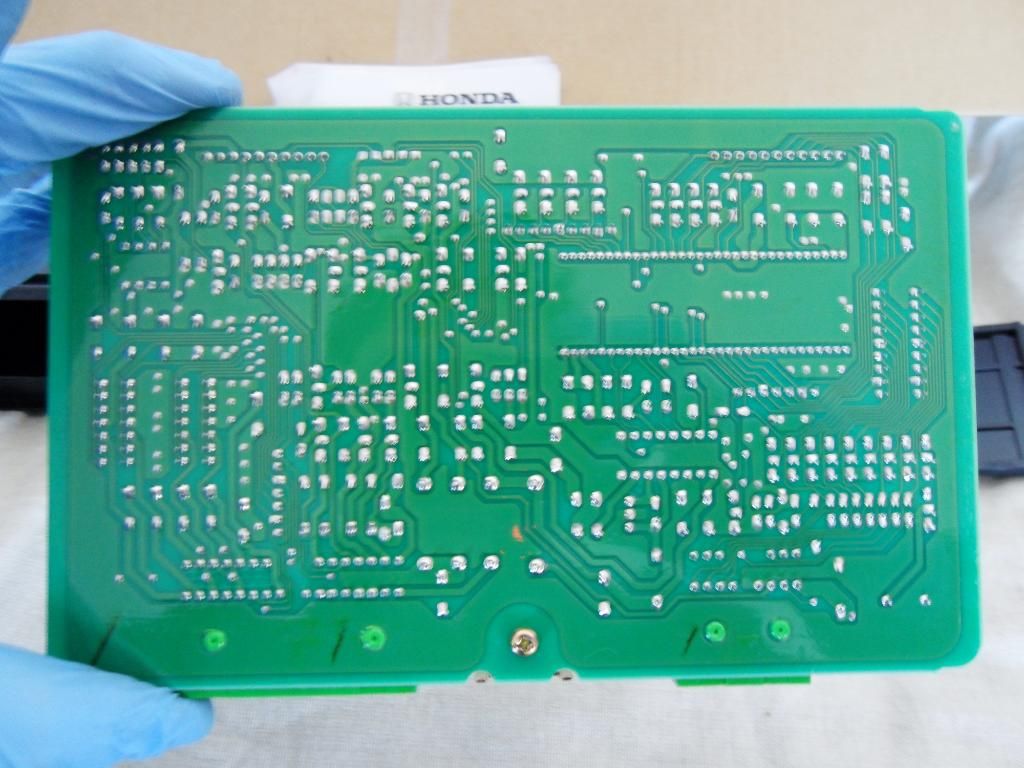

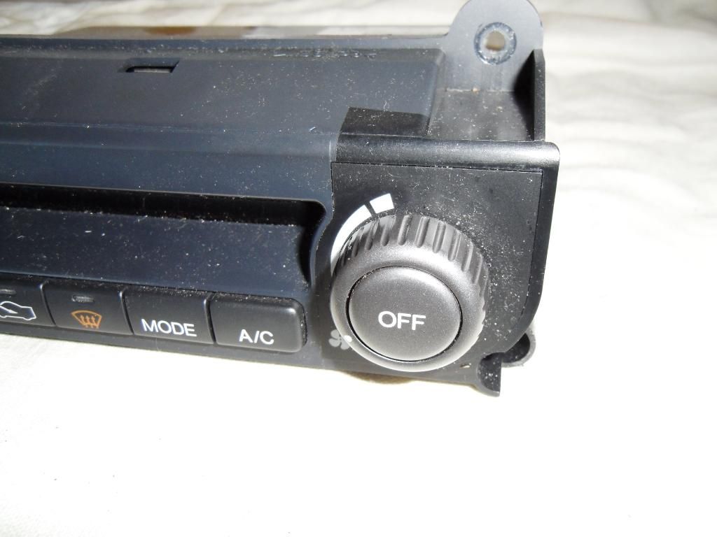

With the AC controller removed I checked the board and capicators for damage. Interesting to see they changed the color of the knobs lol
http://i77.photobucket.com/albums/j7...X/SAM_0334.jpg
http://i77.photobucket.com/albums/j7...X/SAM_0335.jpg
Board removed, and its looks all brand new! But as Kaz mentioned, capacitors can give up anytime depending on use and so forth

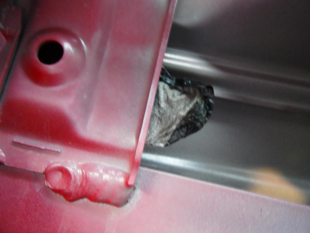

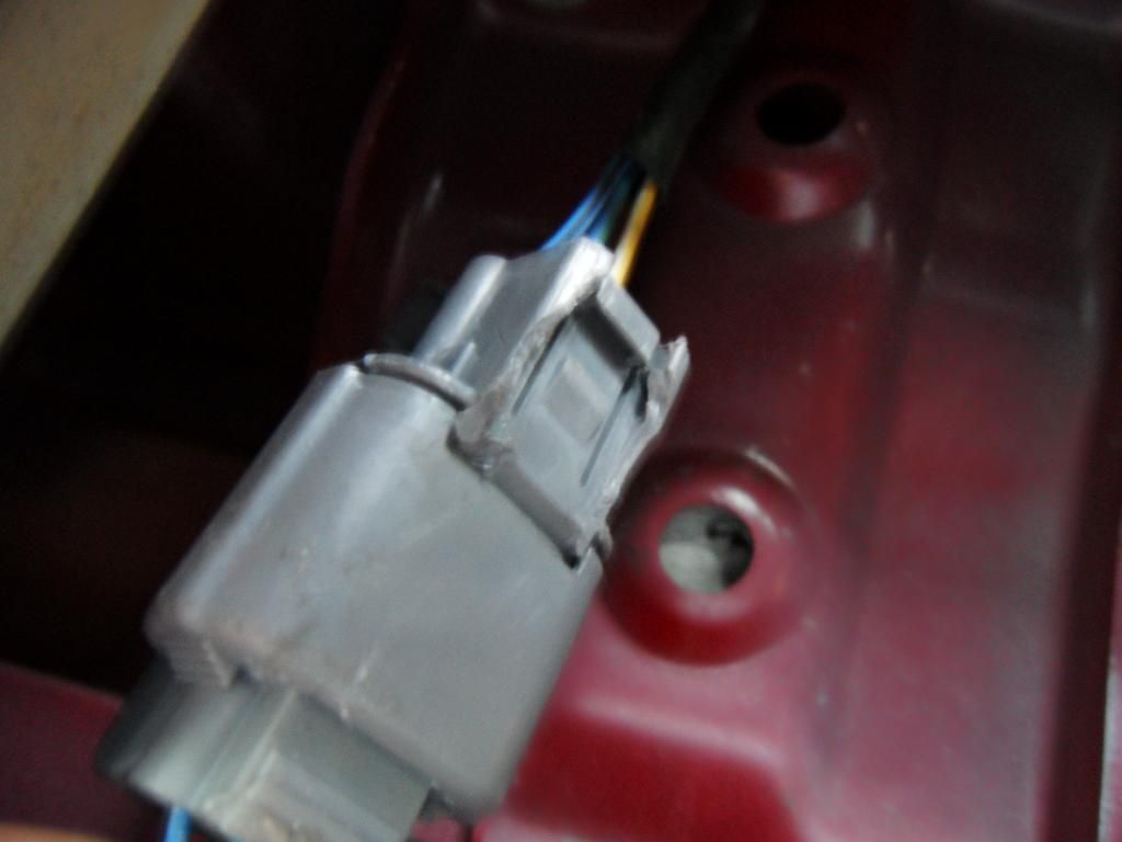

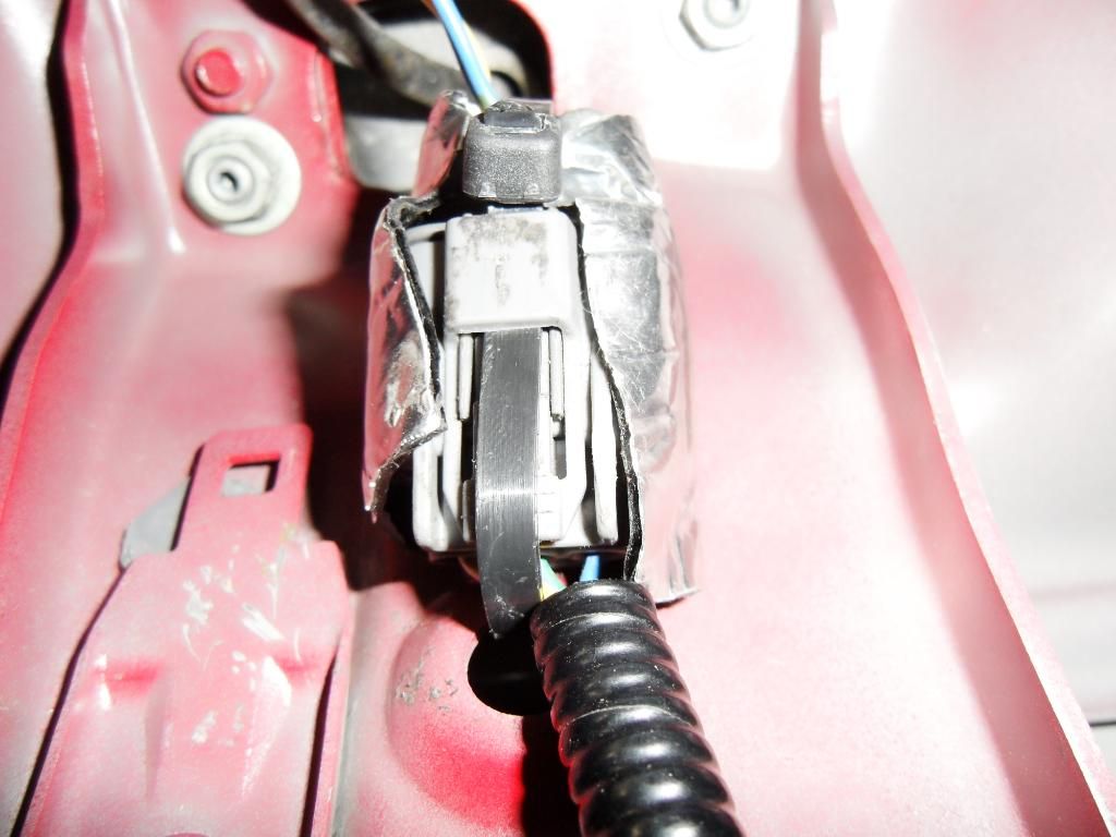

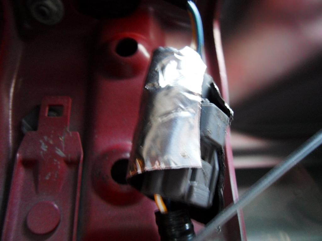

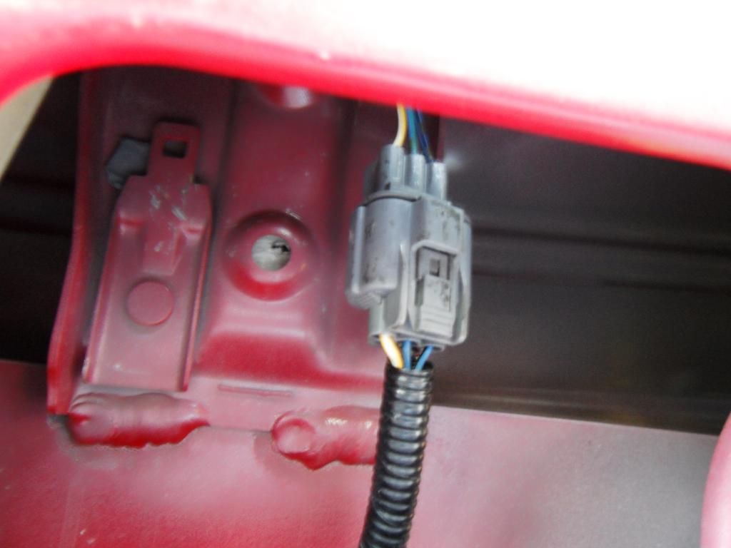

I found that there was a strange noise coming for drivers side window, not the usual pop or crunch from a window being out of line but a funny dragging and banging. [Hard to explain]
So with the door card removed, I immediately noticed the cable.socket for the wing mirror was hanging free and the window would catch this on opening and closing
http://i77.photobucket.com/albums/j7...X/SAM_0354.jpg
After inspection, it was clear to see the socket was damage and the retainer that hold the socket to the door cannot be used to secure it. Also someone tried to mask it up at one stage.
http://i77.photobucket.com/albums/j7...X/SAM_0359.jpg
http://i77.photobucket.com/albums/j7...X/SAM_0360.jpg
Masking removed
http://i77.photobucket.com/albums/j7...X/SAM_0363.jpg
With the tape duct removed, I didnt have much options to secure the plug without changing it. So I covered the plug in sound deadning so it wouldnt rattle or scuff the door, then used a tie wrap to secure it tightly against the door out of the windows travel.
http://i77.photobucket.com/albums/j7...X/SAM_0364.jpg
http://i77.photobucket.com/albums/j7...X/SAM_0366.jpg
Nice and Snug now and no more nasty sounds!

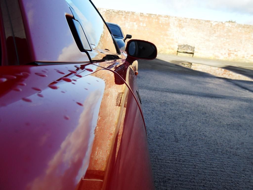

Both doors were out a bit
http://i77.photobucket.com/albums/j7...X/SAM_0347.jpg
http://i77.photobucket.com/albums/j7...X/SAM_0348.jpg

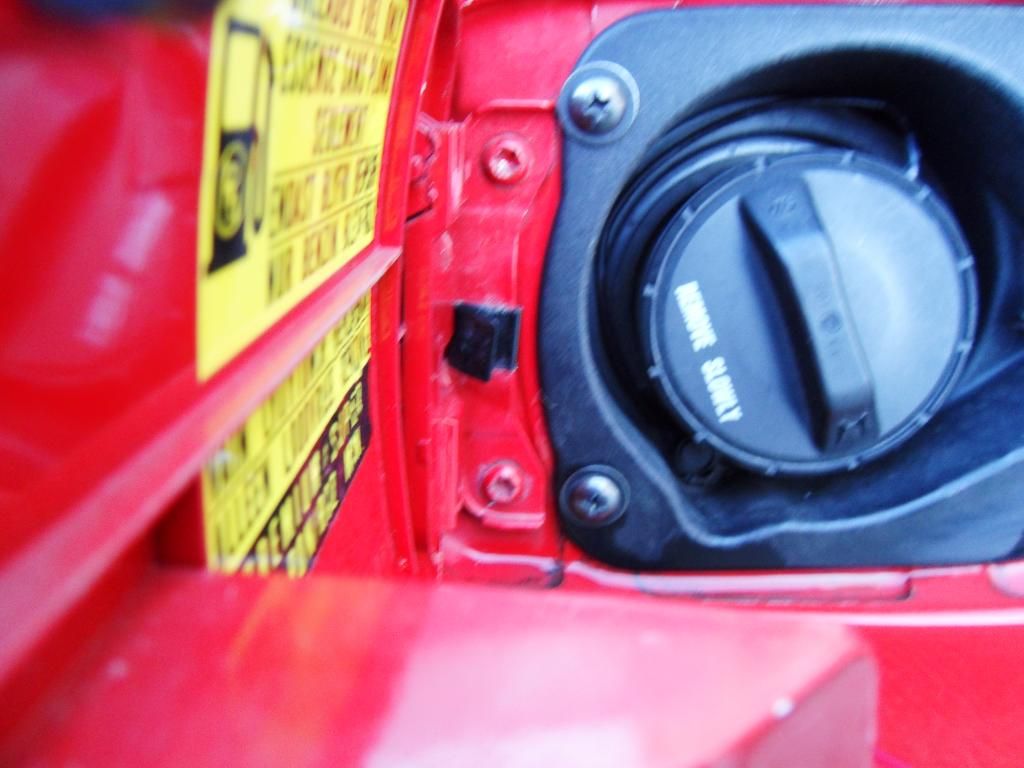

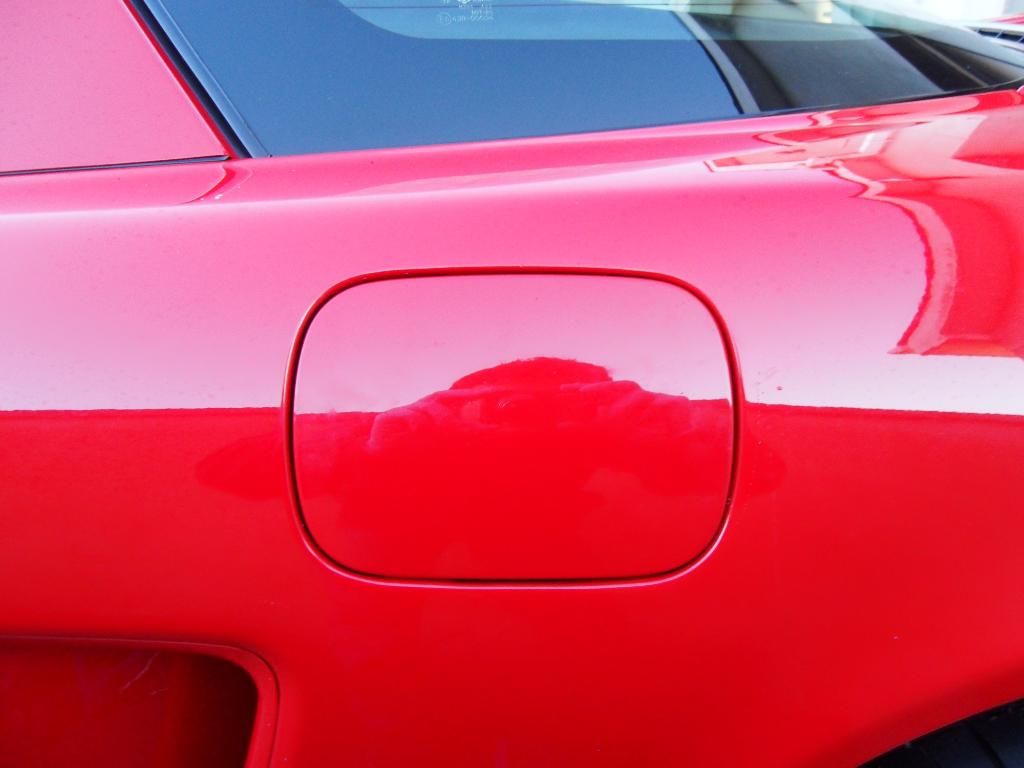

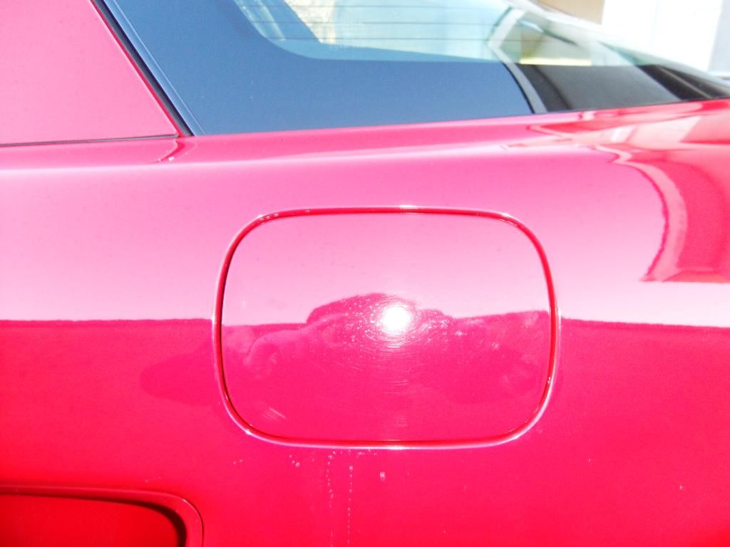

Fuel filler cap was slightly out and very tight to one side, it also wouldnt spring open when the handle was pulled.
So I loosen the 2 hex bolts slightly as it just takes small movements to get it right, I also adjust the spring slightly
http://i77.photobucket.com/albums/j7...X/SAM_0397.jpg
http://i77.photobucket.com/albums/j7...X/SAM_0399.jpg
Cap now opens like it should and not tight on the right side and nice gaps

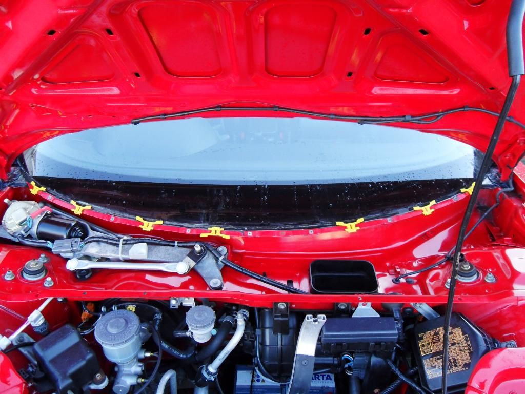

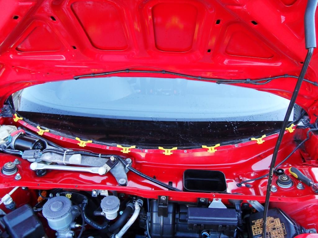

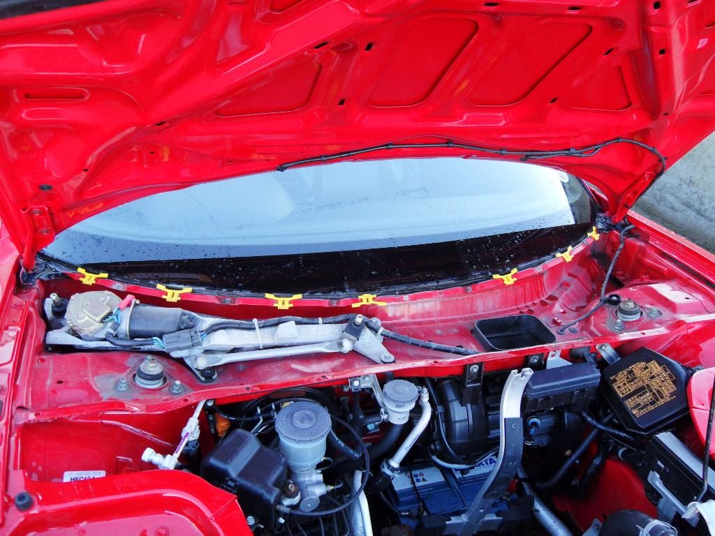

I noticed a slight rustling noise and squeek coming from the the wiper motor area.
So I removed the top cowl assembly to get a better look
http://i77.photobucket.com/albums/j7...X/SAM_0378.jpg
http://i77.photobucket.com/albums/j7...X/SAM_0380.jpg
http://i77.photobucket.com/albums/j7...X/SAM_0381.jpg
The noise was coming from a combination of old debris/bits of leaves etc, also the joints on the wiper motor arms were quite dry.
http://i77.photobucket.com/albums/j7...X/SAM_0379.jpg
I cleared out any debris and greased the joints, and while I was there I polished up the area. I also noticed there was a yellow clip on the wrong way and one missing. So I turned it up the right was and from my spares added the missing clip. [cowl must have been off in the past]
All nice and clean and no more noises

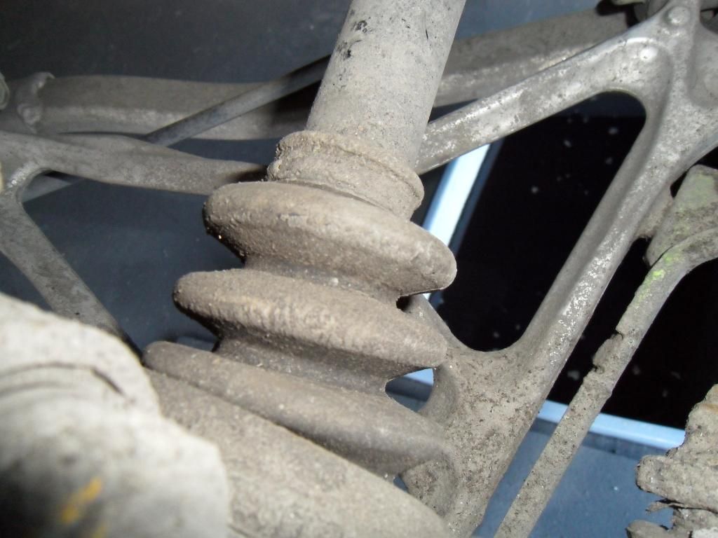

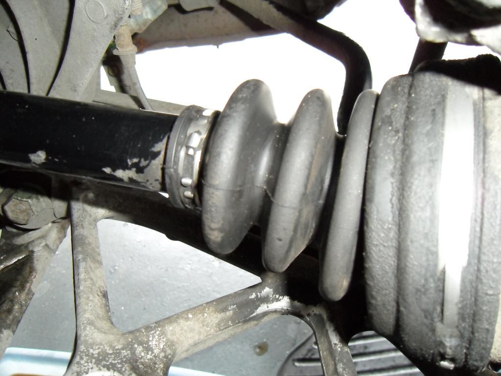

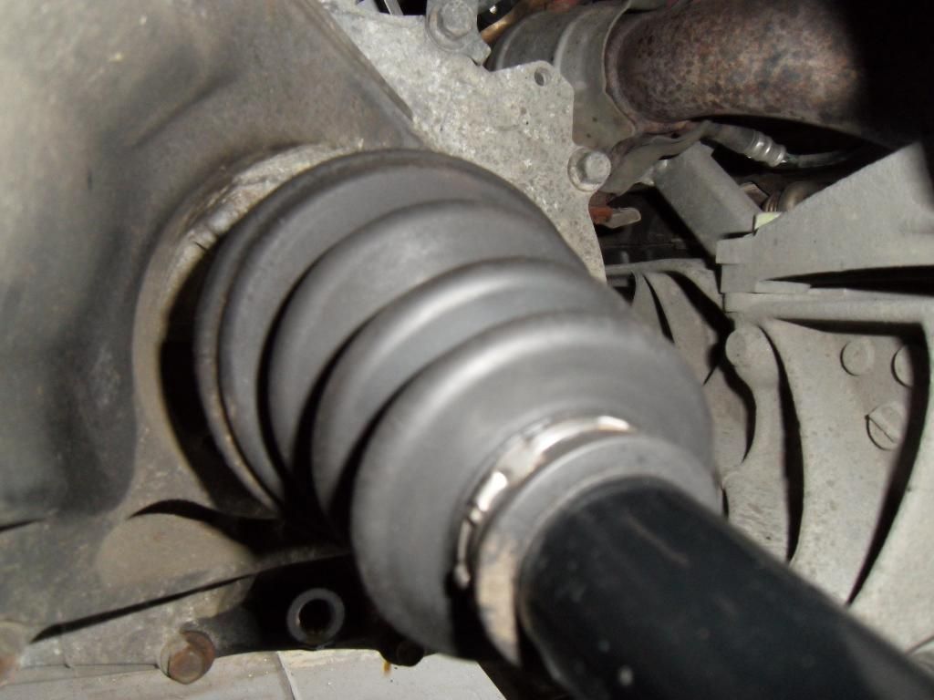

Drive shaft boot inspection
Quite a bit of build up on the boot whuch is quite normal depending on the road conditions the car is used in.
http://i77.photobucket.com/albums/j7...X/SAM_0469.jpg
In order for me to give the boot a good check I cleaned up the both inner and outer boots as much as possible for a good visual check
http://i77.photobucket.com/albums/j7...X/SAM_0471.jpg
http://i77.photobucket.com/albums/j7...X/SAM_0472.jpg
http://i77.photobucket.com/albums/j7...X/SAM_0473.jpg
After the clean up it I gave them a good inspection and all were perfect!

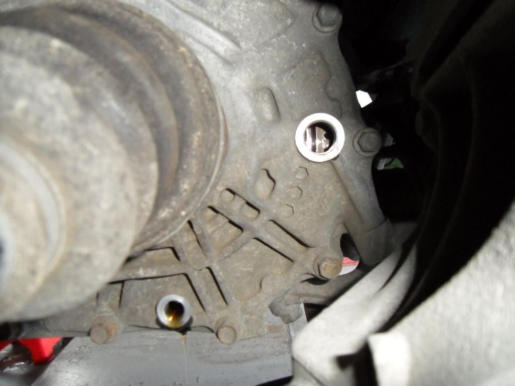

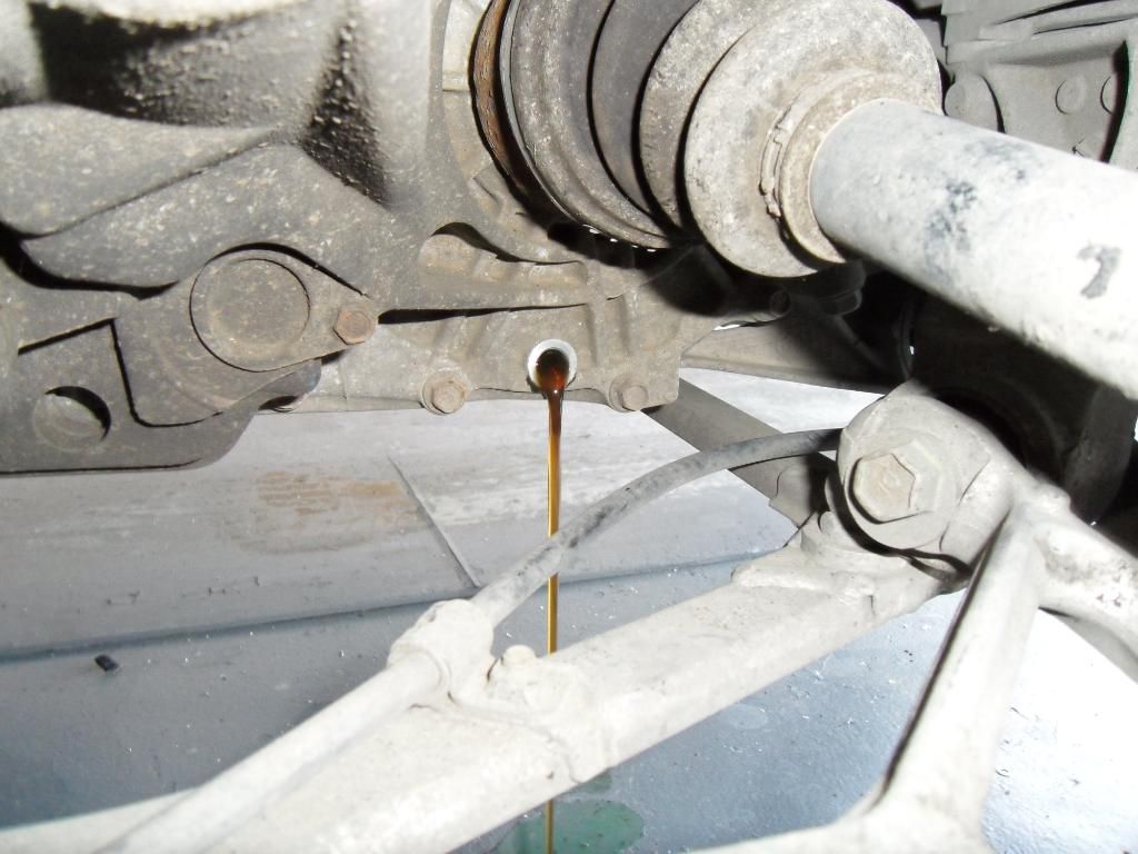

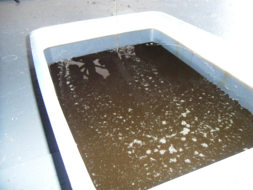

After speaking to the owner we have decided to go with all the fluids flushed and fill.
So I started with the gearbox, drain plug removed. I like to let the transmission drain till it just dripping lightly, then I will flush the transmission with the Honda MTF3
http://i77.photobucket.com/albums/j7...X/SAM_0465.jpg
http://i77.photobucket.com/albums/j7...X/SAM_0466.jpg
Fill plug and drain plug now removed
