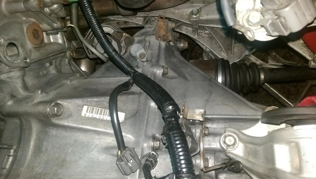

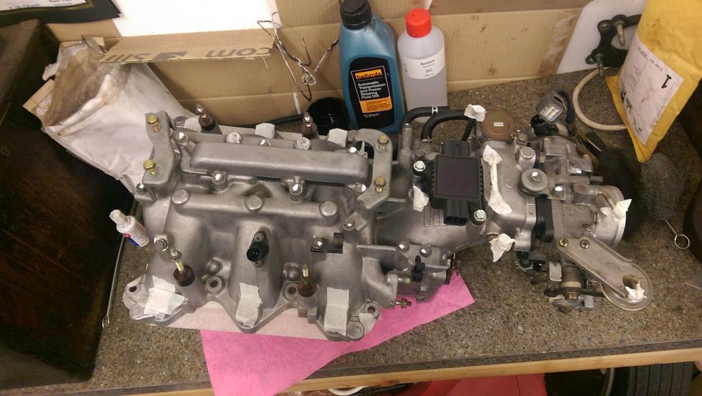

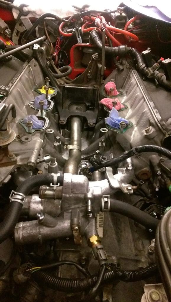

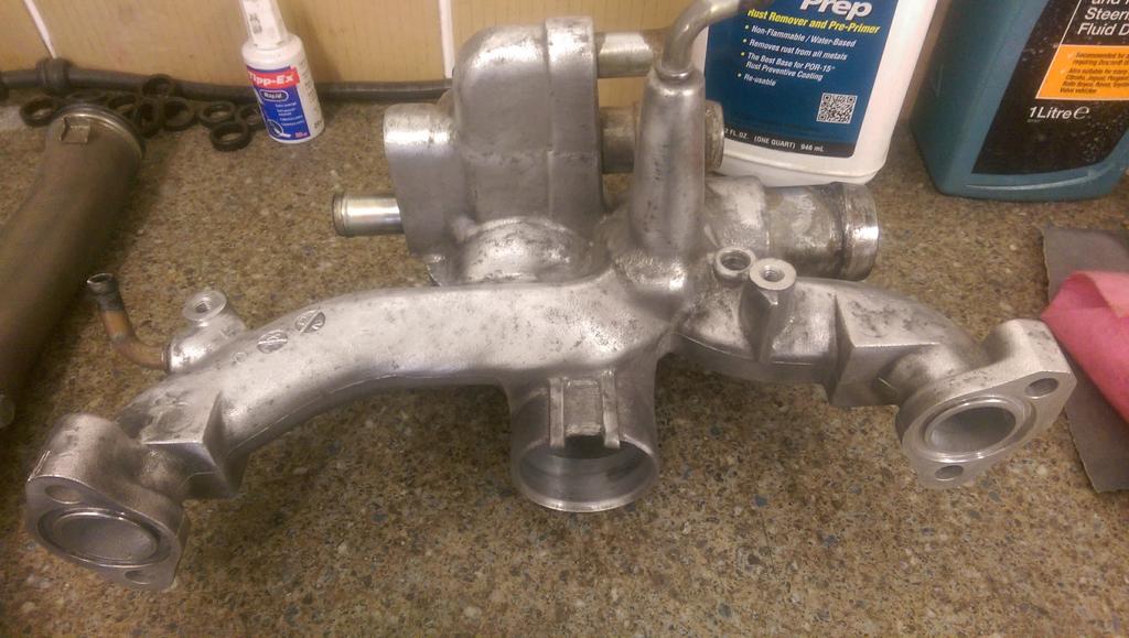

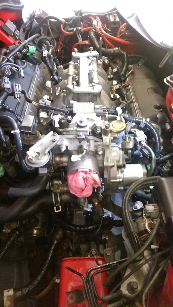

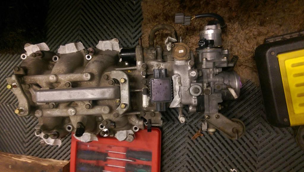

More progress, although I'm not getting in the garage as often as I'd like...... especially over the Christmas holidays, thanks to the Moderna booster.
Gearbox back in place. Awkward job to do with only one pair of hands, the small transmission lift helped but another pair of hands would've been useful for holding the clutch fork in a position to not hinder the final few cm's of mating the gearbox. In the end a piece of bent wire had to do.
For anyone else who may take this job on, I would say the main thing to remember is .....CLUTCH FORK, CLUTCH FORK, CLUTCH FORK !!! It hinders the removal & re-fitting of the gearbox if not held in a suitable position.
Clutch slave cylinder in place, now with dust boot. Worth mentioning the boot makes aligning the cylinder shaft awkward to align into the clutch fork, it's quite easy to think the shaft is engaged into the socket in the fork but there's a good chance it won't be, which wouldn't be ideal when you first press the clutch pedal.

I bought a gearbox from Goldtop of the forum, a while ago, so I had this sitting in the garage ready for the time to do the swap, which is a JDM spec box with around 65K miles covered. I also decided to replace the clutch with a Science of Speed single plate 275 clutch & flywheel assy. This is very nicely engineered and weighs 5kg less than a twin plate OEM assy.
Attachment 15005
Attachment 15006
Attachment 15011
Attachment 15012
To help with dropping and raising the gearbox, I fashioned a very basic winch by strapping some left over wooden planks to some joist hangers, and suspending the gearbox on some rope, connected to a small pulley. This worked really well & the allowed me to align the gearbox a lot easy than trying to just use my small transmission lift, as I could easily align the gearbox to the engines angle.
Attachment 15007
Attachment 15008
Attachment 15009
Everything was going well, until I tried to re-fit the clutch slave cylinder & I found the clutch fork was too close to the rear side of the small aperture not allowing enough space to re-attach the cylinder, so there was only one thing to do & that was to drop the gearbox out again. Fortunately I hadn't fitted a lot of things back to the car, so didn't take long but was frustrating. The reason for the mis-positioned clutch fork being the clutch bearing being out of position in the fingers of the pressure plate.
