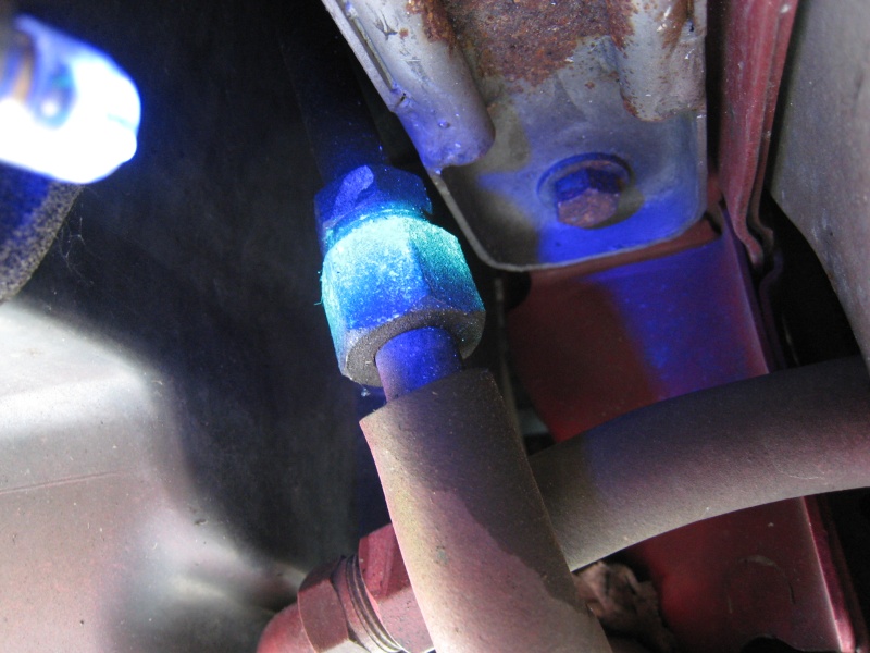

First, from your photo, it looked as if the evapo fin was covered in green.
Sometimes, digital image won’t show the true colour of actual object but the green colour could be the leak detector added to the A/C gas.
Your friend of A/C specialist should have UV ray light so if you apply it to the evapo and if you get fluorescent green like the photo below, I’m afraid there is no point in cleaning the evapo while it’s inside the car if the leakage was severe.
Attachment 7073 Attachment 7074
The bonded debris is actually caused by the A/C oil (not the gas) and it is very sticky material. Even you wash the evapo thoroughly and re-charge the A/C gas, it will end up in the same result if the oil leakage was severe unless you fix the leakage.

Please check the pipe connection points with the UV ray light if the leak detector was added to your system. The common places for the leakage on our NSX is at the compressor, the two pipes at R & L condensers and the fittings of the evapo at the firewall.
