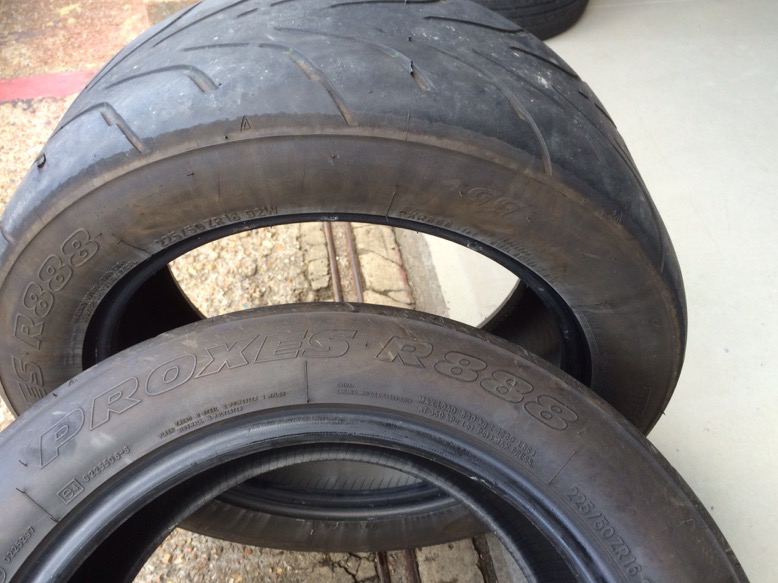

After only 3,500 miles my Toyo 888R rear tyres are now worn out 😳

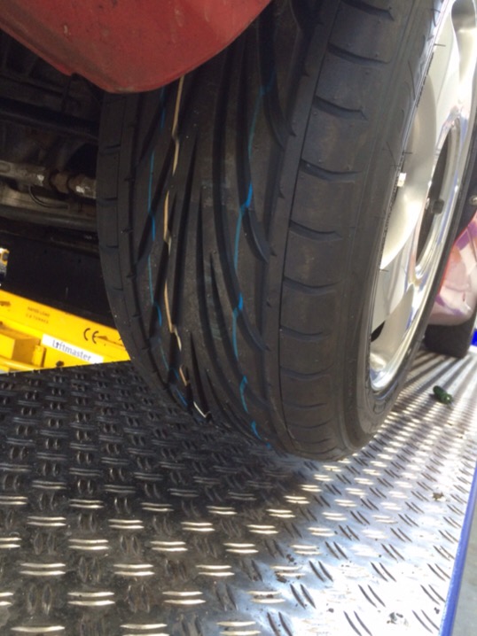

So I thought I would try the TR-1's on the basis of what nobby thinks of them so far, they certainly look good and at just £125 for the pair 👍 I can't really go wrong, hopefully good for 10,000 miles at least now.
First impressions this afternoon are very good and with the super sticky 888R's on the front for good sharp turn ins I'm hoping this will be a great combination.

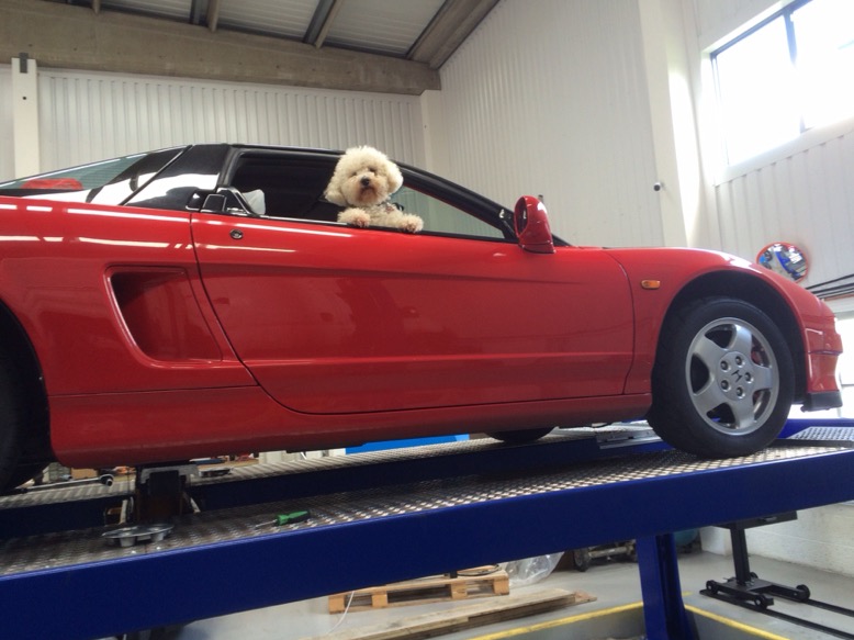

Fredbear 🐶 seemed to approve anyway :)

I've no idea how you have your chassis set up but to chew a set of rears so quick youre either hard on tyres by way of driving style or they were (IMHO) way too soft for road use.
I had F1's do 18k on the rears, Kumho's that did similar ad offered stiffer sidewalls, and current AD08's have covered 10k with plenty left to go ...
