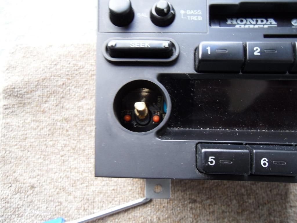

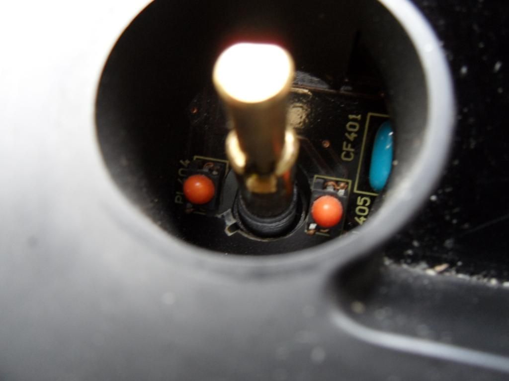

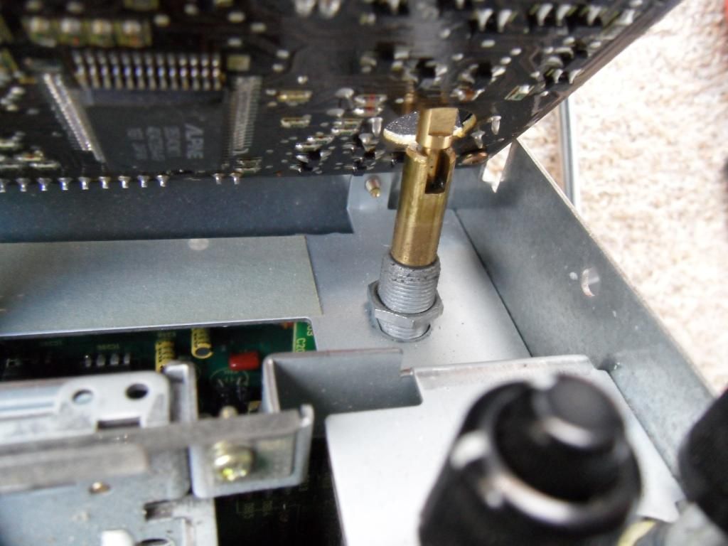

After doing some initial testing of the car as it stood I noticed the radio volume knob was not seated correctly and had quite a bit of movement, so I removed the knob for inspection
http://i77.photobucket.com/albums/j7...E/SAM_1310.jpg
http://i77.photobucket.com/albums/j7...E/SAM_1311.jpg
With it removed I could visually see the free play, so I removed the the front plate of the radio and found the volume knob retaining nut, had shifted up the thread and was causing the problem.
http://i77.photobucket.com/albums/j7...E/SAM_1313.jpg
I tightened up the nut, put the unit back together and all is now as it should be.

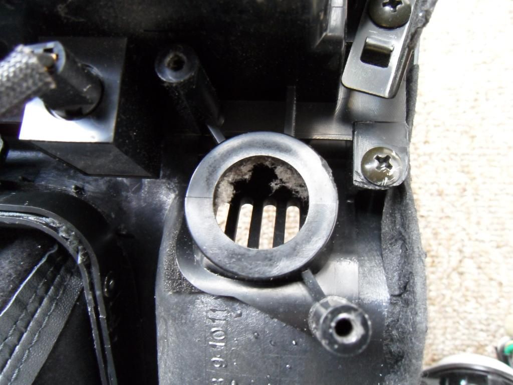

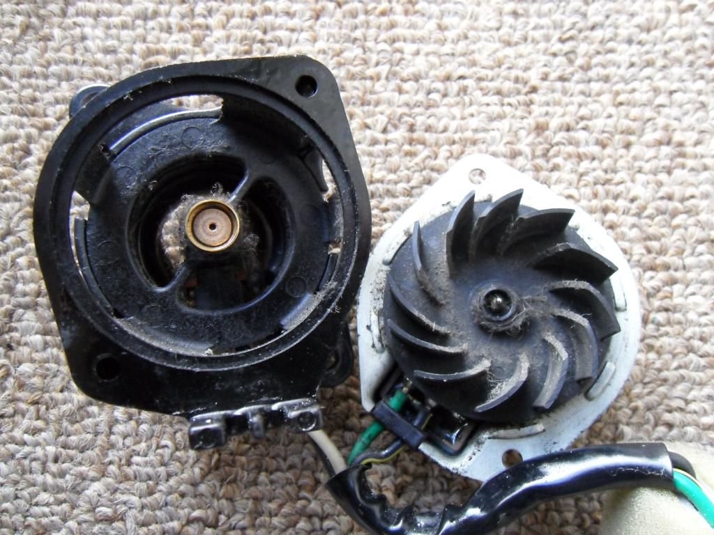

Done the usual check of cabin Aspirator fan/sensor, and as always was slightly clogged up
http://i77.photobucket.com/albums/j7...E/SAM_1305.jpg
http://i77.photobucket.com/albums/j7...E/SAM_1307.jpg
As always this was cleaned down and greased and working perfectly now with no annoying ticking noise.

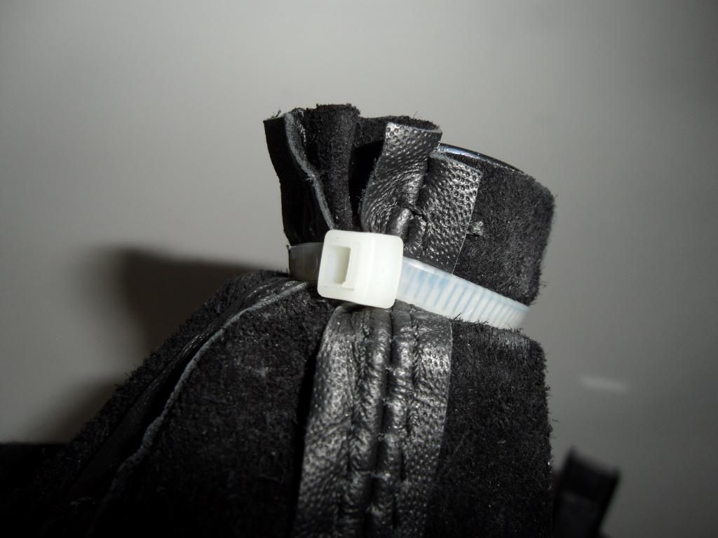

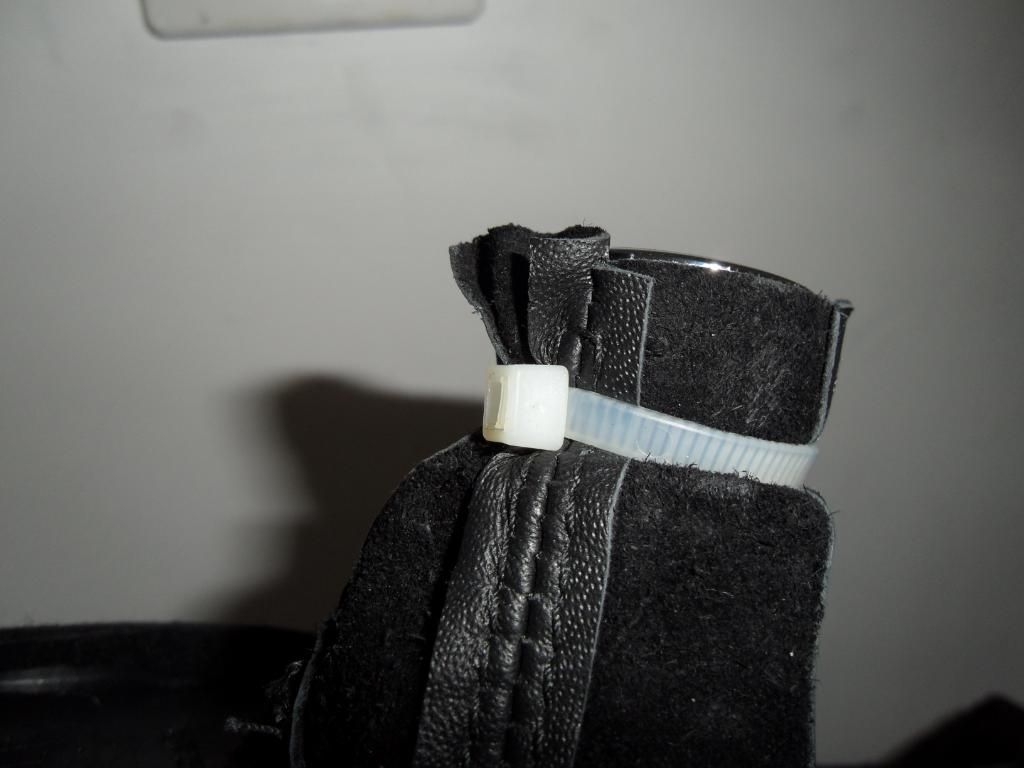

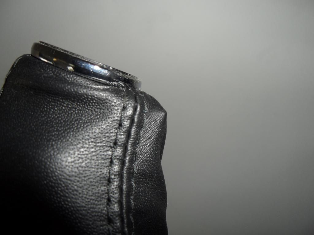

I noticed the owner had bought one of the real nappa gear gaiters I had made up with a company in the UK, very nice finish and much better than the nasty "leather look" that came on allot of the NSX's. Only thing I wasnt happy with was the cut off point of the cable tie used, over time it would have damaged the leather, very sharp
http://i77.photobucket.com/albums/j7...E/SAM_1299.jpg
http://i77.photobucket.com/albums/j7...E/SAM_1301.jpg
So I cut it right back and file off and edges
http://i77.photobucket.com/albums/j7...E/SAM_1302.jpg
http://i77.photobucket.com/albums/j7...E/SAM_1303.jpg

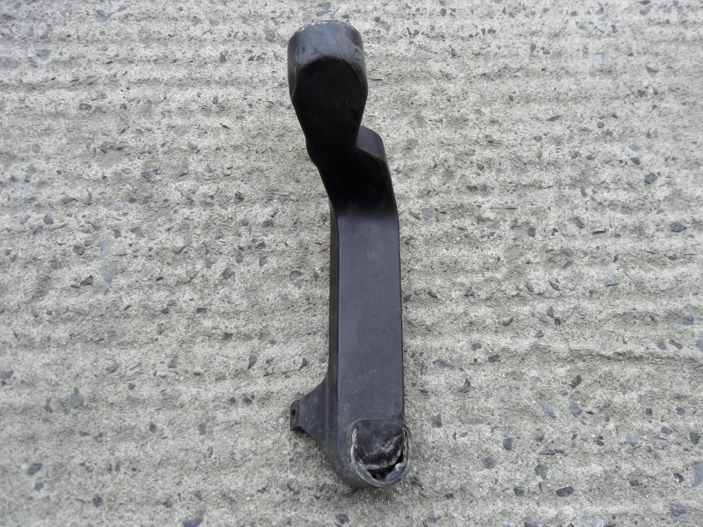

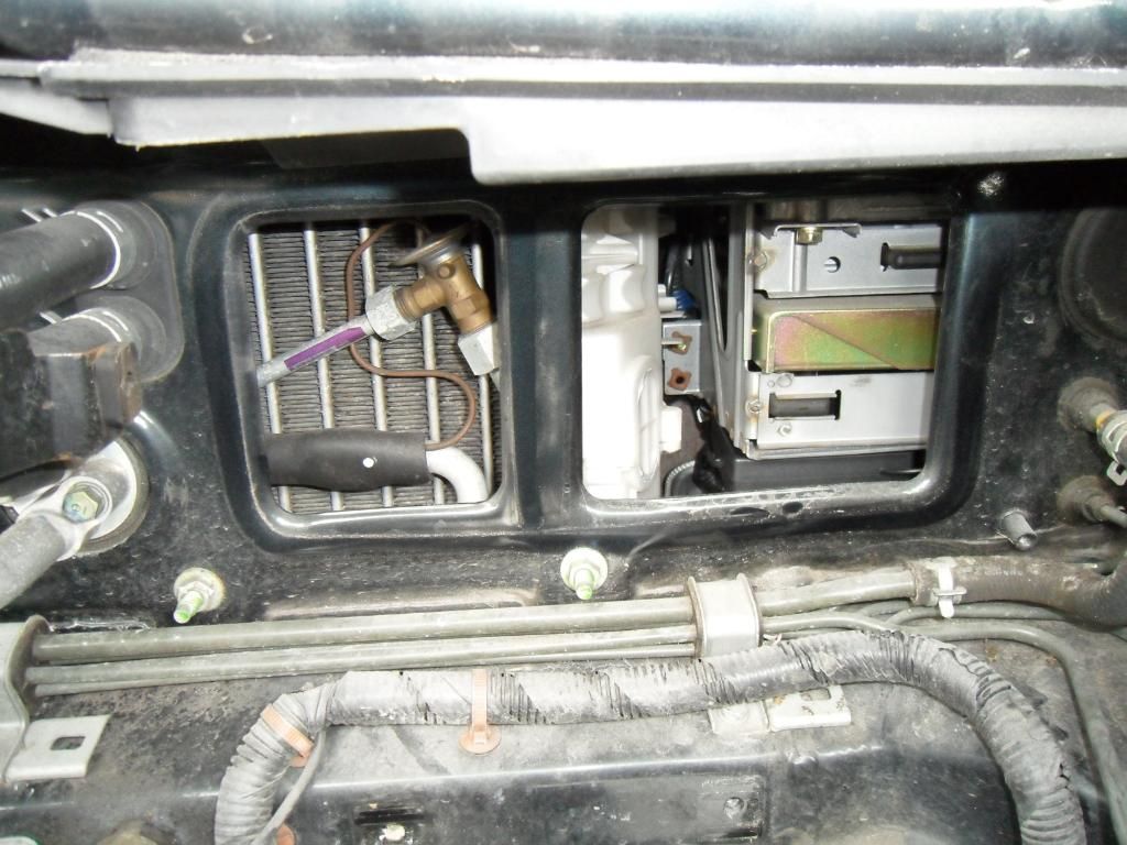

I removed the blower motor for inspection and checked for any build up behind that as, the owner mentioned about a slight moisture problem in the cabin from time to time. I checked the AC drain pipe but it was fine and seated correctly with no blockage and no damp on the floors or door seal damage.
http://i77.photobucket.com/albums/j7...E/SAM_1377.jpg
The blower motor was very clean on this car, and behind was very tidy. I then inspected the drain pipe which runs from the scuttle panel and couldnt believe what I found lol
http://i77.photobucket.com/albums/j7...E/SAM_1372.jpg
http://i77.photobucket.com/albums/j7...E/SAM_1373.jpg
http://i77.photobucket.com/albums/j7...E/SAM_1374.jpg
