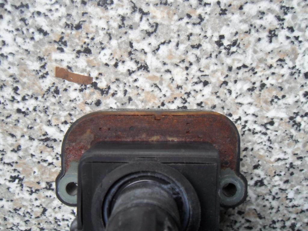

Hi,

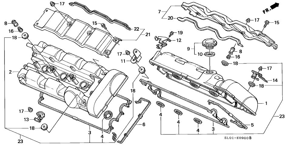

It was from NO:1 bank which is the first one towards the rear of the car not the bulk head, the bulk head coils are all like new. The NO:1 and NO:2 coils had corrosion. Although it looks bad in the pic, its actually more surface rust, and a couple of blasts with contact cleaner and scotch pad cleaned it right up. I tested them all for OHM level and all are perfect.
From inspection, the seals have perished slightly, so I have new one s on order, I also wonder why they didnt put seals on both ends of the covers as the covers are indented the same, so I might experiment and put 2 seals on both covers.
