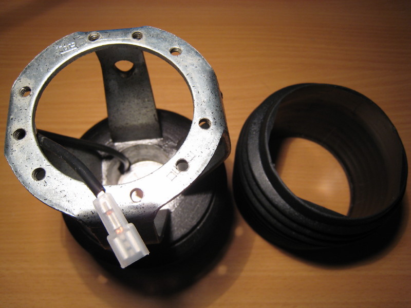

Hi, Sudesh.
To start with, although you already have this, followings are the photo of the OEM R Hub. As you can see, there are 9 fixing screw holes on it.
Attachment 4862 Attachment 4865

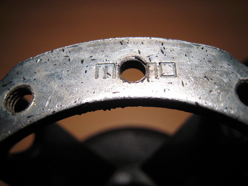

Engraved 'MOMO' and '4916' logo on it. Based on MOMO #4916 but with extra 3 fixing screw holes.
Attachment 4864 Attachment 4863

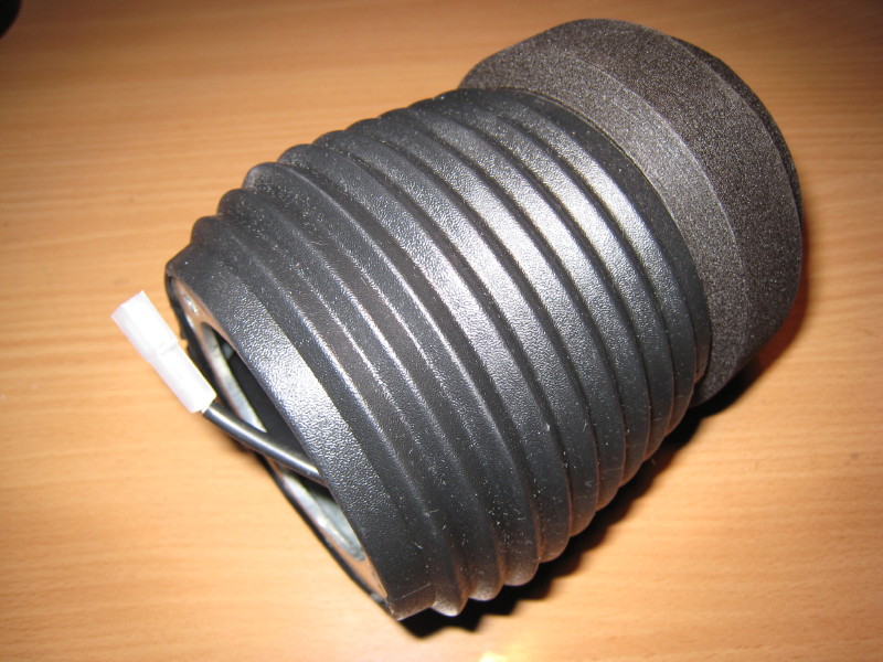

The biggest difference between the OEM Type-R MOMO steering wheel and the aftermarket ones including MOMO is the number of fixing holes. As you can see below, there are 9 holes on the OEM Type-R version.
Attachment 4866
There are some differences between NA1 and NA2 Type-R but in general, from outside, you will only see 6 bolts on the steering Ring (no.6). 3 extra fixing bolts will be hidden under this Ring.
Kaz,
Thanks for the info, I noticed the momo logo and numbers on my hub too.
Always wondered what the extra holes were for but now I see from the pics and your description they are hidden below the ring. My guess the 3 extras are to support the steering wheel while trying to install the horn and steering ring.
