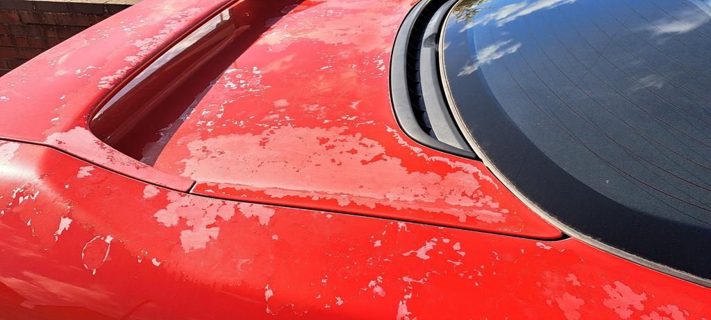

Its much more than just a blemish Jonathan, the whole bootlid, the spoiler, top of the rear wings and starting along the top of the doors now. :(Attachment 14732
If retirement is around the corner, why not make it as one of your retirement project?
If you have never done DIY re-spraying, that’s great because you would learn something new.
For the professional re-spraying or wrapping, no need rushing and you can wait until the right time comes.
Obviously, no reason to sell the car just for the cosmetic reason.
Much more important to invest in the mechanical and electrical services.
Even if you have made mistake with the DIY re-spraying, no big drama because it will be stripped off by the professional people during the preparation process for the re-spraying.

You are not alone and the same issue on many NSX that experienced strong UV ray over many years.
Mine started showing the effect of UV ray years ago.
It started at the upper horizontal section of the door panel.

You'll need to flat the paint off using Scotchbrite pads in either case - basically to remove the lumps in the clearcoat and most of the clearcoat to key the surface. If you are brave enough to do the prep yourself, it'll be a lot cheaper.
The other problem with red cars is fade - it'll need blending across the doors so you don't get two red cars stuck together. So it's a bit of a big job.
You could even try a DIY wrap! The boot lid & wings should be fairly easy. It's fairly forgiving as long as you don't overheat it. The spoiler & air inlets a bit tricky and they'll need to come off.

Well, I managed to get the funds together and found a great body shop near me who were happy for me to be involved at every step and let me do as much of the work as possible so I have done most of the strip down as well as some of the prep and will be doing all the refitting.
Some of the painting has been done already and is looking really good.
