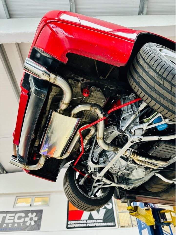

Another picture this time of the underneath, the new exhaust is a work of art, hopefully get to hear it next week. The garage is now sure they have the answers they need to sort the clutch out. Attachment 14868
Looks good! Probably will Sound even better :D
Let us know when you know what was the problem with the clutch, as it can help other owners in the future!
