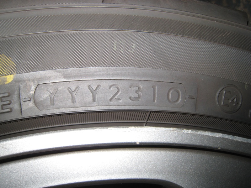

Attachment 8989
You can check the manufactured week No. and year of your tyre by looking at the stamp mark on the side shoulder.
Most of the tyre manufacture will follow the same rule.
For example, this one is from my Front tyre.
It was manufactured in the week No. 23 of 2010.
Hope this will help a little....
