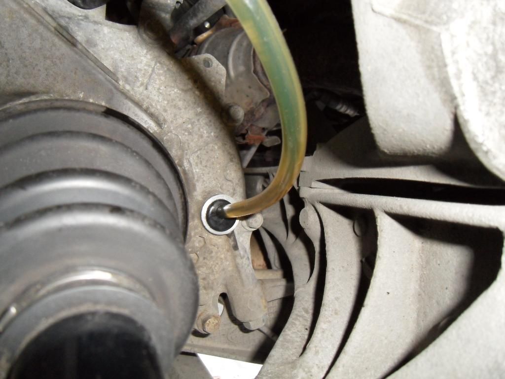

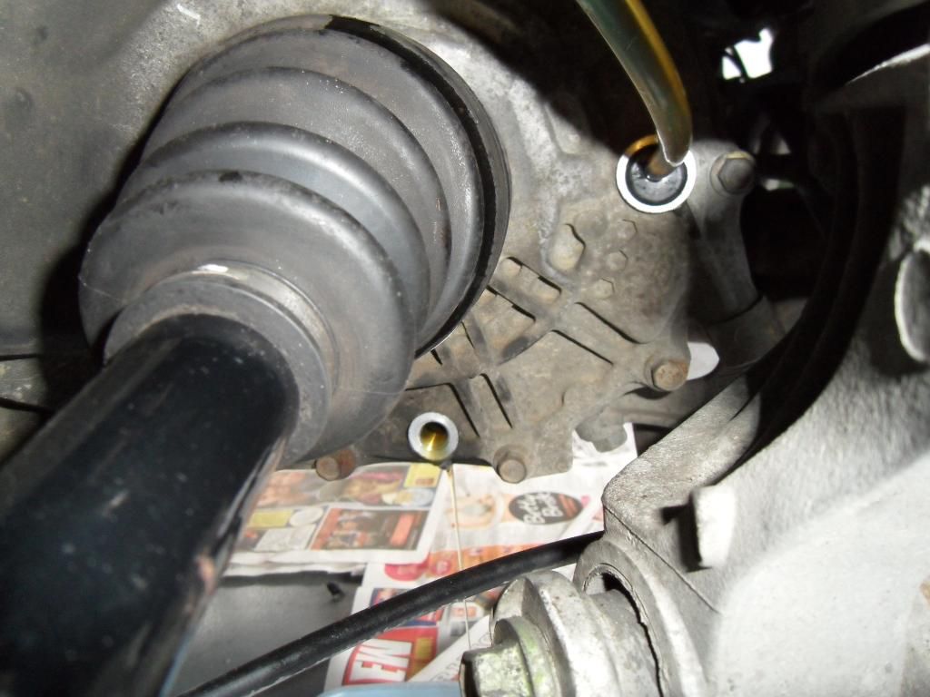

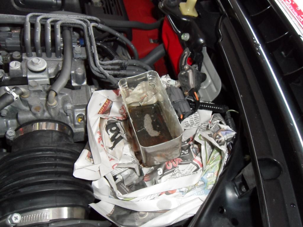

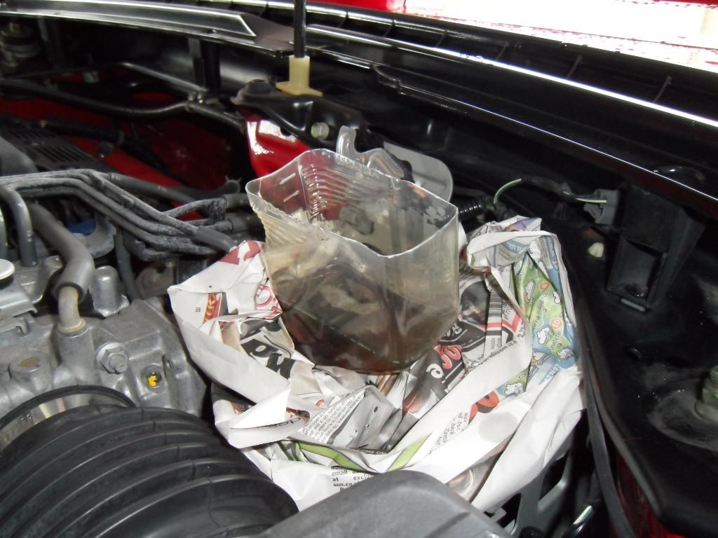

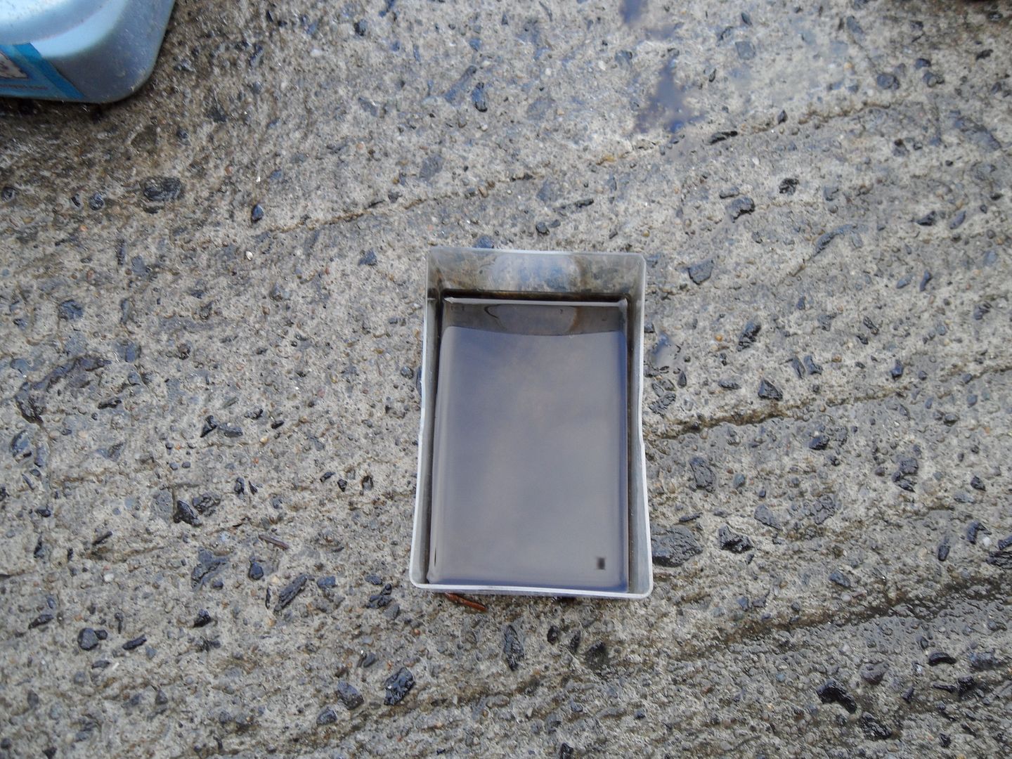

Flusing of the transmission

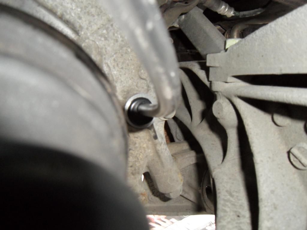

I have a little system I put together for flushing the transmission
Pipe and seal installed in fill plug
http://i77.photobucket.com/albums/j7...p/SAM_0480.jpg

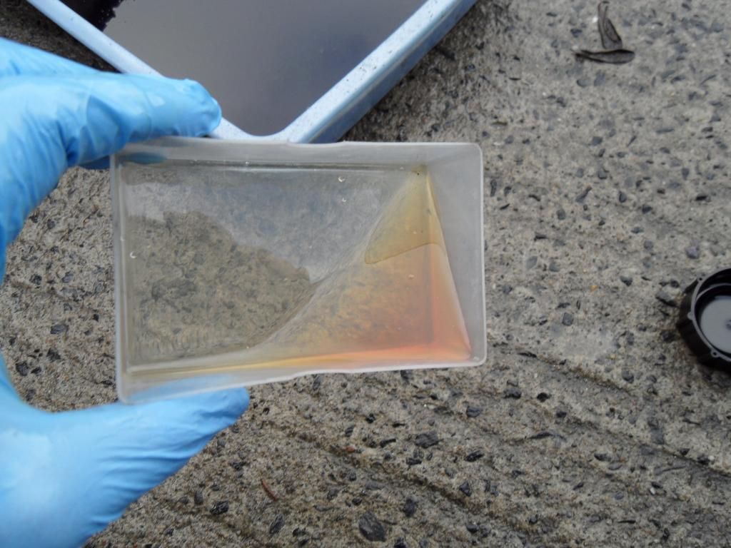

The pipe runs to this little container that also has a sealed end to stop dripping
http://i77.photobucket.com/albums/j7...p/SAM_0483.jpg
http://i77.photobucket.com/albums/j7...p/SAM_0484.jpg

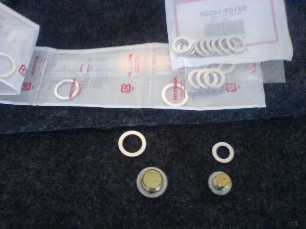

To flush the gearbox some more I sealed the drain plug, filled the gearbox with new MTF3, and drained again. Once that was done draining, I replaced both fill and drain plugs with new OEM crushed washers, installed bolts and torque to OEM settings. Fill transmissiom and Job done!

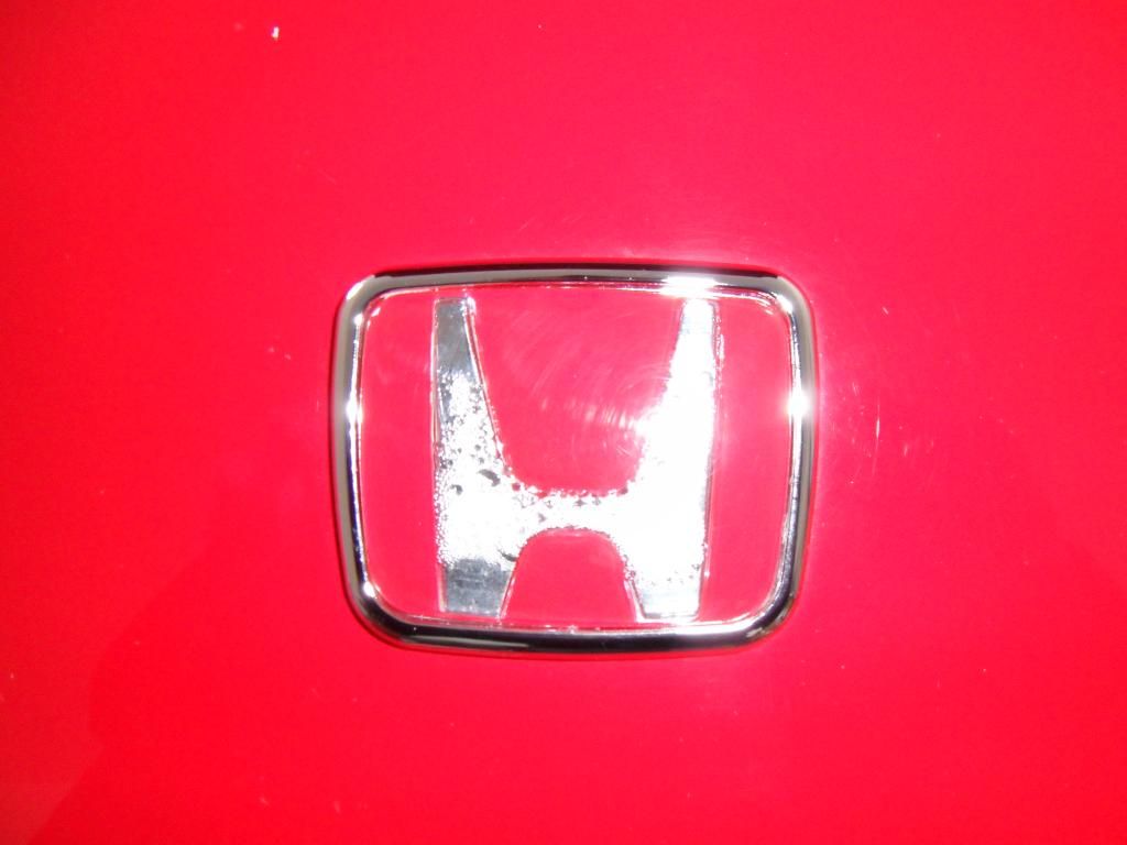

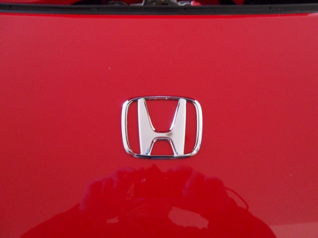

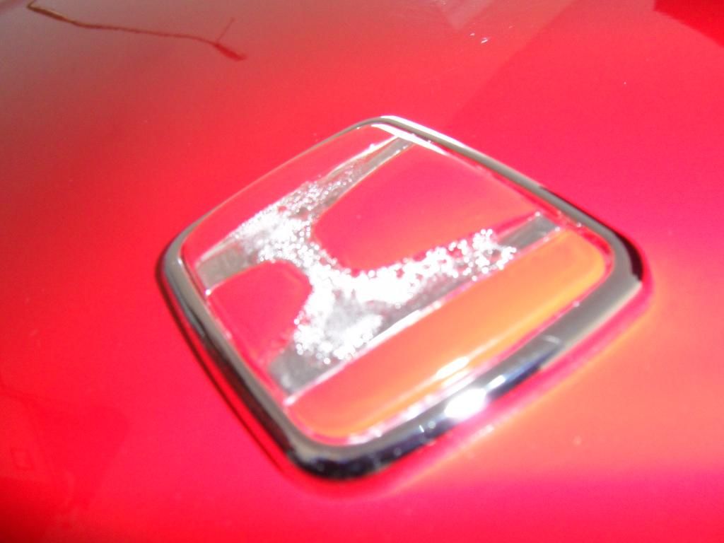

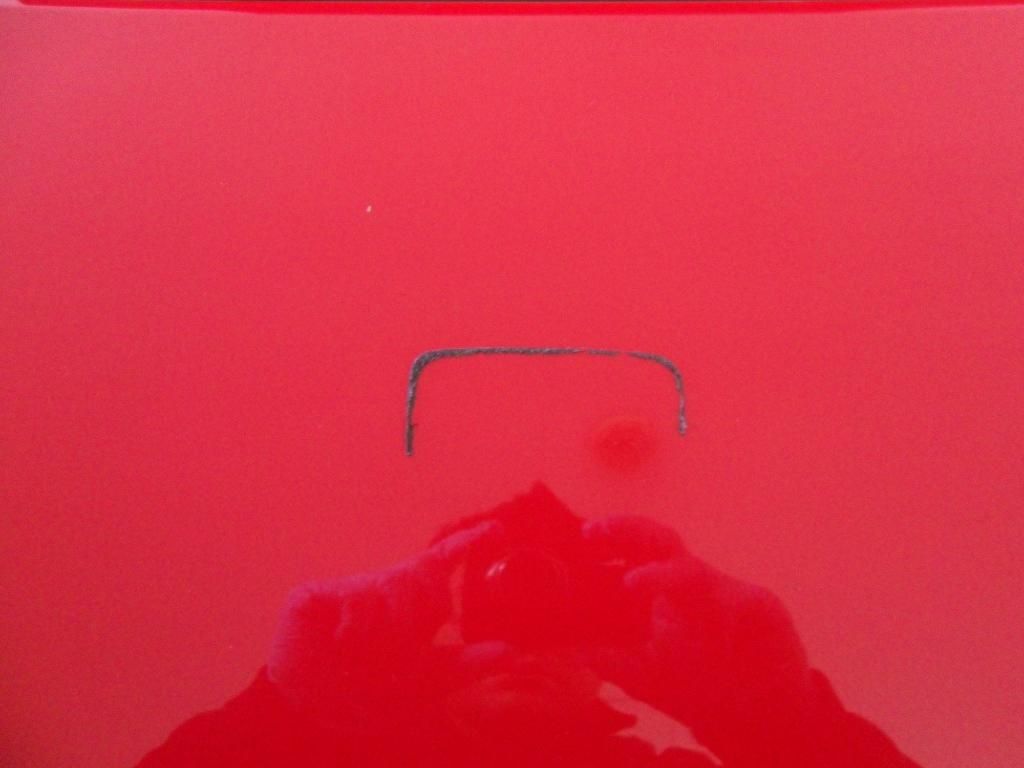

Old badge removed
http://i77.photobucket.com/albums/j7...X/SAM_0510.jpg

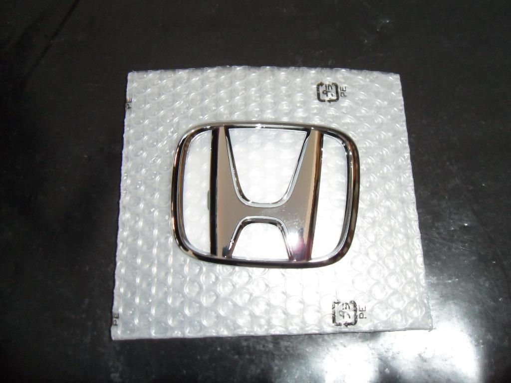

NEW badge insalled
http://i77.photobucket.com/albums/j7...X/SAM_0511.jpg
Interesting to see how they changed the style of badge on the facelift cars! Facelift badge is open/empty
pre-facelift is closed and the badge has the color set into it.
Also alot cheaper than pre-facelift
Facelift badge £17.61
Pre-facelift £58.46

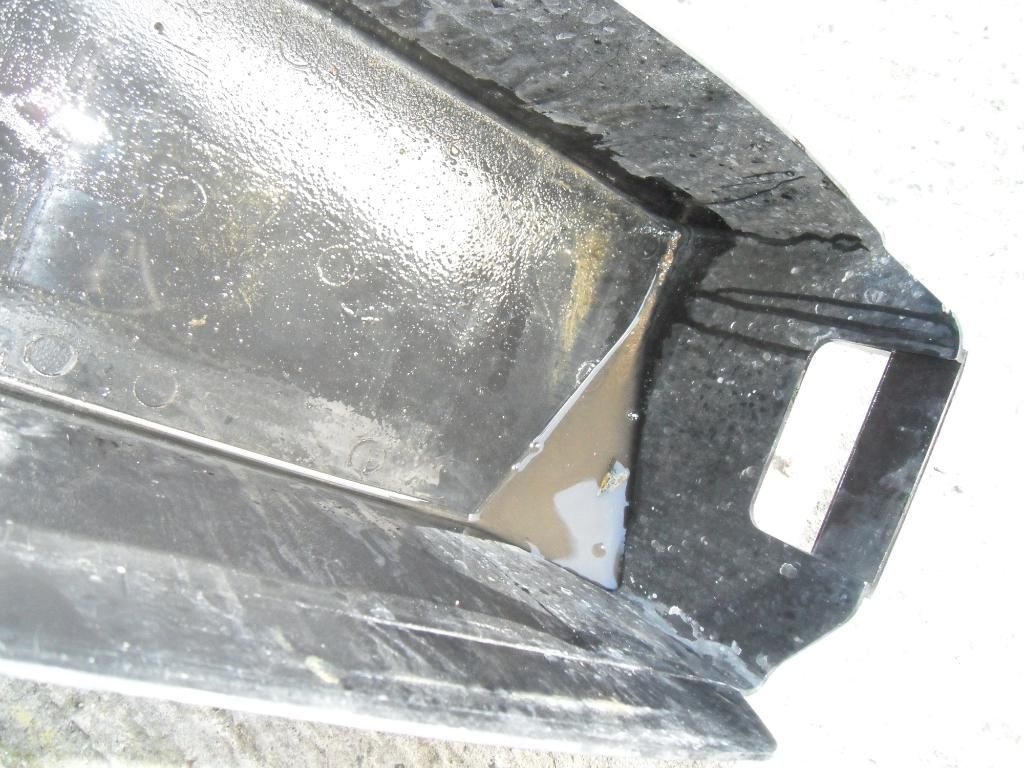

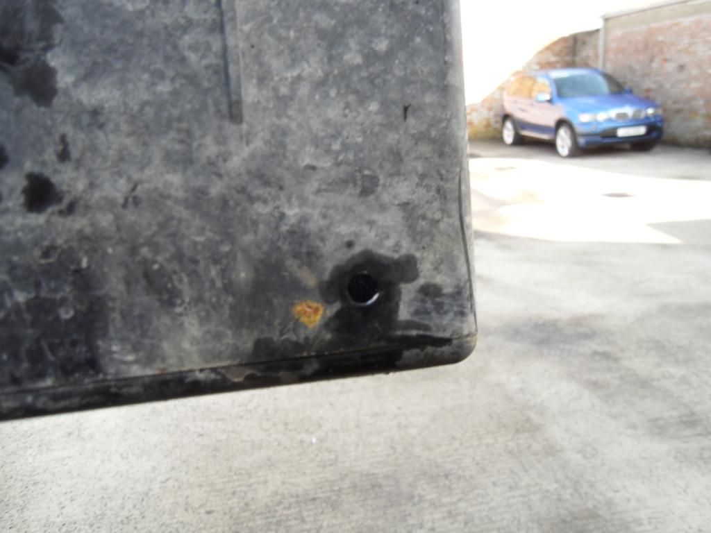

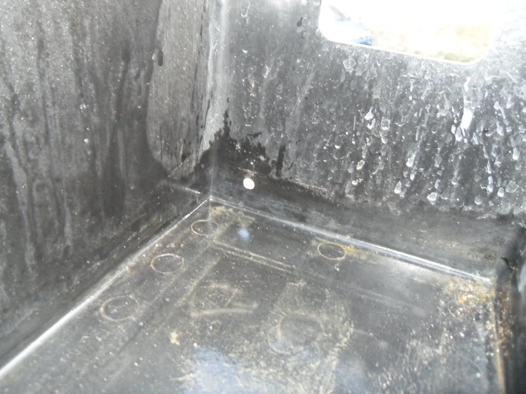

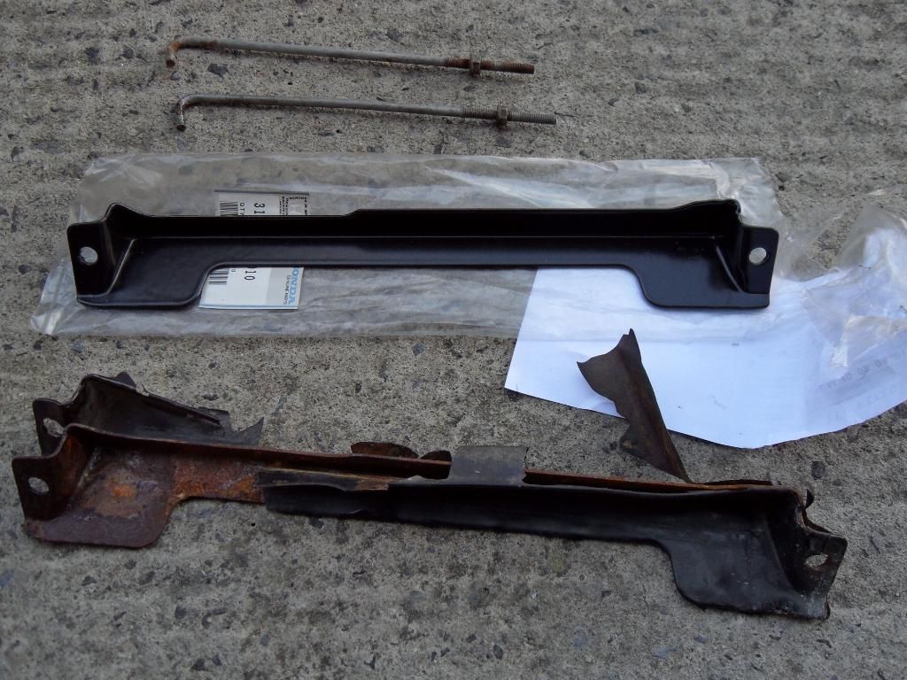

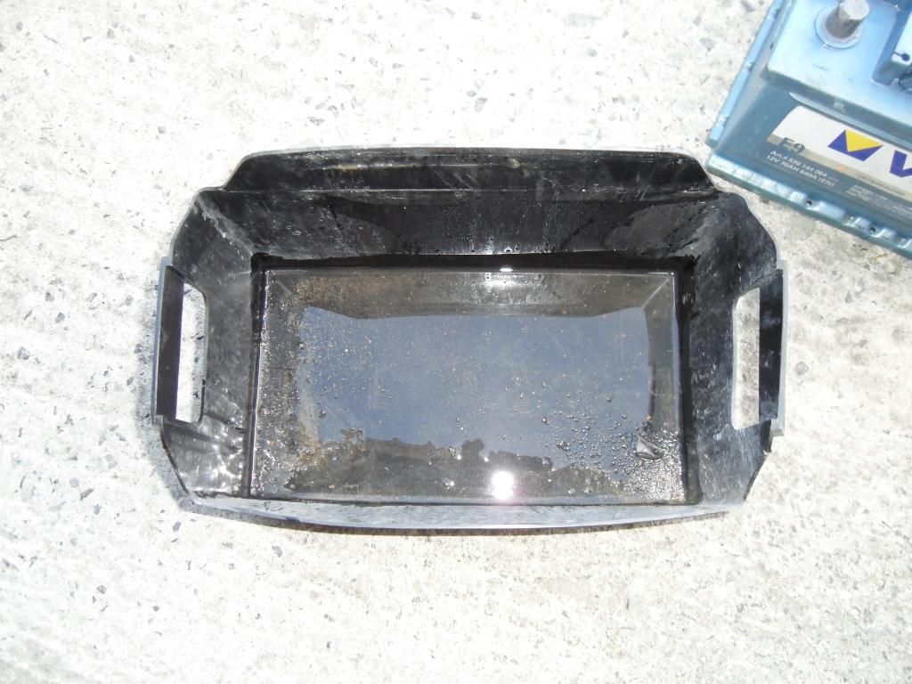

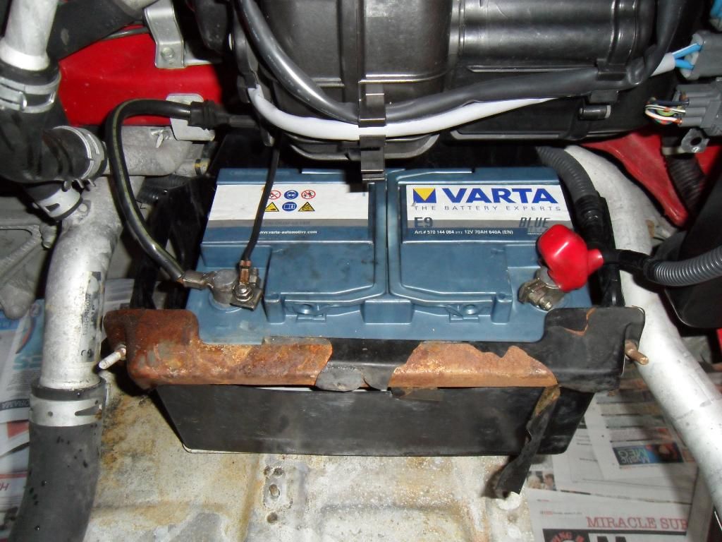

The battery mount as mentioned here: http://www.nsxcb.co.uk/testvb/showthread.php?t=7352
Was bad and corroded and as I mentioned not very safe.
So I removed the old mount and as you can see its quite bad with the protective covering completely perished.
I have a new OEM mount to install.
