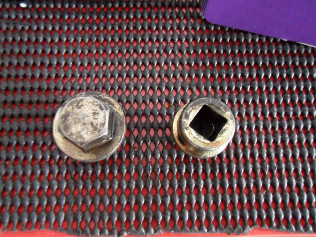

So as always remove the fill bolt first, once thats off remove the drain bolt and let gravity do its job, I had plenty of time so I let it drain and drip out for over an hour.
http://i77.photobucket.com/albums/j7...8/SAM_4344.jpg

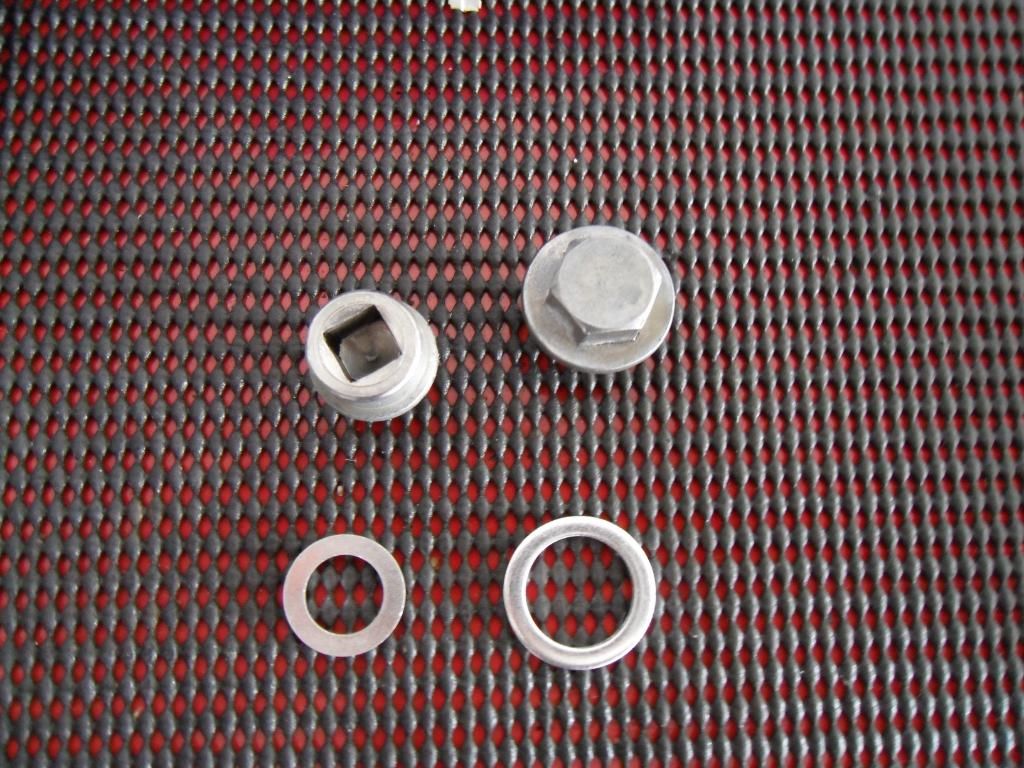

With both fill bolt and drain bolt removed I decided to give them a clean down
http://i77.photobucket.com/albums/j7...8/SAM_4343.jpg
After clean down and new seals

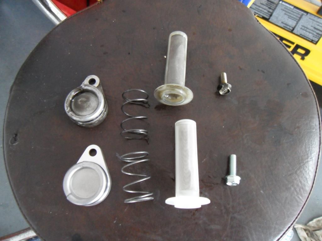

This is the cover where the filter is, it can be a little tricky to remove and usually gets damaged when removing so best to replace with new cover and seal.
http://i77.photobucket.com/albums/j7...8/SAM_4345.jpg

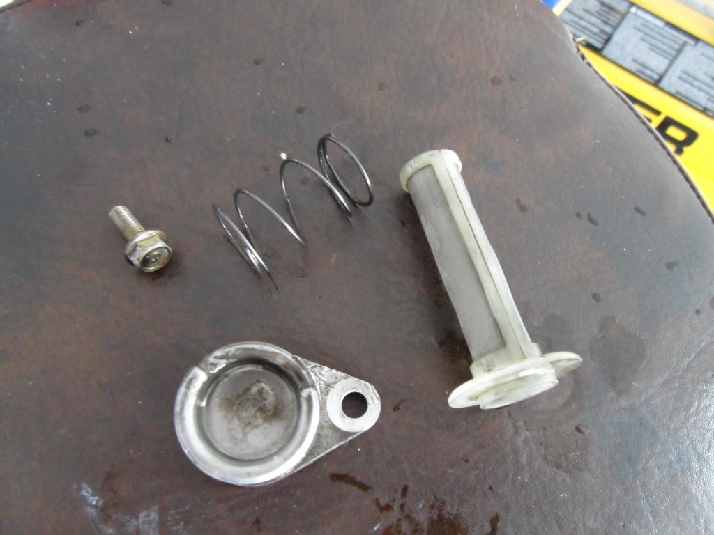

I managed to remove this one without it breaking, but wouldnt re-use it anyway. I also decided to replace the rest with new items, not necessary as the filter, spring and bolt can be re-used, but for all the cost involved I just went with all new bits. So I inspected the filter for any signs of metal chards and can report all was good!
old items
http://i77.photobucket.com/albums/j7...8/SAM_4347.jpg
new items
http://i77.photobucket.com/albums/j7...8/SAM_4348.jpg
http://i77.photobucket.com/albums/j7...8/SAM_4349.jpg
So re-installed the new filter, spring cap and bolt!

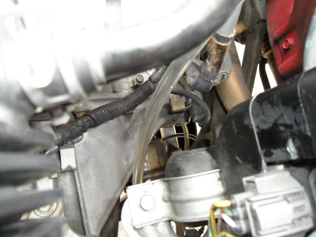

All thats left is to fill the box with MTF 3, so as always put the drain plug and new seal back on.

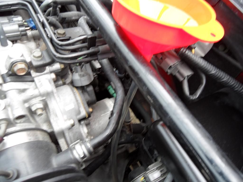

With some pipe and funnel running to the fill plug start pouring!
http://i77.photobucket.com/albums/j7...8/SAM_4351.jpg
http://i77.photobucket.com/albums/j7...8/SAM_4352.jpg
I can pretty much judge this correctly so know when to stop pouring, so with car on the level, the MTF fluid comes up to the level of the drain plug, and thats it! Job done, fit the filler plug and new seal, torque to spec and take for a test drive.

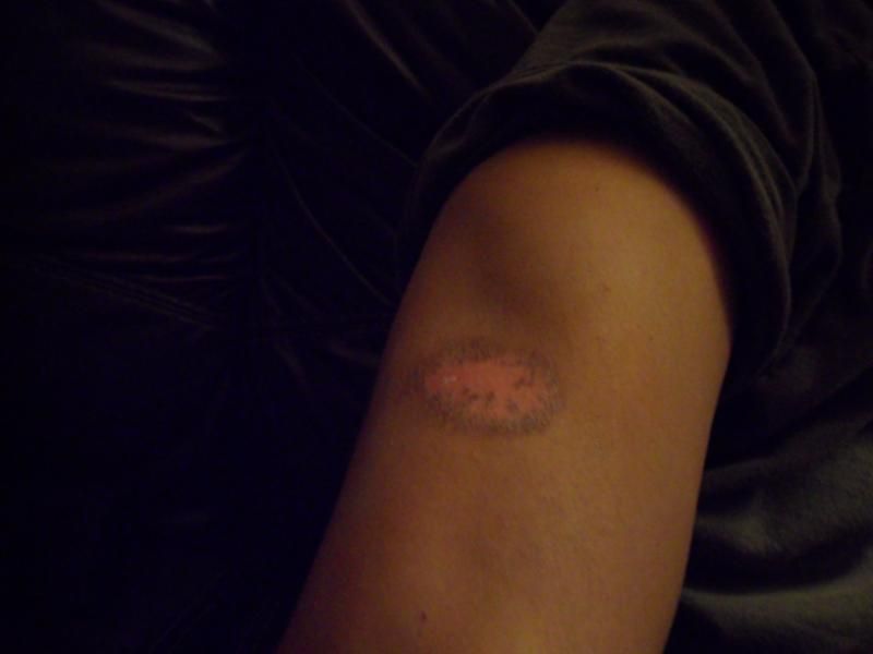

While doing some checks on my on car and trying to being cautious, I still managed to catch my arm on the exhaust, for only a few second and achieve a nasty burn
http://i77.photobucket.com/albums/j7...8/SAM_4521.jpg
That looks sore Sudesh, but its a painful way to bond with your car! :D
jeez mate NOT good, looks bloody sore!
thats 2 burns from an NSX now :)

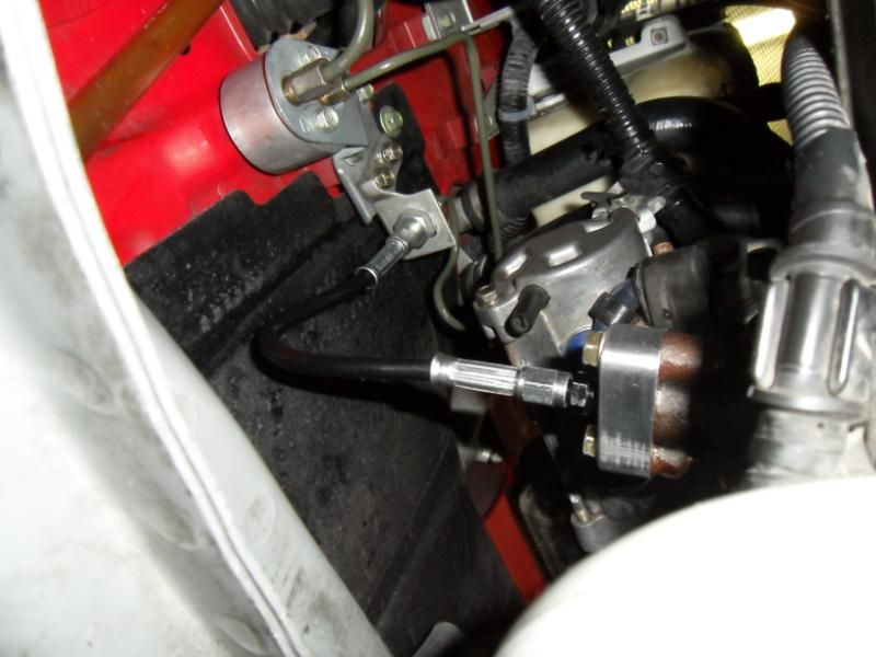

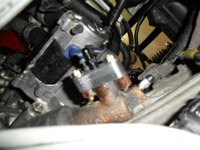

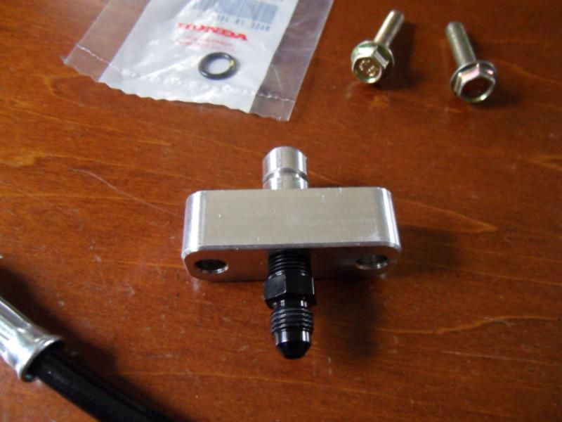

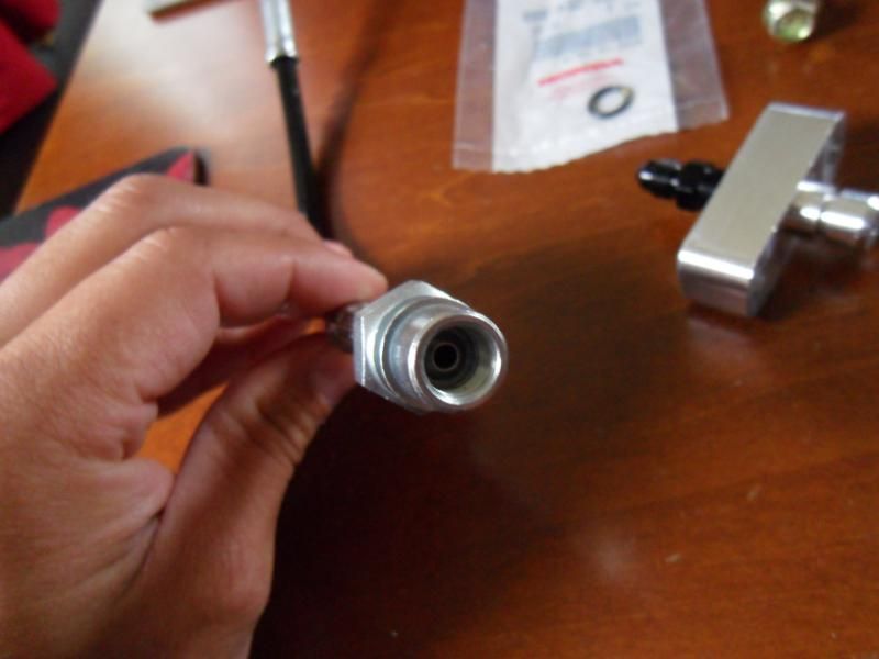

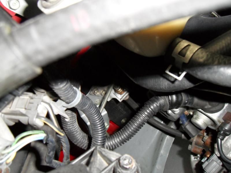

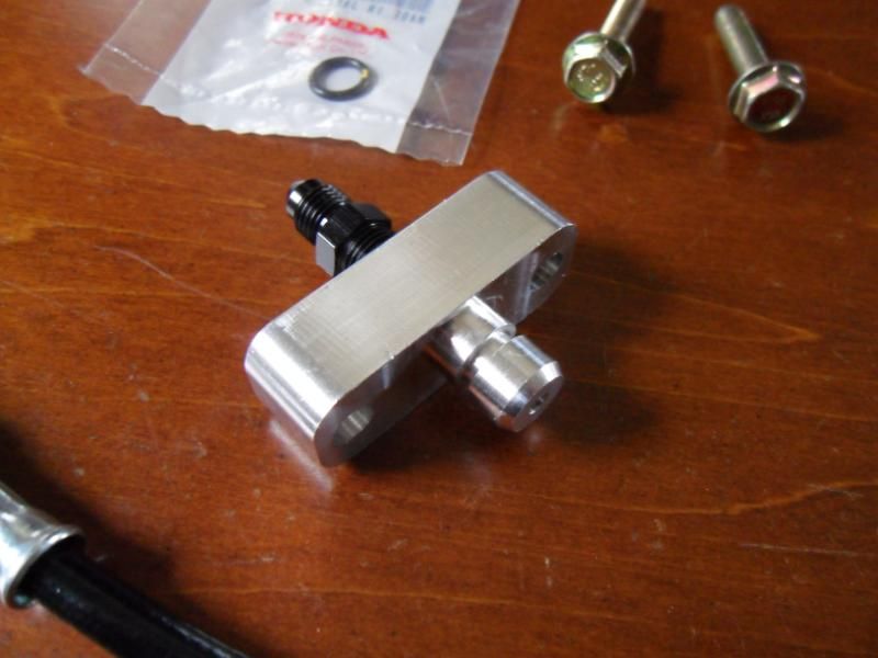

Just received the stainless clutch hose and adapter for the NSX. So got around to installing it on my car today.
Quite a nice setup, it came complete with new bolts, OEM seal and obviously the other necessary bit.
http://i77.photobucket.com/albums/j7...8/SAM_4582.jpg
http://i77.photobucket.com/albums/j7...8/SAM_4584.jpg
http://i77.photobucket.com/albums/j7...8/SAM_4585.jpg
http://i77.photobucket.com/albums/j7...8/SAM_4587.jpg

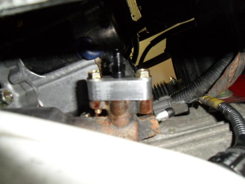

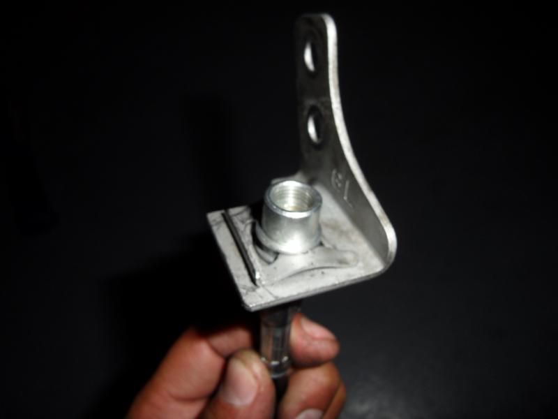

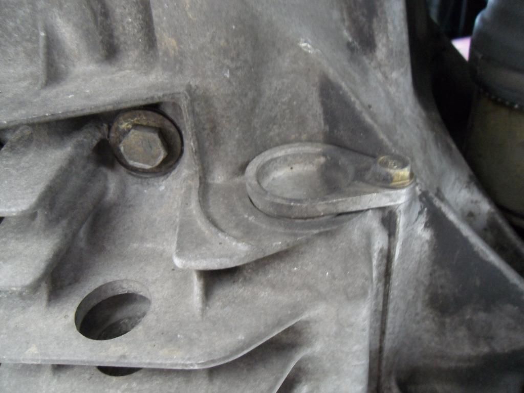

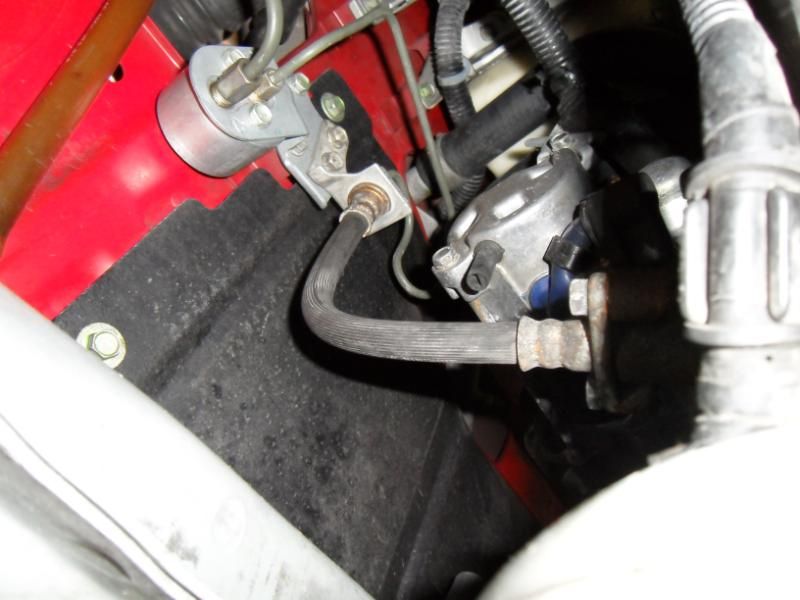

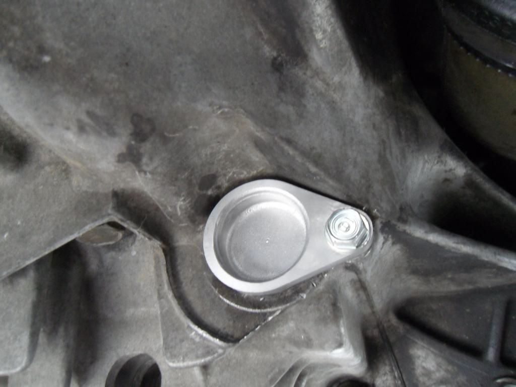

So first remove drain the clutch resevoir, but even with that drained you will get some fluid dripping out so be careful and try not to get it on the body work, just keep a cloth handy to wipe down, with the hose removed I put the new seal on and bolted the end that goes into the clutch slave first really simple and and straight forward, only 2 bolts.
http://i77.photobucket.com/albums/j7...8/SAM_4592.jpg
http://i77.photobucket.com/albums/j7...8/SAM_4593.jpg

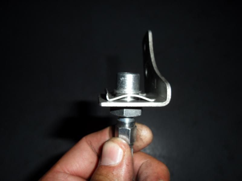

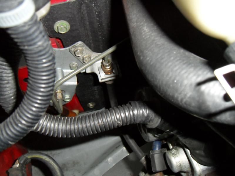

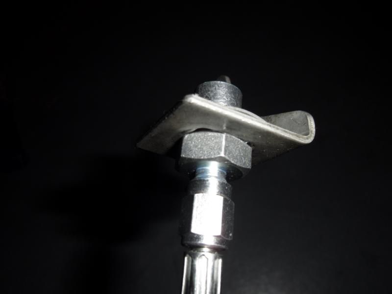

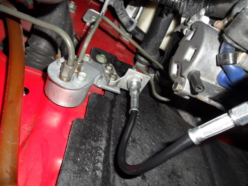

On this install I decided to remove the retain bracket that sits on the fire wall as I wanted to see how good a fit the new hose was and make sure the little clasp was nice and tight.
http://i77.photobucket.com/albums/j7...8/SAM_4594.jpg
http://i77.photobucket.com/albums/j7...8/SAM_4595.jpg
The clasp fitted perfect and as good as OEM.

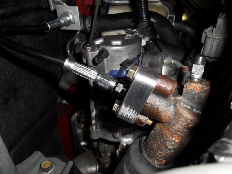

So, just bolt the bracket back up, install the metal clutch pipe into the female end of the new stainless hose and screw up the female end of the new hose to then adapter on the slave cylinder and thats it!
Just need to bleed the system now and have a test.
