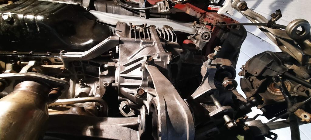

More progress, although I'm not getting in the garage as often as I'd like...... especially over the Christmas holidays, thanks to the Moderna booster.

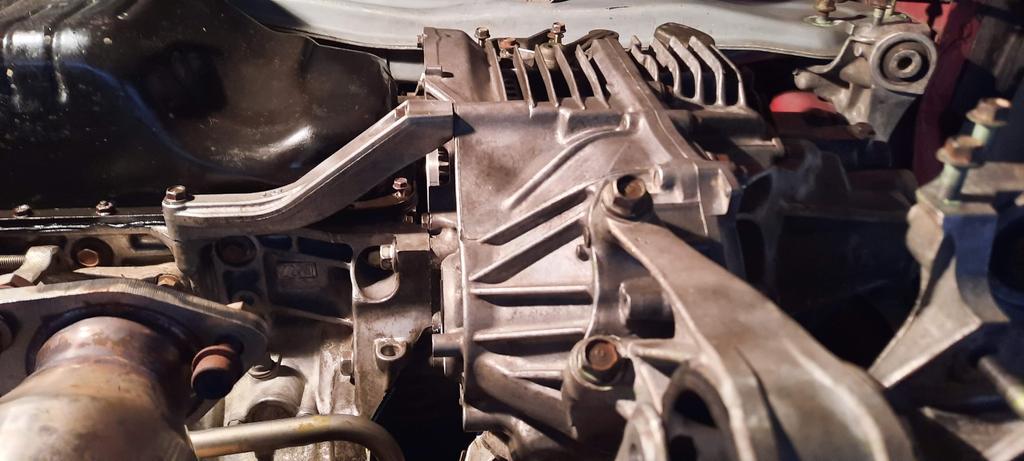

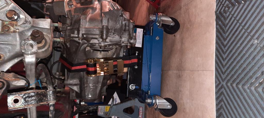

Gearbox back in place. Awkward job to do with only one pair of hands, the small transmission lift helped but another pair of hands would've been useful for holding the clutch fork in a position to not hinder the final few cm's of mating the gearbox. In the end a piece of bent wire had to do.

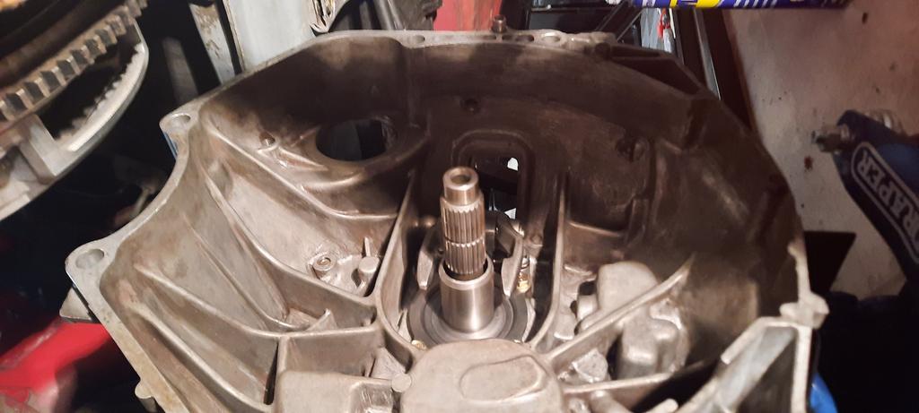

For anyone else who may take this job on, I would say the main thing to remember is .....CLUTCH FORK, CLUTCH FORK, CLUTCH FORK !!! It hinders the removal & re-fitting of the gearbox if not held in a suitable position.

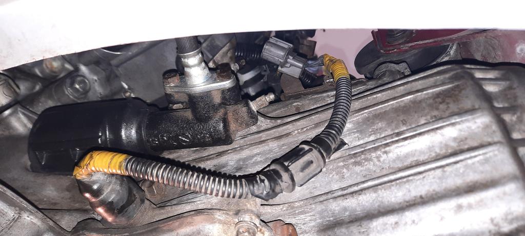

Clutch slave cylinder in place, now with dust boot. Worth mentioning the boot makes aligning the cylinder shaft awkward to align into the clutch fork, it's quite easy to think the shaft is engaged into the socket in the fork but there's a good chance it won't be, which wouldn't be ideal when you first press the clutch pedal.

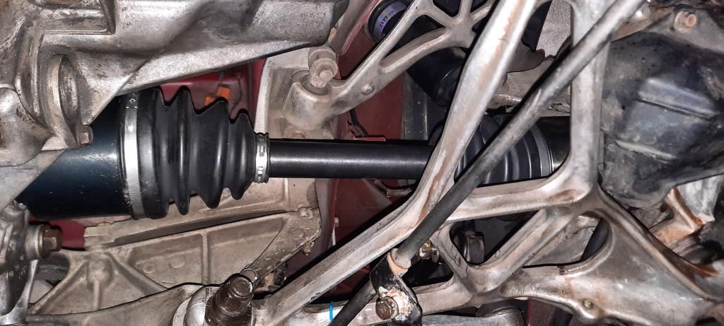

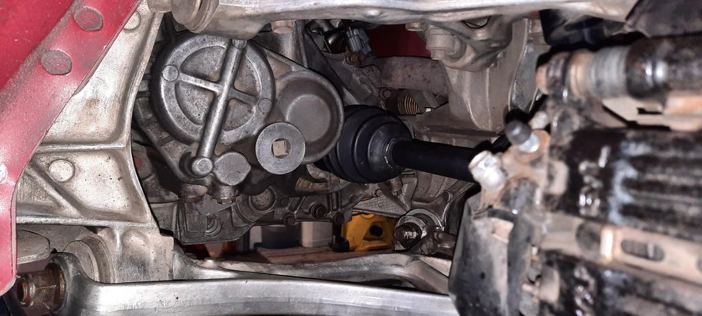

LH driveshaft in place. I'm fitting brand new shafts from Insane Shafts.
Attachment 14481
Attachment 14482

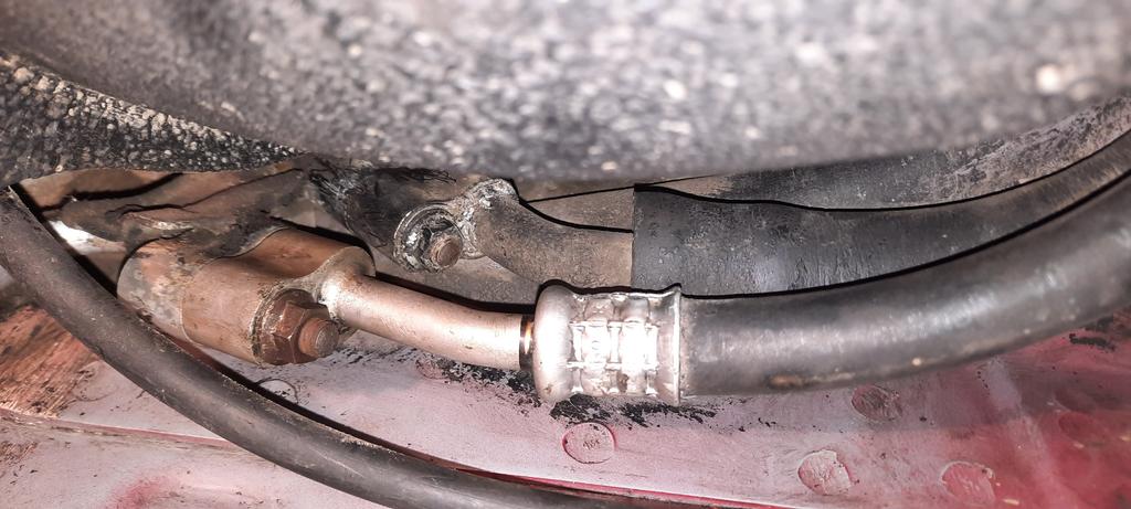

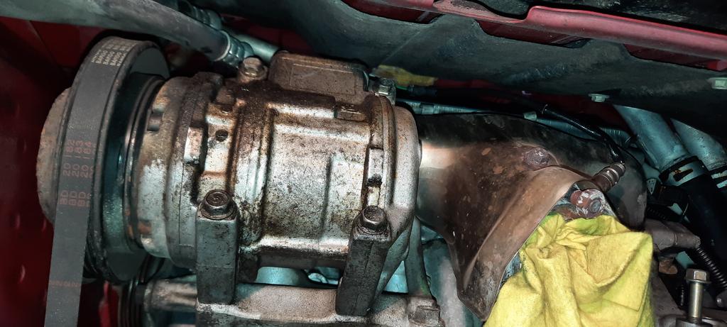

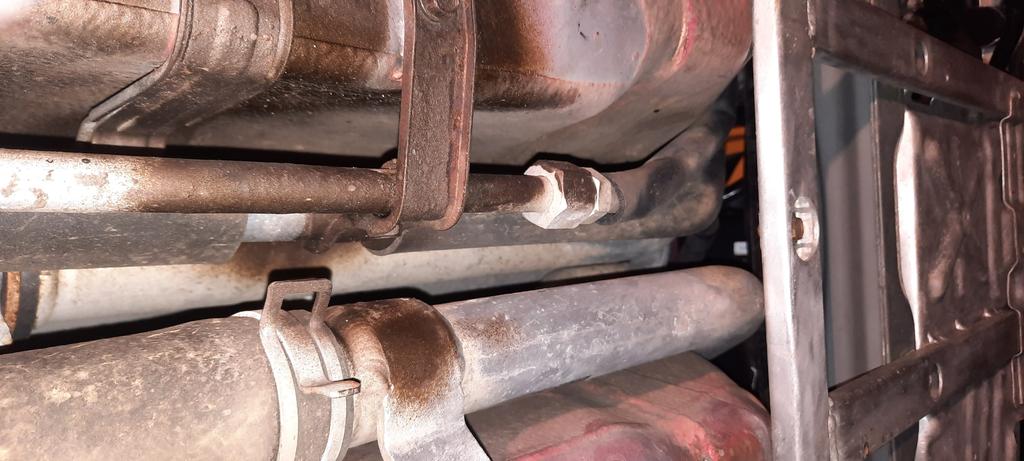

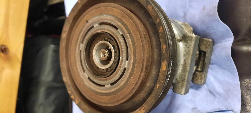

A bit more work done this weekend. Started to replace the Air-con pip seals & remove the compressor & have it checked out/reconditioned, while the system has no charge. Looking along all the pipe runs, there's no visible sign of a leak, which is annoying, as where did all the gas go ?? There was no pressure in the system when I split the first joint.

Belt tensioner needs a new pulley, it's quite noisy, so a few more parts to order from Amayama.
Attachment 14495
5th photo.

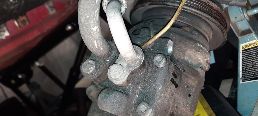

Although you mentioned that your 'system was checked out/reconditioned', does it include the compressor?
That sticky looking debris at the service plate and the front housing is most likely the compressor oil.
How much oil did you manage to recover from the compressor body?
Not only the small o-rings at each pipe/hose fittings, the octagonal big gasket under the service plate and also the large diameter o-ring at the front and rear housing of the compressor body are common places for the leakage.

The compressor hasn't been checked yet, my guess is that this is the first time it's been removed in it's 31 years of age. I only had the system re-charged last year, after the condensers were replaced.
The sticky debris seems to be quite old IMO, I was expecting more signs of a fresh leakage from last summer, when the system stopped working and so far I've found none.
I haven't tried to drain any oil out of the compressor yet, so something to do but when the pipes were removed, there was hardly any seepage of oil from the hoses.

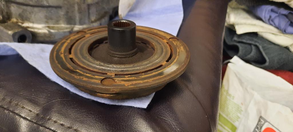

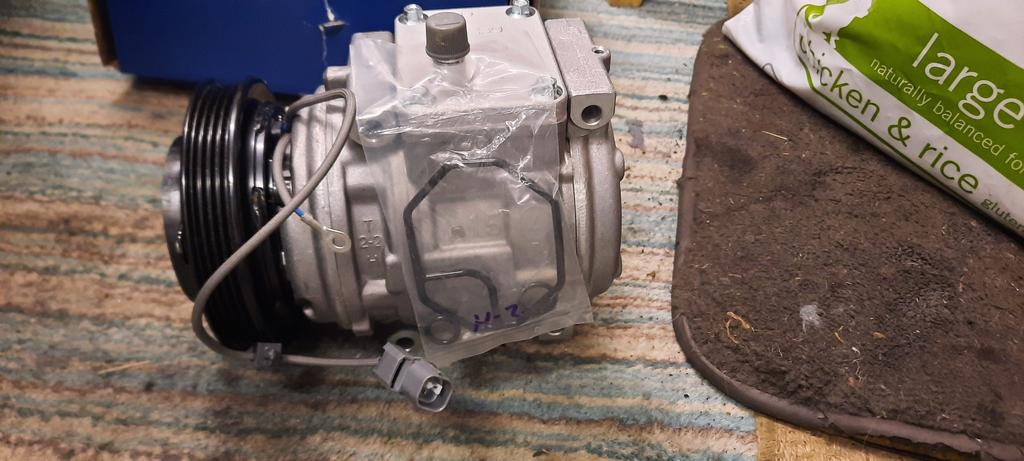

Continuing on from the my last post, I've bought a new air-con compressor. Had to get the 471-1194 model from the US, as 47-1193 wasn't available, as Kaz had pointed out. I'm now waiting on a '97 mounting bracket & a '97 clutch/actuator assy, the later coming from Rock Auto. Strangely Rock Auto specify the same replacement part number for both a '91 MY & '97 MY, whereas I was under the impression the two assys were different, due to the mounting bracket offsets as documented in Kaz's posts.
Rock Auto part numbers
AC Delco 154750
Four Seasons 47598
AC Delco not currently available & the Four Seasons assy is also listed for a 1994 Toyota Celica.
Amayama part numbers are
'91 389-PR7-A01 (full clutch & stator assy)
'97 389-PR7-A04 Clutch 38924-PR7-A01 Stator Assy
I was sort of hoping to use my current '91 mounting bracket & swap my clutch/stator assy but looking at the clutch, I think a replacement is due, eve though it did seem to function well enough, during the brief time the air-con worked last summer.

i think on the later cars the AC pump was moved outward with the updated bracket to get it away from the revised exhaust manifold, and the pulley was moved inward towards the pump body to correct the difference
Hi, Wix.
471-1194 has smaller pulley diameter (about 125mm) compared to the OEM one or the 471-1193 (about 140mm).
Hard to see in your photo but the connector on the -1194 would be also wrong.
By the way, 471-1193 just got back in stock at the Rockauto.
AFAIK, there is no aftermarket 97+ CL/Pulley/Field coil set with the proper offset matching the 97+ mounting bracket listed under the Acura NSX section of the Rockauto site.
Therefore, the two parts listed (#154750 & #47598) in your post are most likely to be 91-96 offset spec.
Could you measure the diameter?
Also, kindly take a photo showing the mounting offset, just like the two yellow arrows as per the photo shown later.
Not the end of the world as your existing friction material looked worn out so best replaced with your new aftermarket ones.
Most likely, the aftermarket one will have 91-96 mounting offset, just like your existing one.
Just re-use your existing 91 - 96 mounting bracket and not the 97+ one.
Please keep your 97+ mounting bracket as I'm quite sure someone will need it when doing the A/C Refresh.
I may even buy it from you in the future if I was asked to do another A/C Refresh.
