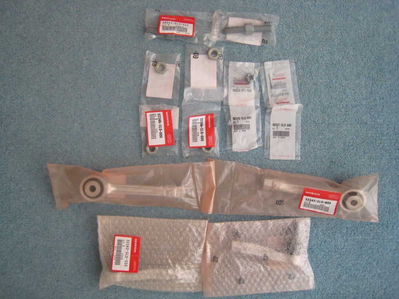

Not sure the correct English name for this part but long time ago, when I tried to install the key-less entry system, I accidentally broke off the small tab sticking out from this part. It was there to prevent this panel to rattle. It started to rattle recently so I decided to replace it with the new one. I saw lots of NSX with the same damage to this panel and after replacing it, the rattling noise was gone.
3. Type-R Clutch pedal and Damper-less joint
Attachment 5327

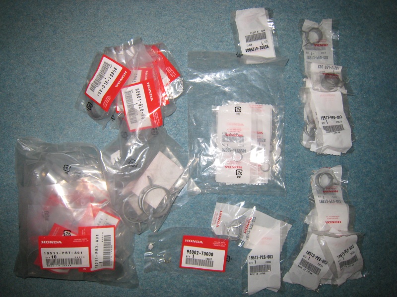

If you don’t like the height and feeling of the clutch pedal at the bite point, this is one thing you can try. These are the clutch pedal and damper-less joint from the Type-R. It will provide you with more direct/solid feeling and due to the clever angle of the pedal, the pedal height at the bite point will be lowered without any bad side effect.
4. Clutch slave cylinder and the clutch hose + O-ring
Attachment 5328

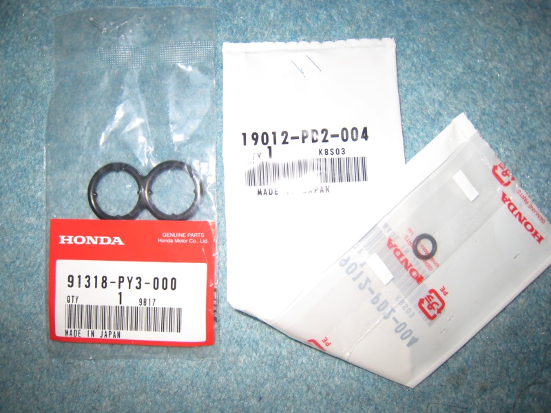

If you find a leakage at the Clutch Master or Slave cylinder, replace both of them at the same time. Also, if you haven’t done so, please replace the clutch hose and O-ring as some of the owners experienced burst hose due to the aging.

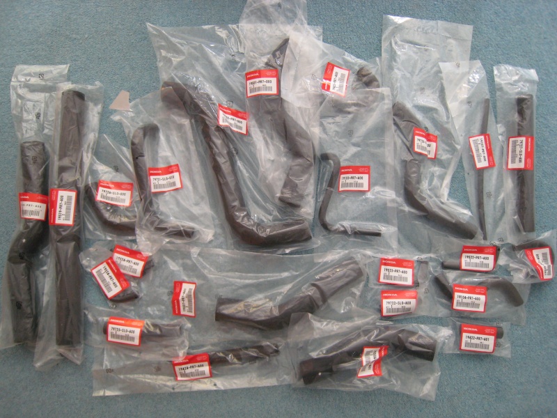

5. Coolant hoses – 23 of them
Attachment 5329
These are the regular maintenance items. There were several reports on the burst hose especially at the ones under the header tank, the small/short one at the Oil cooler and the one in the middle of the body under the floor.
