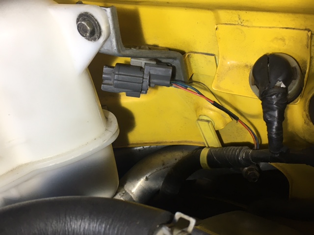

1995 UKDM 5sp manual. Fixed to the coolant expansion tank, Sumitomo HW[?] 2 way male and female with both wires pugged off. What is it for/ where does it go.

Roof holder switch sub harness.
It triggers the NSX-T roof warning if the roof R&L latch/lock were not fully engaged or if the roof was removed but not stored properly at the roof/eng cover.
Since NSX-T was introduced from 95, if you own 95+ model but coupe, you will always see unterminated 2pin grey connector there.
