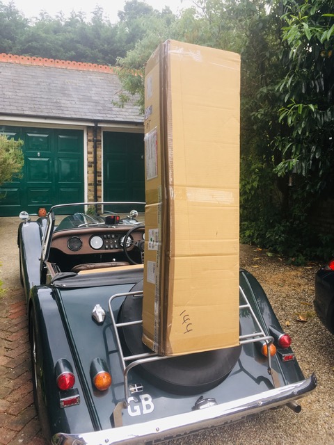

1 Attachment(s)
Attachment 14952
Ebay from Japan the box contains the cross pipe between the two condensers and one condenser
